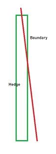

  11. I'll have to see if I can get hold of those title deeds - assume they are with the bank, good idea to check.....I think the hedge was put in not long after the build - it's perpendicular to the neighbours house, but not in line with the official land registry info which has than angle. Thanks.
  12. It only influences the front driveway so that would need to shift a bit but then not align with the planning drawings. The build won't be affected but it's how best to square the circle with / without the neighbour.
  13. I have planning permission but just noticed that the front boundary in the drawings does not match the land registry drawings which narrow towards the front of the site. There is a hedge that aligns to the planning drawings that has been there for 20 years or more. The question is do I proceed and build or talk it through with the neighbour? I don't know if changing / amending the planning drawings invalidates planning permission? I'd rather talk than go for adverse possession or leave it to a future owner to sort out, or if my neighbour sells spot it then. Any advice?
