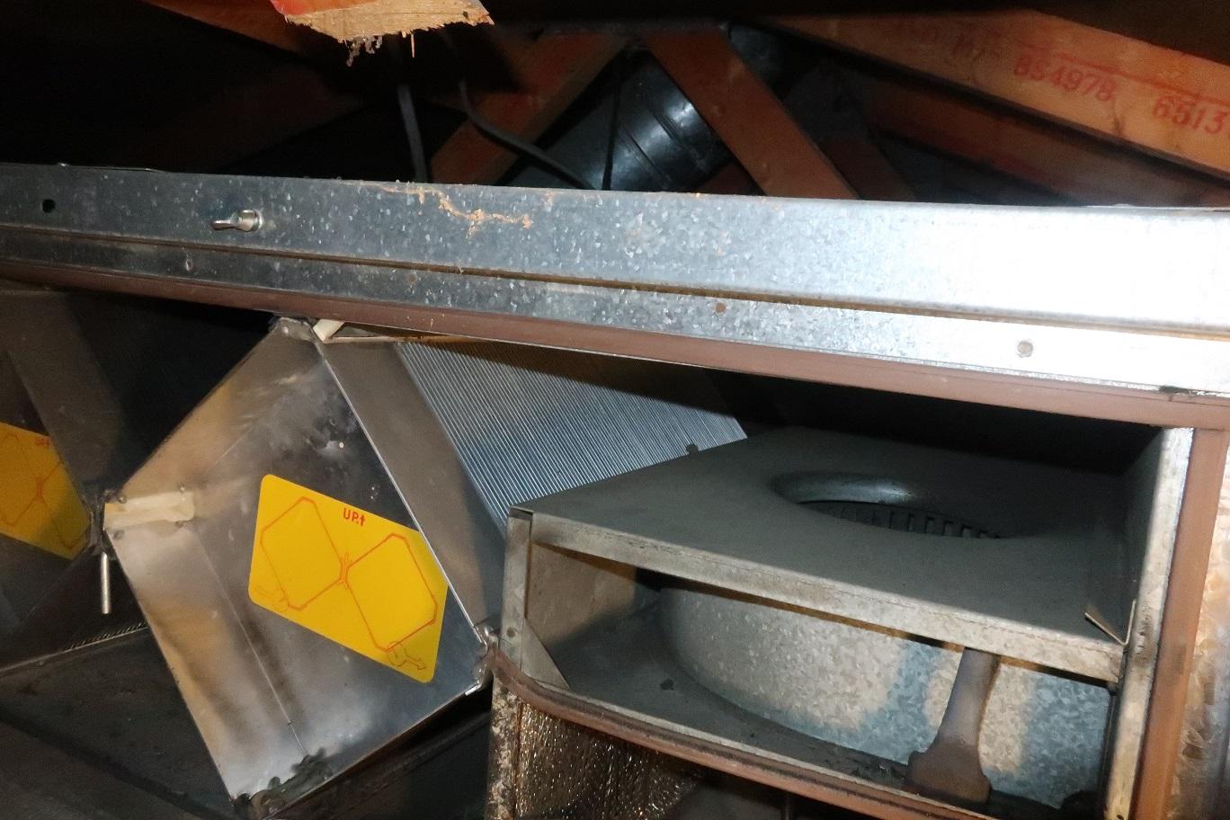

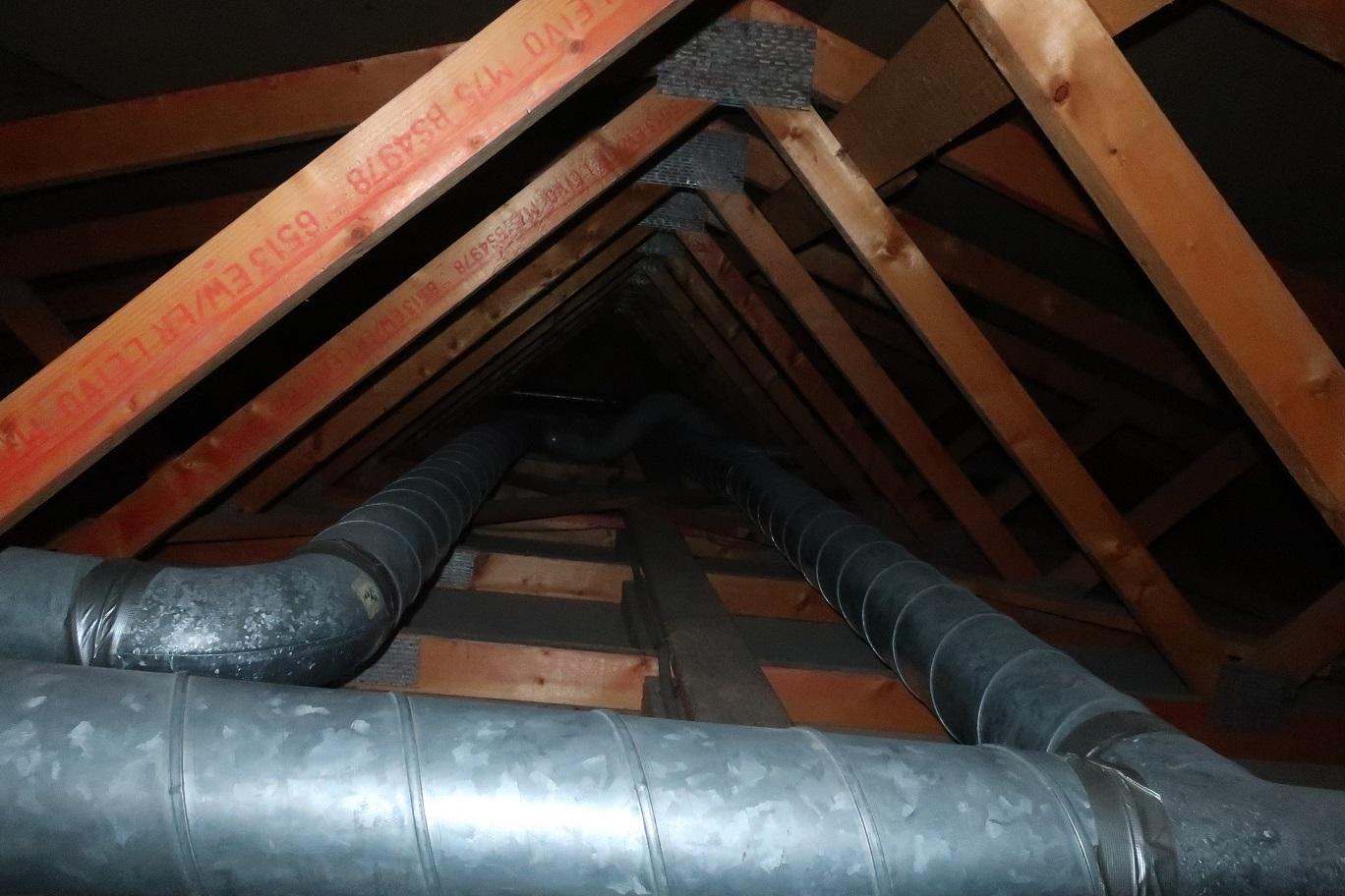

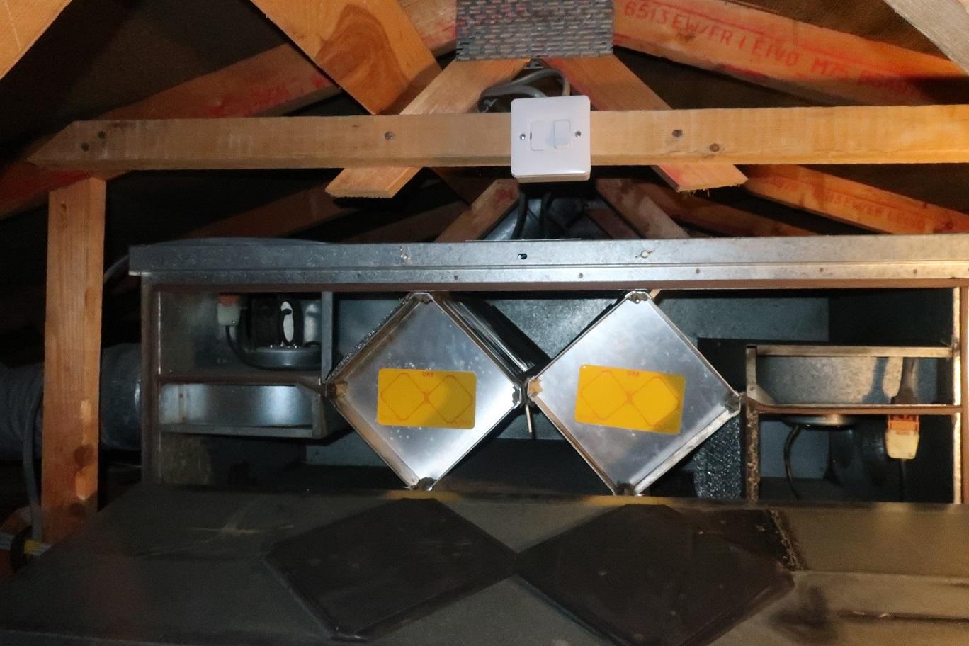

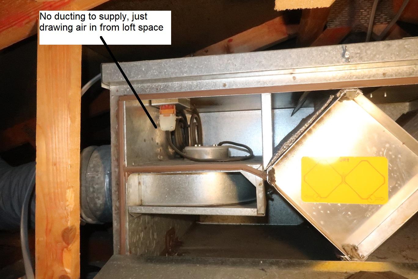

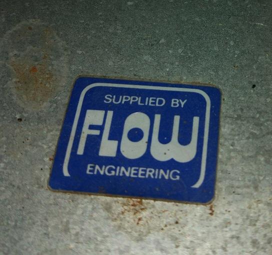

  3. Hi, we've just bought a house that has a very old MVHR installed which needs the main unit replacing and the ducts cleaned and balanced. We are not planning on having an airtight house and will keep windows open during warmer months. We cannot decide if the benefits of running an MVHR in a non-airtight house warrant the cost to upgrade/service. We cannot find anyone in the local area (North East) that can assess our installation and make recommendations so would be grateful for your opinions. The installation is very old, the main unit is branded "Flow Engineering" and I've attached some photos. I can hear the fans are working but I cannot feel any air movement through the vents. There is galvanised metal ducting to every room and it extracts from kitchen, utility and bathrooms. The unit is mounted in the loft and there is no loft insulation at all. Is it worth upgrading and servicing the MVHR system or would it make more sense to install an MEV with the existing extraction ducting and remove the rest of the ducting in favour of loft insulation?
