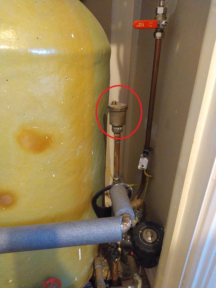

  11. Hi, What is this in relation to my heating system? I've a gas boiler but wondered where the air vents out if needed. There is one in the boiler, you have the radiator bleed vents but then what is this used for? Thanks!
