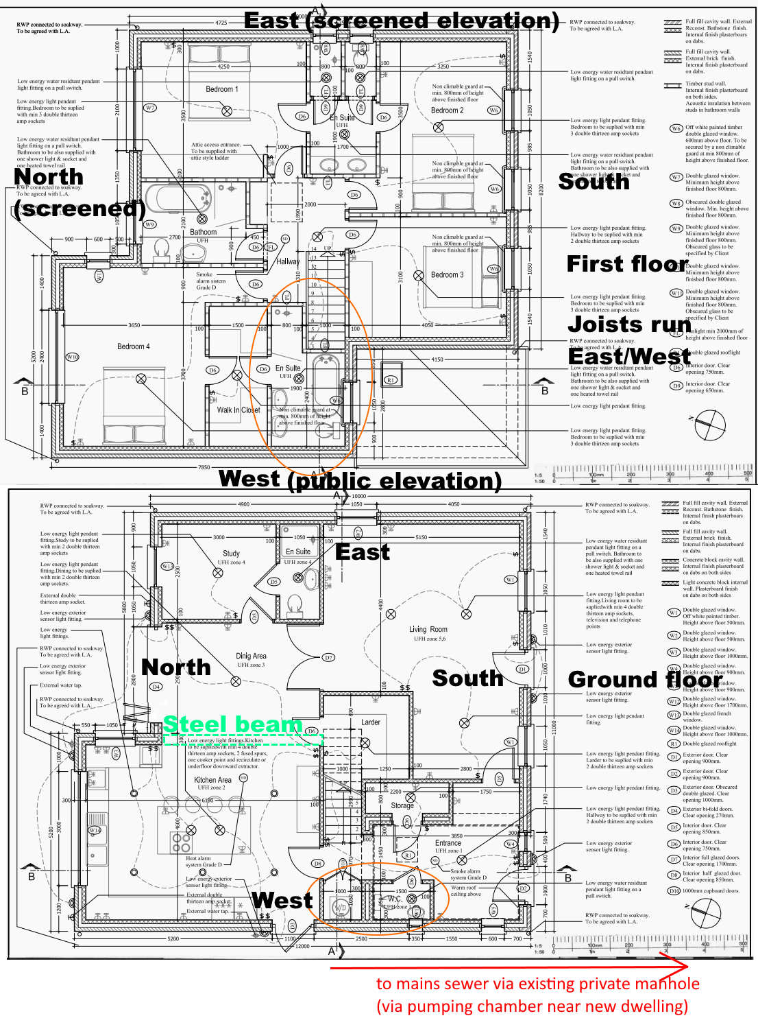

Do you have any internal rodding points in that layout? -
The first floor west bedroom ensuite is foxing me. (area encircled orange) Is the sanitary ware positioned helpfully? Where would you place the soil stack(s)? Rodding points? Inspection chambers? This west side en suite foxes me the most out of all the bathrooms. Especially the shower position and how it would get to a stack. Aim is to ensure access for rodding, minimal blockage risk, and if possible to keep the west elevation looking good.

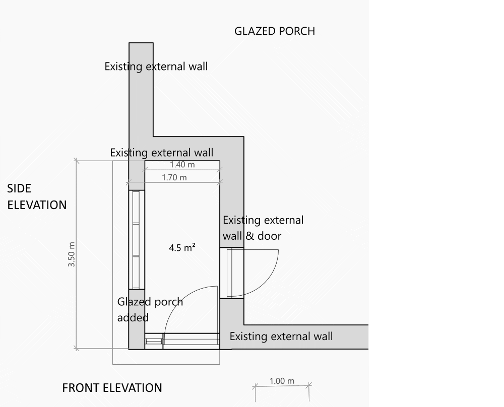

Demolition of attached garage to create access alongside current home. New build in rear plot. Construction of small lean-to porch/single storey extension where (larger) garage once was. Builder has all relevant insurances with us covered, except if there is some damage without negligence. So the normal self-build insurance is covered. Problem: Current buildings/contents insurer says they will stop cover (& refund for remaining duration). We need to find buildings/contents insurance for our current home. What would you do?

No circuit breaker labelled Garage. One of the 2 circuit breaker switches labelled "ring main" isolates all of garage. Lights and sockets in garage all get isolated by this switch. But this same switch also isolates sockets in the adjoining first floor bedrooms. There is a small box high on the garage wall. From here, cables run in at least 3 directions to various parts of the garage. Suspect the wiring runs under the first floor bedroom floorboards and through the wall into the high box high on the (internal) garage wall. Apart from keeping the garage completely isolated during demolition, what is likely to be required in terms of dealing with the existing live cables/live box on the internal wall? (This wall will survive but will again become an external wall. Electrics compliant with BR will be required in the small glazed porch that will replace the demolished garage. The porch is generally exempt from BR according to LA BC)
Demolition of a lean-to attached garage that has electric lights and a switch. Cables enter near top of lean to. What precautions needed for demolition, electricity-wise? Builder probably knows, but I would like to understand too.

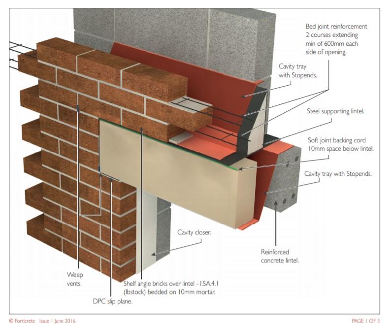

Tks. But why the lower cavity tray? Necessary?
