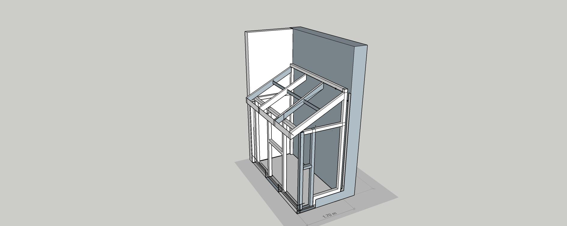

roof joists 1.6m short side 3.2m long side
Lean to in the recess formed by 2 existing walls. For various reasons, it is exempt from BR. Outer skin (side wall) will be stone masonry, tied to the posts. Cavity 25mm with breathable membrane. Front elevation largely glazed, for various reasons. Roof covering OSB3, breather membrane, counterbattens & battens, slate. Any obvious flaws in the design? Is it crying out for any changes (eg, more purlins?) Would you insist on structural calcs? Would a 450 x 450 mm trench fill foundation suffice to hold up the stone outer skin, 2.6m tall? (soil texture is sandy gravel, good load bearing) How would you fix the timber posts to the foundation concrete?
For various reasons, a stone external skin is required for a stick-build timber frame lean-to. How to bind the stone masonry to the timber posts?

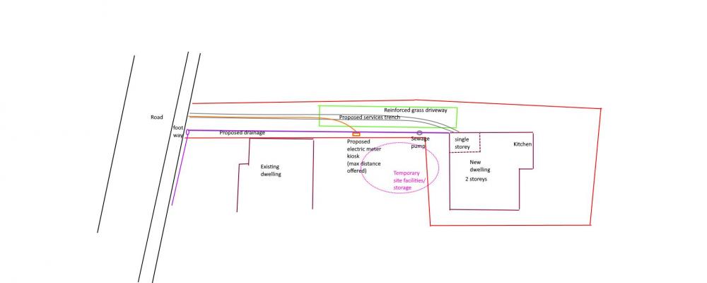

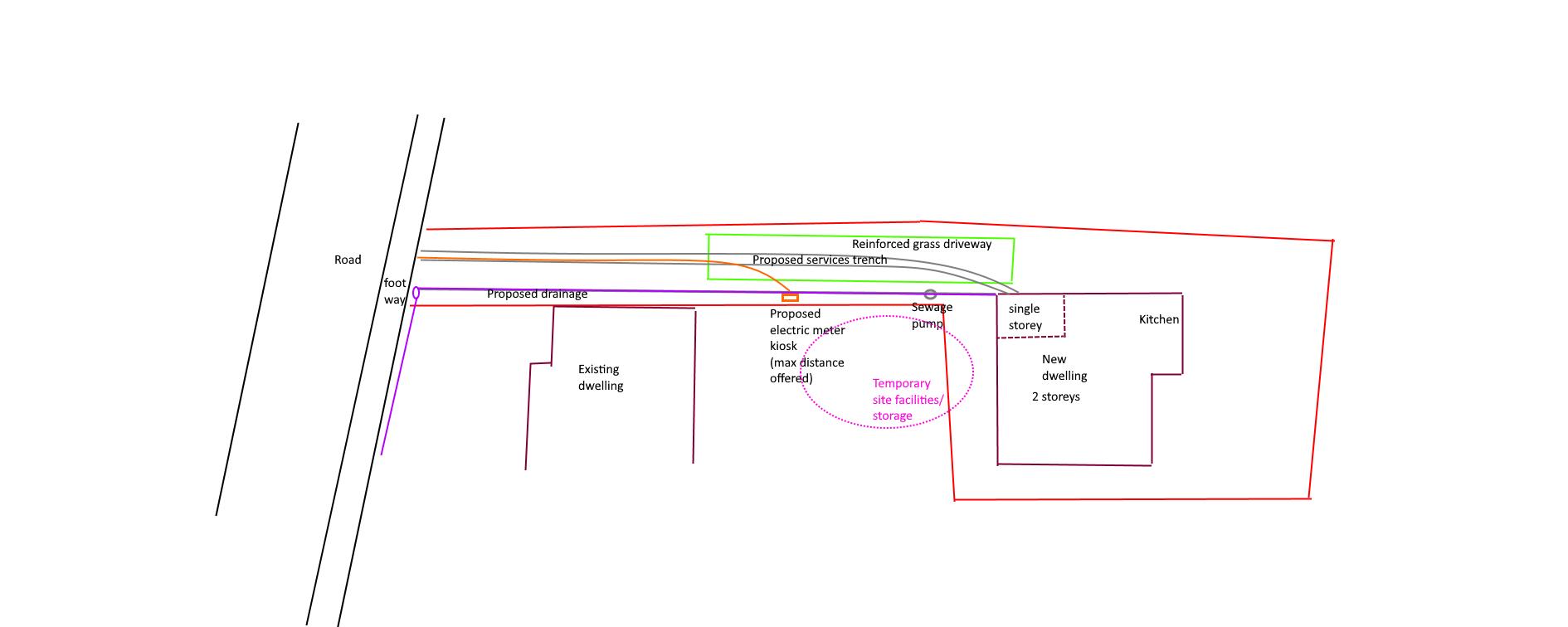

Just commenced enabling works. Electricity connection due soon. 3 phase 46kVA. No idea: 1) Where is best to put the 3 ph distribution board. In the kiosk? And where to put the kiosk? (It is as far from the road as SSE offered). What else to put in the kiosk (eg., switched fuse(s)?) 2) How to provide power to builders. What gadget(s) to use. Novice here, so pls assume zero knowledge. 3) How to take power to the new build in due course? Keep the 3 ph board in the kiosk and take single phase supply to the new house? Use SWA? 4) Where to put EV chargers eventually. And whether to put in some cabling at this stage in preparation. Grateful for any advice.

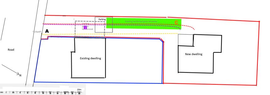

Wales & West Utilities info says "Ducting must be laid in a straight line with services running perpendicular to the mains pipe. Ducts must terminate a minimum of 1m from the service entry point to allow for assembly and installation of the service entry fittings. An open excavation must be left at this point" Pits must be left open at intervals of not longer than 20m to assist the insertion of the PE pipe. Additional pits must be left open at any bends in the service pipe." Route A was the proposed plan sent to WWU. Builder's groundworks man proposes trench in the middle of the reinforced grass driveway. So that large lorries will straddle the trench. (routes B and C) B and C are not completely straight lines. Should I chance them?

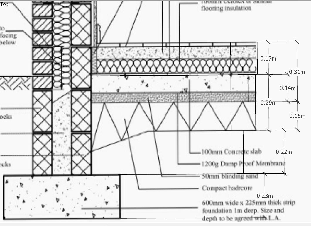

Do the underslab drains go best in the hardcore layer or the ground beneath, or partly in each? Maximum distance 11m to get the drain out of the footprint. Would you use one concrete lintel for each leaf of cavity wall or one wide lintel spanning both leaves?
re underslab drains, Building regs approved doc H (drainage) says flexible filler and at least 75mm of granular material between the top of the pipe and the underside of the flexible filler below the slab What can serve as the flexible filler?
