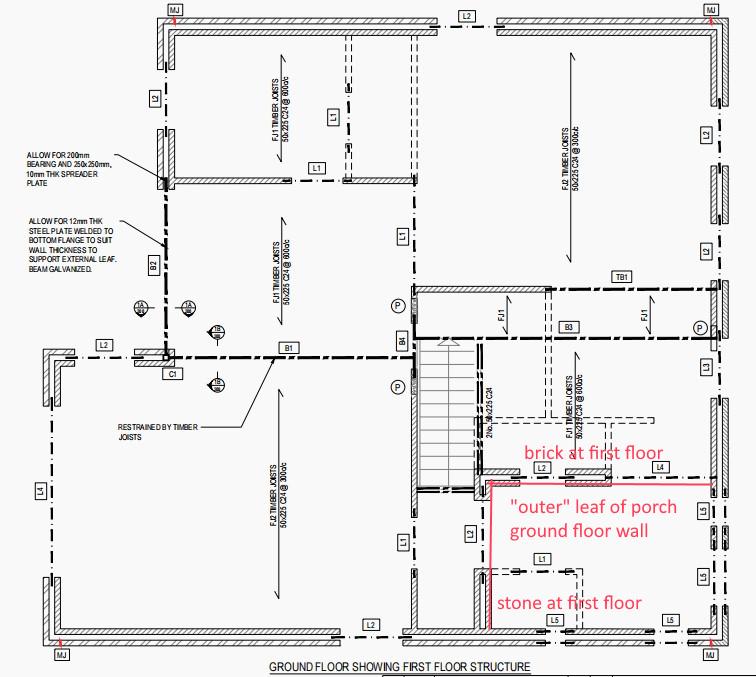

  21. Entrance porch is single storey. Cavity walls of porch continue up to first floor as external walls. (drawing attached, front/south at right). Outer leaf of cavity wall non-loadbearing. First floor external walls are, respectively 1) brick (side/west) 2) reconst. stone (front/south) Question: If brick and stone are not the preferred finish for the interior walls of the porch, what is the most cost-effective block that safely can sit beneath brick or reconst. stone? 3.6N aircrete? Other?
