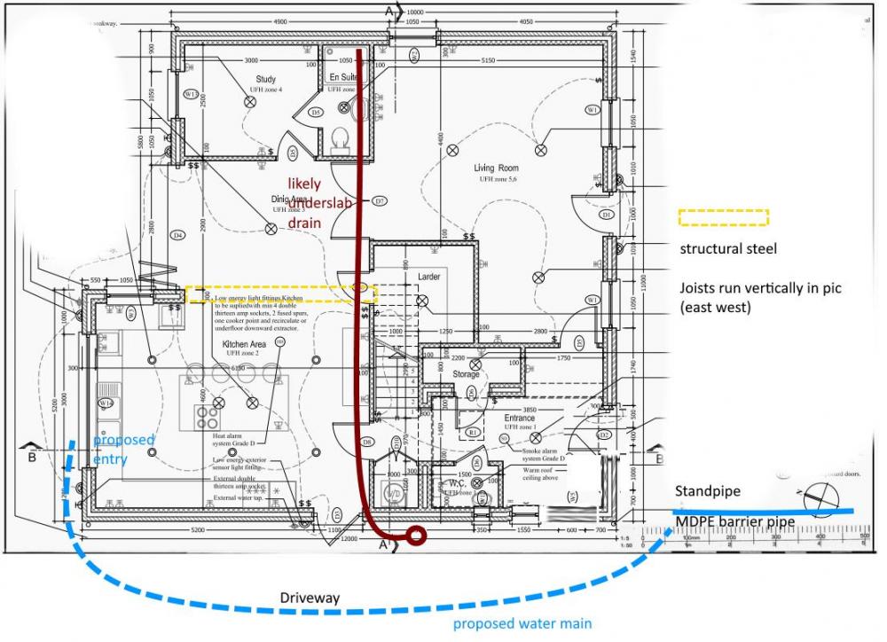

Does underslab water main still need to be 750mm deep?

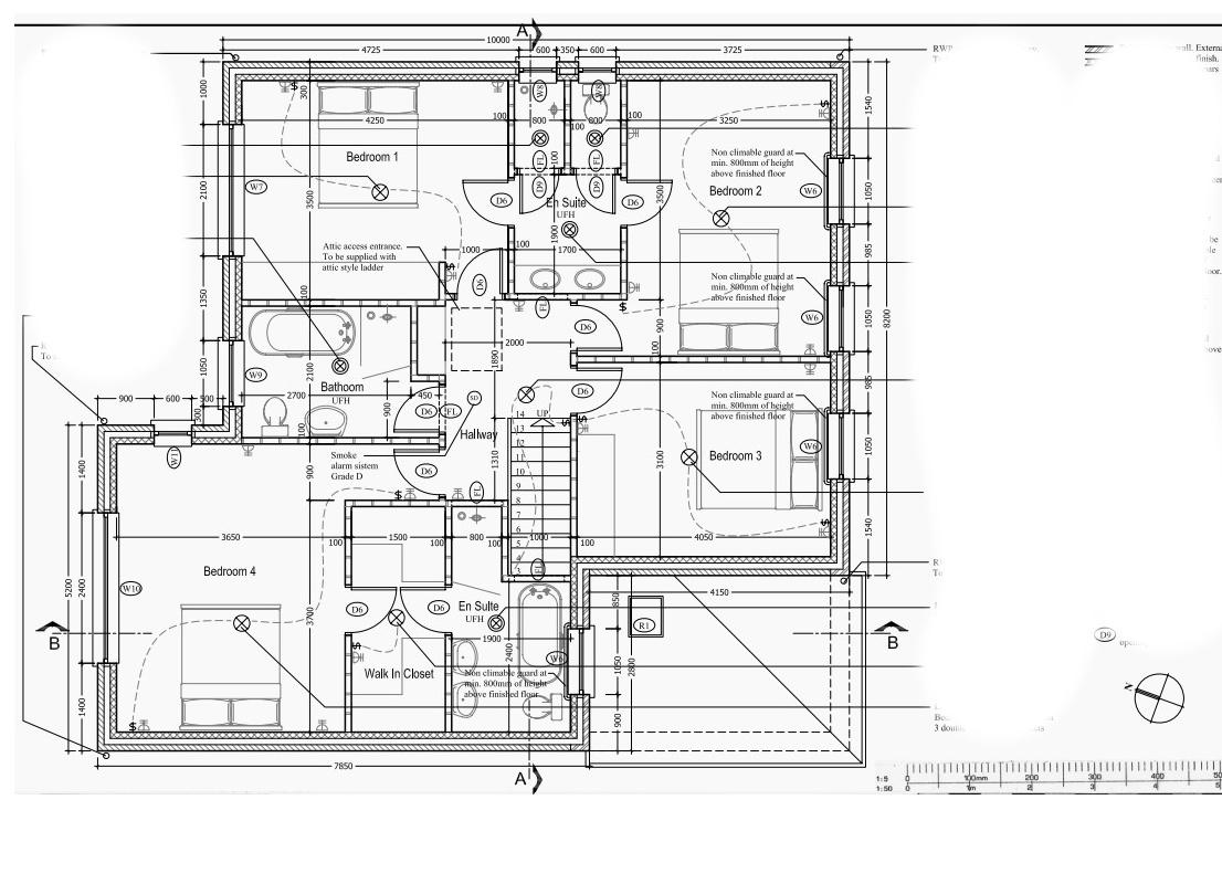

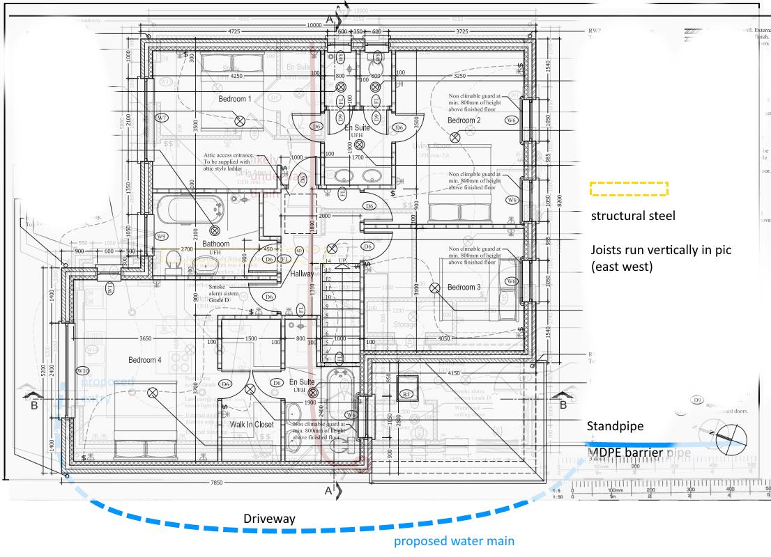

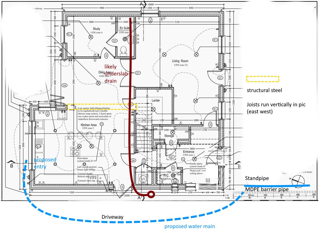

Experienced groundworks subbie proposes water main entry point. (pics of ground floor, first floor, and both approx superimposed) Barrier pipe required if going under permeable driveway. Where would you put the entry point? My instinct was nearer the existing standpipe.

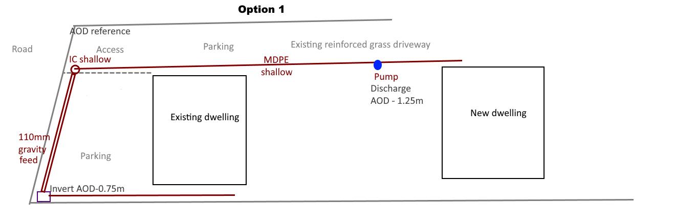

Apologies for the confusion. Those were minus signs not hyphens. The house is lower than the manhole invert, not higher. Hence gravity drain ruled out.

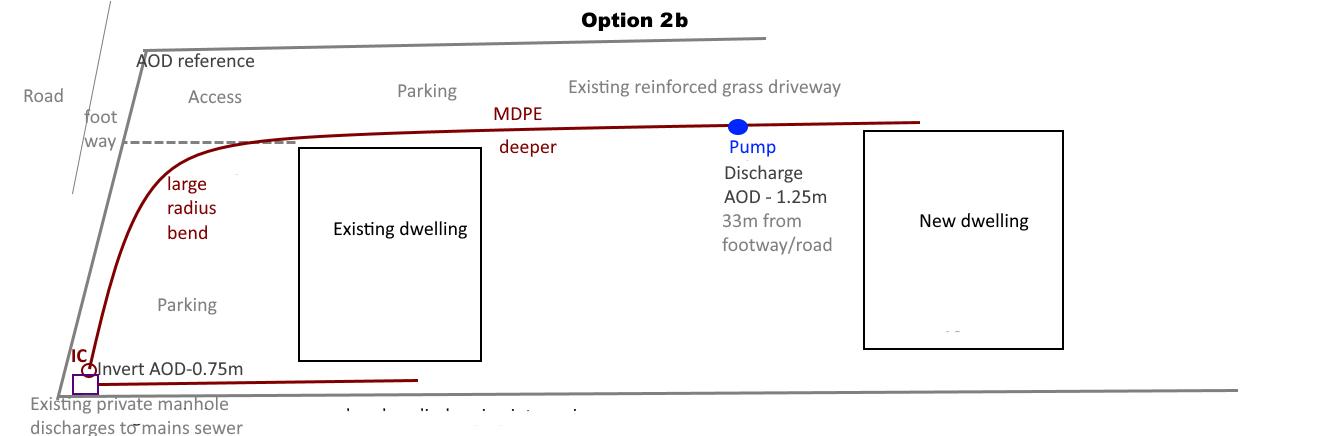

Came across Strate pumps, seems good technology for pumping sewage. Can be installed indoors or outdoors. But does not have a huge effluent chamber. Anyone used one of these on a new build? Can it pass Building Regs without a huge effluent chamber?

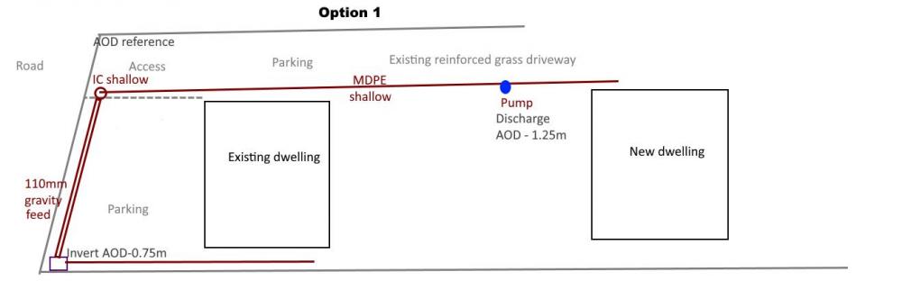

Thanks, understood. Will installation of curved MDPE be quite difficult? Agree that the opportunity to rod both directions (no curve in MDPE) is attractive.

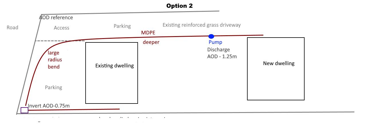

Just to make sure you mean option 2, it is the one where the MDPE has a large radius bend. Either option will include a chamber.
Yes, apologies. AOD reference level in this case is over 40m above AOD. So I should not have introduced this confusion
Yes, pump discharge level will be approx 0.5m BELOW the inlet of the inspection chamber
For avoidance of doubt, this is foul drainage (sewage). The existing manhole is likely to have a catchpit. Brick and concrete construction (over 100 years old). Not broken into yet. But upstream IC is brick with concrete bench discharging into concrete-embedded pipe (probably clay). Good point. Maximum pumping head (level difference) would never exceed 2m. MDPE length from pump to existing manhole would be less than 50m. Pump with 5m head might suffice. Tempted to put the pumping chamber nearer the new dwelling, would increase the MDPE distance by 10m and reduce the force of flow a little bit.
Would this variation on option 2 work? Inspection chamber to break the velocity before discharge into the existing manhole. The force of the pump discharge suggests that a large radius bend in the MDPE is not fatal.

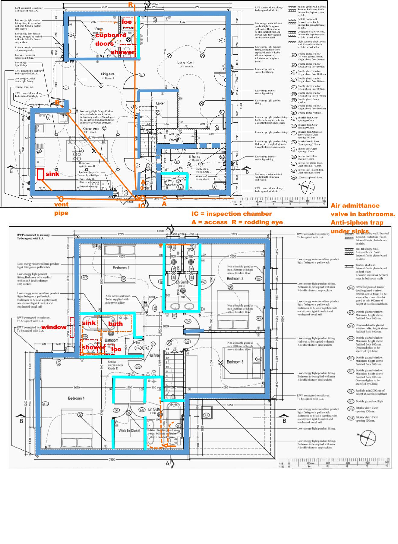

Soil vent pipe open to atmosphere - can it be come off the rodding eye at top (east)? Instead of the position shown on the pic. Underslab drainage: bed and bench in pea gravel, with compressible material on top, then concrete (where there is space beneath the ground floor slab). PS South (right) is the front elevation. East (top) elevation is relatively private and screened. There is a blank wall (no windows/doors) on the north (left) half of the east (top) wall. Pumping station likely to be near SW corner (bottom right). About 1200 ltr capacity tank with one (or perhaps twin) pump. Other comments/suggestions on the foul drainage are also welcome.
