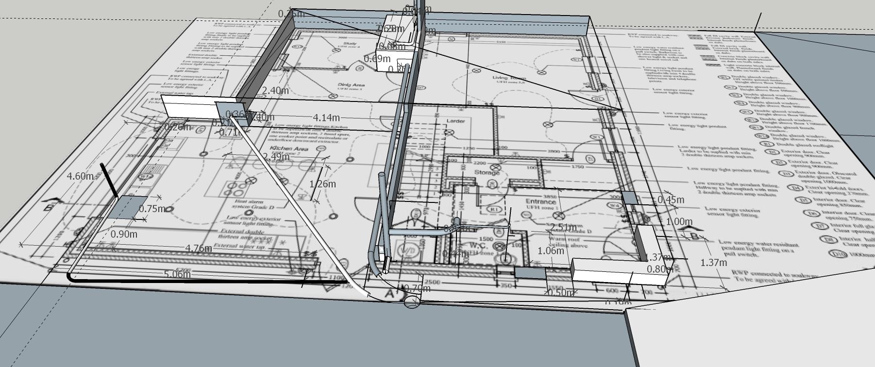

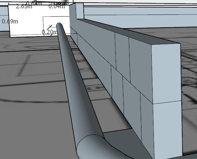

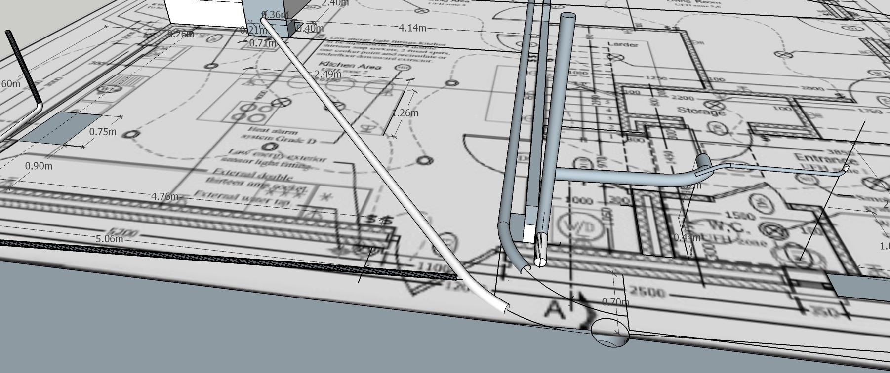

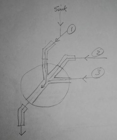

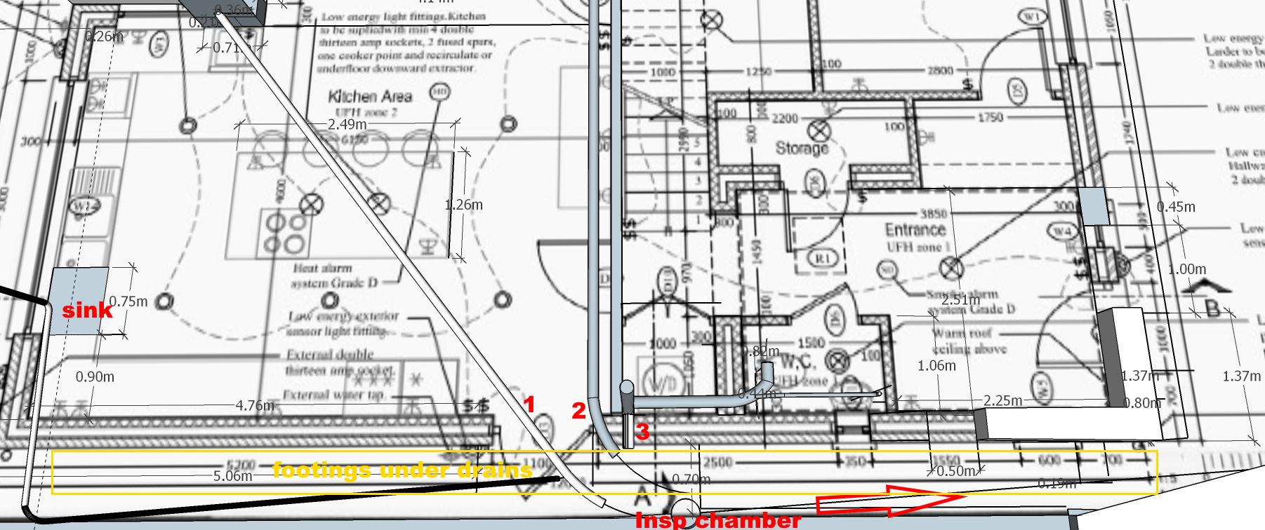

Drains numbered 1, 2, 3 to go into inspection chamber(s). En route to pumping station. Sink/dishwater waste pipe shown. How to get the drains into IC(s)? Footings (yellow) project about 0.6m from external wall. Need to have clear idea before drains are written in concrete. Openings in foundation masonry being positioned within next few days. Grateful for any ideas/suggestions/advice. PS Aware that a rest bend is needed in the soil pipe (3), exact position of soil pipe can be adjusted. Openings/lintels being positioned shortly.

Slope about 1 in 30 down towards front elevation of house. Top soil about 150mm. Limestone brash soil, high permeability. Trench fill, topped by concrete blocks cavity wall (lean mix fill). Backfill with limestone brash spoil. Sand blinding 50mm, DPM, Concrete slab 100mm, insulation etc. Do these foundations need to be waterproofed? Else will water simply run under the slab and swell or shrink whatever little clay remains in the limestone brash? (Moving the underslab drains)
No block and beams, no hangers. But is it ok to encase in lean mix? Not just bed or haunch, encase fully?

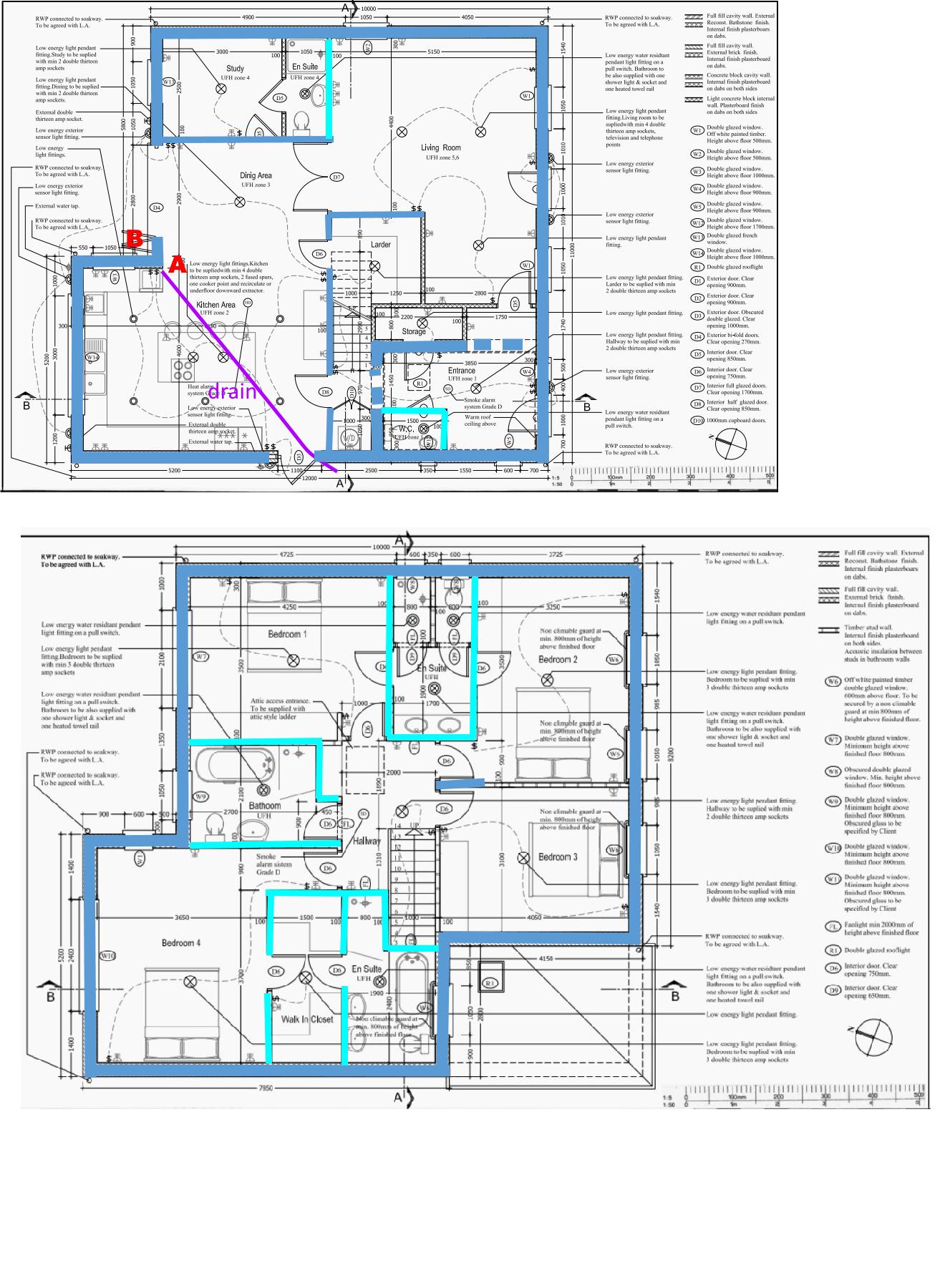

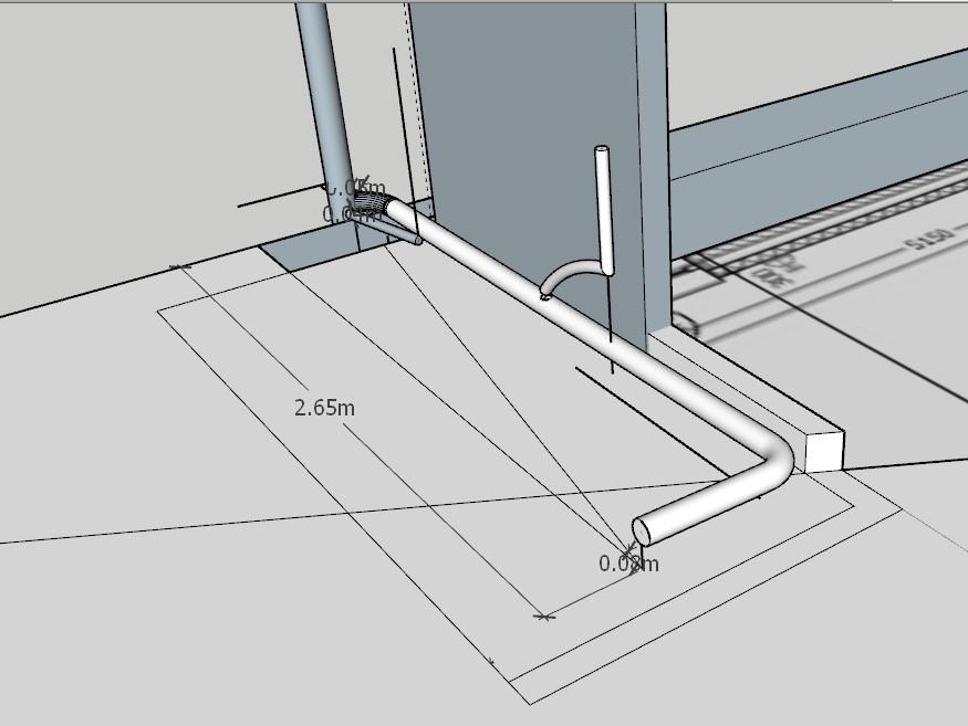

Ground floor WC/shower with external stack (top of floor plan). Need to get a clearer pic of fall, distances etc. That helps decide how low to keep the stack rest bend at the bottom. Got as far as the attached outline. Perhaps some obvious problems or solutions are being overlooked.

In form work to hold it in place? Or does it just stand on its own in a heap? And covering drain or just bed and bench?

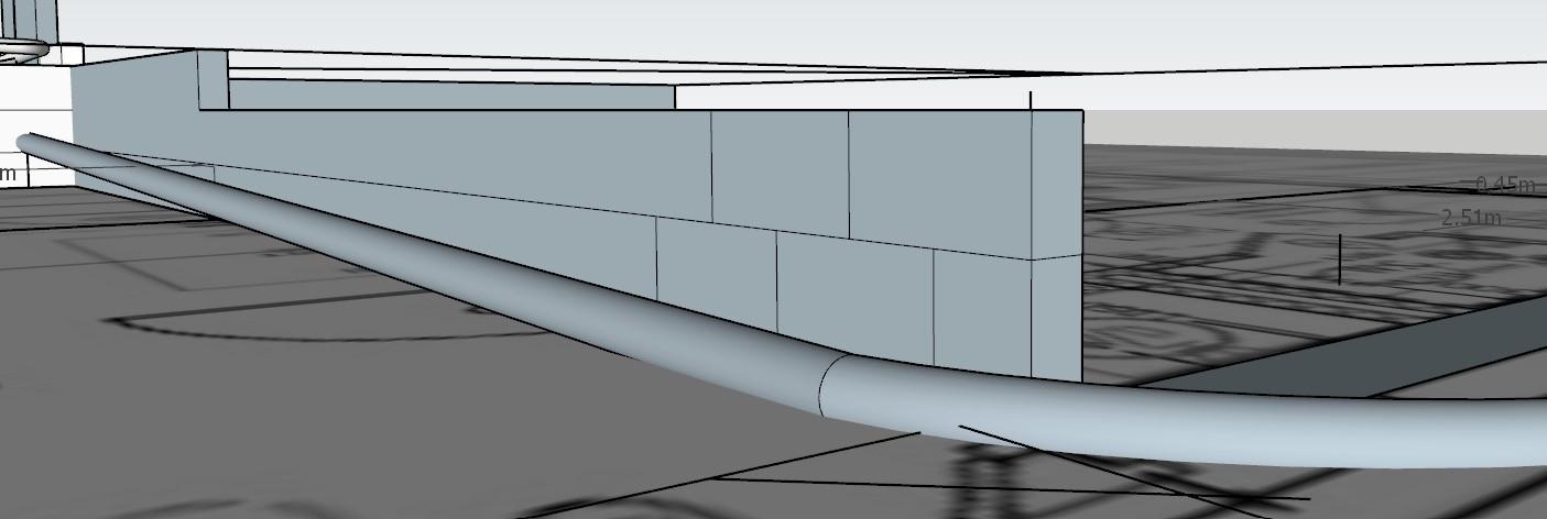

Yes, wondering how to hold the pea shingle in place. Option A is to build a stub wall on the footing (1 leaf of concrete blocks) parallel to the inner wall. Then pea shingle between the 2 walls to bed and cover the drain. Option B is to backfill the footprint with hardcore, compact well, and then excavate a narrow drainage trench above the trench fill footing. Then pea shingle in trench, bed and cover drain. Perhaps there is an Option C.
Underslab foul drain will run above trench fill foundation alongside internal wall. How to achieve bedding and covering? Perhaps lay another line of blocks parallel to the wall, for the purpose of forming a narrow "trench" in which the drain can be bedded and covered with pea gravel? If that's ok, how wide/narrow a "trench"?

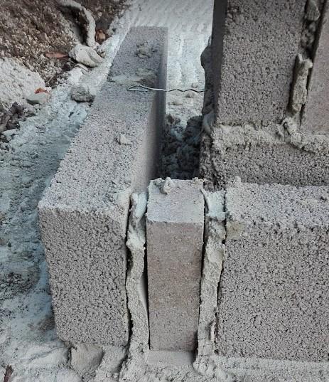

Saw this at a site. Foundation masonry. Does it matter that it looks like this? Will be backfilled on both sides and filled with concrete, I believe. Could the cavity walls be wobbly if these blocks move?

Thanks. Trench fill poured today, under the kitchen sink it is for the water mains entry. Hopefully will be able to run pipes (probably plastic) up and along the steel beam to supply the rest of the house. Including plumbing manifolds on (probably) upstairs landing recess, and boiler / cylinder in upstairs master en suite. That's bottom right in the first floor plan. Don't relish many holes in the ordinary timber joists
