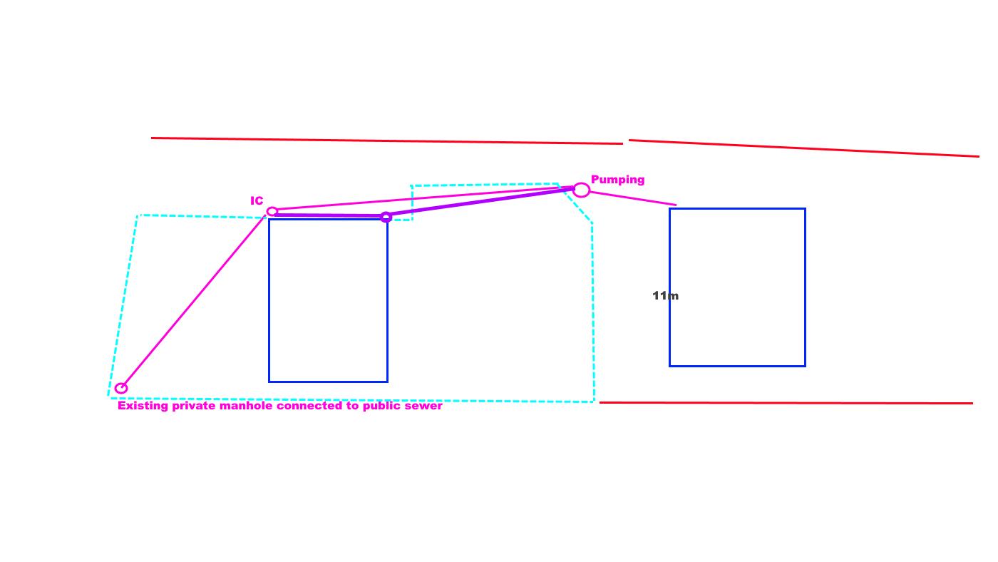

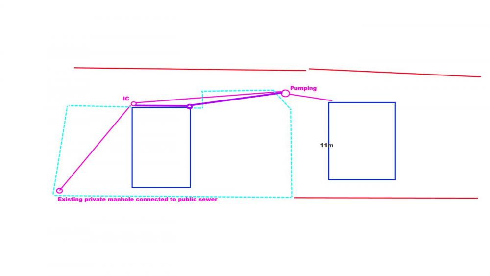

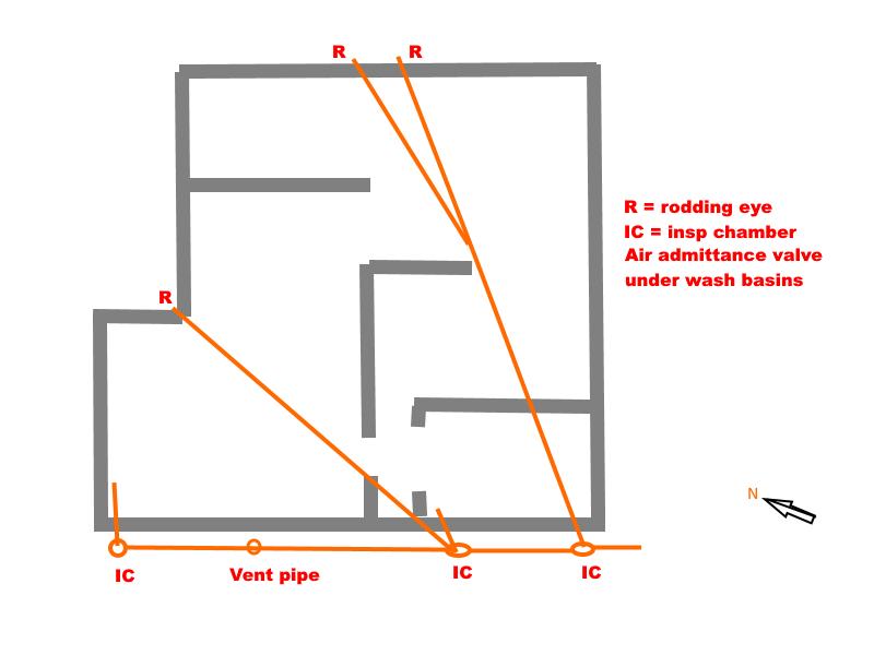

  9. block plan with drainage. Any obvious flaws?
  10. 5m from house SW corner to pumping chamber Any obvious flaws?

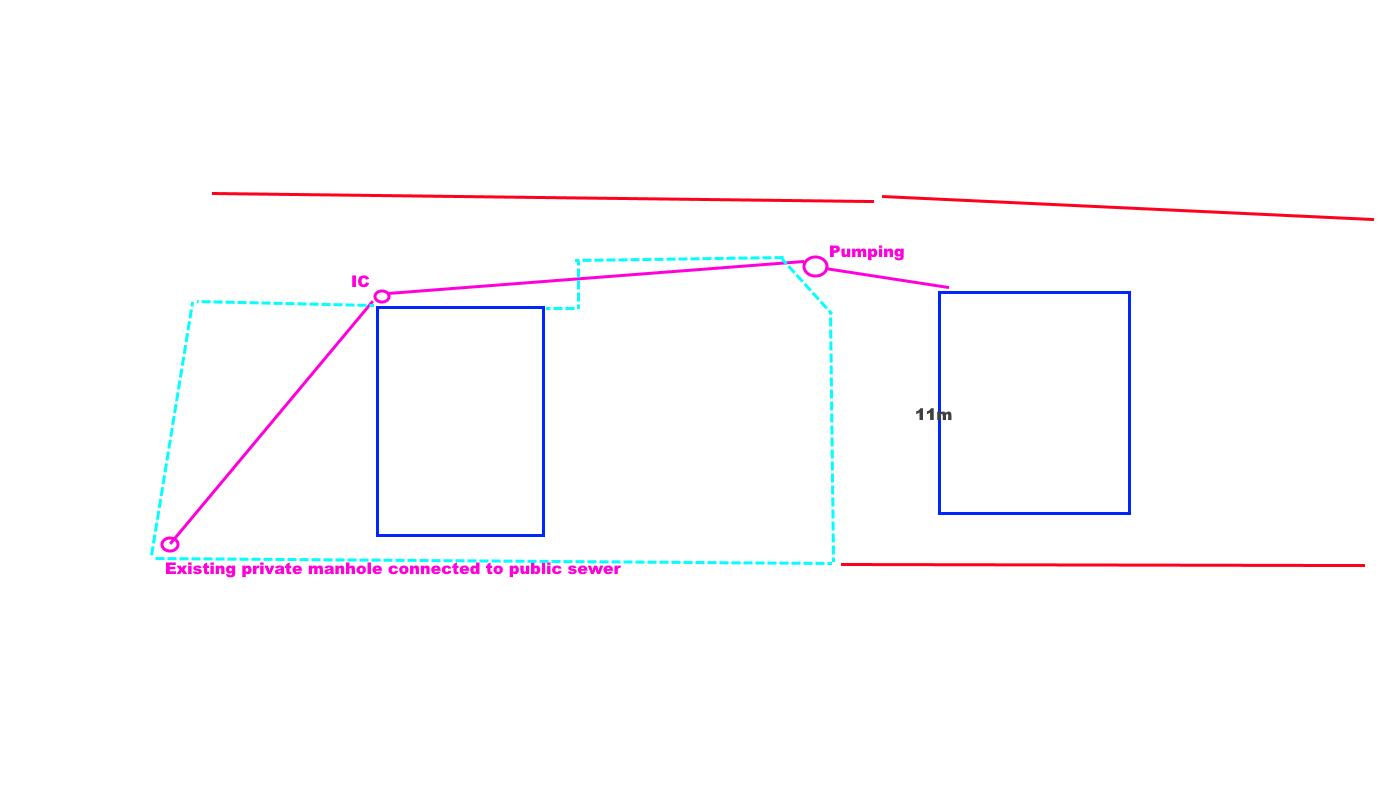

  11. Thanks, all. Was relying on stuff like this: https://www.nhbc.co.uk/binaries/content/assets/nhbc/tech-zone/nhbc-standards/tech-guidance/5.3/p261---tg-5.3---y-junctions_v1.pdf Rodding eye at one end, IC at other. One soil vent at east side. Air admittance valves in every bathroom/WC. Pumping chamber situated 5m from dwelling. Because discharge from pumping chamber would go under a drive, cast iron 100DN (instead of the black MDPE 90mm suggested earlier). Might that work, despite the concerns expressed?
  12. Is this foul drainage ok?

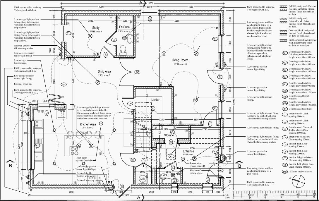

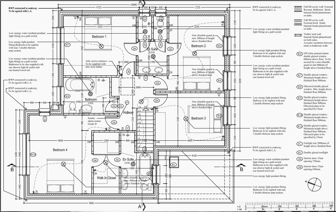

  14. Attic height too low for habitable room, but interested in having storage space there without overburdening roof truss beams. Any suggestions?

  16. Anyone tried constructionrates dot co uk? Any good? Any serious drawbacks?
  17. Noted. What they need they will get. No question. The decisions/options are about how to get it from the new dwelling to the existing manhole near the public highway. Once our preferred option is clear, the conversation with them can continue. They want our foul drainage to go south (up an incline) instead of north.

  19. Right from planning stage onwards. Trying to sort out preferred options at our end before next stage in the conversation with them. How about Pumping chamber to Relatively elevated insp chamber at NW corner of host dwelling to Slightly lower insp chamber at SW corner of host dwelling to Private manhole (appears to be relatively deep detachment chamber with vent pipe out of ground) nr public highway
  20. Yes, this has been the front-running option. Longer distance and needs to cut across front garden of host dwelling, hence exploring whether east side is feasible. Presumably inverts for west side need not be 600mm below ground. Would you pump to near NW corner of host dwelling and then rely on gravity for the rest of the way to the manhole nr the public highway?

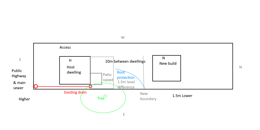

  21. Schematic diagram attached. How to get the foul drainage of new dwelling N to the existing drainage without disturbing the tree? Under or over the roots? Trying to picture over the roots, along the Eastern boundary. MDPE on stilts? Something else?
  22. Challenge is posed by the drain from the pumping chamber of new dwelling to the existing drain of the host dwelling. Part of the root protection zone intervenes. Routing the foul drainage from the new dwelling either under or over the root protection zone might work. But how exactly?
  23. New dwelling in rear garden of host dwelling. Land slopes down towards rear. Foul drain to go from pumping chamber of new dwelling to existing drain of host dwelling. Problem: root protection zone of a tree enroute. Any suggestions for how to cross the root protection zone above ground? Height difference about 1.5m. Probably less if invert of existing drain is the reference point.
