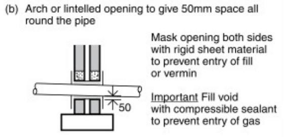

Thanks. 120mm width of opening where 110mm drain will pass under lintel from underslab to exterior, while resting on/just above concrete footing. Footing continues horizontally for 600mm external to wall. I suppose there will be a channel drilled into the concrete footing to form a haunch for the drain. Still a risk of movement/pipe breakage? If so, can make an issue of it Measured the openings under lintel, on either side of the partition wall. Left side 140mm, right side 170mm. 210mm would meet BR
Probably best to send the builder the BR text and diagram and leave it to him to decide next steps. Done that
Thanks. To push or not to push the builder re enlarging the space around pipe. Main consideration is whether the drains will function properly despite the narrower gap
Trying to assess how hard to push the builder. Lintelled opening 120mm for 110mm drain. In other respects good builder, but is resistant to redoing the opening. No backfill around foundation masonry there, yet.
How important is the BR 50mm gap all around the drain where it goes through a wall? Is anything less than 50mm seriously unsatisfactory for us to live in? BR approved doc H 2.24, diagram 7b

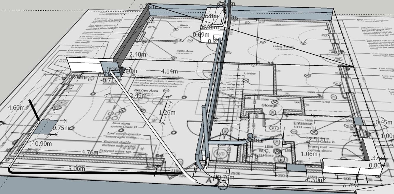

Longest underslab drain approx 11.25m Not too difficult to set its origin in the wall a bit lower than the existing. The exit from the opposite end of the footprint can be lowered by cutting concrete as suggested. Shalloduct is reputed to allow less than 750mm depth for water pipe https://www.bes.co.uk/shalloduct-water-service-pipe-insulation-835-x-32mm-19170/?gclid=Cj0KCQjw1dGJBhD4ARIsANb6OdmKISJLneP8bQfbEhDyABYg_nZDqb-ZvNFO6S_2zzFnjUNXHelrD4MaAjQjEALw_wcB
Cutting concrete for drains makes sense. 2 courses of concrete block (3 for inner) put in already around most of the perimeter. Conduit under concrete already in place for mains water, but that involves a circuitous route. Considering shalloduct and bringing the water in nearer where the services reach the footprint.
Just at the stage of foundation masonry being laid atop trench fill footings, with lintels in the cavity wall to allow drains to pass under slab. Not too late. It may be that the trench fill came up too high, relative to the permitted finished floor level (long story). Will know for certain by measuring level difference from a survey AOD reference point that has just been discovered. Not certain that the permitted ffl will require any lowering, but looking for ideas just in case. If & when there is a need to lower the ffl, what is the simplest way to do it? Would be good to keep a 1 in 40 drainage fall across 11 m width of footprint. Thickness from underslab sand blinding to flooring top surface is 317mm. Includes 50mm sand blinding at bottom and 65mm screed with under floor heating. Perhaps a channel could be drilled in the margin of the (deep) concrete footing to form a haunch for the lowest part of the drain? Alternatively, if the difference is small, perhaps switch to 40mm liquid screed that can take underfloor heating. And switch from 50mm sand blinding to 30mm?

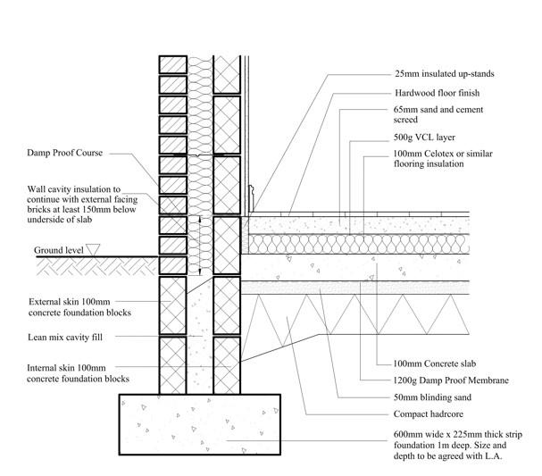

Thanks. What would be the U value difference for the perimeter upstand + inner leaf only please, aircrete vs concrete? Probably a negligible point, but interesting to nerds like me. The mortar of the inner leaf probably offends as much as anything else.
Thanks, great advice. Would increasing the overslab insulation from 100mm to 150mm (Celotex lambda 0.022) be a cost-effective option? Need to watch the budget. Noticed that heat escapes downwards through the inner leaf. Does Passiv standard recommend insulation horizontally to reduce that? Probably trivial loss in the larger scheme of things. Also, does anybody add internal insulation just above the usable wall area only?
Noted, tks. Not Passiv standards. Ground floor UFH, very unlikely to have carpets. Does the concern about 50mm perimeter upstand remain? EPS is said to be more compressible than PIR, allowing the screed to expand/contract.
Agreed solution. 50mm thick upstand, and for pragmatic reasons (materials onsite already) to continue with 7N concrete blocks for third course above footings. Point about underfloor heating leaking into cavity accepted. Aircrete is said to suck in moisture too, so concrete below damp proof course is preferred by builder.
