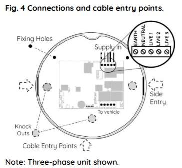

One EV charger supplier provided this Figure. Instructions say "Ensure that incoming cables are connected to the appropriate terminal as follows: Earth: Green/Yellow Neutral: Blue Live 1: Brown Live 2: Black (three-phase units only) Live 3: Grey (three-phase units only)" Over the phone the advice was that 32A was required. An example installation guide here: https://s3-eu-west-1.amazonaws.com/podpoint-website/PP-D-130012-15-Solo-Smart-Charger-Install-Guide-1.pdf Question: Is it useful to ask the DNO to connect power to all 3 cutouts, even though all 3 supply cables are on the same phase? EV charging is the intention. -

As a layperson with no knowledge, it looks as if 3 power supply cables are going into the innards. They are 3 different phases. Is it possible physically to replace those supply cables with others that are identical in all respects, except for being on the same phase? -

Does it make sense to have 3 "same phase" supplies to the "3 phase" cutout already installed by DNO? That would enable connection without extra costs. -

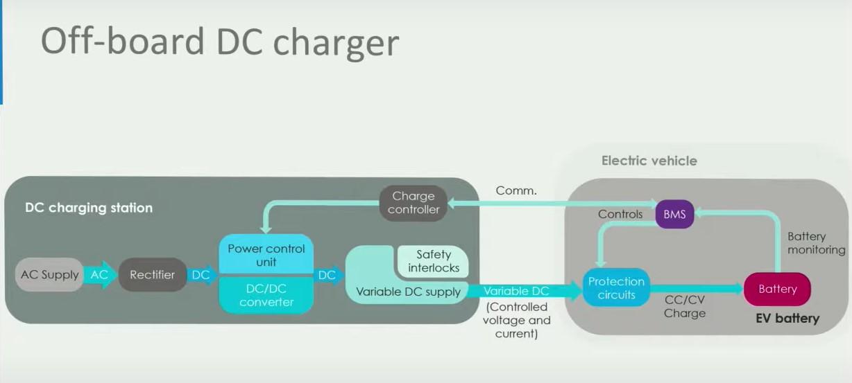

plus there is this: https://go.ads-tec.de/en/hpc/dispenser#intro Claims ultra-fast charging without needing to upgrade electricity supply, afai can tell -

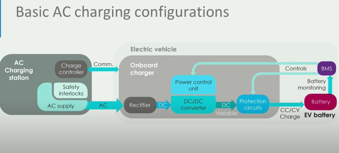

Alternately, if a dual phase 46kVA supply is connected to the cutout as contracted, will a single phase (presumably 23kVA) suffice for fast charging (22kW)? -

Found these. But what do they mean? If the DNO connects 3 cables to the cutout, all 3 cables being the same phase, can that enable fast 22kVA charging of electric vehicles? -

Nobody knows less about this than I do. But it sounds very promising. Might it be that the DNO can simply connect the 3 same phase cables to their cutout, and that would work for fast EV charging? That would be great -

Fast EV charging Would phase converters cost several thousand pounds?
