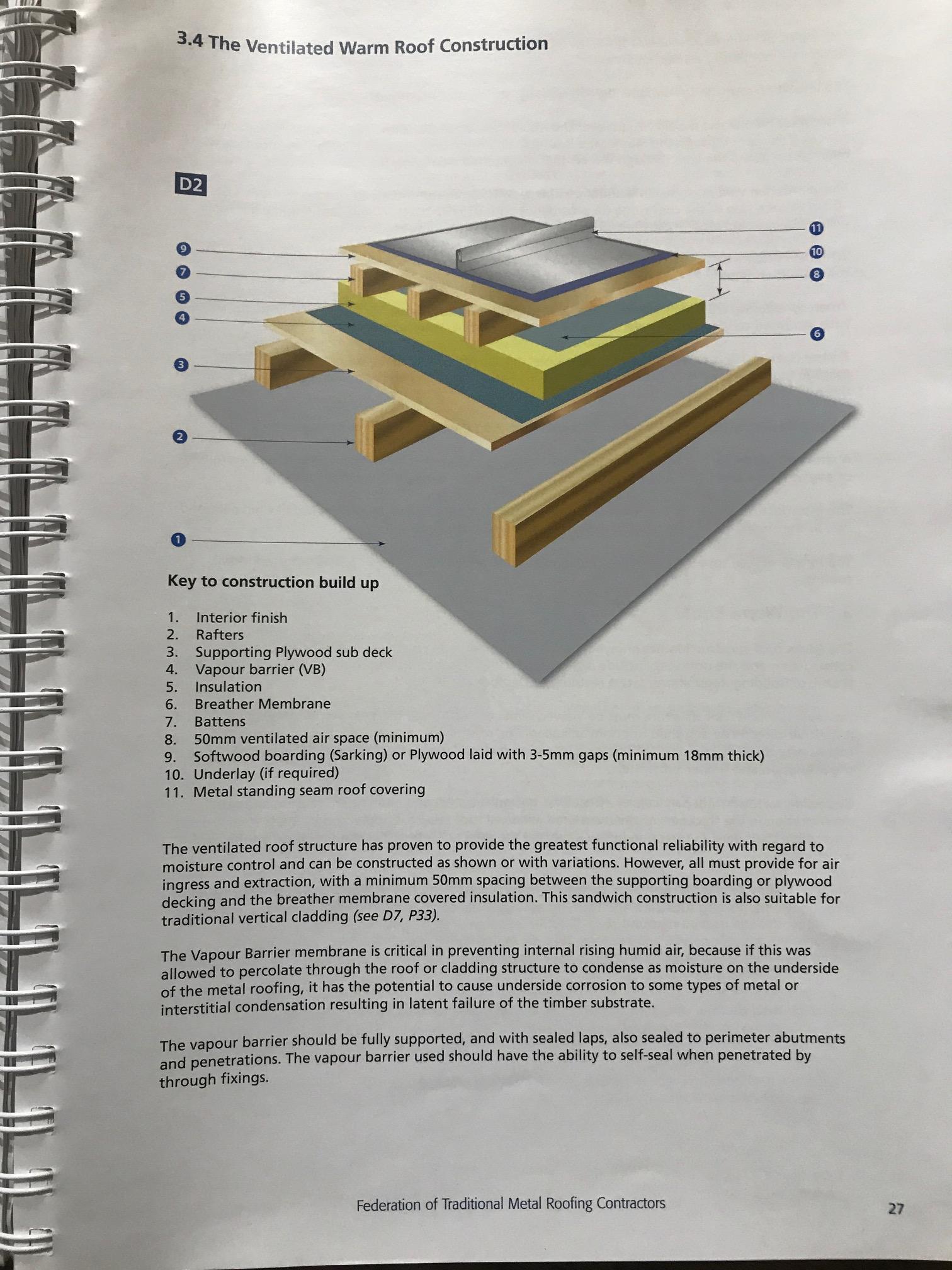

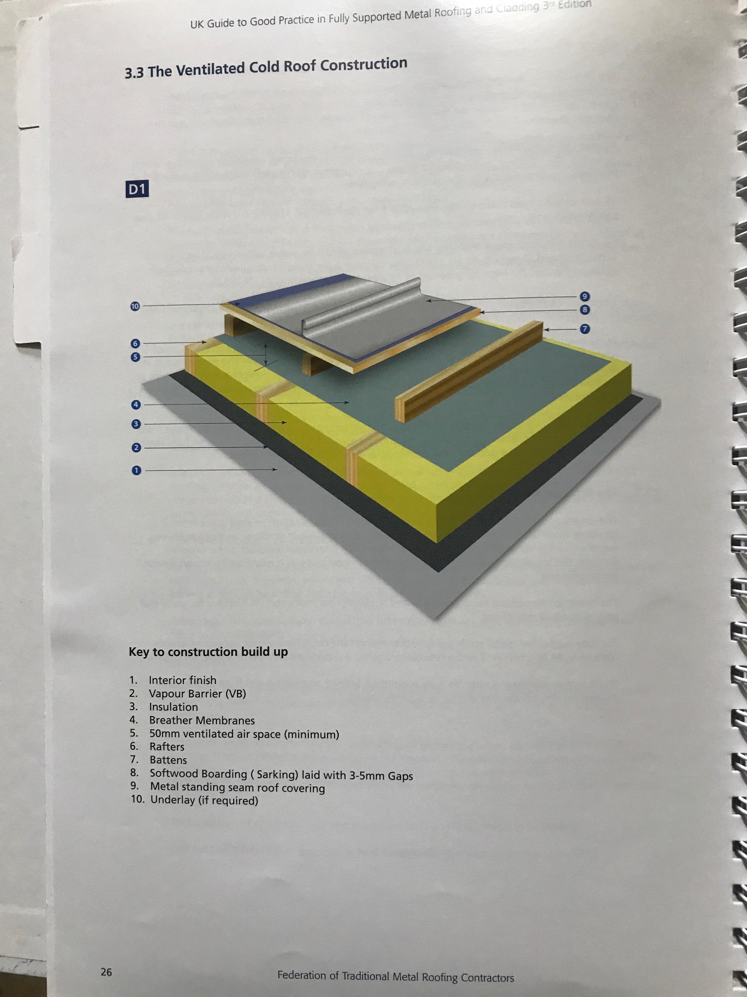

I'm sure it does prevent pooling and build up of condensation against the zinc and as it lets it run off the roof it's got to be a good thing. The membrane I recieved with my coated steel has a fleecy backing to it but more normal fibre weave on the top. Yeah, I agree it's really weird. There are certain types of warm roofs covered within the guide to good practice, but these tend to be warm roof systems, for example WarmFast, structural insulation board or composite metal faced insulated panels. In most cases however, there's a big emphasis on the number of fixings that penetrate the vapour barrier. As such in these cases they recommend the metal roofing contractor is used to fit the whole roof substrate. So the concern is definitely about moisture ingress as I quote from the manual on warm roofs: "The vapour barrier must be fully supported, self-adhesive, bitumen-backed aluminium foil sealed at the laps, to perimeter abutments and around penetrations. The vapour barrier must have the ability to self-seal when penetrated by through fixings.....Unless a Composite Panel System with cellular glass insulation is used, there is a risk of failure, most often caused by the vapour barrier not being laid and sealed correctly thus allowing eventual moisture ingress....no means of escape and therefore condenses and corrodes the underside of the metal or denigrates the timber.....This can particularly be the case with a structural warm roof installed by a generalbuilding contractor prior to the specialist metal roof installer's arrival." It also differentiates between vapour barrier and vapour control layer, how and where they should be used. Whoever wrote this doesn't have a lot of confidence in general building contractors either it seems! Under these circumstances it does seem sensible and easier to simply build in a 50mm ventilation space at least for this type of roof.
That's funny stuff, for a moment I thought it was just bitument felt with a fleece backing! Looks like your roof was the size of a football pitch ?
It looks like it in the pic, but spec says 50mm just as with the cold roof
I can only guess it's down to risk of condensation behind the metal, but perhaps because of the riks of corrosion, there's a bit of a hedging against crap vapour barrier installation.
I got a strange feeling when I saw this thread as I was sure there's something wrong about warm roof build up and zinc standing seam. So I dug out my UK Guide to Good to Practice published by the Federation of Traditional Metal Roofing Contractors. Low and behold it recommends against using an unventilated warm roof buildup - or shall we say it diplomatically suggets to approach such a design with caution, especially with materials like zinc. So definitely listen to your roofing contractor, not your designer. The recommended design for a warm roof actually includes 50mm ventilation below the plywood/osb deck supporting the standing seam. Instead of writing and quoting loads, I've attached pictures of the pages so you can see for yourself. If you need any further details, let me know. HTH.
