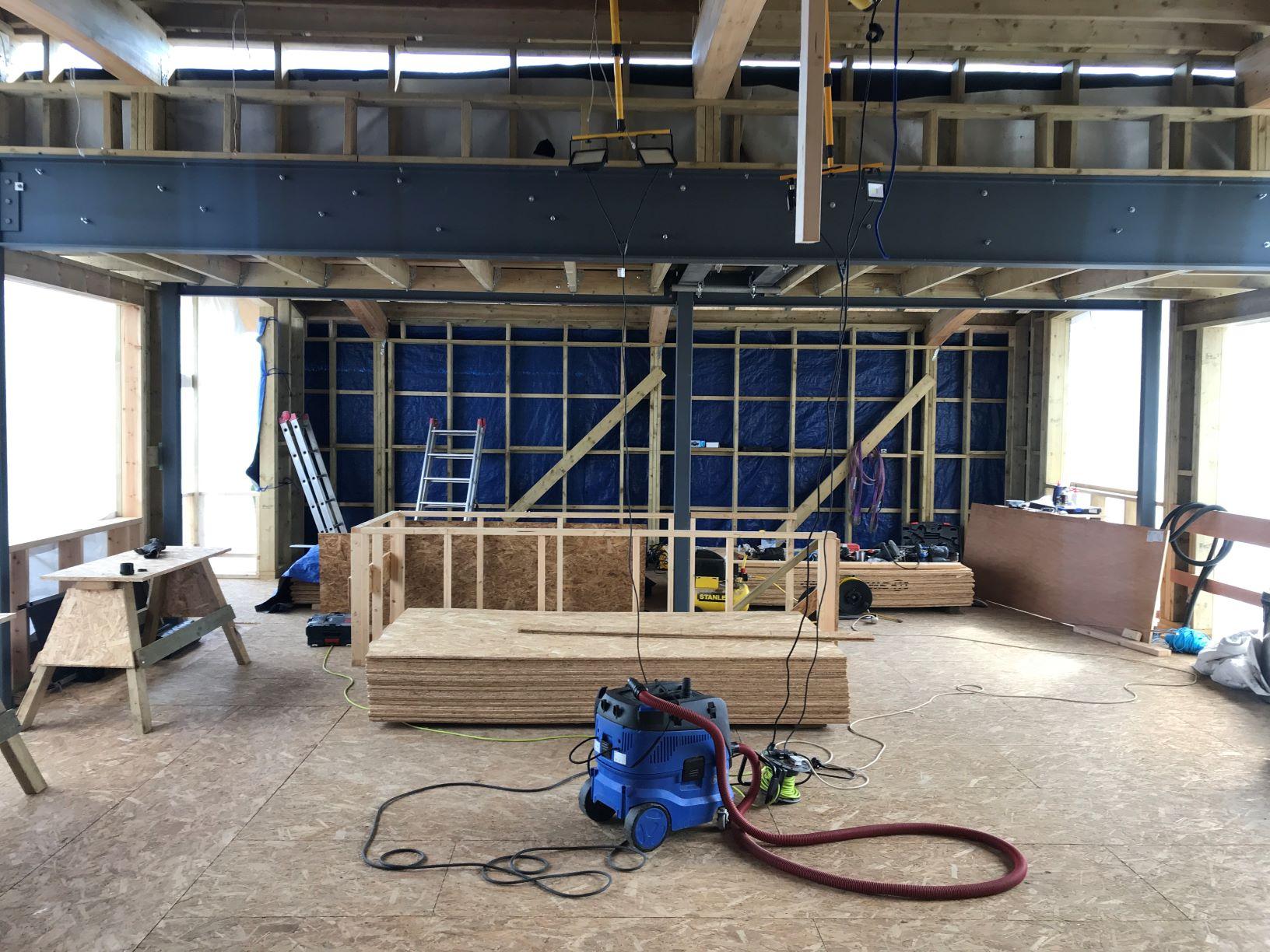

I've got OSB3 tg4 sub floor installed across the floors of my house. I'll be installing three bathrooms and one utility. When reading the BBA certificate for the OSB subfloor (did I really do that? Is that a sign of a newly acquired self-build abnormality? ) it says that when used in bathroom and kitchen areas the osb should be tanked before putting in the finished floor. Now, I was a bit surprised by this given this kind of osb's propensity to deal with moisture - it even survived several months of outdoor exposure and a lot of rain without any issue. (also surprised as I'm yet to find a bathroom installer recommending this kind of practise in a normal bathroom) So, given this product's suitability for use in moist environments, occasional wetting and even 'occasional' exposure to weather during construction, is this tanking suggestion mere overkill or something I should take seriously? (if I'm building a wetroom, which I may do, I'd obviously be tanking the thing). Thanks!

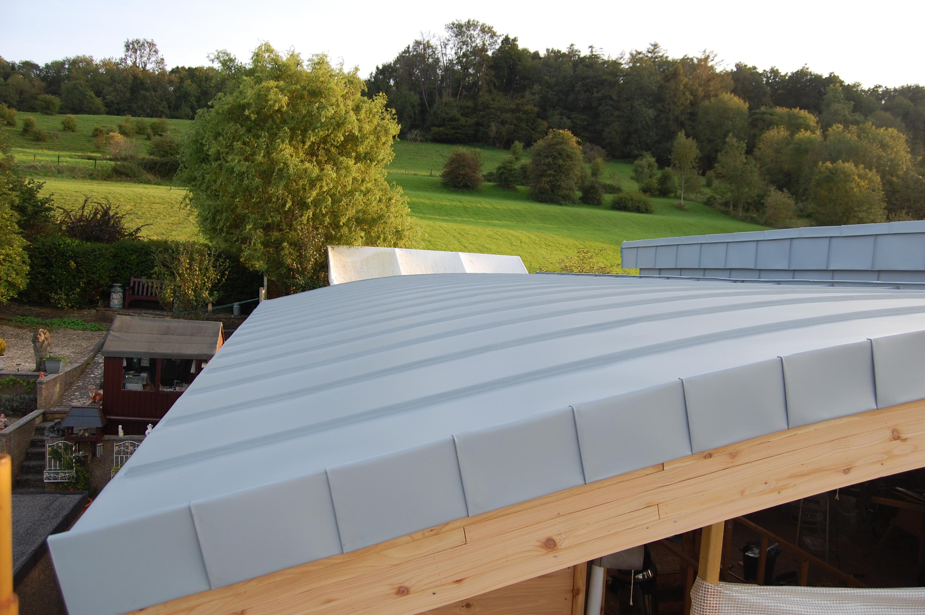

Mine were 600mm trays formed from 670mm wide coils in traditional 25mm profile - every little helps when installing on large surface with hand seaming tools ??

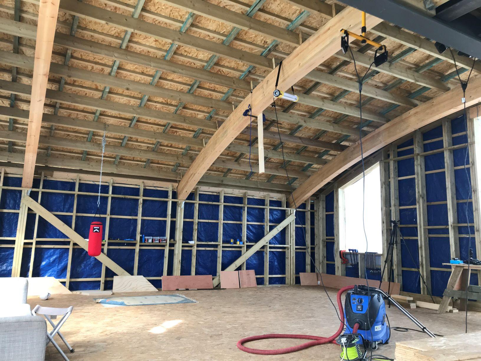

Sheeps wool works brilliantly in a garden office. I repurposed an old summer house for our temporary office while building the house and insulated it with 100mm of sheeps wool in wall floor and roof. My wife works in it every day and feedback it that it provides an incredibly comfortable environment, summer or winter. During two winters, used every day of the week up to 12 hours per day there's never been a drop of condensation in the space. I'd use it in preference to the celotex/kingspan stuff any day ? The wall buildup is similar to a standard 'breathable' wall: Inside: Finished internal wall (whatever you prefer like plasterboard, plywood or some other panelling) I chose just to stick with the below 11mm OSB. Service void (optional) 11mm OSB 3 (ideally taped at the seems but mine wasn't at the time) (osb acts as the vapour barrier but is hygroscopic so it allows the passage of moisture through the fabric of the building) Sheeps wool insulation between battens and studs (if you have the space, then an extra layer of 50mm or more outside the timber frame works better - reduces cold bridging more effectively than extralayer internally - see Trada research for this) Breather membrane Ventilation gap Cladding With mine I took some shortcuts in just putting the sheeps wool into the old frame right up against the original cladding. Because of the nature of wool to buffer moisture, it has been fine, but for proper permanent build, I'd used the above buildup, which is what I'm using for my breathable walls and roof in my new house. Last I look at prices, sheeps wool was cheaper per sqm than the wood fibre but that may have changed. Below is a photo of the same buildup going into my new roof. Hope that helps

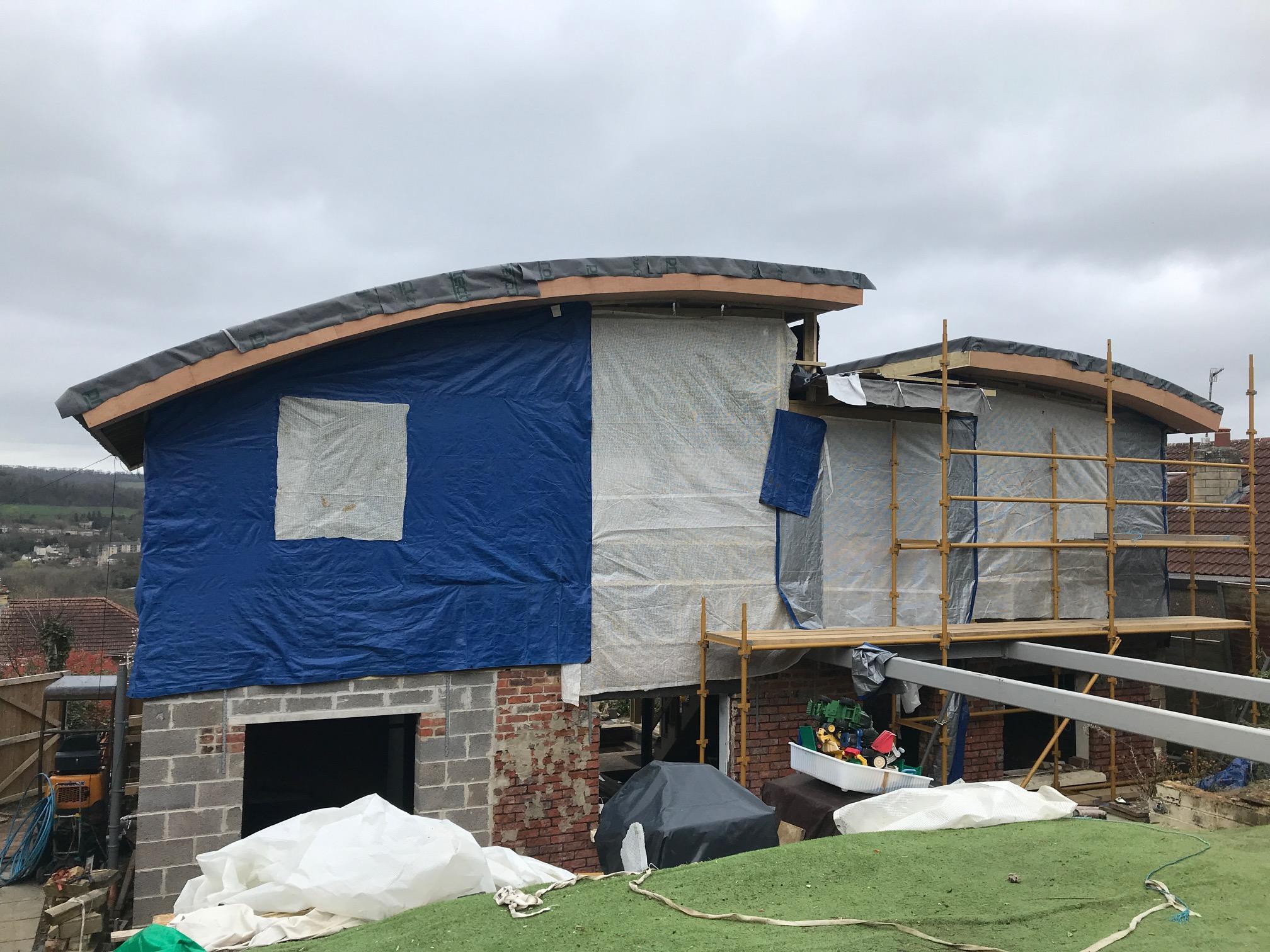

If it's any consolation I had a Protec membrane on my roof from December through to the beginning of May this year. It survived the February Storms including 70mph plus winds. Just make sure it's sufficiently lapped and battened down against uplift and it should be okay if you have a decent roof pitch. (Mine wasn't even battened down but stapled to the OSB and I just had minor leaks at the top of the curved roof where it's almost flat).
Looks nice. I had dealings with Metal Solutions and they were helpful, offering to fabricate and pre-form everything for me too. I also bought a load of the metal roofing tools from them. I didn't buy from them as I needed a bit more support due to my roof buildup and that I had no idea what I was doing at the time! It looks like you have narrower profiles on yours? Mine were 600mm centres, are yours 530mm?

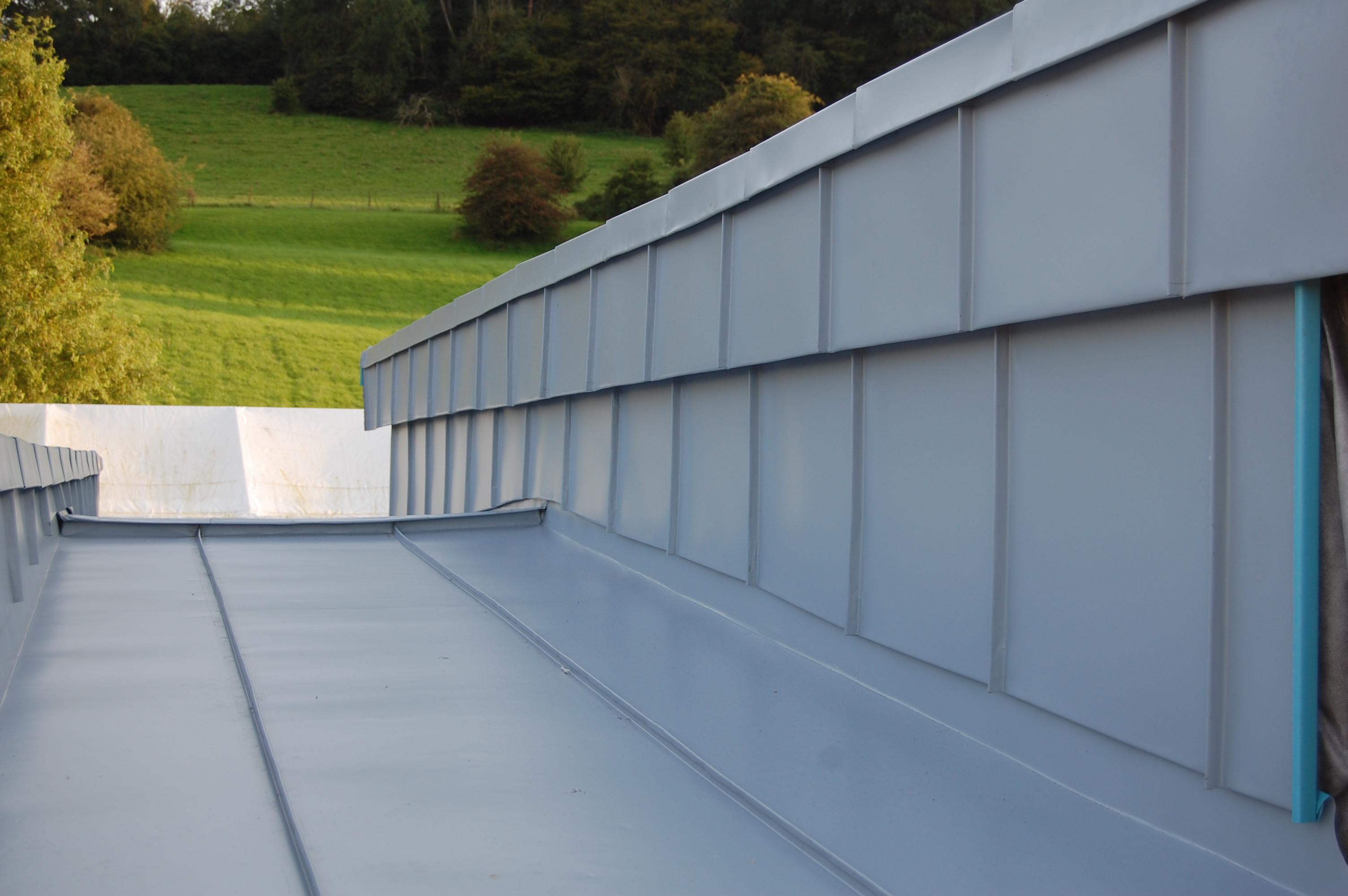

I've just installed a traditional standing seam roof on my build, but because I have 2 curved roof sections, I had to form, cut and fold the entire roof myself on site. The products like Bradclad are simpler. They need to be fully supported and use the hidden clip systems so you don't run the same risks as the typical profiled sheets you see on barns that have the exposed fasteners and rely on rubber seals on the exterior etc. These companies will provide you with pre-formed pans for the width and length of your roof and the will also provide all the flashings pre-folded too. The flashings, clips and brackets make up for a surprising amount of the materials. There's a couple of other companies out there that provide the preformed 'kit' type standing seam roof. Tata Steel's Colourcoat Urban is one ( I was going to use them but backed off when they massively hiked the price for me and trying to have an adult discussion with them didn't work). Metal Solutions, UK distributor for the SSAB Greencoat PLX Pro BT provide them in all manner of finishes from Zinc, to coated steel to coated aluminium. If you wanted to go down the more hands on traditional forming, I'd highly recommend talking to the Metal Roof Company (where I bought all my supplies from in the end) who will also get you in touch with a local metal roof specialist. The last prices I got for the pre-formed versions of this kind of roof were back in March: Greencoat PLX coated steel at 530mm centres was a little over £12 per linear meter ex VAT, but then you have to add costs for flashings which vary according to girth as they're cut from a 600mm wide steel coil. On top of this you'll also need sliding and fixed clips, installed at about 220mm centres around the verges, ridges and eaves and about 380mm centres across the rest of the roof (but this does depend of wind uplift forces for your roof). This obviously doesn't include installation costs either. Specifying this stuff isn't straight forwards! They work well with Velux and any other upstands across the roof. I think these roofs are gorgeous and worth the effort mind you. Hope this helps and do let me know if you'd like more details.

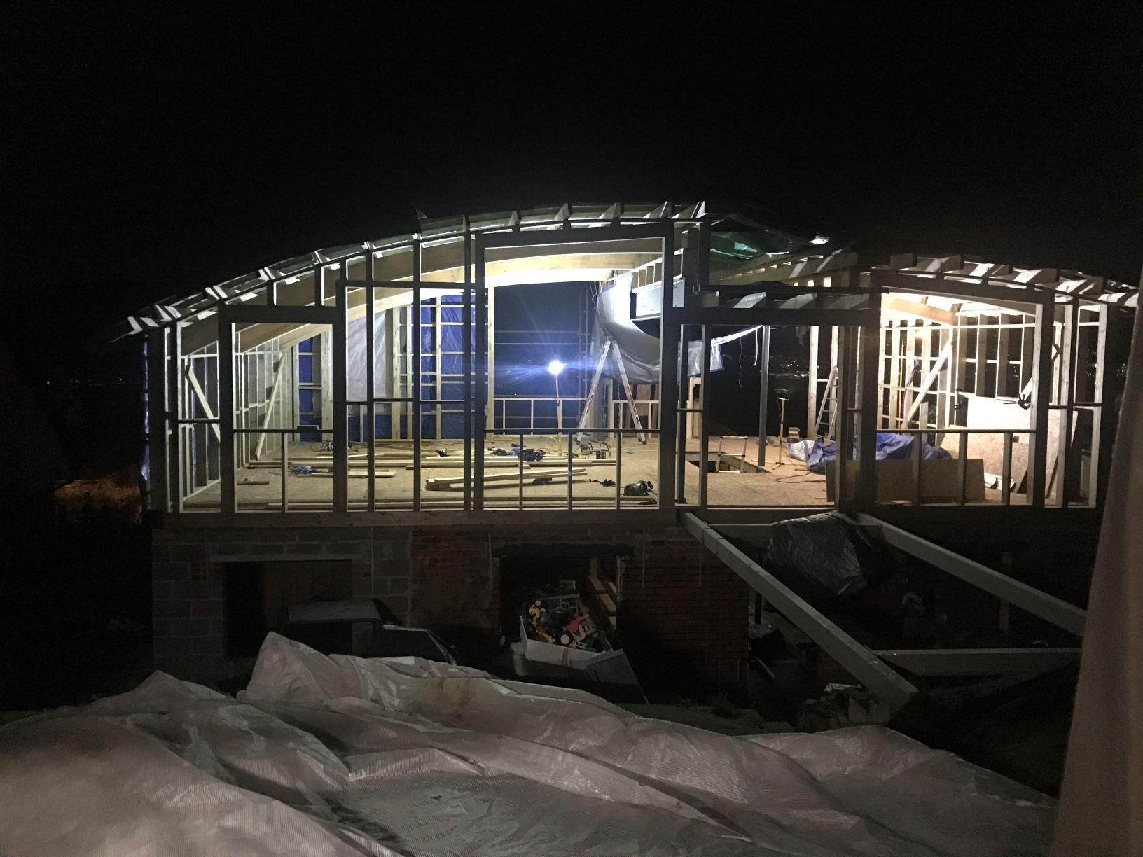

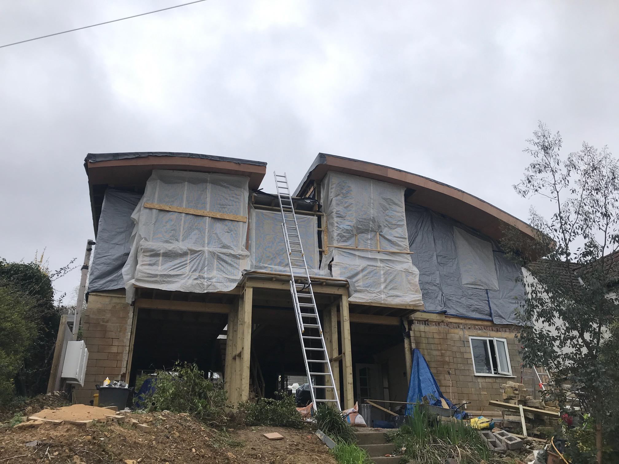

Hi, as a new member, I'm just introducing myself to the forum. I've done a bit of lurking on the forums on the odd occasion as threads have come up in search results for me over the last year or so and I finally thought it was time to actually join up. I've been building a house on my own. It's part renovation/conversion, part new build with a total area just over 200sqm. The renovation/conversion is 1920s brick & brick, and some brick & block, or shall I say what was actually left of it once we scratched beneath the surface of the structure - all soon to be covered in woodfibre EWI & lime render. The new build part is mostly timber frame but a bit of a hybrid with a substantial steel structure amongst the glulams. The timber frame is all filled in and wrapped in sheeps wool and to be finished off with timber cladding. It's all built as a fully breathable wall system. Roof is now on and I've just ordered the windows for delivery early December all being well. I've never done this kind of thing before so it's been a major steep learning curve every single step of the way. It's been gruelling, interesting, and a but if a pig of a project because it has two curved & vaulted roofs with some flat roof in between. The architects detail drawings were all rubbish so I've had to work a lot of it out myself. Oh, and it's been fun too in parts ? Covid has, like for many, taken its toll in terms of progress so I'm well behind on my timeline, (the rain and storms last winter didn't help much either) but I've at least just installed the roof before winter and now getting the cladding on too. Much to do still but I've attached some pictures of the build.
