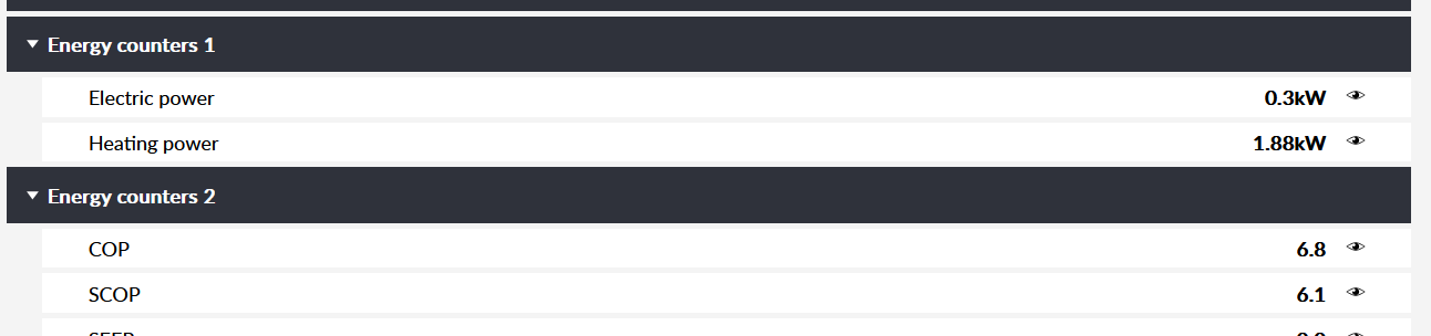

Interesting couple of days with the new heat pump.
SimonD replied to MikeSharp01's topic in Air Source Heat Pumps (ASHP)
Obviously your flow rates & dt need looking, but also be very patient. I commissioned a new installation at the beginning of December that has very thick stone walls and had no heating for 3 months. Initially I thought I'd messed up the installation, but it's taken until the last week or so to find its balance. This is todays: This is what it looked like just after installation: -
