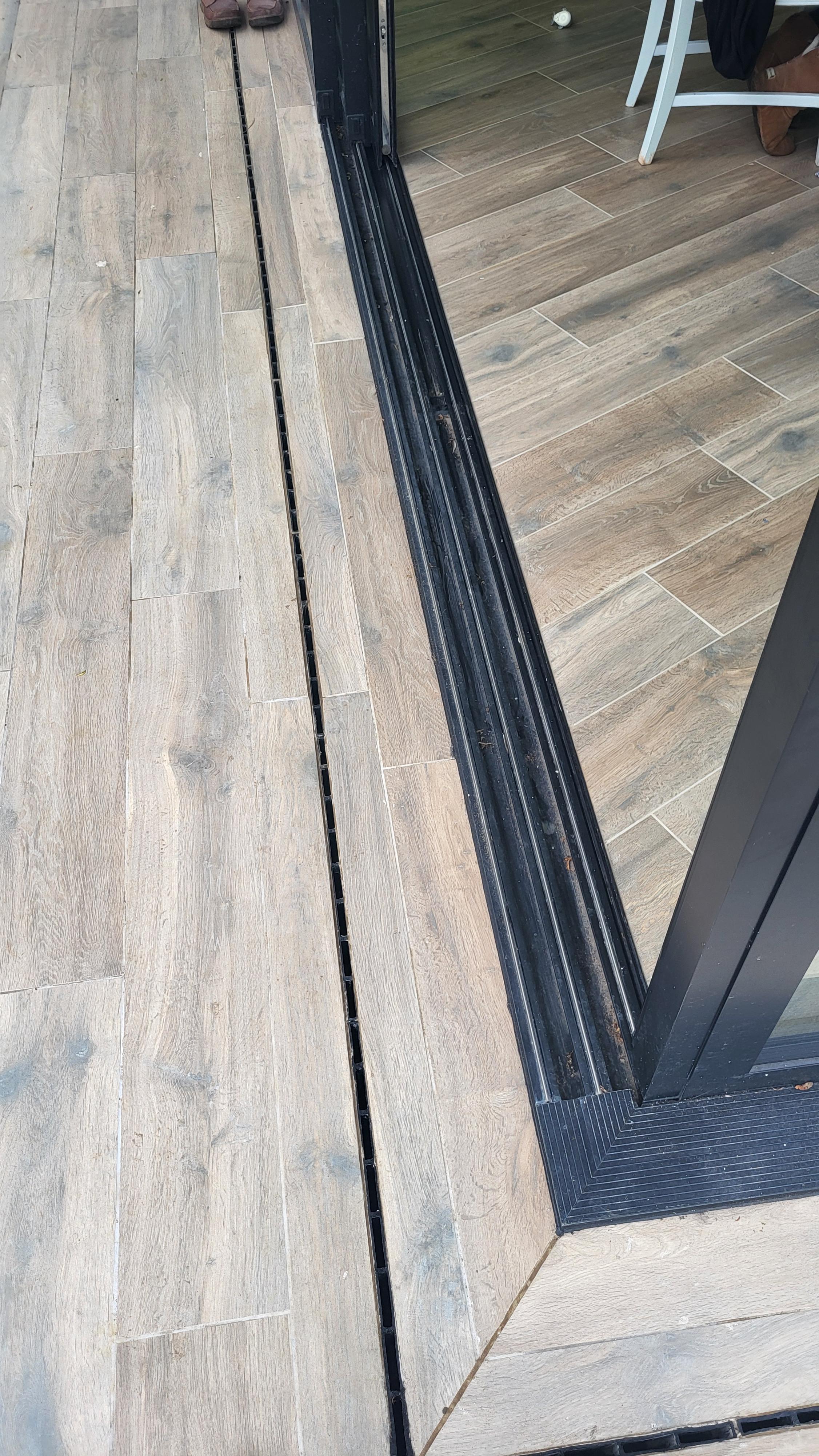

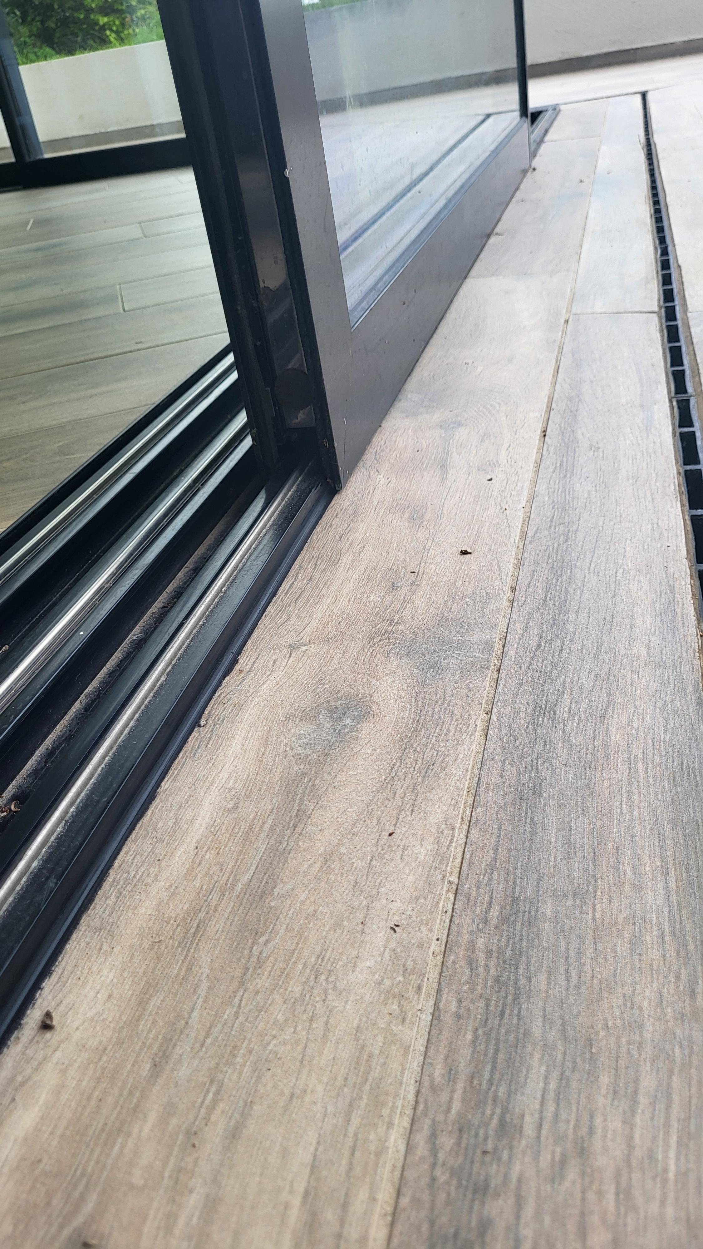

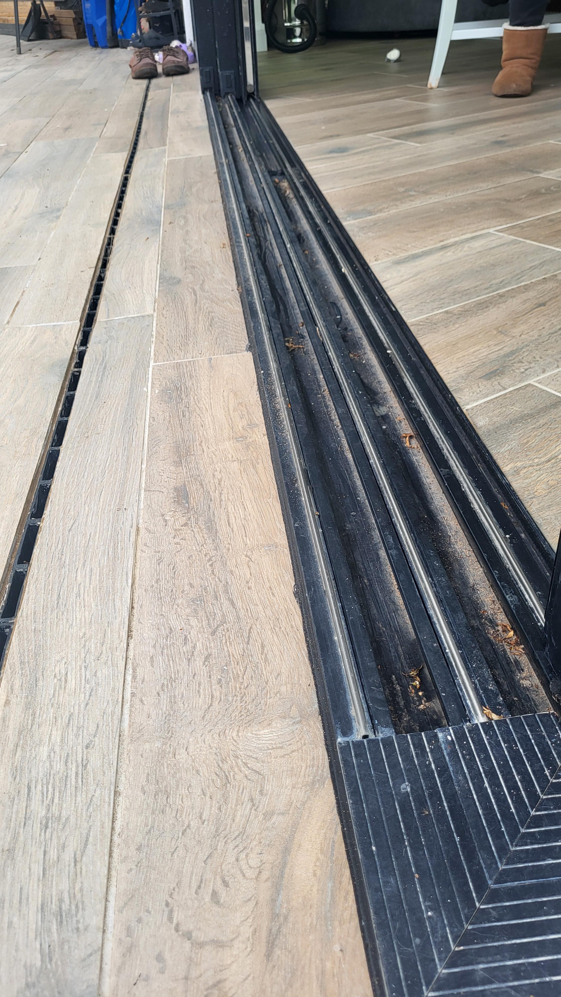

Yeah, they were finalising a bolt on part or something to enable flush fitting last year when we had ours installed, but couldn't afford the delay to wait and see. With the channels the doors sit in, you naturally step over it all and 20mm, isn't noticable unless looking at it. For us it also acts as a final 'fail safe' for water flooding/pooling risks in driving wind. If your panel is fixed could you not tile tight to it, and have flush tiles, then a thin bead of black silicone round it all to hide minor gaps?
Issue we created was having our sliders able to slide both ways meaning outer sunflex panel forced us to sit the tiles down 20mm due to the lip the door created, meaning not truly flush, was annoying but again... Soon forgotten!
We had exactly the same with our sunflex, blue brick step out. Pic below is what we did. Set back a blade drain, enabling tiles either side of it. Not as surgically attractive as it could have been, but soon Iver looked....
