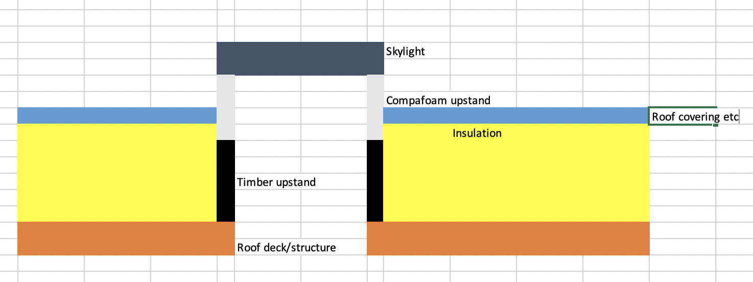

Wouldn't you do this. To get the levels where you want them? Doing mine again I would miss out the GSE flashing and do lead instead
