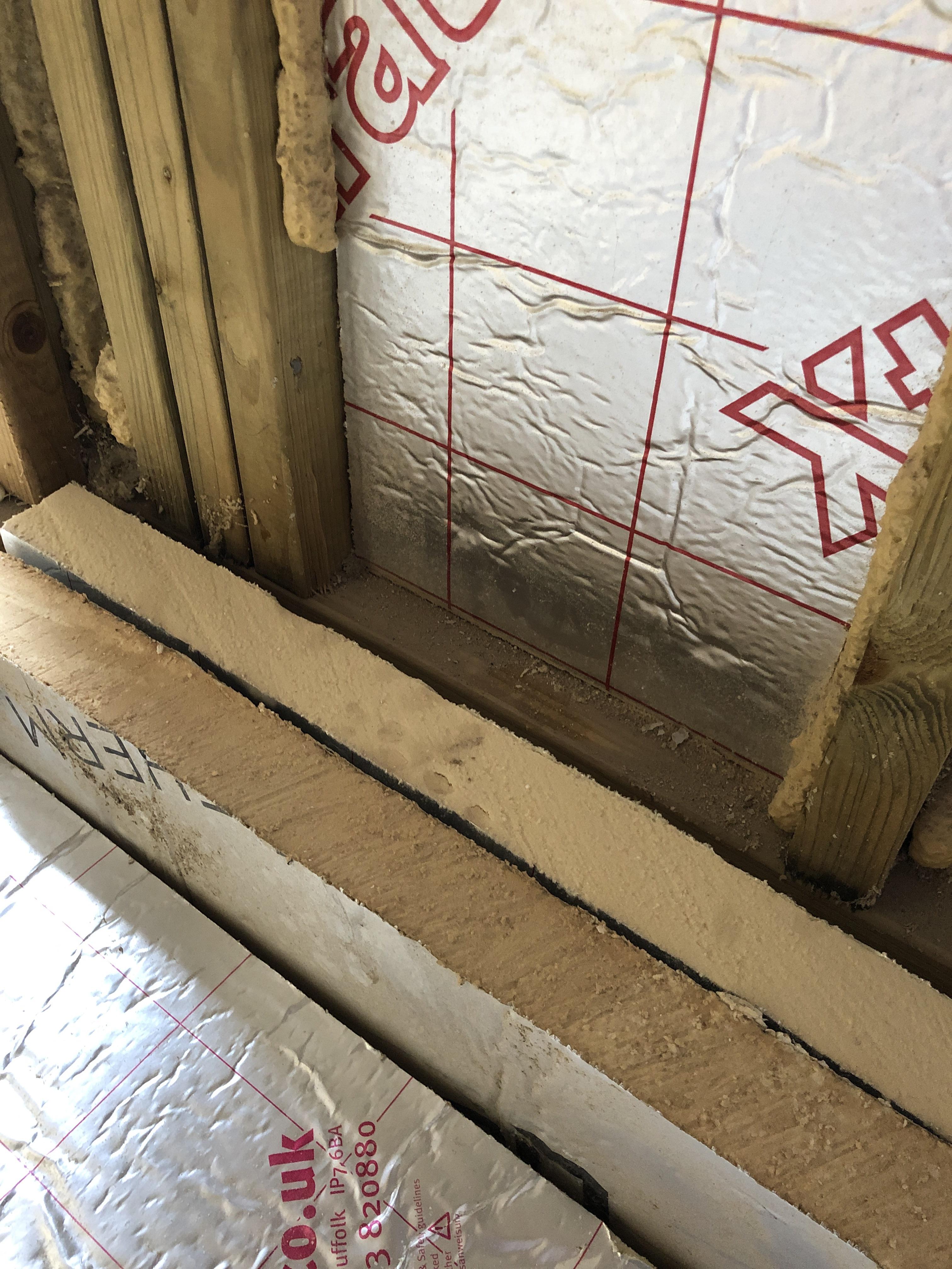

  23. I THINK I may have found something. Ordered some Dye to prove it. Here's what I think is happening... Today I decided to hose down the outside of the lane wall - underneath was damp and showed water track marks as usual. Someone turned up - so I stopped hosing and spoke to them for 15 minutes. I then went underneath and it was I THINK far more clamy and damp on the ceiling. Whilst all track marks (apart from 1) seem to go to the edges and the water appears to come in above the original slab and in the 'void' i.e. where the insulation is ; got me thinking.... The below ground blocks etc. were all poured as one. But the 100mm slab and 35mm reinforced concrete were done after. What's to stop a hairline crack being between these separate pours? . There's no detail in the architects design for this. But at the edges what stops water getting 'in-between' the layers?
  24. To be honest ( from memory ) i’m Fairly certain that corner has always had that fault and track . Tried to find an old photo but couldn’t . I’m 99% sure the corner ‘leaked’ when just the slab was down . Obviously as I had holes everywhere I didn’t worry about it
