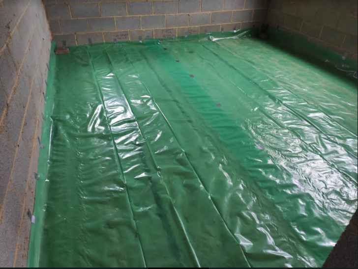

Anchoring studding sole plate to concrete
MortarThePoint replied to MortarThePoint's topic in Timber Frame
This is great news. Blue Peter taught me how to do that sort of thing years ago. -
I was thinking it would be anchored to the walls at its ends using L-brackets or welded on flange plates. -
I'd be happy to, but I still need a plan ? -

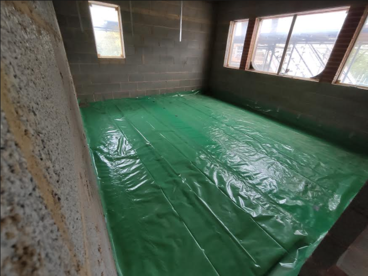

The vast majority of my walls are blockwork, but I wanted some walls as timber studding for the benefit of possible reconfiguration. None of the studwork walls is structural. We have precast concrete on GF and FF, insulation below the concrete. Anchoring the studwork wall sole plates on the first floor (FF) will be easy I expect. Either before or after screed, I envisage using a Masonry Torx Frame Fixing Screw (e.g. below at 7.5mm x 122mm) through the 4x2 and into the concrete. 600mm c/c? On the ground floor (GF) it's more complicated. Immediately on top of the precast concrete we have a gas membrane. That means I can't drive a screw into the precast concrete. Thankfully there are only a few places I need studding walls. Below are extracts showing them. The screed will be 40-50mm thick so doesn't feel substantial enough to screw to (and I'd have to stop before the membrane). The WC is the hardest I think and there is an almost 3m section. Before applying the screed, I could put a couple of timbers (4x2 flat laid) at right angles that follow the lines of the studwork walls. These timbers could be anchored to each other and to the walls at the ends. The timber has to be thin enough to pass under the WC door and Study door. I could do similar for the plant cupboard. Either side of the chimney is easier as I can just anchor to the walls at each end and it's only 1.6m. Does all this sound even vaguely sensible? I'm worried that there are long unconstrained sections that could bow or shift like a diaphragm. If I flow the screed up to the timber it is constrained but puts a lateral load onto the screed. I wondered if there is a good approach using steel (e.g. RHS 100x50 laid flat) I could put along under these studwork walls with bolts pre installed to then tie the studwork down to. The steel would end up flush with the top of screed (but isolated from it by expansion strip).
