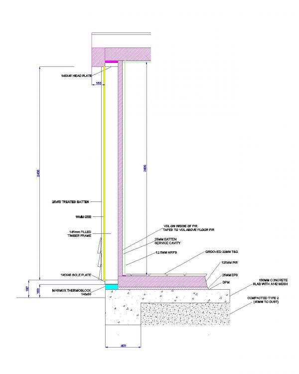

  5. Cold bridging surely? Or is it that it's minimal?
  6. I'd do "normal" concrete for strength personally or as I say 2" "council" paving slabs. But add others have said above the 50mm you say for screed/concrete is a bit thin imo. Less mess, easy 'ish to lay (mind fingers). Depends how flat your slab is underneath. You can always bed on some sand. I wonder if you could even do away with the screed/concrete... Put down 50mm of pir or eps then 22mm t&g moisture resistant chipboard flooring over that.....keep your feet a bit warmer! That extra flashing sketch to the right of 3 is good if you can do something like that. You see so many metal sheds just sat on an often oversize slab and water pees in at the edges. Devil's in the detail!
  7. Option 1 = bad. Water / damp will drive in (red arrow) and rot your metal shed. Option 2, not bad as the shed is sat on the DPM but a bit of a risk of water sitting between DPM and shed edge. With hindsight you could have cast a taper on the slab edge where the shed sits. Option 3, fold and stick the DPM down the side of the slab. Saves it turning up and trapping water. Great if you can then flash from under the shed and down over the DPM. 4 ideally you want the "ground" 150mm below where the metal is. If less then a stone filled trench at least with drainage if necessary.
  8. @MarkyP might be your man for advice on this Think it's the norm to affix timber "strong points" to the wall pre mesh and render. The small area doesn't compromise the insulation too much. If not then you can get stand off plastic "tube" type fixings.
  9. Sorry, I'm a bit lost without a section drawing. One option could be 600x600x50mm council slabs laid atop the DPM...
  10. "Taping it to the walls"... Is the intent to sit the edge of the metal shed on the concrete base, then to lay out a DPM inside and tape it up the inside of the walls? Bad idea if so.
