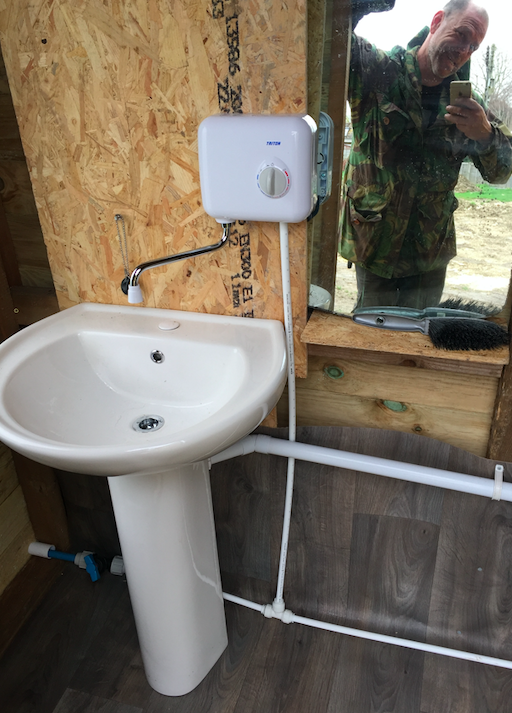

  1. Good morning all. I've built a little shack at the bottom of the plot that is going to house a WC and sink plumbed into the existing foul drain. I plan on putting a 3kW Triton electric handwash heater and a light in the WC. The temporary WC is 30+ meters from my Temporary Building Supply and to route any cable from the TBS to the WC would necessarily cross the access to the plot. What is the best way of doing this, temporarily?

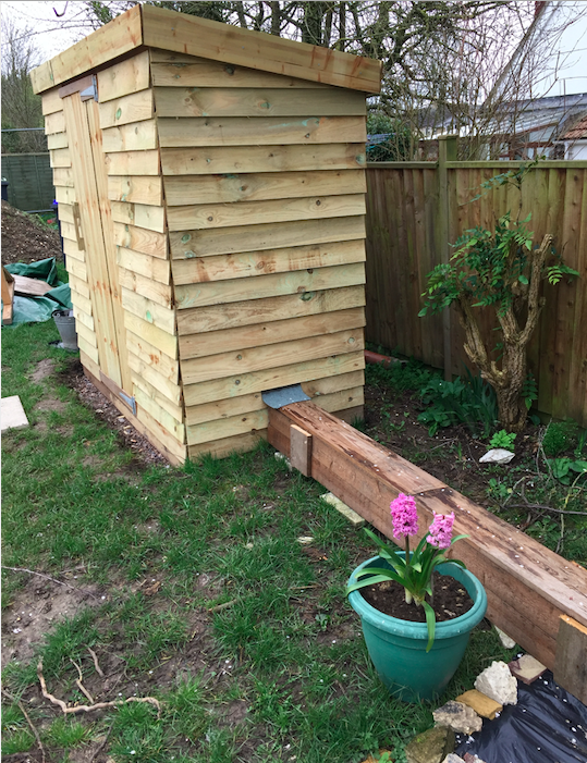

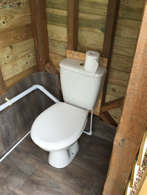

  9. @Ferdinand I'm going to build a little thunder box down by the drain in the bottom south west corner of the plot and plumb straight into that manhole cover (on the excellent advise of @Russell griffiths in a previous thread). The welfare unit will be at the north of the plot and I don't plan on connecting it to the drains. My thought is if I did the drains first then they would likely get damaged. I don't want to be up to the finished drive level during the construction phase and so I would end up with at least 1 IC protruding from the drive sub base.
