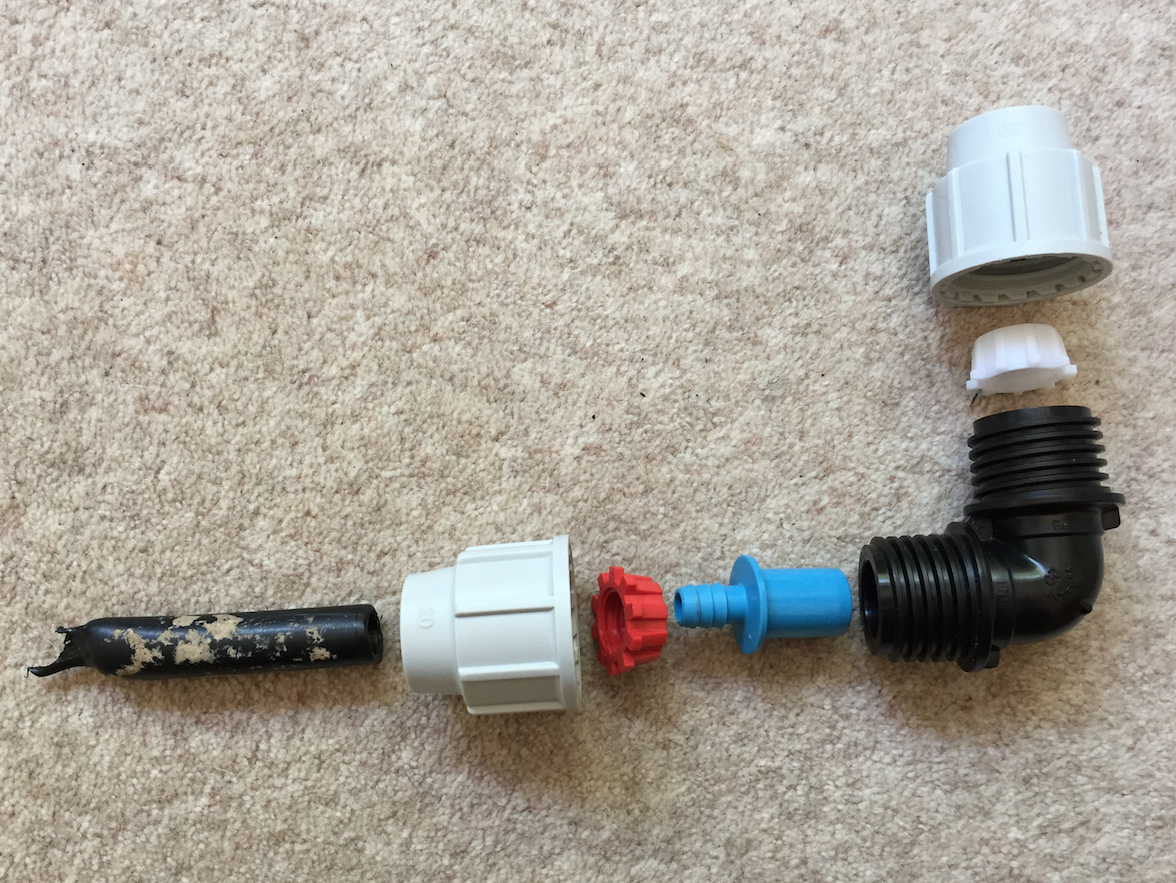

Well, a friend bought his mini digger round and we've found the water main... It's not iron or lead, it's black poly (is that the correct technical name?) We also unearthed a steel cable buried around the same depth, can anyone tell me what that is for? Should I hide it quick? The water main itself is externally just shy of 3/4" and internally it's pretty much bang on 1/2". So, have I got a 3/4" or 1/2" black poly main? I'm assuming it will be imperial as I suspect it's been there for decades (in new money, externally it's 17.5mm).

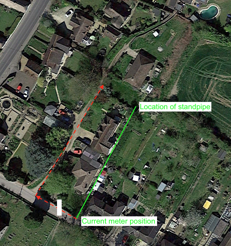

(Minor thread drift). I know where my water meter is and so I can make a pretty good guess as to where the supply enters the plot around 50m from the meter. I want to set up a building supply prior to demolition so I dig down and find the supply pipe... And then what? It's probably a sixty-ish year old pipe. Are there special techniques, tips and tricks to cut it and fit a standpipe and how do I connect a standpipe to the supply pipe? What bits do I need (apart from a mini digger).
