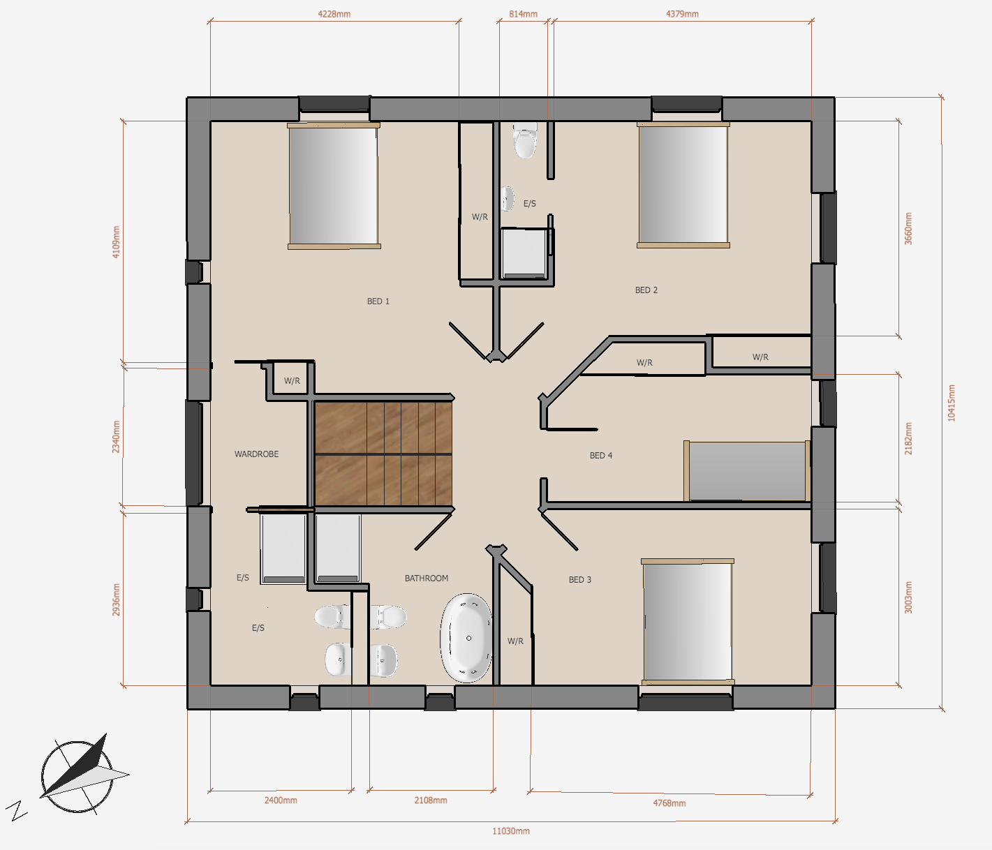

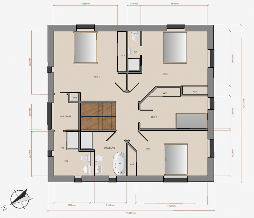

  3. Thanks for the all the replies. I had a figure of 210 degrees (ballpark'd in exactly the same way as Ferdinand) The figure the consultant has come up with is 60 degrees out and, of course, all the other elevations differ by the same amount compared to what I expected. I explained to the consultant what I considered to be his error, including copying the 'help' menu from the PHPP (leaving plenty of wriggle room for him to 'cough' to the mistake) but he insisted he was correct and that the measurement should be taken from the window perpendicular, clockwise to north, which of course would be 150 degrees... I won't be using him - I need the book! On the thread creep regarding certification, I'm still undecided if I will or not. I want to use the PHPP to ensure that my new build doesn't overheat as that seems to be the biggest problem for a passive house, so the more I can do to design that risk out the better, hence my desire to use PHPP.
  4. Thanks again, I shouldn't have been so vague in my first post but I was trying not to lead the jury.
  5. Many thanks so far. Perhaps I should have added a bit more clarity and detail. Once again, this is the same floor plan (with walls and windows now visible), it's the windows highlighted in blue that I'm after the 'DEVIATION FROM NORTH' for. The second image is a 'help' screen from the PHPP package explaining how to work it out.
  6. Well, I've been on the back burner for a while (again), but slowly making progress-ish. I chickened out and went for a PHPP consultant who has sent me a copy of his first iteration of my plan, having looked through it I'm concerned about several things, the main one being the 'DEVIATION FROM NORTH' on the 'SHADING' tab. Without leading anyone with his or my view, I would be very grateful for anyones input on what they consider the 'DEVIATION FROM NORTH' of the wall highlighted in red on the image below - ball park is fine, the consultant and I differ by 60 degrees. Thanks in advance.

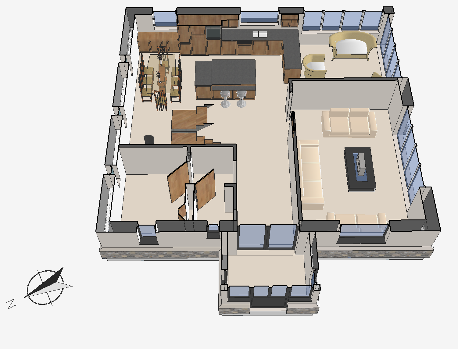

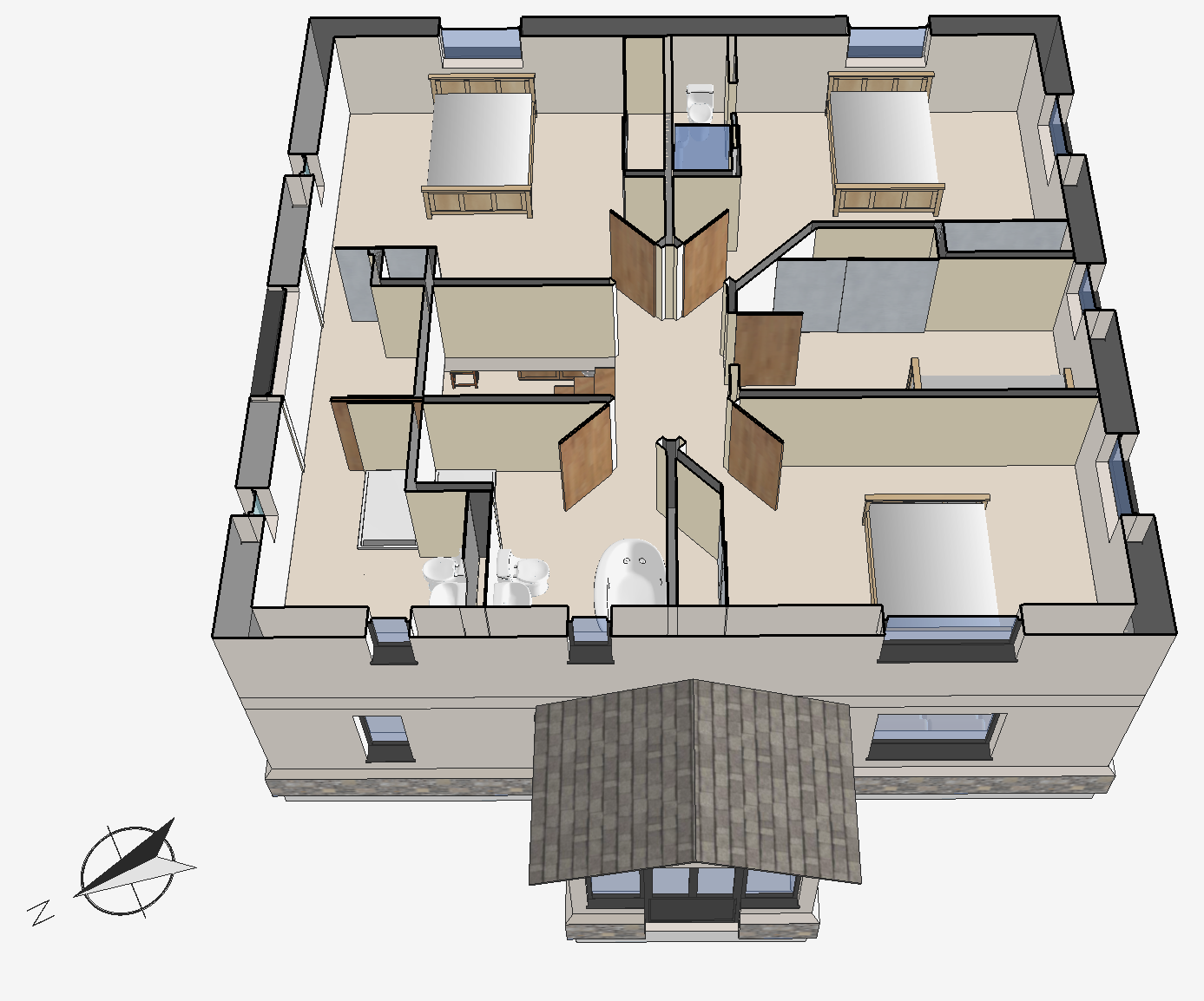

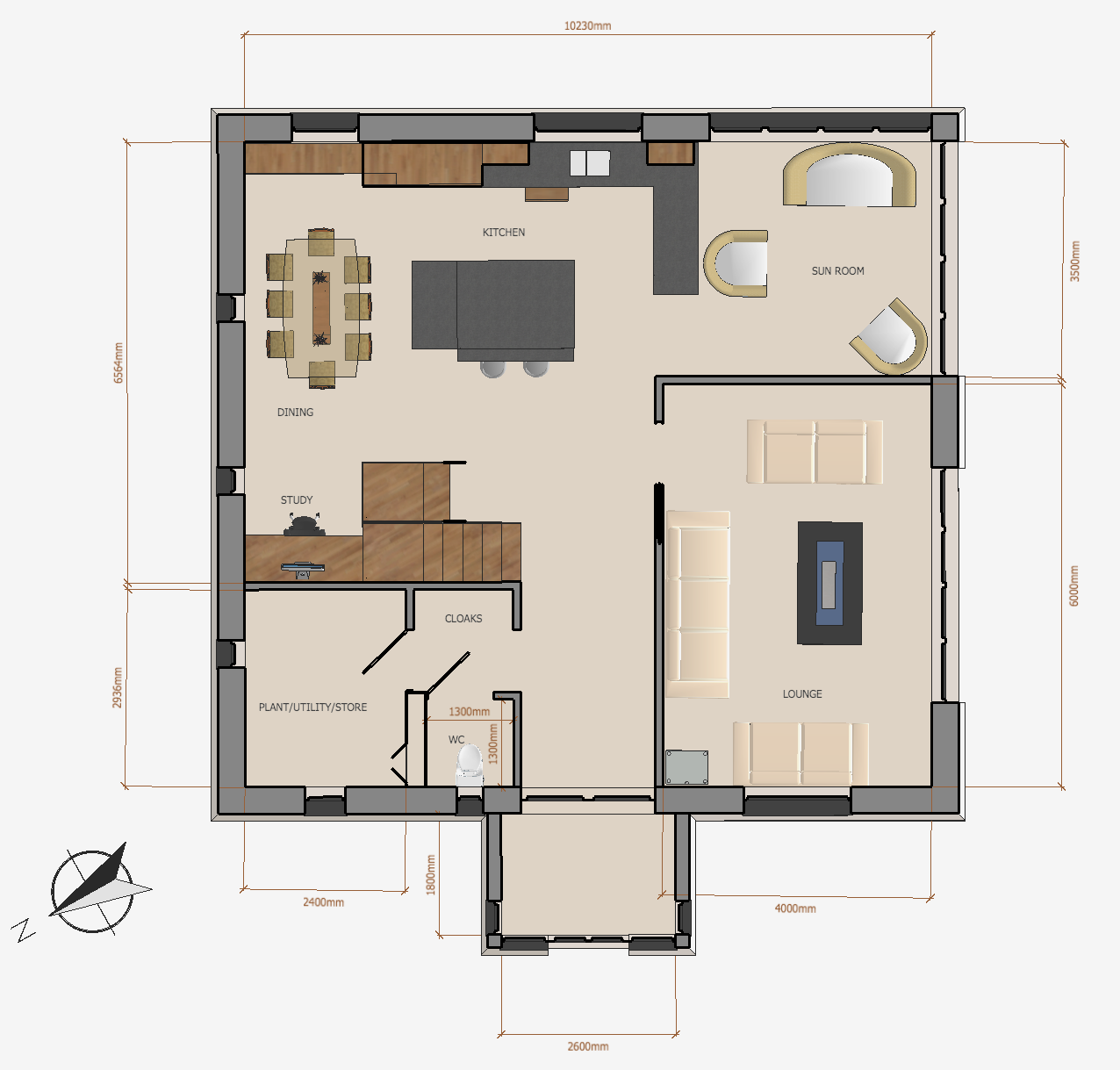

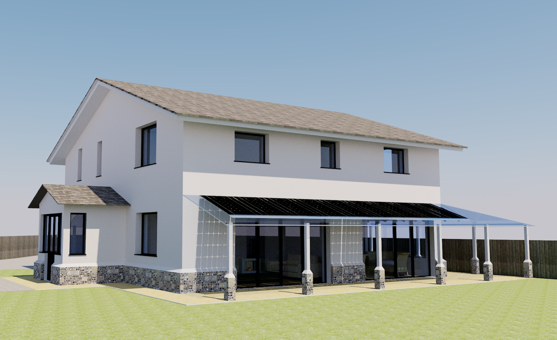

  19. Thanks all for your feedback so far, we very much appreciate the time you have put in to looking at our plans and then responding. The second en-suite is hanging by a thread and may well be deleted, if it stays it will be bigger and have it's own window. A sunpipe or sun tunnel will go at the top of the stairs. I think I'll leave the kitchen where it is and hope the sink is not full of dirty dishes when we get visitors. There will probably be an additional door on the north east elevation. Technicalities regarding the stairs and the building height etc still pending...
  20. Thanks Dave, I'll check regarding the step on the half landing (that would never, ever, have crossed my mind!) Nor the stair lift - I'll check that. En-suite 2 getting bigger as we speak, personally I'd be happy to abandon it but the boss seems to think its necessary. My poor drawing. There will be patio doors from the sunroom and lounge. I'd though about the bin walk and decided that going through the sunroom would not be a major issue but I may just reconsider that, thanks.

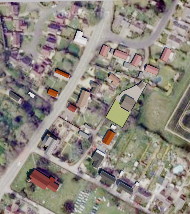

  21. Thanks for your detailed reply AliG. Very good point. It's still fields behind - but I guess that could all change. Plan 'A' (which is in its infancy) is to by the little corner of field that we look out over but I guess I should have a plan B Thats the next step. I was concerned about the spans. Next stop MBC to see what they have to say about it. Good points, I'll move stuff around. That was deliberate, but probably not well thought through - I think your right, looking at a nice table as you come in may be better than a sink full of dirty plates! It would also probably make it easier to site the waste from the No.2 en-suite. I had thought about that, but then discounted it. The stairs will be open 3 sides on the ground floor and I was hoping that might provide enough light. Can you get Sunpipes for passive houses? I'll get on to Google. That will happen, as will the understairs storage. Neither have I! it came out of my head :-) It's purely a sketch at the moment. I fancied a veranda, and obviously need to shade the windows. Shading them with PV's could kill two birds with one stone. I found these PV panels http://www.lumossolar.com and thought they may be an ideal solution though I've no idea on costs. the fence round the back is just to define the boundary in 'SketchUp' and in reality would be a lot less significant. Continuing the 'solar veranda' around the back was deliberate to increase the amount of PV production time. Thanks again Ali for your excellent and considered feedback. Russ.

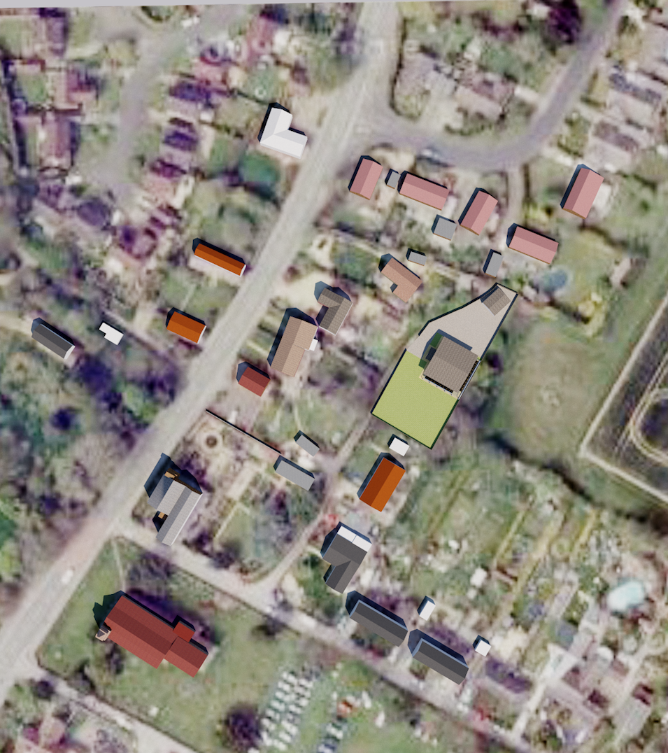

  22. Dear all. I would welcome your feedback regarding our proposed plan. We have an old bungalow we plan to demolish and replace with (probably) an MBC house. I've spent countless hours messing around with SketchUp and I think I'm finally there, but I may have a bit of tunnel vision now so I value all comments. For context, here is the (irregular) plot and surrounding property. The plot is set back from the main road and pretty much invisible until you walk past it. Access is from the south west, it's narrow and it may be tricky. And a view of the proposed new house, looking from west to east. The low pitched roof is because it is pretty much surrounded by bungalows or one and a half story houses and I suspect ridge height will be an issue. We would like a 'solar' veranda but not sure of the practicalities yet. Ground floor plan: Fairly conventional 'open plan' but we've opted for a plant room on the ground floor that will also be a washing/drying room and store room as there is no useable loft space. I plan to run the majority of the plumbing, MHRV etc to the first floor in a void between the plant room and downstairs WC. Is that sensible? First floor plan: Thanks for your time. Russ.
