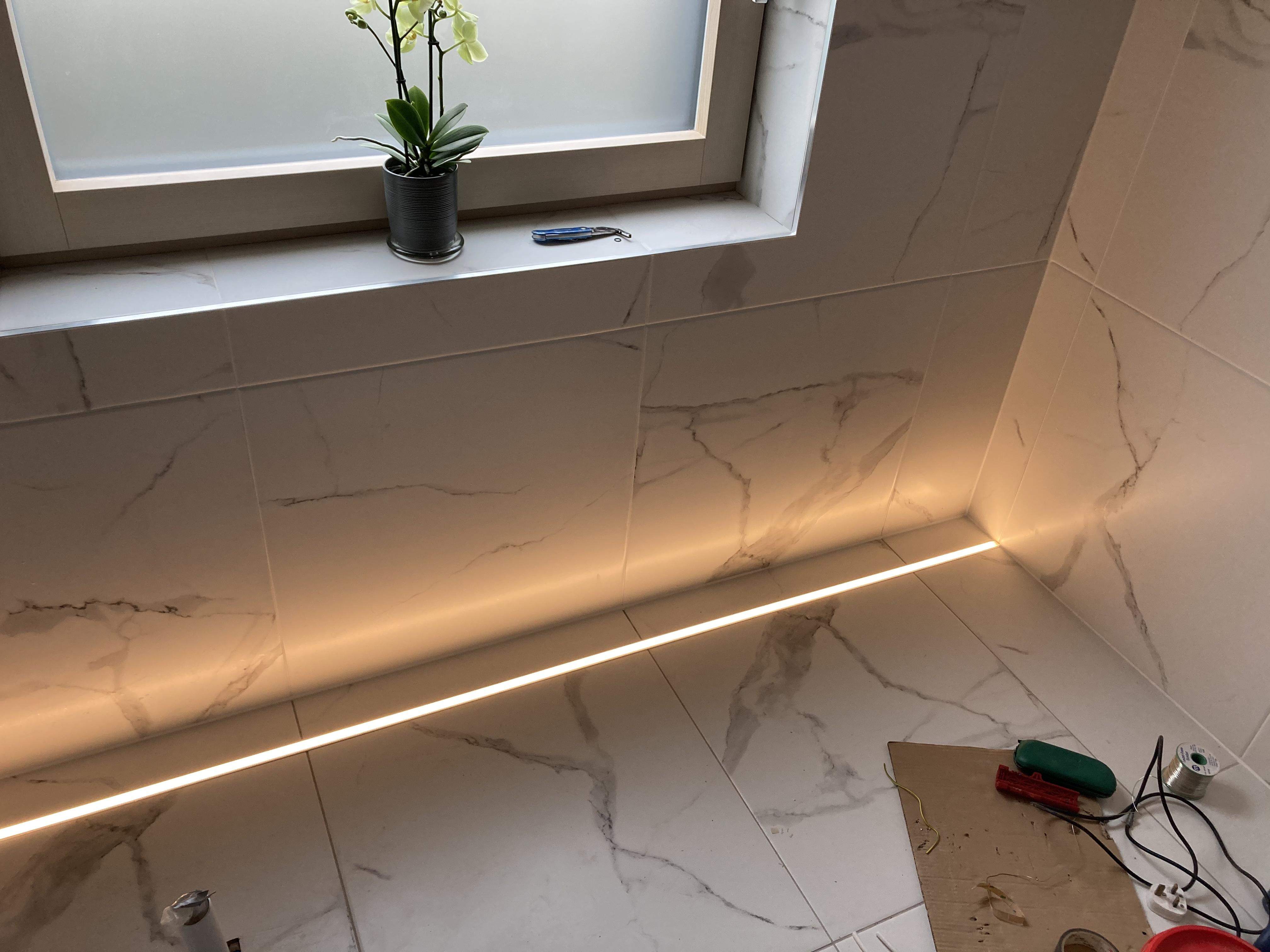

  1. The LED strip is in but if I put the chunky heat shrink stuff over the soldered joint the LED strip will no longer fit in the channel. My electrician wants the joint protected. Can I just surround it in clear CT1?

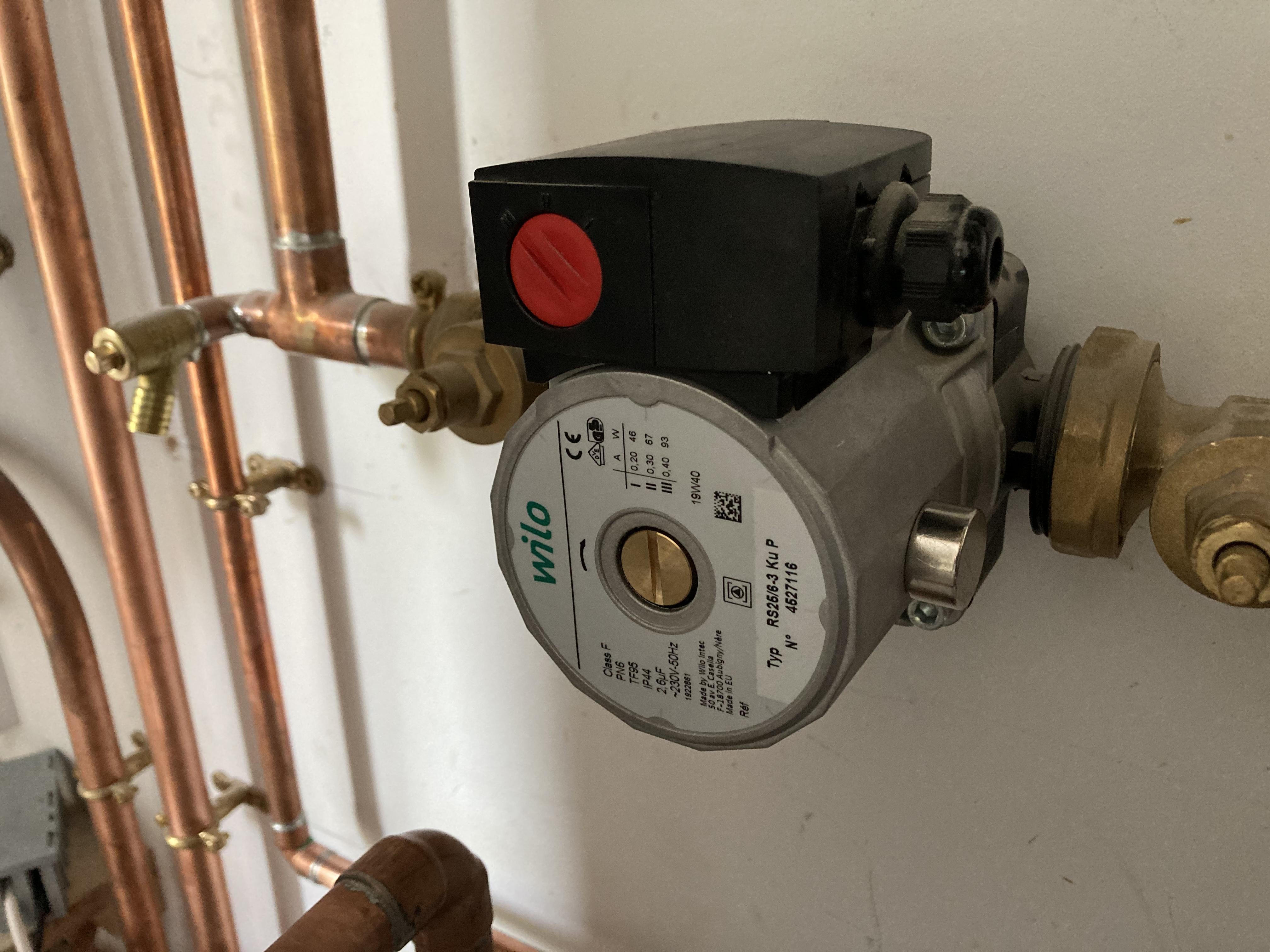

  3. You make a convincing points Peter. At the stage when I was convinced it was absolutely the wrong pump I had planned to change it. The plumber who told me that it was the wrong pump also told me that the pump in the Willis circuit was a crap pump so I was going to replace the reported ‘crap’ pump the current Wilo and get a bronze Wilo for the hot return. Has the plumber sold me a dummy or is it a crap pump? (Water softener pipes in the way. I’ll get a better picture in a bit) I should add, he wasn’t trying to sell me a replacement pump.

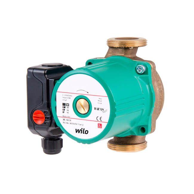

  5. Again, that shows what I know. I thought Wilo were the manufacture of that pump?
  6. I called up, gave the tech guy the part No. (it seems they call it a Star No?) and asked if it was suitable for a hot return circuit. I reckon he was punching that part No. into his computer, and computer said 'no'. He told me I needed an SB60, as I explained exactly what it was for he said the much cheaper SB30 would be more than sufficient. I couldn't comment further on his competency or otherwise I wouldn't do that, I was the heretic after a standard light switch in a downstairs WC (not literally). I like change unless there is a good reason not to. I appreciate your explanation as to how things have evolved in the manufacturing process, had I had that information last night I either wouldn't have called Wilo this morning, or if I had I would have been much better informed. As I said and @PeterW highlighted, this is in potable water supply, so trying to minimise use of the inhibitors ?
  7. Clearly indicating how little I know about these pumps. The impeller body is black plastic or some such thing. I understand what your saying but Wilo say it’s not the correct one. All the pumps on the Wilo website that are specifically for domestic hot water recirculating loop have a bronze impeller body. The tech guy told me I had the wrong one and I feel obliged to go with that advice.

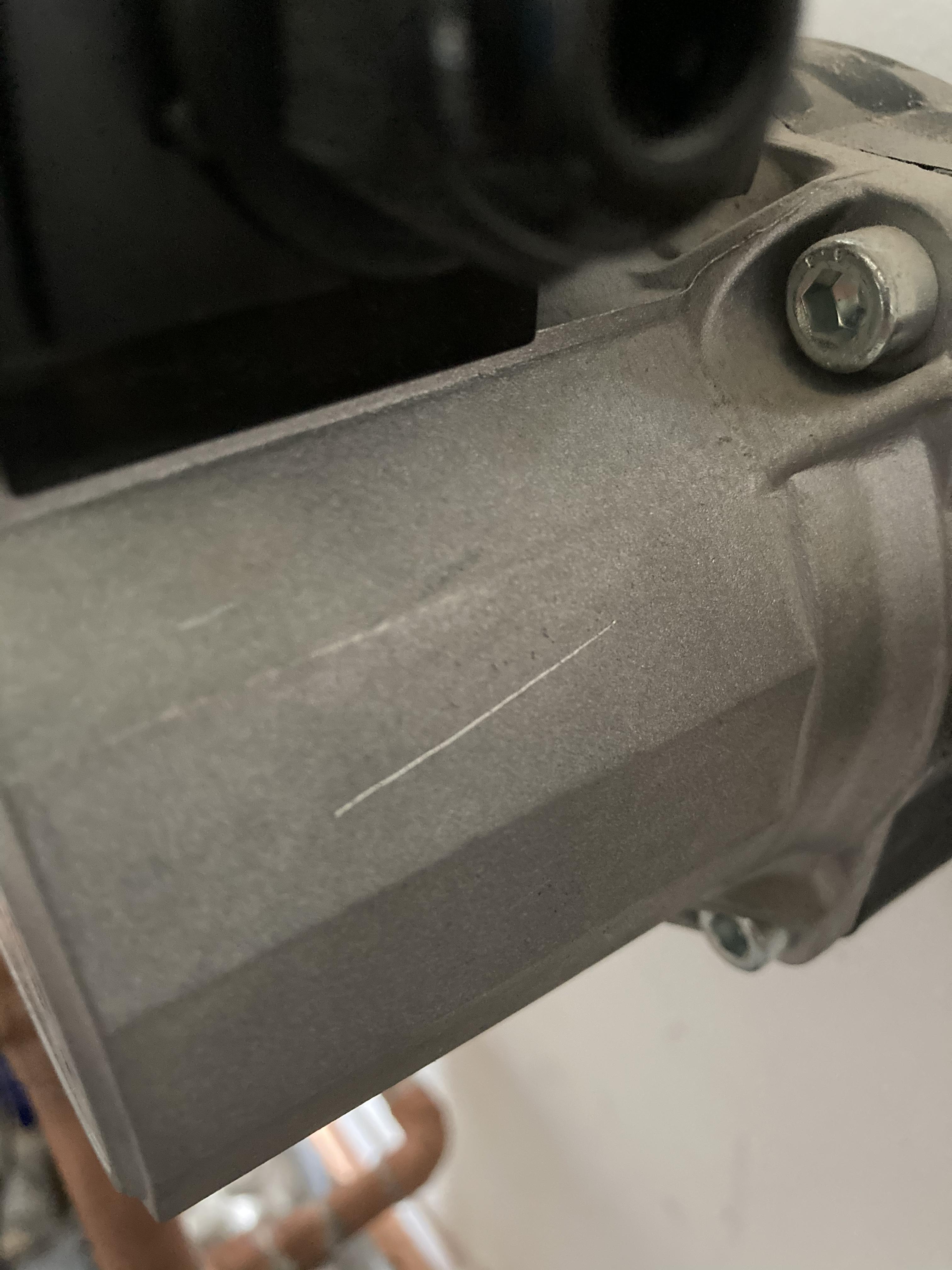

  9. It’s not a plastic body. It’s cold and scratches just like any alloy would and there is definitely something ferrous inside (magnet sticks with ease). I’m minded to stick with the Wilo tech guy on this and not the eBay resellers. Maybe the Wilo guy is wrong but with this conflicting info I’ll stick with him. Regarding the hot return pipes. I’ve got that wrong. I’ve been reminded that the pipes are plastic coated copper and I agree the solution to turning it on and off is elegant.
  10. Quick update. So the consensus on here and the www is 'bronze pump' for the hot return. I didn't want to speculate further so I called Wilo to get some answers. Wilo technical confirmed that it is the incorrect pump for a hot return circuit and that after time I would get rusty water from the taps and finally a pump failure. Why on earth would the very knowledgable and highly skilled plumber fit the incorrect pump to our hot return circuit? He must have known what he was doing? The list price of the incorrect fitted pump is £120. The list price for the correct pump is £548. (That £548 is the list price for a Wilo SB60, a Wilo SB30 would probably do what is required with ease and can be had for £162)
  11. That would appear to be the consensus and makes sense to me. But do I actually want a corroding pump in my potable hot water return. I'm sure it's not going to kill me and probably not event kill the taps but for how many years would I be running rusty hot water in to the sink before the pump finally fails? Neither can I which seems odd. Is it likely to be a discontinued model? ~~~ Googling this issue led me to this separate concern. Can I use Hep2O in a continuously operated re-circulating system? No. Continuously operated re-circulating systems (Secondary Hot Water Circulation/Ring main installations) are very different from conventional hot water supply and central heating systems found in domestic properties, for which Hep2O products have been tested. Thats from the Wavin site, and Hep2O has been used in our hot return loop. As ours won't be continuously operating I think we're in the clear but it was going to be initially. I didn't really want a hot return circuit but the plumber cajoled me in to agreeing to one and came up with a simple solution to only make it run when the bathrooms are occupied.

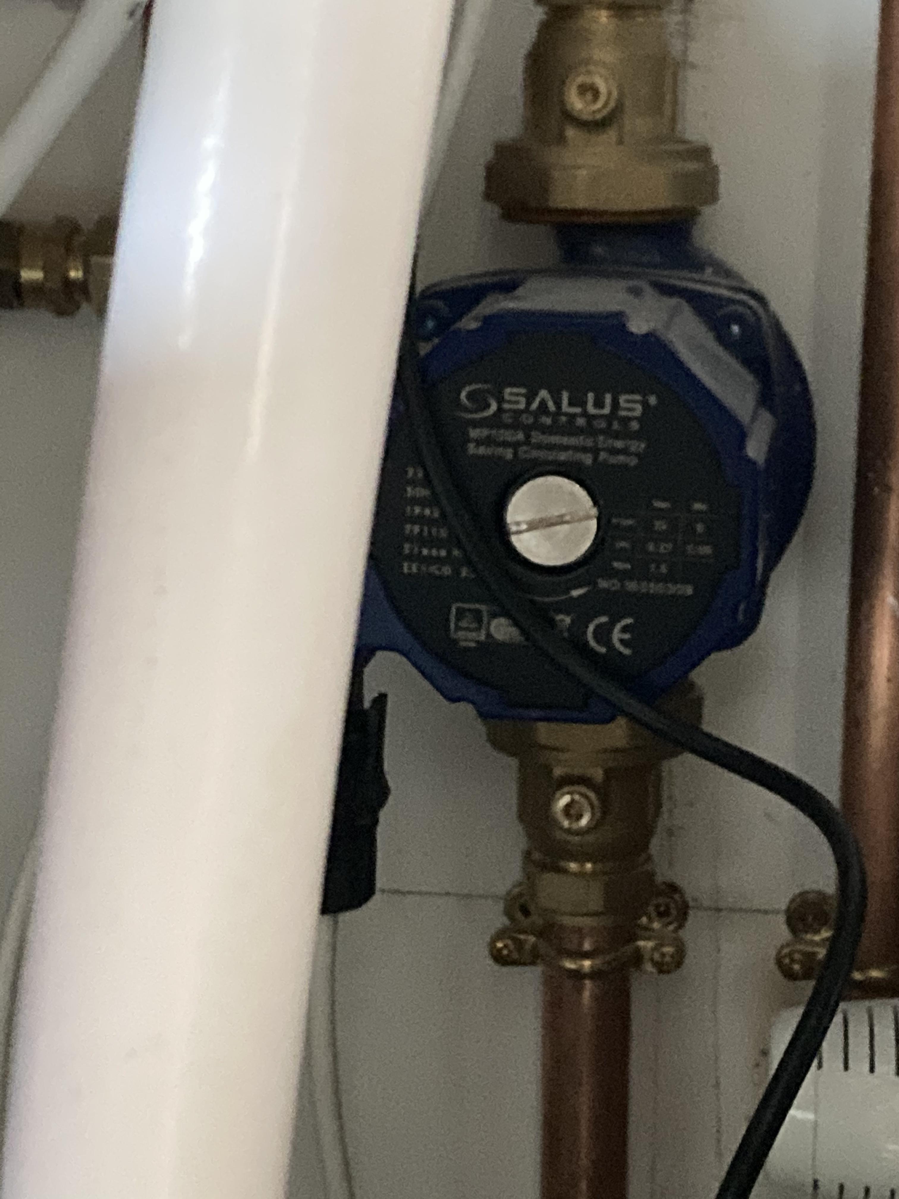

  13. On the subject of hot returns, 3 times now I’ve been told that the pumped fitted in out hot return loop is incorrect. The first to tell me was an electrician so I kinda ignored him, the next two were plumbers so I had to pay a bit more attention. They all say that the pump in the picture below is for a heating circuit and should not be used in a hot return circuit. They tell me I should have a bronze pump for the hot return. I know nothing of these things, can anyone shed any light on this?
