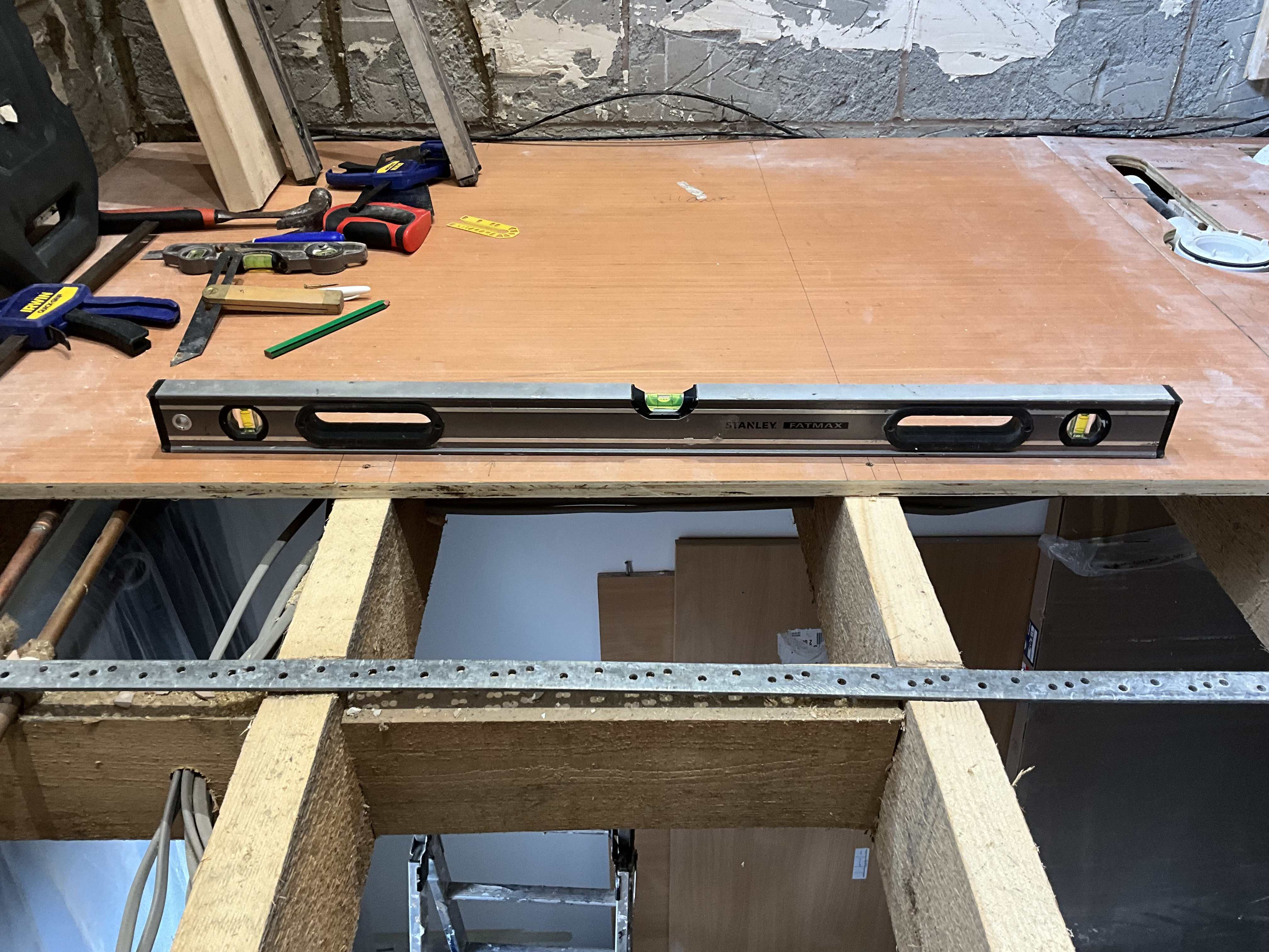

I have just installed our Mira stone resin tray (900 x 1700) installation methods vary manufacturer to manufacturer. Mira recommends bed on a weak sand and cement mix or use a suitable construction adhesive. Their tech help confirmed CT1 would be suitable. I tried the sand/cement mix but wasn’t happy so cleaned it up and redone using a few tubes of clear CT1. Took a leap of faith with the level because once laid in position I could not prize it up off the adhesive. I had lowered with banding straps which snapped when I tried the lift. Left 24hrs and all solid and level. Check out what Rodger says on the skill builder YouTube channel. I preferred the clear CT1 for this task. Thought process being that it’s a bit thicker in consistency than the white and the bed needed to make up a 3mm gap. our previous tray which I installed approx 10 years ago was bedded on the sand and cement mix which was good for years but then developed creaking noises but no obvious movement? On removal,the bedding mix was all cracked and turning to dust. I read everything the Welsh Wizard posts, he is amazing but do check out skill builder. Mira also told me not to use tile adhesive. You don’t want to bond the tray in position. Even flexi tile adhesive won’t allow for the different expansion movements. The indecision is a painful. You already have a suitable adhesive if that helps. How much of a bed do you need to make up under the tray? -

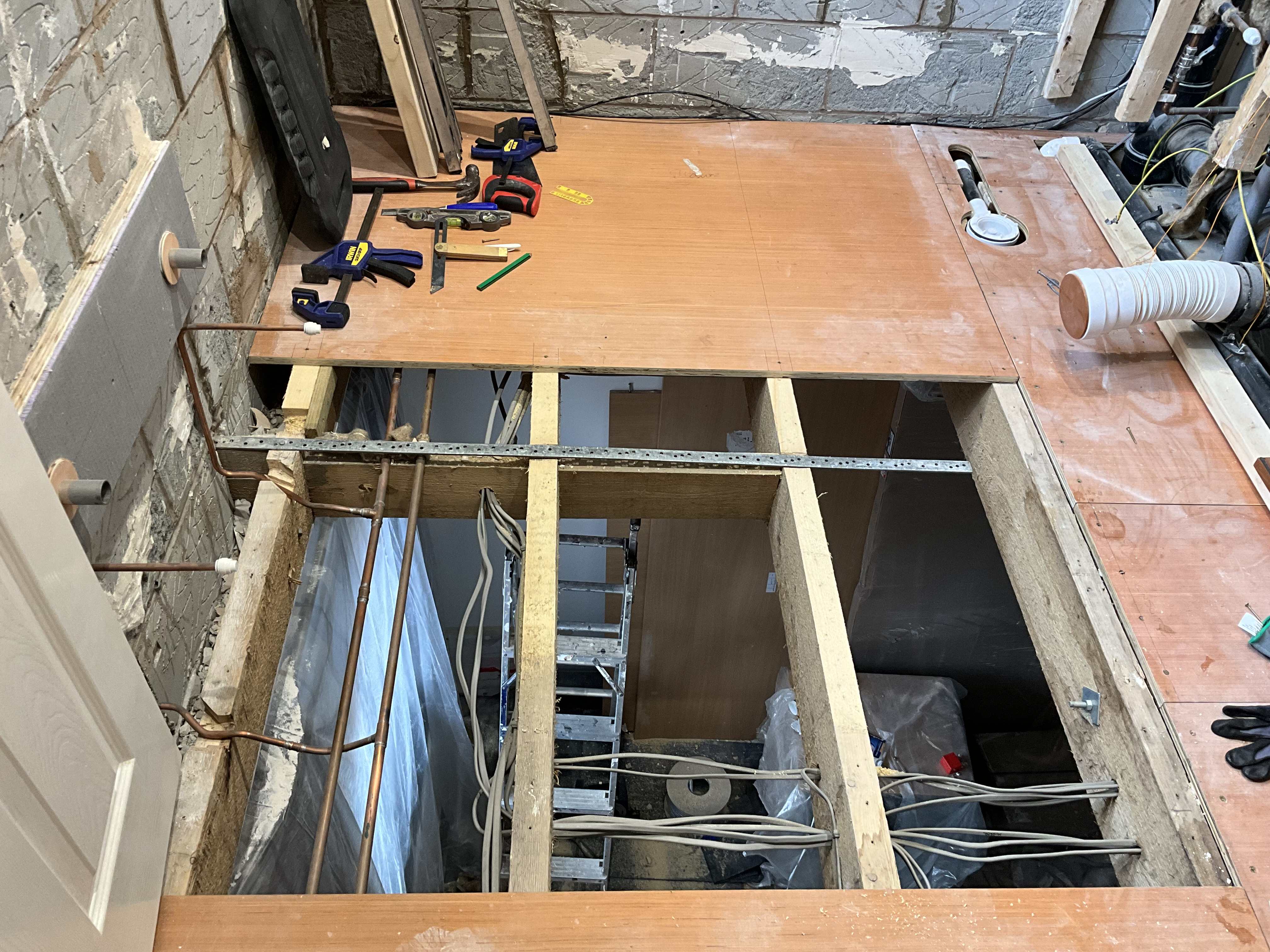

Hi members, couldn’t find my answer in previous topics so asking for some pro guidance. Bathroom refurb due to a flood. I’ve taken a big camber out of the floor so all boards now can sit flat but the area is not level. The bubble is just touching on the line. I don’t want to remove anymore from the timber beams so what’s the best way to achieve a suitable level? we have a low profile 1800 x 900 stone tray to go in which is flat underneath and the rest of the rm will be tiled with loose lay wire heating bedded into the tile adhesive for comfort and not rm heating. Should I use self level compound for the whole area and then continue or, level the tray in the adhesive of choice something like ct power grab and then tackle the remaining floor area I.e take out imperfections with adhesive > 6mm insulation boards> decoupling layer > tile adhesive with heating wire > floor tile. Tray manufacturer recommends a smooth flat surface to bed down on with a suitable silicone adhesive. The tray is very heavy so don’t want to be relifting once in place😀 Input appreciated as always ps could only upload two pics, size is inside allowance?
