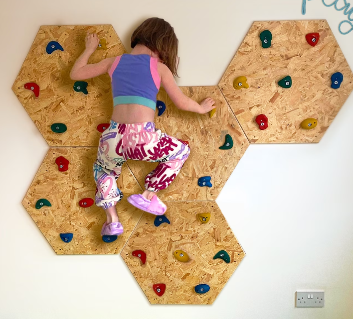

I'm planning on constructing a climbing wall like this in a bedroom: From what I read online 18mm OSB/ply should be used. I have an excess of 9mm OSB - would it be wise to sandwich two cut sheets together (using PinkGrip or an adhesive) or should I just get some 18mm sheets?

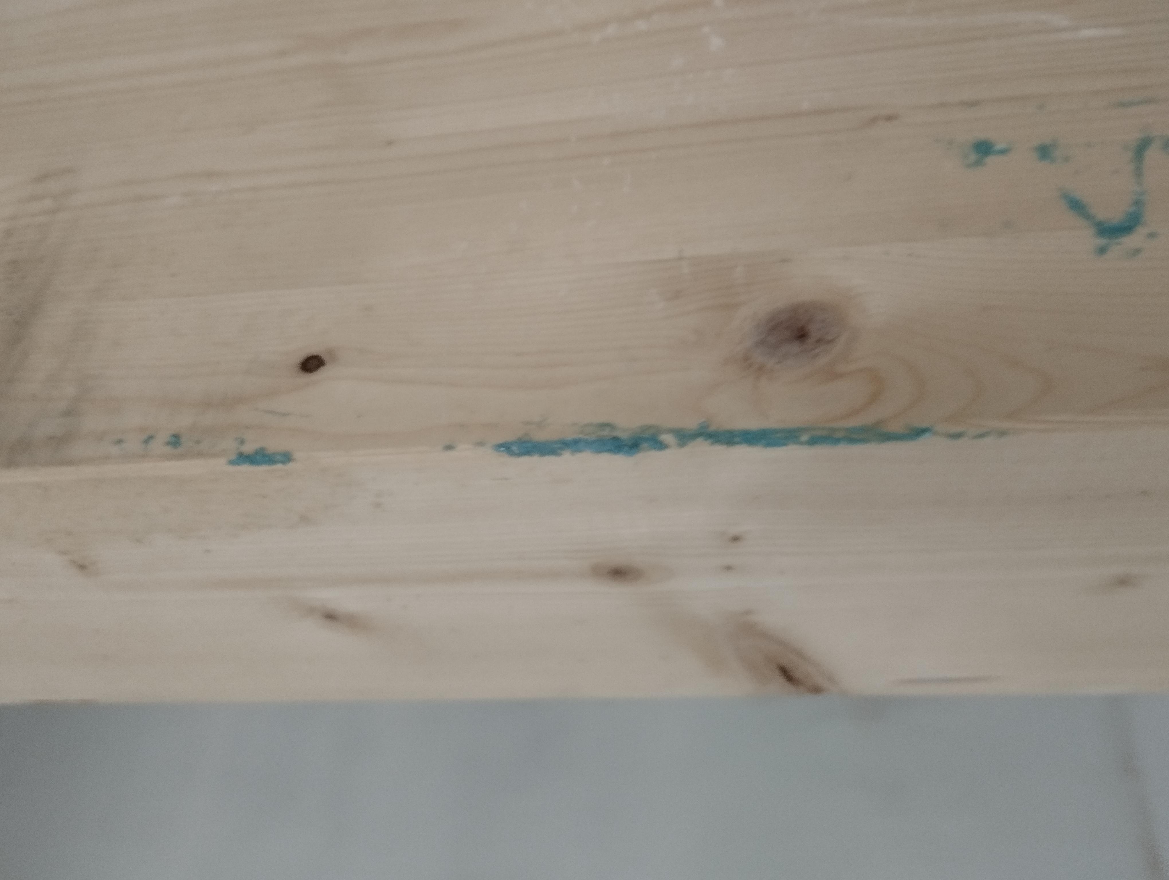

Our exposed purlins have taken a bit of a battering from expanding foam, silicone fillers and paint. Any suggestions for how best to clean them before any final staining?
