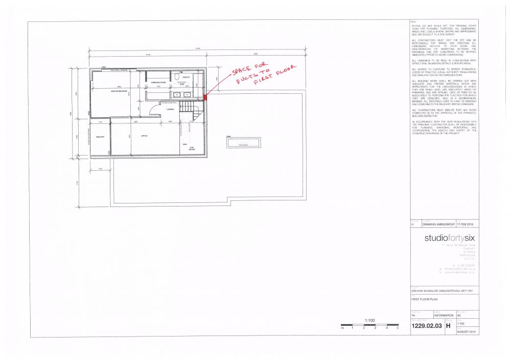

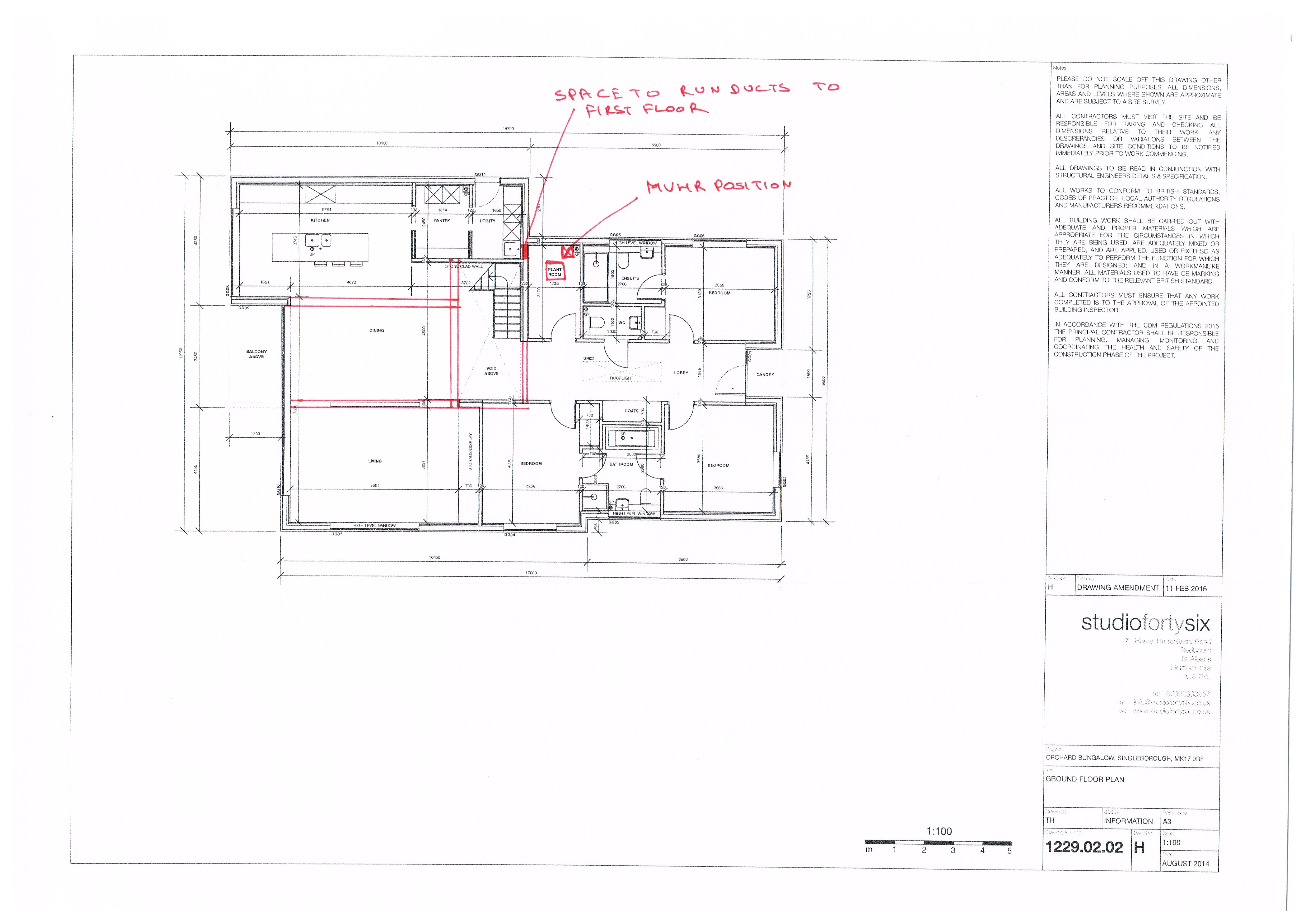

RandAbuild - I have a quote from a company called Systemair (Swedish) which is only marginally more (10%) than those from BPC. I have seen Systemair units and they look very well built. They also offer a number of features that appear as chargeable options on the units that BPC supply. The only thing is that they have specced a branch system rather than a radial one. I am going into investigate this one some more but frankly I am getting to a point of analysis paralysis and might just buy the nicest looking one The position shown on the drawing is incorrect and will be shifted over to the left hand corner of the wall so that both vents will sit inside the 1750 room width.

I am in the process of selecting an MVHR system for the house. Floor area is approx 260m2. I have quotes from BPC (competitive) and some other suppliers such as Regavent, Systemair etc. The units look pretty similar with comparable (claimed) performance parameters. I know Jeremy used Genvex for is build and some Mitsubishi models have been recommended also. Are there any no go makes/models? Does anyone have any opinions on performance or advantages/disadvanteges of wall mounted units over floor mounted ones? I have attached floor plans of the house. Please disregard the shown preferred position of the unit. An oil boiler has to go against the outside wall as well and I am a little bit concerned about the positioning on the inlet, extract and boiler flue all being on the 1.8m wide wall. I cant seem to find any definitive guidance on the minimum separation between these. Any thoughts? I am coming down in favour of a radial system but I have seen some drawings where runs of over 15m arent advised. Is this correct as I cant see how they can be avoided. I have also come across crossflow vs counterflow systems. Am I getting them mixed up?
