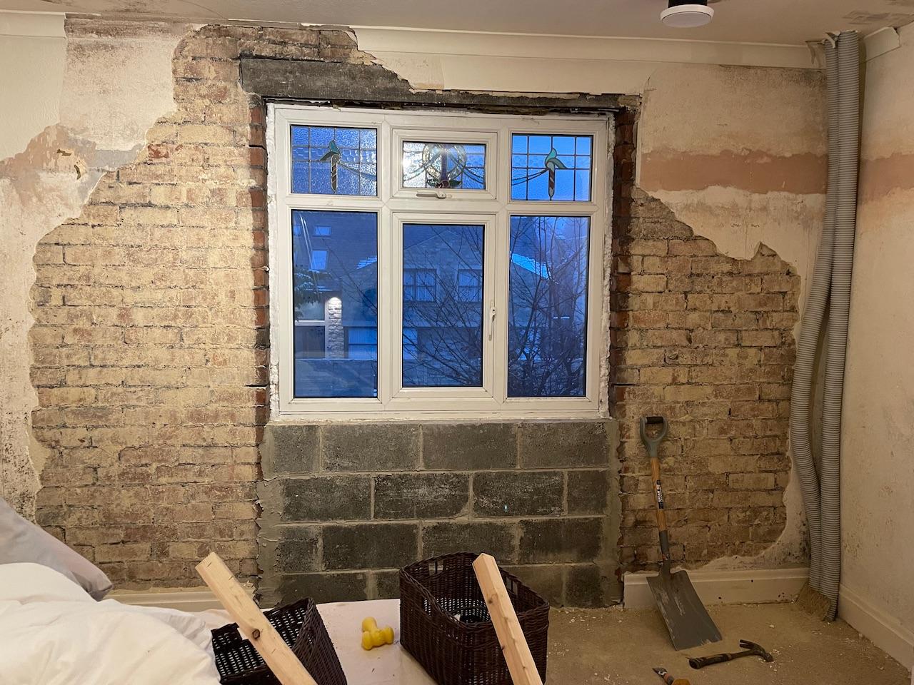

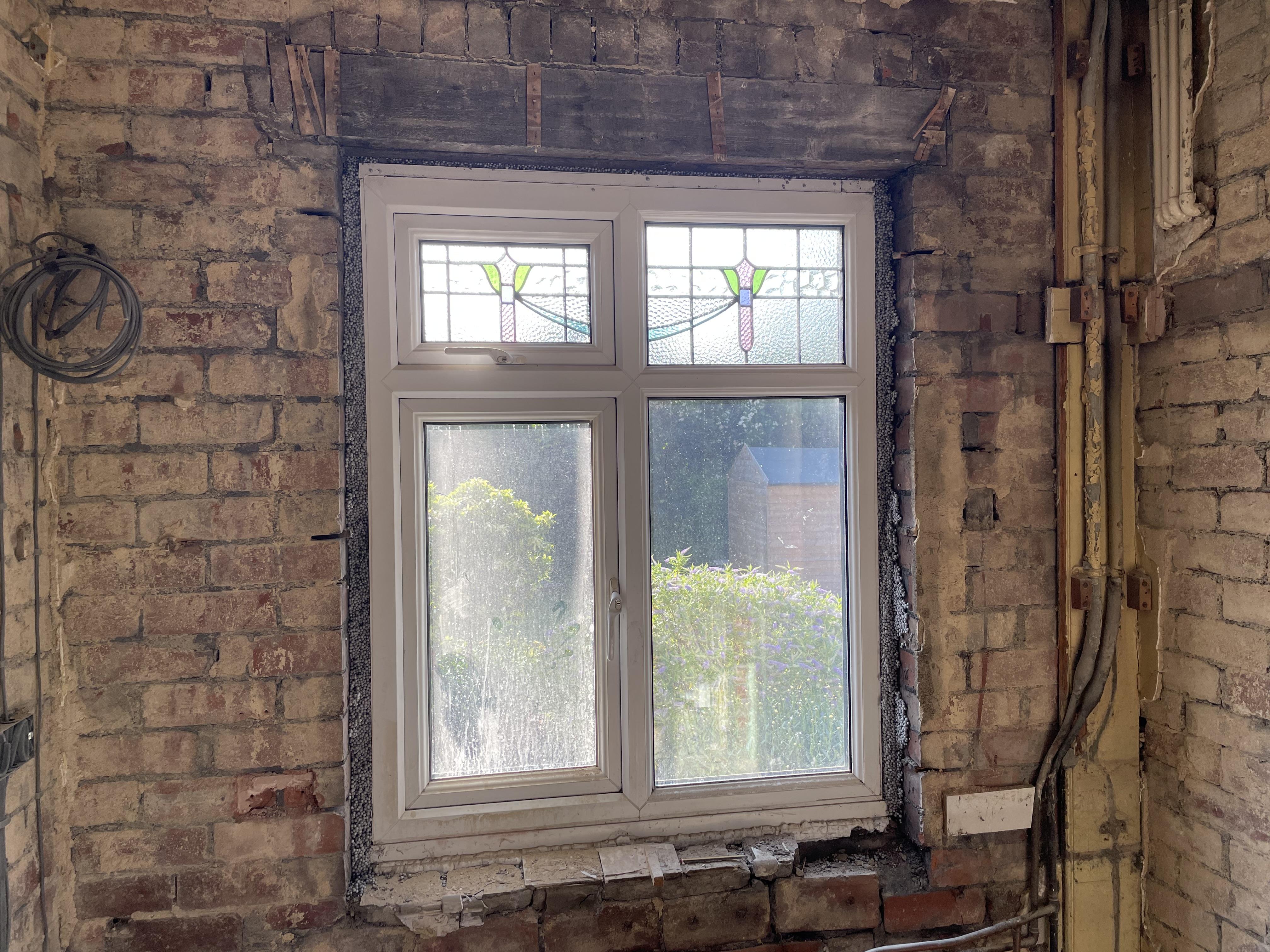

Day 2 of starting work and turns out I’ve got timber lintels on all openings on the inner leaf. How to deal with airtightness, just tape the hell out of them with Contega Solido SL? I’d rather not have to replace replace literally every lintel internally unless it’s absolutely necessary, ££!

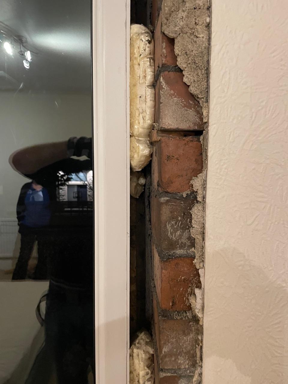

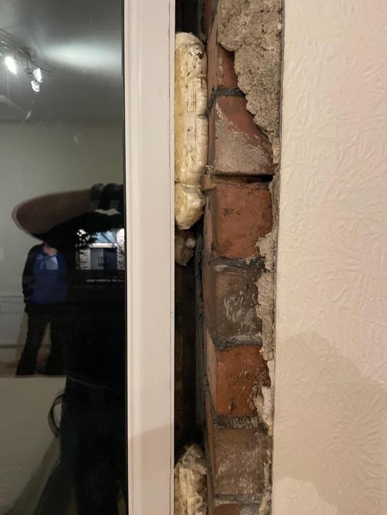

So when the window is removed, cut a rebate out on the internal side of the cill and place something like compacfoam to fill the rebate before installing the new window?
