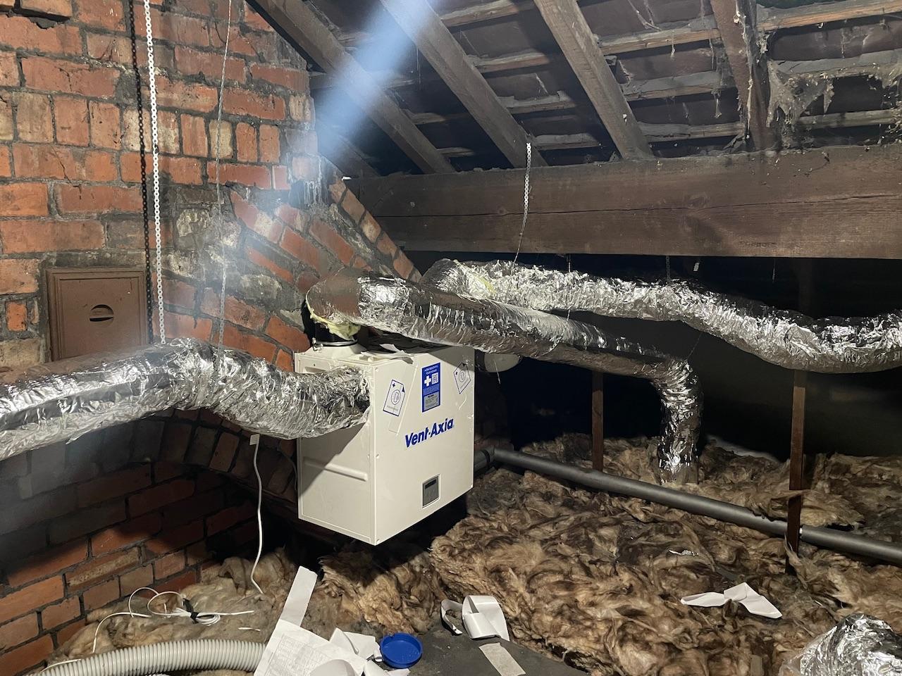

Insulating MVHR Ductwork in the loft
IGP replied to richo106's topic in Mechanical Ventilation with Heat Recovery (MVHR)
I just wrapped the sides of the unit (the back is mounted on brick wall) in the foiled backed insulation. For the front I just used the same insulation but used Velcro to attach it so it’s removable for filter changes. -
Yes I taped both membranes to the brick. I didn’t insulate the walls internally, got cavity wall insulation.

I installed a Vent Axia Sentinel FH in my 1930’s semi in a cold loft and it’s performing quite well. I just wrapped everything in insulation (photo without everything fully insulated). -

I’ve put window film on it in one of rooms, it helps but isn’t a wonder product. I’ve just DIY’d an MVHR install in my 30’s semi. It’s made a huge difference in air quality. It’s no longer stuffy, there’s no condensation on any windows as we used to have humidity 65-80% regularly. I feel I sleep better with the fresher air in the house which is something I didn’t expect. Also my partner hasn’t used her inhaler since we fired it up, but that be coincidence. All in all, I’m super happy with it but it was loads of work! I’ve now fully insulated the unit (photo taken before) and has helped a lot with warmer supply air. I can recommend MVHR. -
