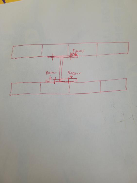

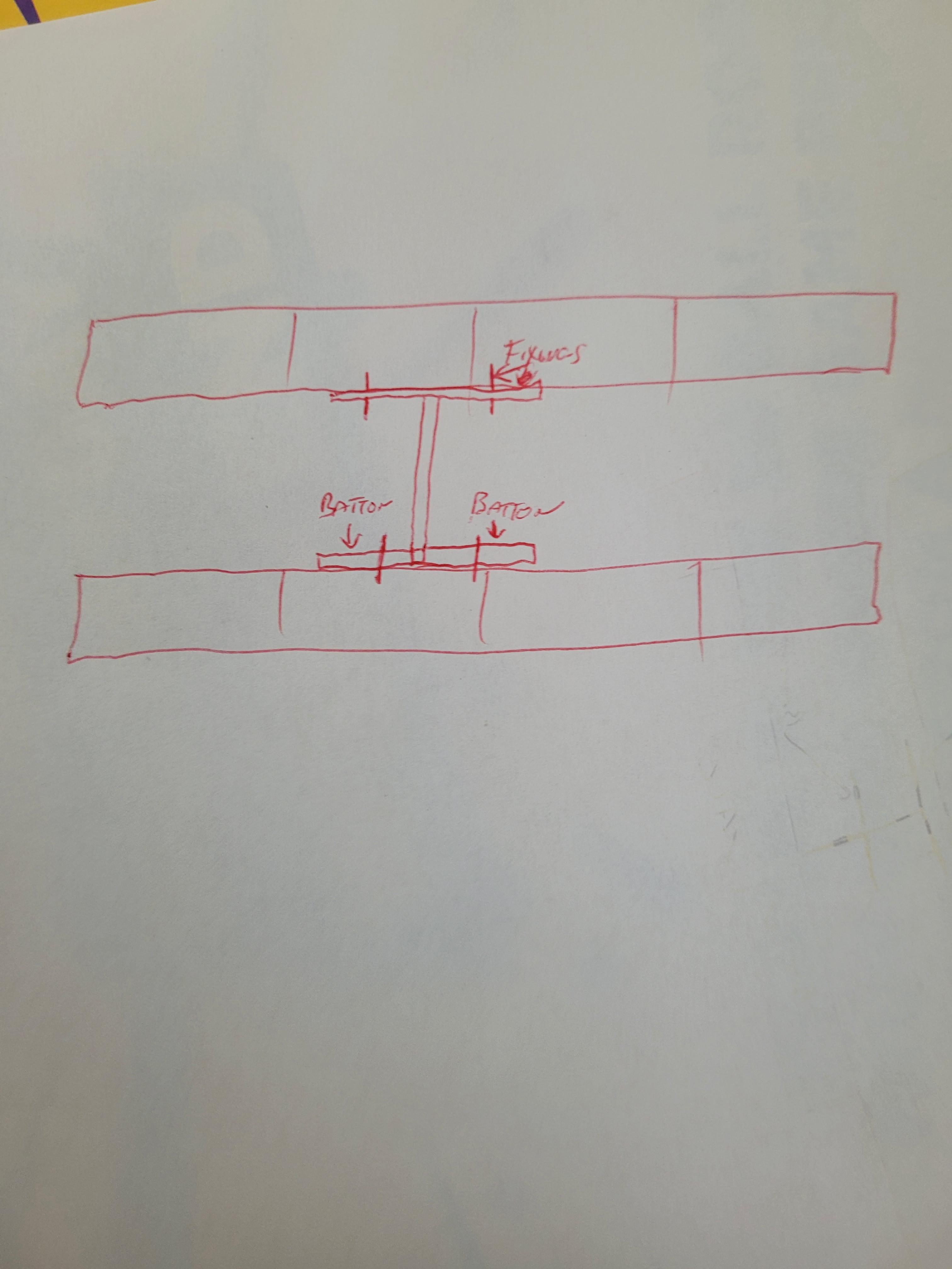

@SteamyTea is this what you mean?
Good Question, didn't feel the need to draw, just drawing what I thought steamy meant.
Re. metal bracket, that's why I was suggesting a plastic one, nylon could also do but would the condensation still be an issue?
Was thinking about fixing a plastic 50x50x6mm angle bracket to the inner side of the outer leaf to support the window boxes. I know @Iceverge cantileverd his osb "box" but 300mm is a lot(in our case). Anyone with a 300mm cavity done this or suggest something better.

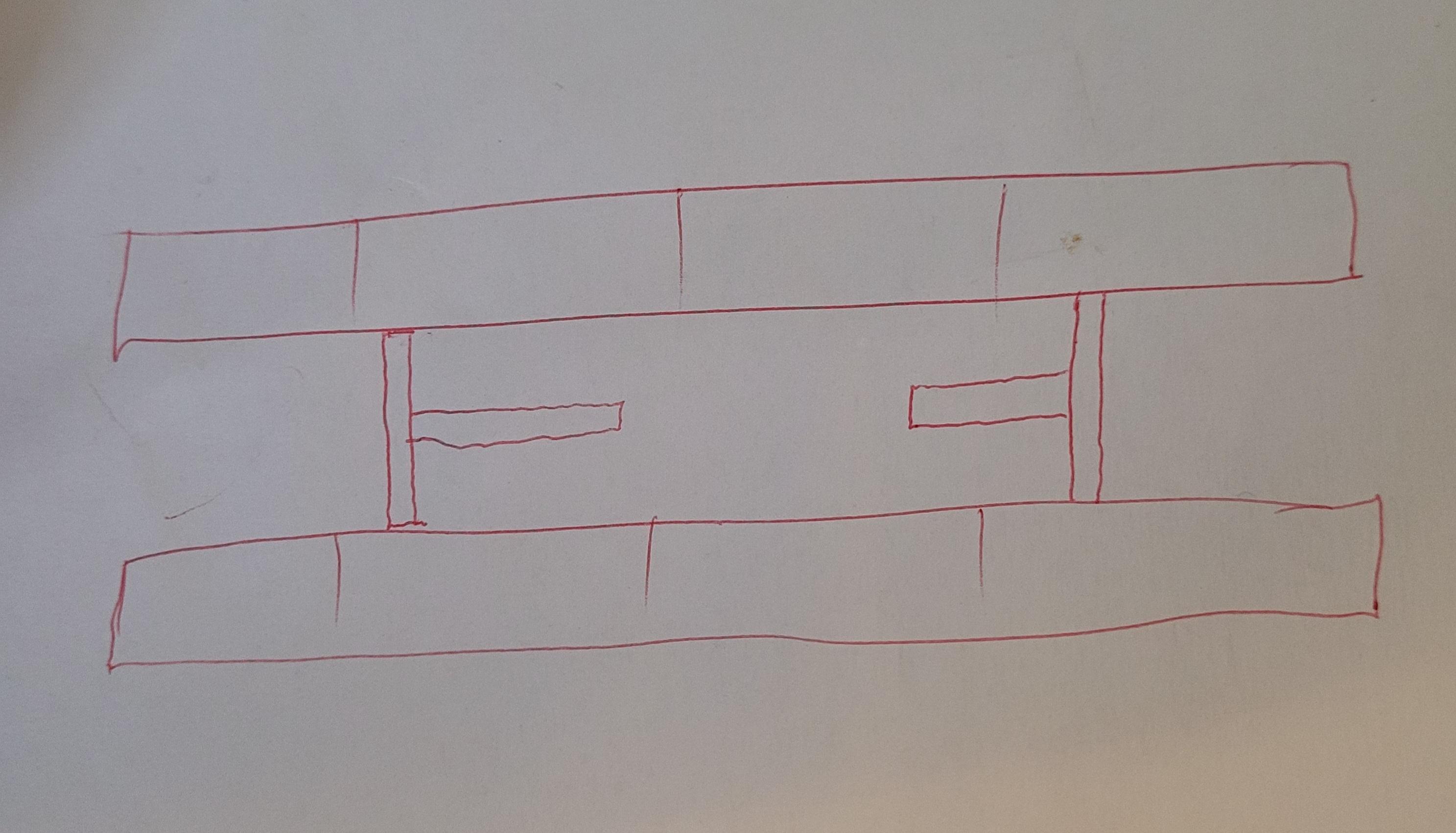

plan on making up something like this, with mortar near flush to outside of external leaf and 12-15mm spacer on inside face of same block then turn it round for the inner leaf. You'll have consistent beds and no spots in cavity

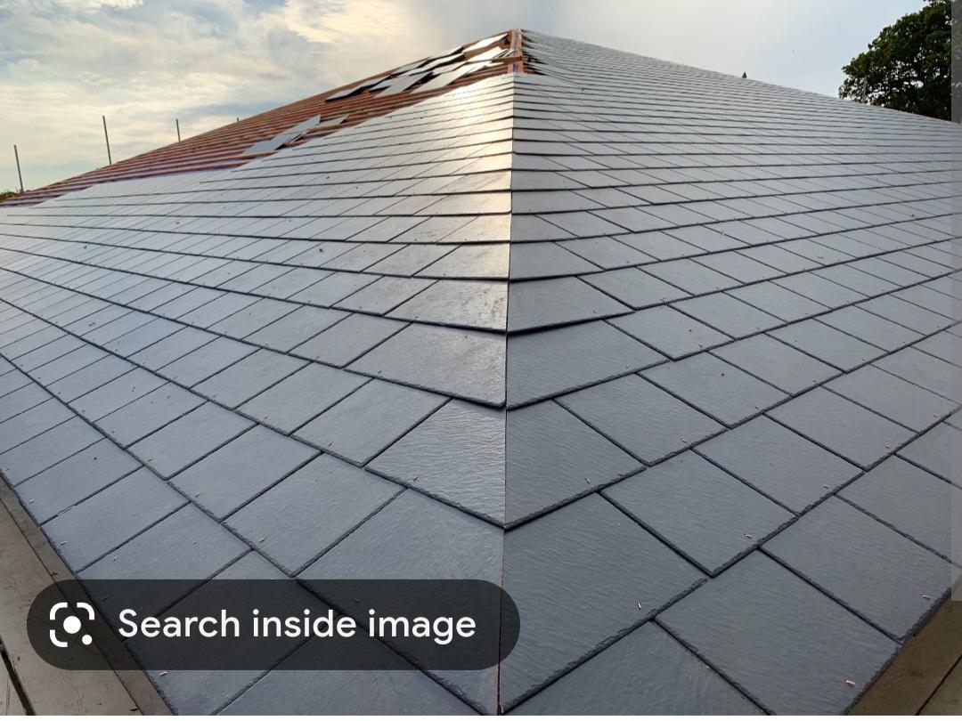

Hooks it will be, haven't really looked at many options re. hip tiles but the couple I did see looked big, will see if there are some low profile ones, think the miter looks sleaker in comparison to the ones I saw.
Probably a silly question, why would hook fixing be good?
Quite like the idea of mitered slate(see pic below) for the hips but wondering of any potential problems with leaks in comparison to finishing with a ridge slate over the top which is what seems to be the norm around here. Anyone go with this or can advise on potential issues.
