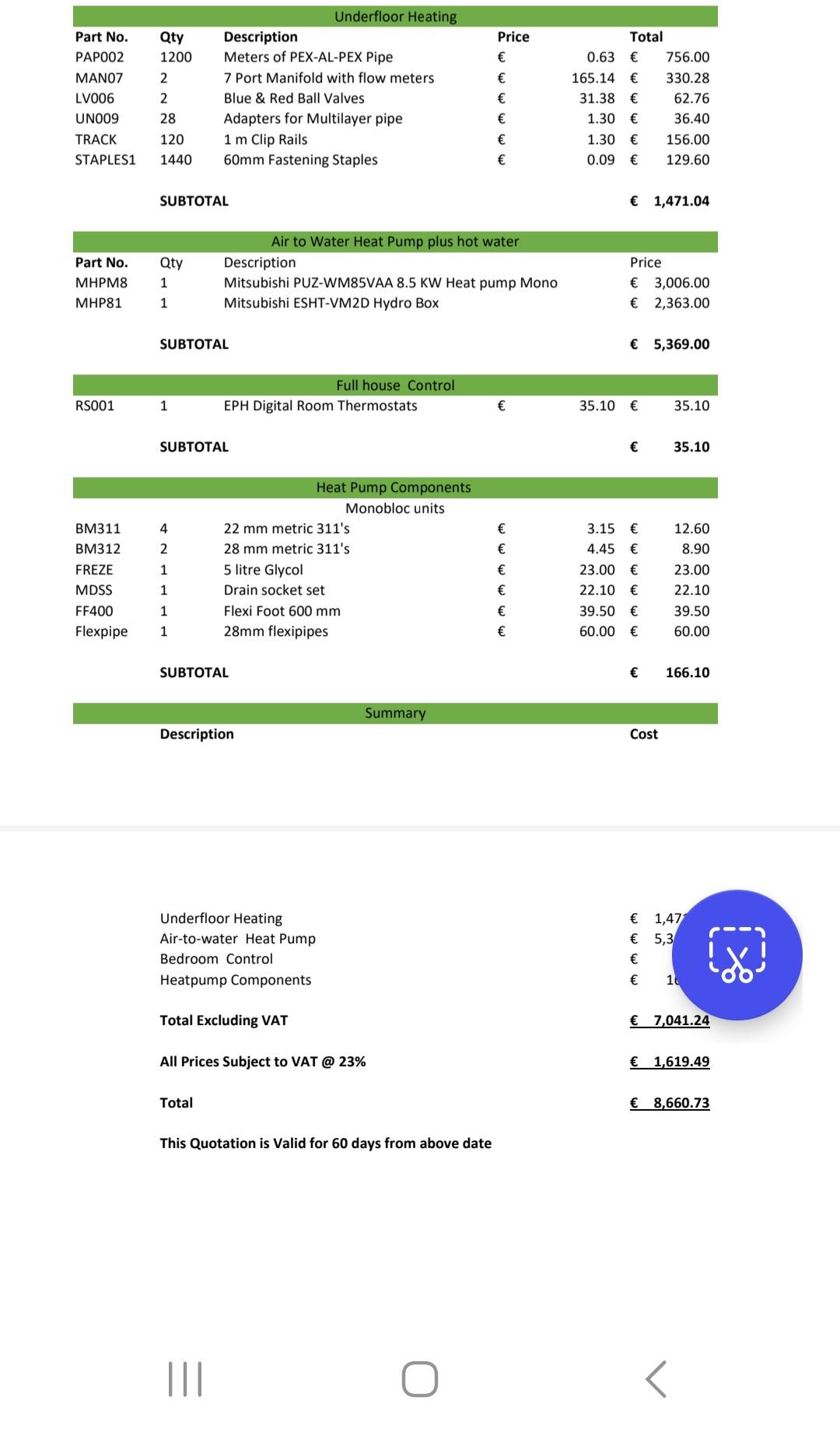

  12. @JohnMo just looking at another quote that we got. I take it that there will be no need for an 8 zone wiring center if the whole house is on a single zone. So just a wiring module for 1 zone. Or is the hot water cylinder counted as a zone in which case a 2 zone wiring center will be required.
  13. Forgive my stupidity John, if the pipe temp is say 23deg surely the floors in all the house heat up uniformly or is it that the pipes for the farthest rooms lose some of the 23deg temp through conduction?
  14. Thanks John, Never thought about the rooms that have pipes running through eg, utility and hall. The 3 or 4 degree variation in room temp that you mention John, is that due to solar gain? re. cooling will have to check if the unit we have selected has a cooling option.
  15. Apologies, 200mm centres, just confirmed with supplier. Pipes will be in 150mm concrete. Had a mate check out heat pump size based off the BER assessment, he came back with 7.5kw so 8.5 ain't a kick in the arse away. Will have to check out hysterisis meaning. Am not sure why a room wouldn't need ufh?
  16. Never tried wunda, wrong side of the pond, did try BPC, around 2k dearer that the quote above, could be providing better quality gear hence the difference, they asked if I would send on the attached quote which I did, awaiting response.
  17. That's based on 150mm centers, 179m2, 300mm eps in floor 150mm concrete and an 8.5kw ASHP. As far as heat loss goes, take it I add up each components heat loss figures, AFAIK the report doesn't give an overall figure.
