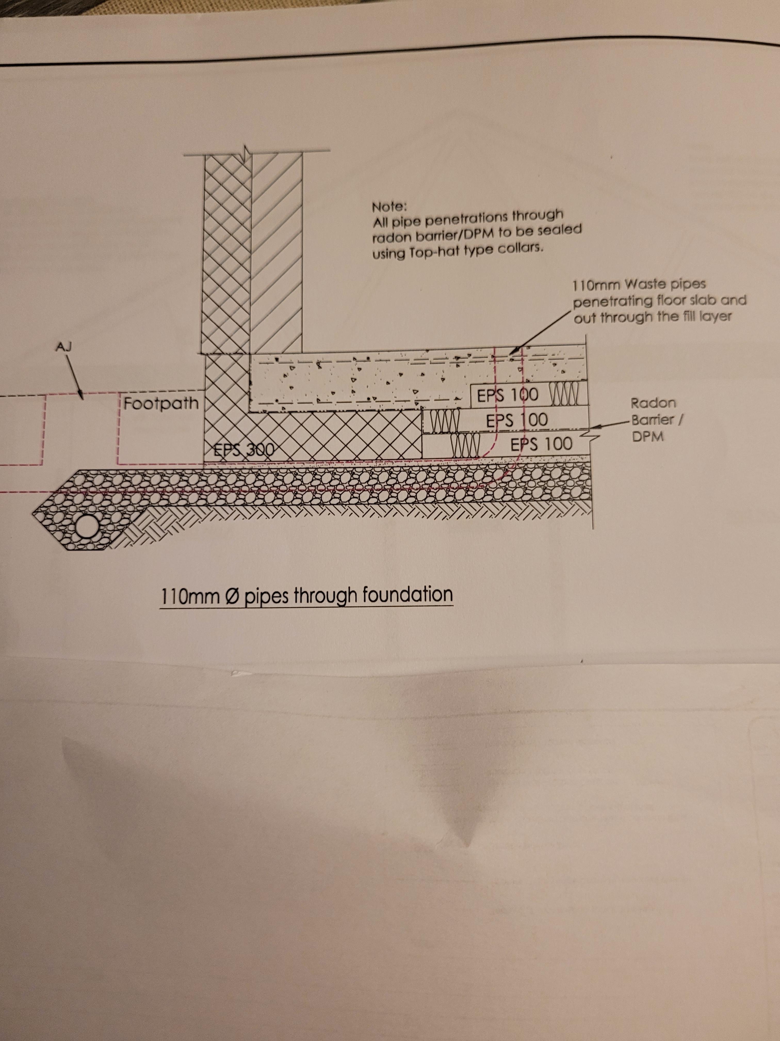

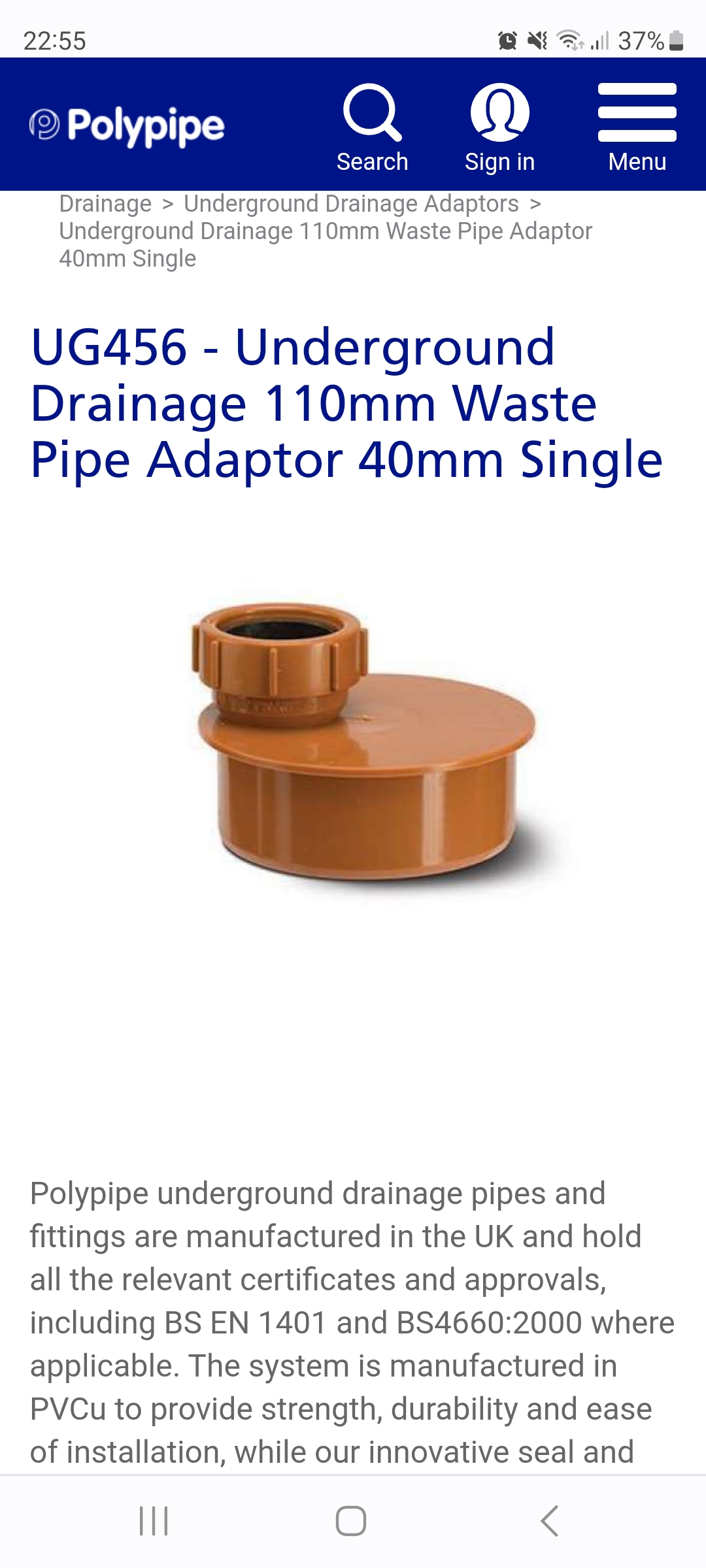

  8. @Nickfromwales so if using a reducer like in the pic the 110mm flange sits flush to ffl?

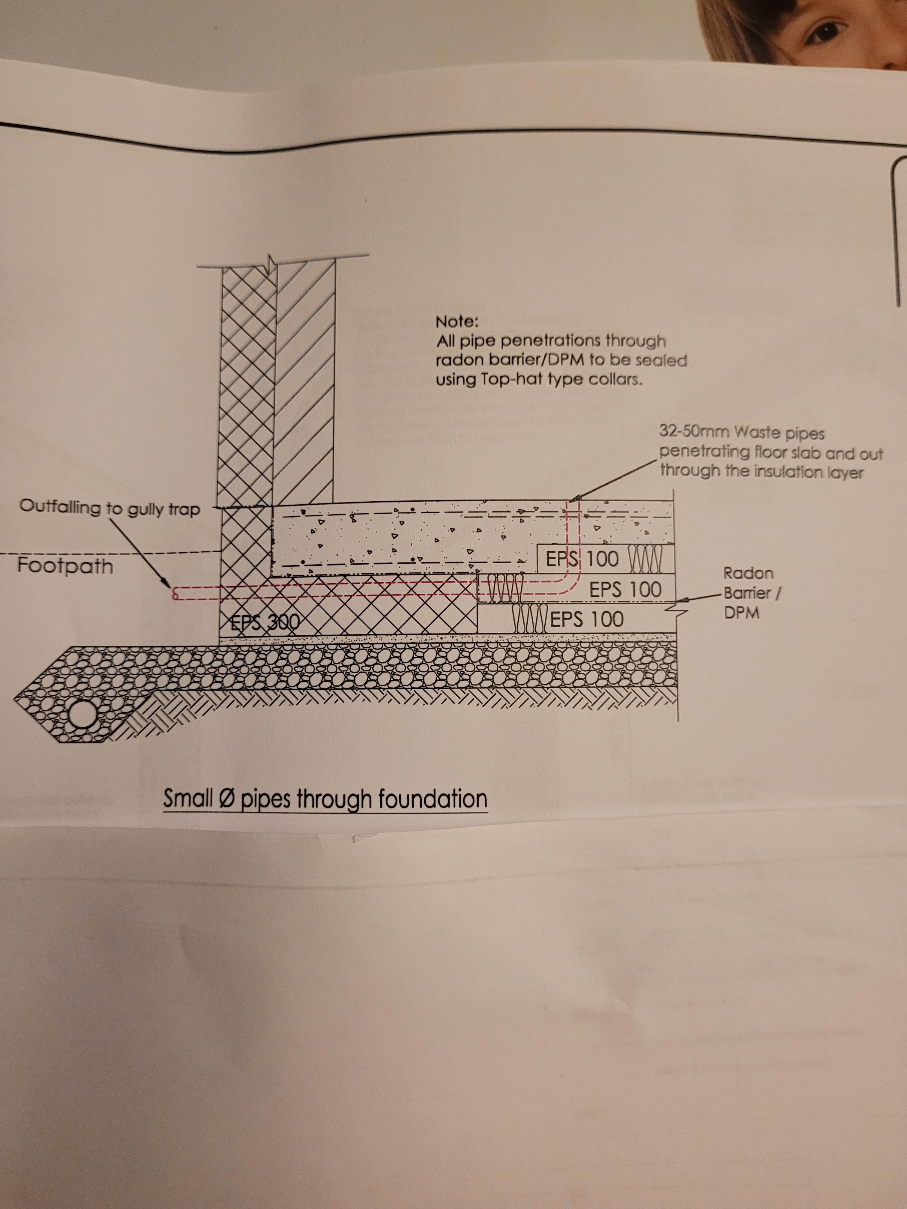

  9. @Nickfromwales Why is that may I ask? does that mean a 4inch pipe reduced down for every sink, shower, bidet etc.
  10. Apologies, have the images in wrong order, but you get the idea.
  11. @Shaun McD FYI
  12. Apologies, should have specified which pipes.

  18. Have seen(pictures mind)Radon barrier/DPM been laid under and also lapped up and over the outer ring beam of insulated raft foundations. From chatting to the guy who maybe potentially putting it in he said you can go either way. Engineer has speed up and over, I can see the advantage of laying under bottom layer of EPS and not up and over, how did you do yours?
