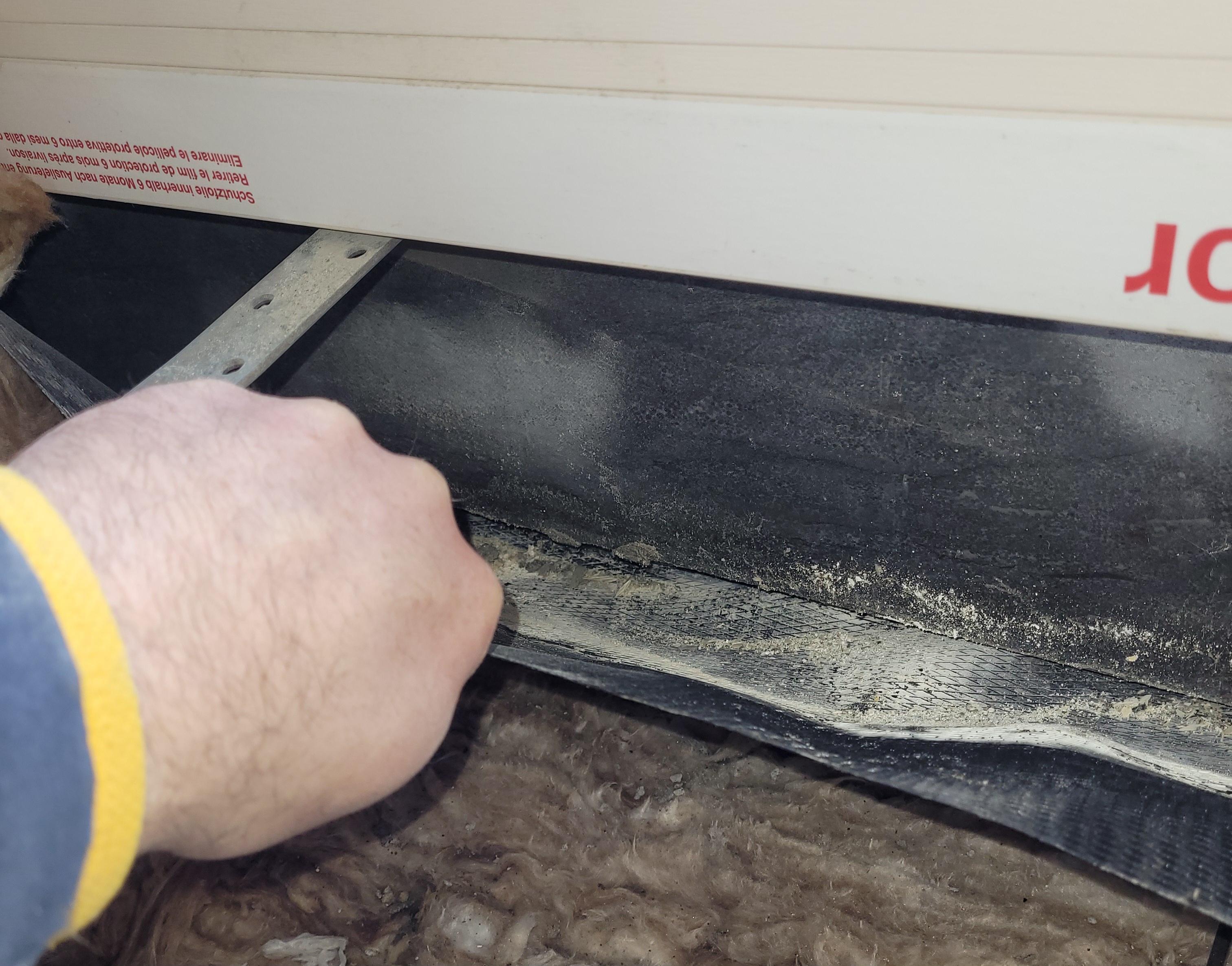

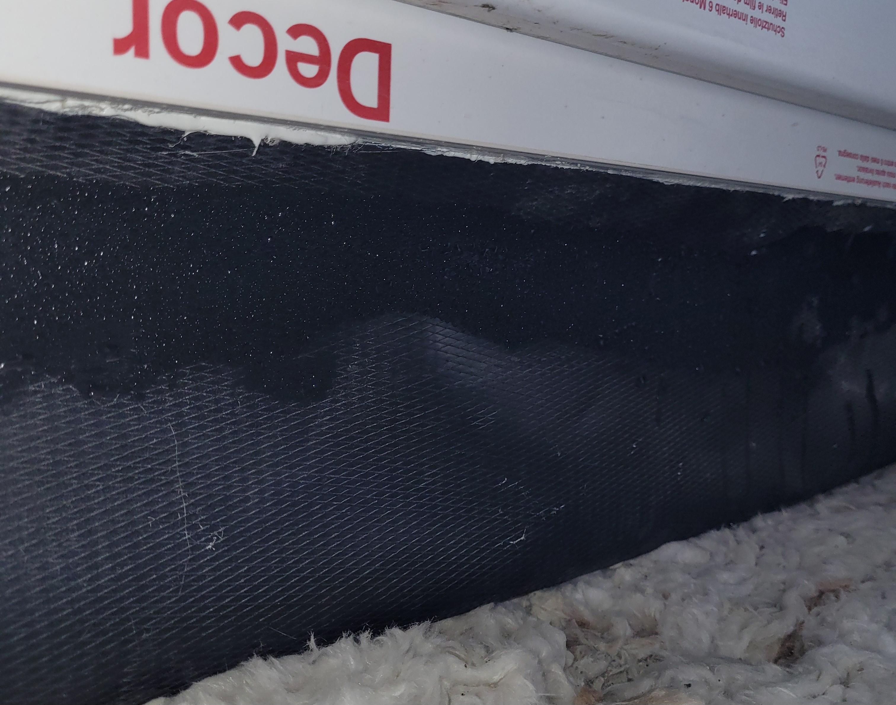

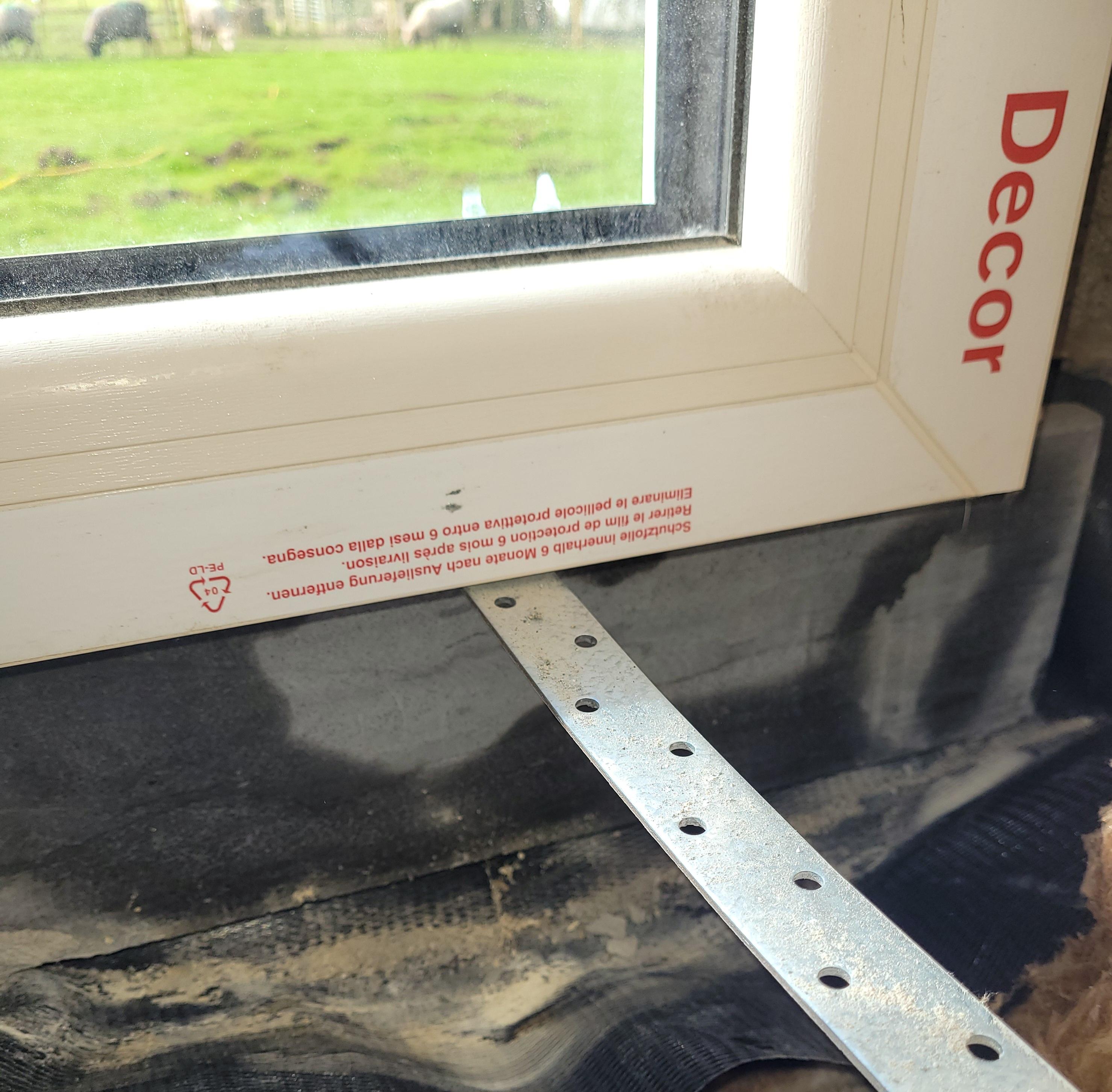

  3. Noticed some out our cills are damp on the cavity side also some of the dpc also has moisture on them. Outside not plastered yet, could this be the cause. Please see pics.

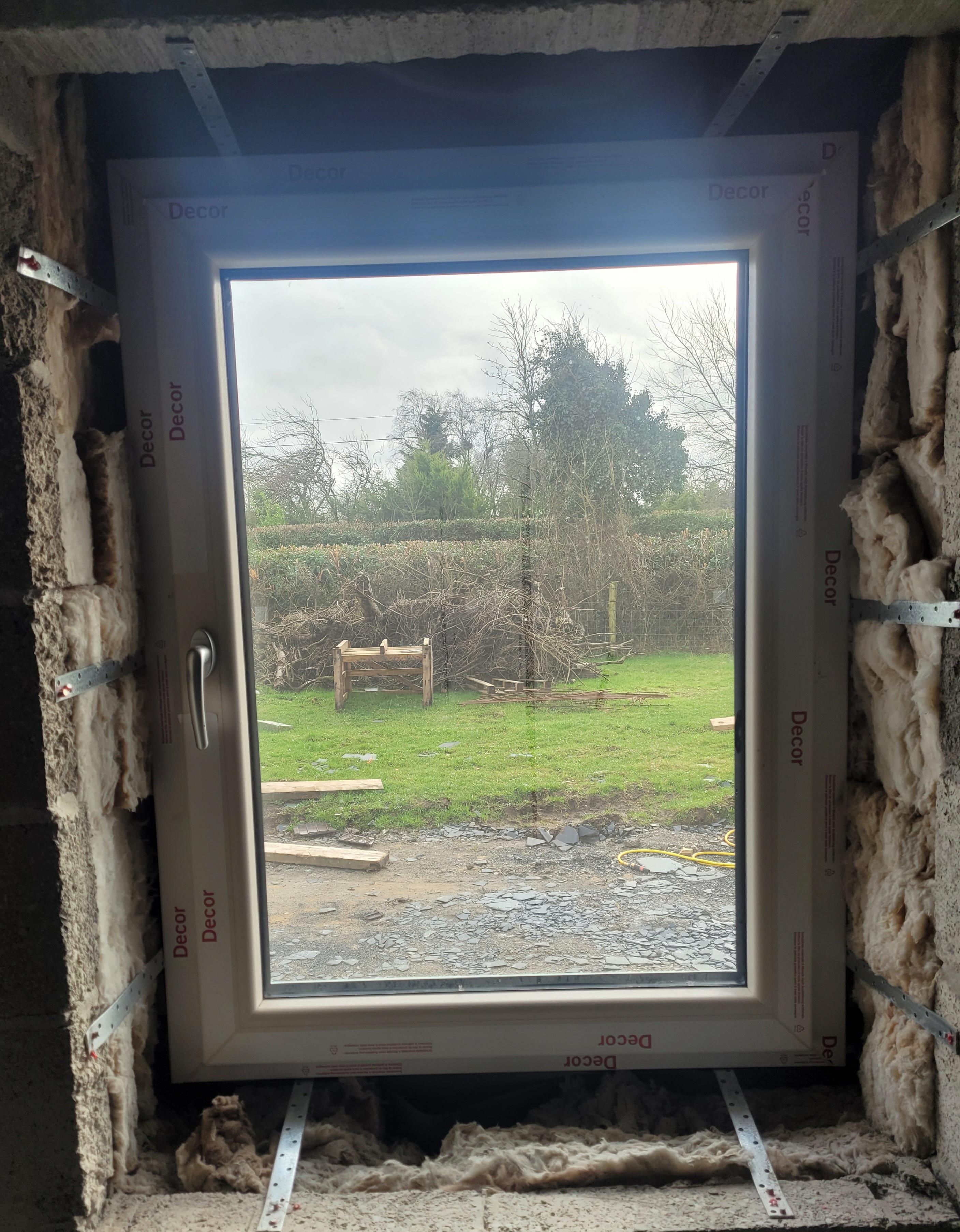

  14. Will take a couple of pics tomorrow as I've nothing encompassing the whole opening. As it stands due to having cut the inner leaf lower(to allow clearance for the sash to open) the osb will foul on the straps before reaching the window frame, top and bottom. Some windows are fixed pane so should be no issue if these straps I.e. top/bottom were removed. But the larger windows that do open there may be an issue due to the weight and twist over time. Any suggestions?

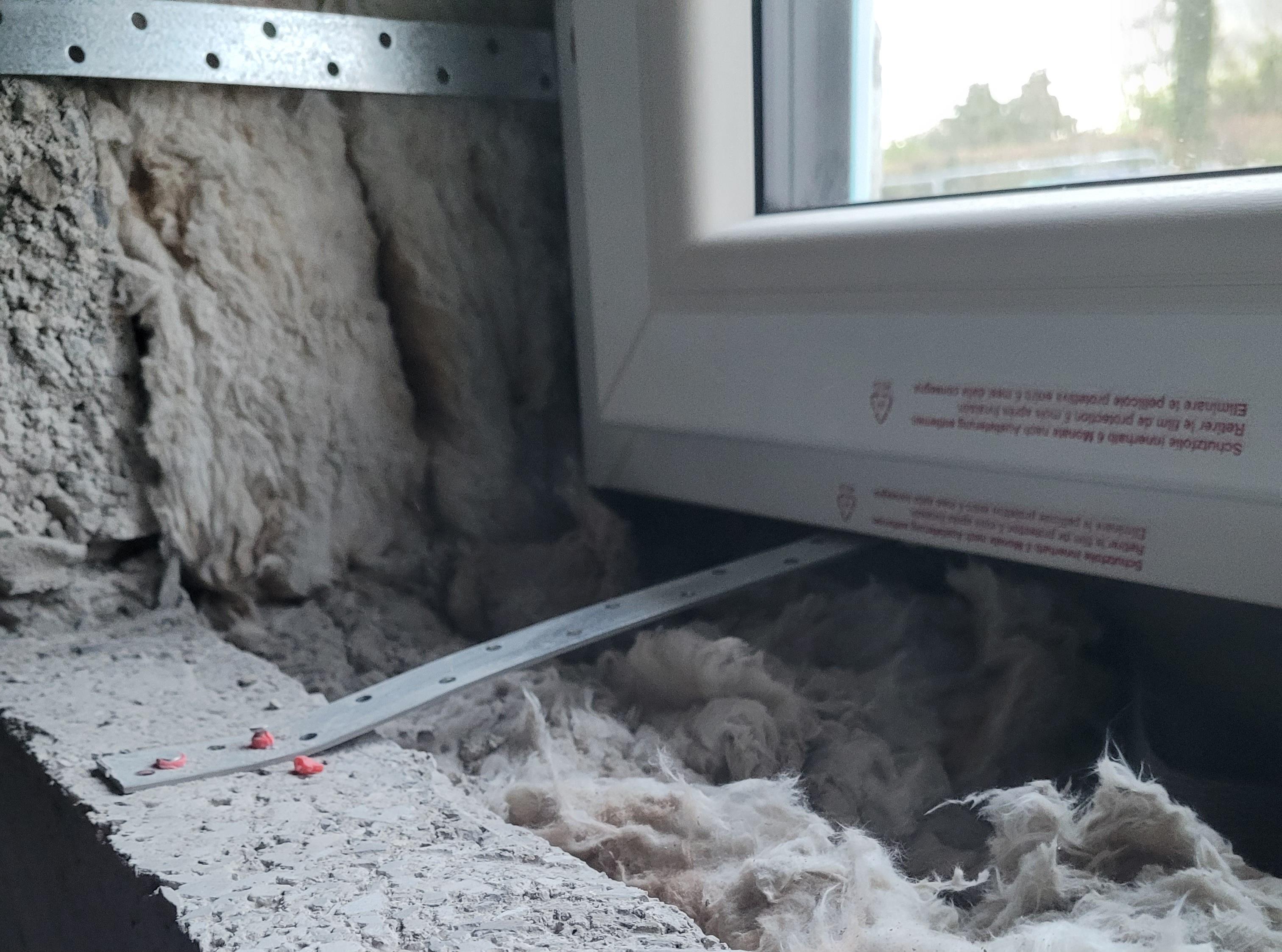

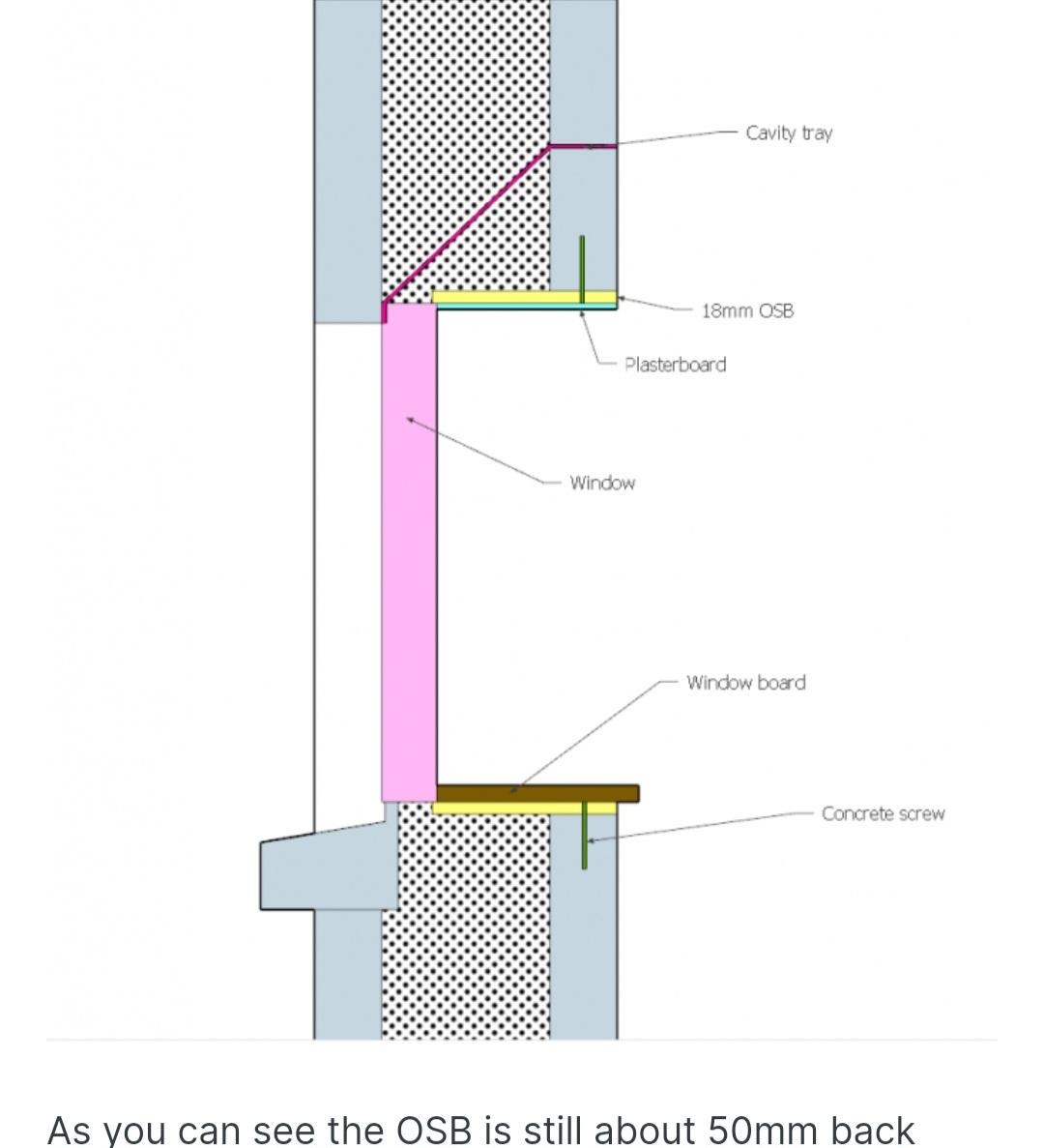

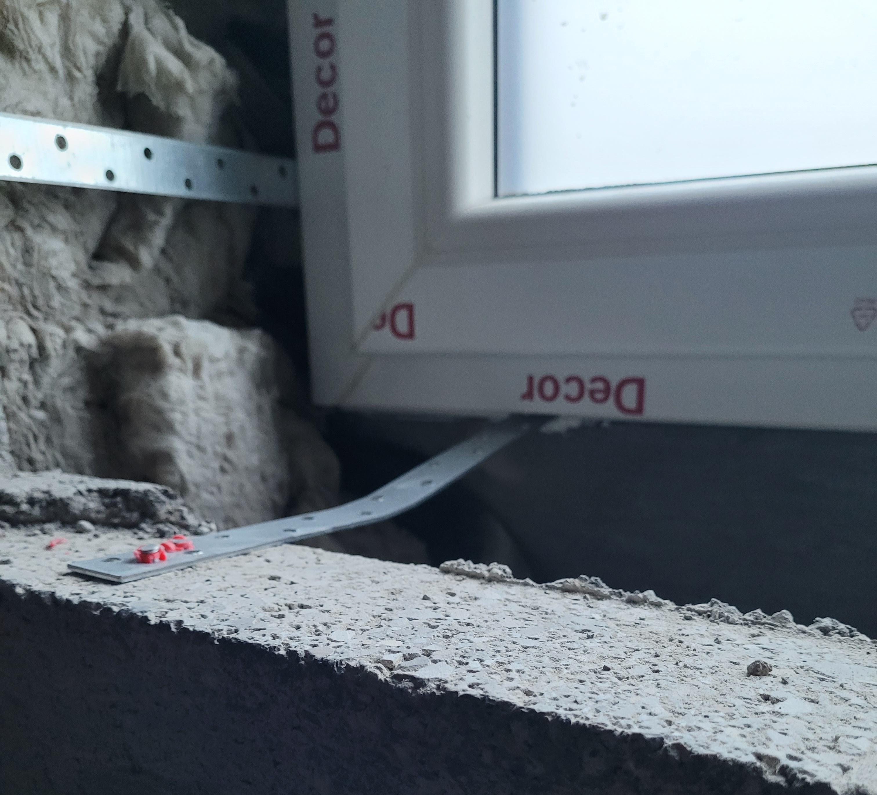

  15. Apologies for late response @Iceverge. So major F...up. The plan was as per one of your drawings below, based on windows being fixed with right angled brackets to inner side of outer leaf. Instead the crew fixed long straps bridging the cavity to inner leaf see pics. Now in the position that we cannot box out reveal due to the angle that the straps ar fitted. What are my options here, not adverse to getting them removed and re fitted. I imagine there are alot of cold bridges introduced as a result of strapping.

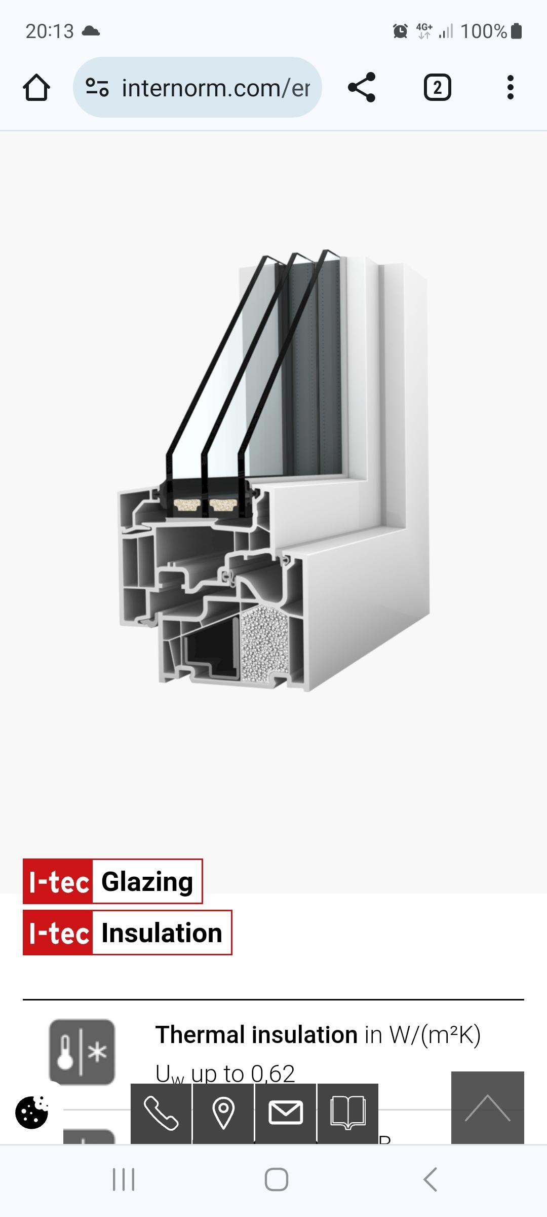

  16. Ah OK, too late for that now. They have fitted a compacfoam variant to the frames, not sure how much of a thermal break that is if even.
