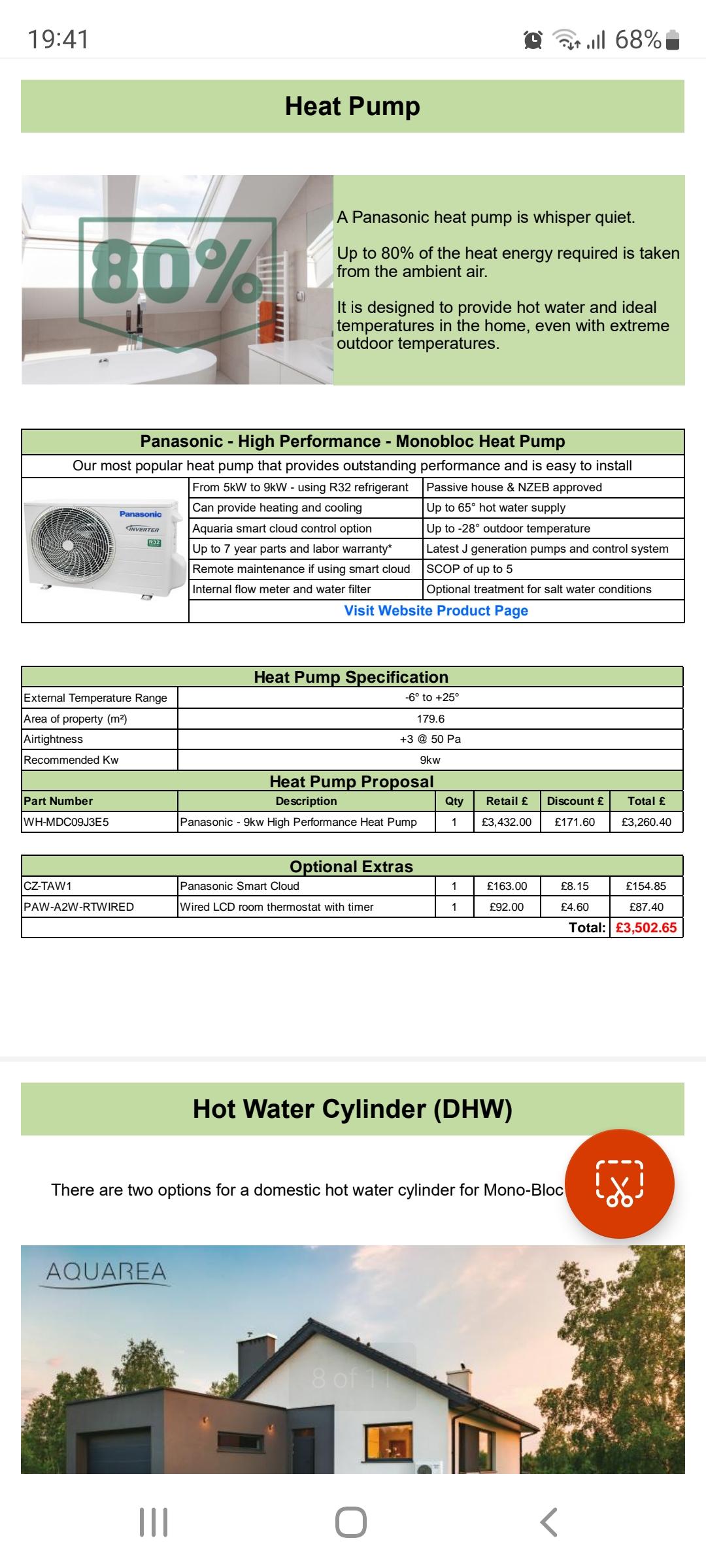

  16. 👍fair play, thanks for that. Silly question, I imagine that 5kw is enough to heat the floor but would it be big enough to also heat DHW? BPC showed a 9kw heat pump on their MHRV quote.

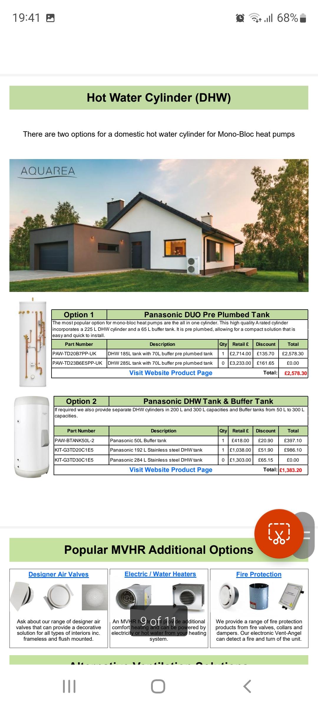

  19. As it so happens I contacted BPC for a quote for MHRV system and they sent the attached quote for A2W as well not sure why, maybe just chancing their arm but it wasn't as expensive as I'd initially thought, though the cylinder is mad money. So It can be plugged in direct to UF Terry?
