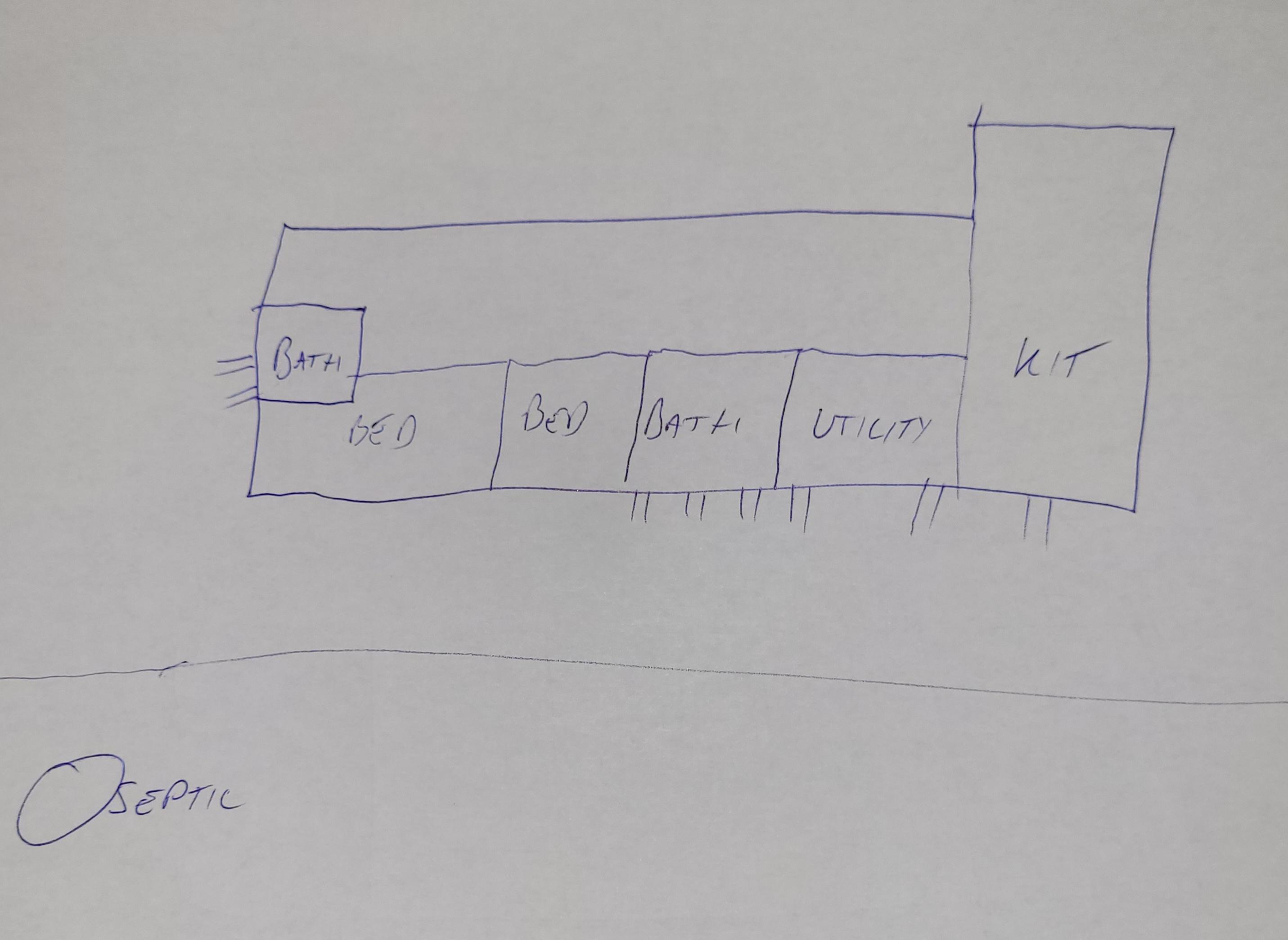

  9. Diy, have taped a 30mm block to a 1800mm level. Treatment plants are way more expensive than the septic and less to go wrong with septic. The perc area is just 5/6 channels with 20mm stone at a depth of 450mm (I think) and already have the stone. Engineer has soakaway's on drawing but could ask him to change, save alot of hassle.
  10. Access junction/Access chamber, we just call em AJ's round this neck of the woods. Percolation test(new build) deemed a septic with Percolation area as suitable for the ground conditions. Haven't installed it yet, my thinking was to get the pipes in first and connect last to the septic. So option 1 it is then, thanks @saveasteading.
  11. Hi all, All the waste pipes at back of house come out at same level from slab. Engineer specced 1/60fall back to septic. Should I put AJ's at every outlet pipe and then run onto a single pipe(with a couple of AJ's)heading to septic or run all outlet pipes to a single pipe with AJ's ( at each junction)then on to septic? See crude drawing.
