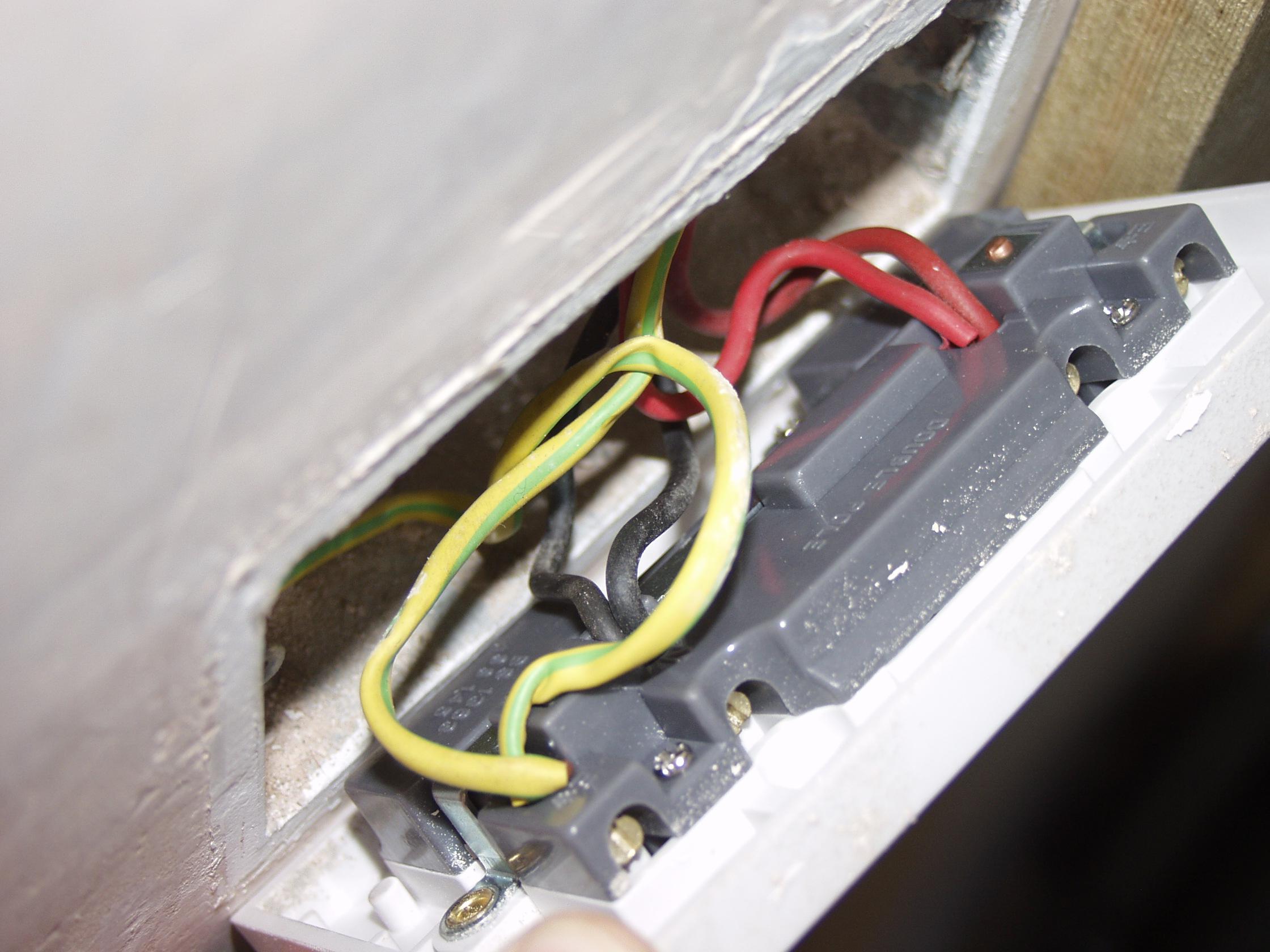

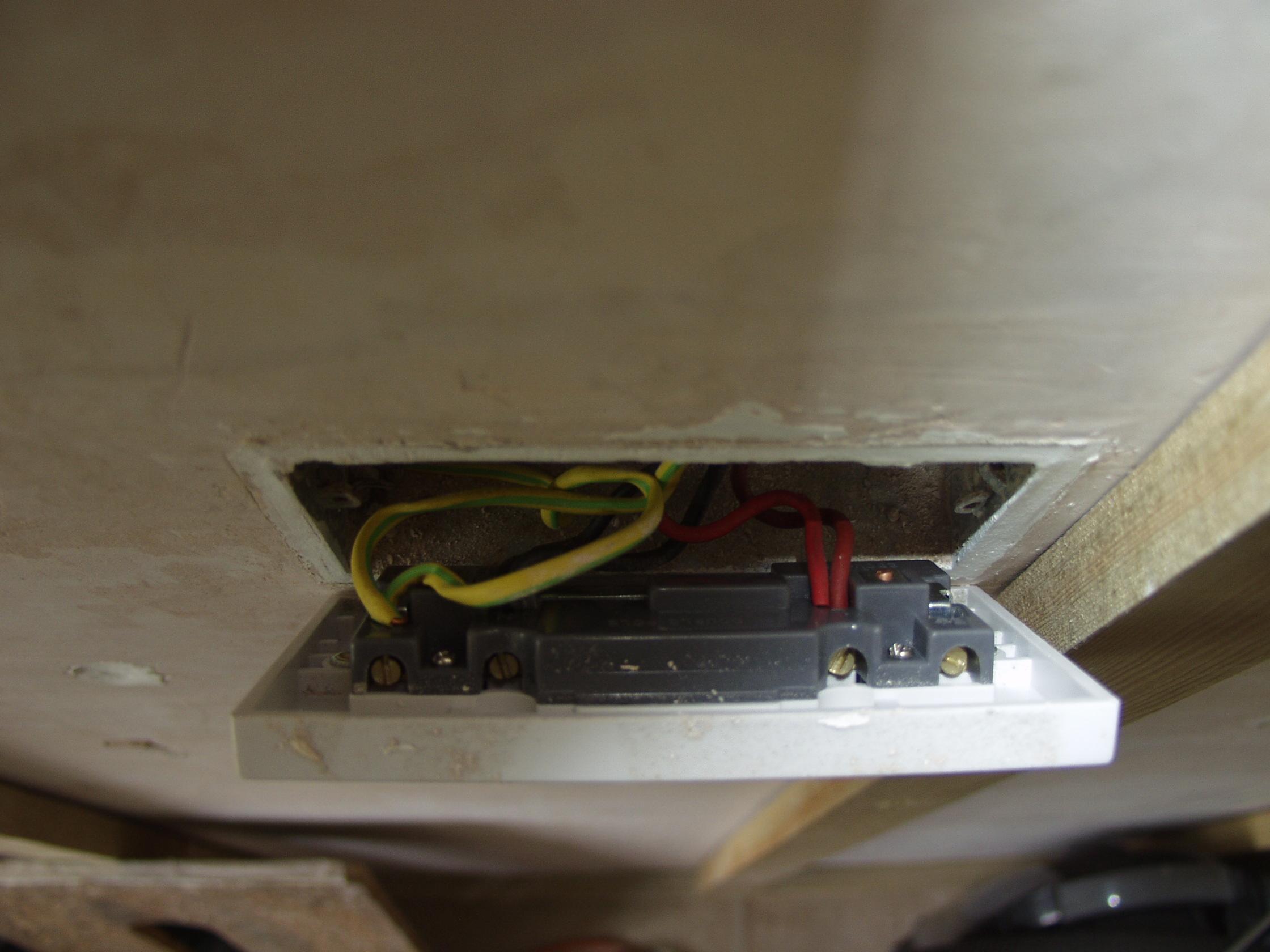

Onoff I'll go with your orig idea of the box extension (that ^ idea looks simplest yes but a bit flimsy maybe) now I'm on board with how they fit together (now seen mine). I was only trying to find s'thing from screwfix as I'm there tmrw/ thought Id found s'thing but wrong, they don't do extensions then. I didn't know the front plate bits were available separately? I'll go with mine anyway/ simplest. I'll have to assume the fixing lugs L & R, the size of the box HxW, & the screw thread too.. are all a standard size so mfr A's extension > fitsm into to mfr B's box (in my wall). Can you just confirm this? then I'll search in town tmrw. I'm electrics aware: as a rule I turn off all/ ie the main double-red flip switch in consumer unit before doing -anything- in the house. I've built fender tube amp circuits (500v at the biz end/ just fully rebuilt a 78 twin reverb), & replaced an old shower unit/ rebuilt bathroom last year too. -

Are you referring to the flush double sockets? or the 3rd one on t'other wall I just mentioned (which projects 40mm)-? -

Onoff Ive said before that I don't get many replies until I reload the page.. this is why I'm late on reading many. I went back over the links you posted, & read them more than once & am trying to understand it.. but as I'm not used to these extentions, & why their needed as opposed to buying a new one, I just didn't/ couldn't on first go at these, distinguish between an extension.. & a box, unless the subtle difference is kindly pointed out. Its obvious to you. Its not to me. I have another one, a single plug socket inplace/ located on the wall yet to do, which protrudes 40mm from the wall to the very fwd point of it (including its front plate). Is the idea with this to leave it in place & PB / C'tex around it?? -

Ah ok understood- thanks. This sort of simpleton talk is ideal for me! so screwfix don't do them by looks of it. So the position of the 2 side screws, & the H & W of the box, are industry standard dims? -

Ok understood. Please don't give up on me! I'm only trying to understand stuff Ive never done before.. I'm still not sure what's exacty inside my box in order to establish how exactly it extends, & how I actually do it (ie, do I need to extend the actual cabletoo.. etc). I'll turn off the mains electric this ev & have a look. -

Ah ok I'm not on board yet then. Your 2 pic egs (just now) seem to be the same.. I assume just a typo.. but yes that sort of thing. But only if its not a major re-faff to revert to this type. I guess it might be better to stay w'one I have, newly replaced anyway (by a 'leccy chap). I have a new 35mm single socket on/off switch w'red light.. here.. can this be used instead of my flush-to-wall one on there at present? -

Screwfix do a 47mm one https://www.screwfix.com/p/appleby-galvanised-steel-knockout-boxes-2g-47mm/29466?_requestid=272602 Am I thinking along the right lines? 1cm proud of the PB preferable than a couple of mm's under, with the 35mm one? mine seems to be 1cm or so proud of my plastered wall after all. -

Onoff, it it a Q (in the case of your links here) of adding these 'extensions' to/ behind my existing socket boxes? I was considering only just now, maybe ditching these & instead put in 2 new/ those HD "industrial" grey metal types.. or is that a big job in comparison I wonder. -

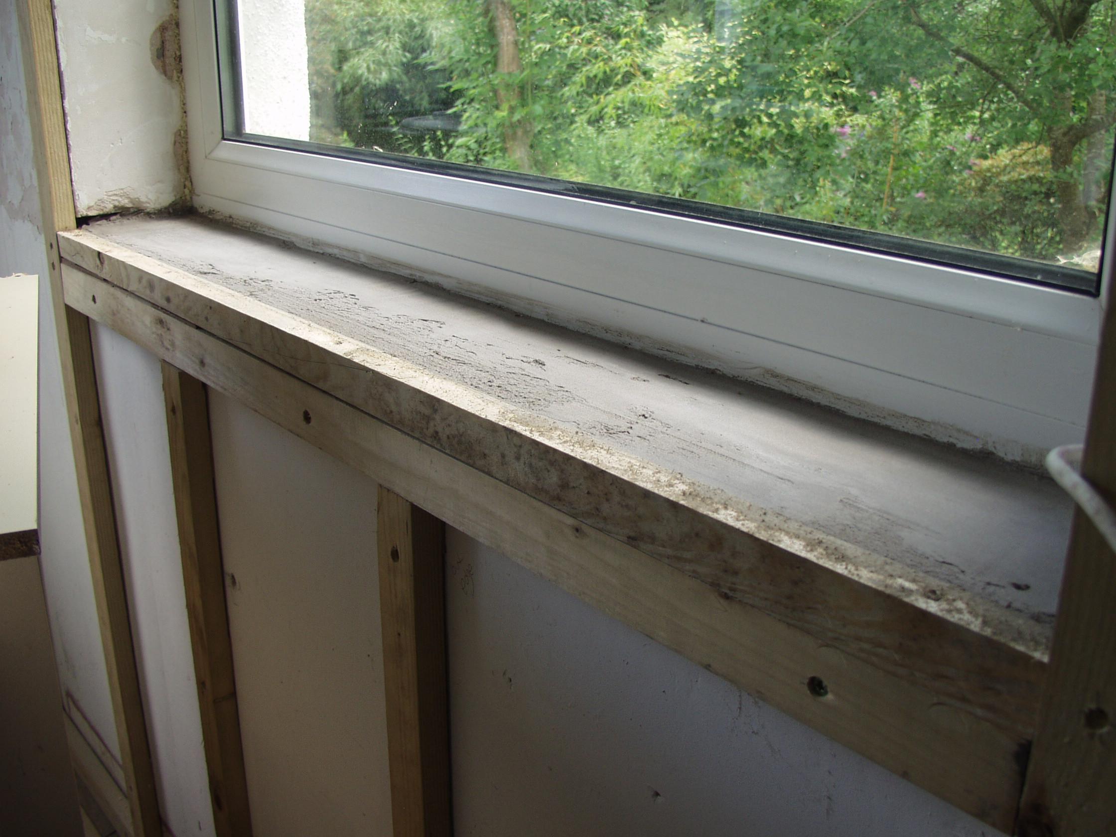

Hehe.. thanks for replies chaps. Very observant. I did some thinking tho: Ive put that extra batten on to bring me mm perfect with the old mortar top, some of which is still there @ front just behind this batten. The old sill was on here/ this H. So the new sill needs to be @ this H too, also bc the worktop's 27mm not 44mm like the old one (which tucked neatly under the old sill). If I continue this top line back to the frame.. Im 2mm just onto it RHS (5mm up onto it LHS.. so window's a bit on the cock). I might add a pine curved-edge sill onto the PB.. to look a bit smart n tarty. May not. I went to screwfix- gave me wrong 'red' Soudal!/ need to go back get the 'blue'.. no probs. tried to find my mortar tub ready mix.. couldn't find the sod/ need to find where I got it before/ ideal for job, for me I think, being a newbie. I need to patch the odd bit too where Ive been a numpty. Good stuff on the 'leccy box info- I'll go over this tonight. Next job I think. TP only do 30mm insulated PB, in end of week @£22 (8'x4'). trying to figure if I can get 8'x4' PB & Extratherm boards in the car. I'll see if Huw's do 27mm.. I don't want to go too 'into' the window frame if I can help it. Big thanks- zoot (weird codeine dream not of me slaying a foam godzilla.. but ross kemp chasing me at a music festival!! codeine...) -

So how do I get it level then.. ? it needs a smooth level top for the insulated PB to fix to.. I cant put a level on the top on wet mortar. Ive got the sill area ready for the mix anyway. Next thing after this is to 'bring forward' the sockets (one double, & one single switch w'red light).. I need some ideas one this: is it a Q of replacing these units.. is that what s'one meant by 'bringing them fwd'? -

I was wondering if there was a small tub or bag of mortar too tbh.. & I've used one before, mixed in the tub too iirc so no spade/ outside mix job (better for me the king of pain this AM). But would a mortar mix be able to 'level itself' Peter like a concrete mix? I refer back to my thickness Q's.. -

So concrete will set 'level'.. but mortar isn't designed for that, more stick onto walls etc. Or, is viscosity a factor in distinguishing between the two, apart from the addition of aggregate & the different sand? And is your link bag able to do exterior (got to shore up a slate step) & this sill? (Id best make use of the bag before it goes 'off' I guess) -

I wish I could have a beer.. havent had one since mid world cup/ not allowed to. I think its looking good.. but worried about once the PB is on re. the contours over my battens a bit. once Ive got this bloomin window area done. driving me mad. Can you see tho the flat splat isn't brick or old mortar.. its the foam beast, cut down. I don't alas have anything solid to glue anything onto. If I went sharp sand/ cement > do a mix Id have to buy a bucket of sand min & a bag of cement > 95% left.. And costwise too just for this.. What I need is some stuff I can as you point to (I think?) pour in & it'll level itself. Is there not some sort of small bag of gubbins, fit for the job? -

The foam monster's cut roughly flat, but Ive been a muppet & forgot the batten addition at front. Bugger- this sill bed is prooving the trickiest bit. What the heck do I do? the surface is so rough its not feasable to fix the PB onto it surely.. Ive also got to add the batten which will mean building it up again with something/ what Ive no idea, or trying to trim -along/ longways- a batten to get it to 1" > then cut the foam down a fraction. I'm not happy about it as a base for the sill to fix to- it seems just not right it seems to me Do I have any other ways of doing this?. -

No- I can't cope with mine let alone follow another! I need a productive day tmrw. Can someone advise how I do my sill 'bed' once Ive tidied up the foam? it'll need something to fill & make a flat area, in front of the foam 2" twds back, on which it'll sit. Ive seen onoff's info, but its so neat.. & I can't tell exactly how he's done it.. esp to get flat & level as will be pretty important I guess. Then I can crack on with the C'tex/ that should be a productive & satisfying job > then onto the dreaded PB job. -
