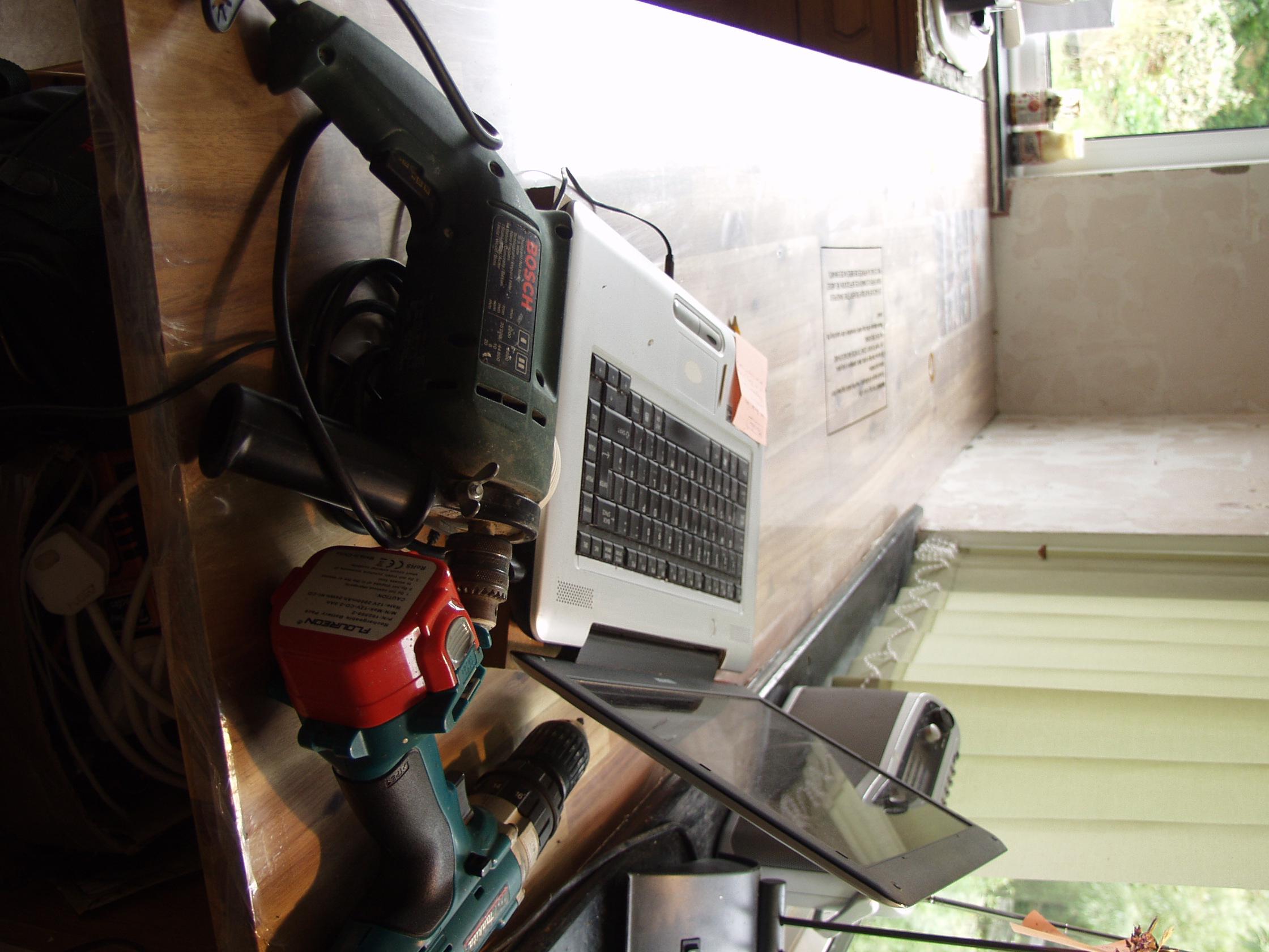

Chaps- I'm thinking of doing a 'proper' job first: ie, add insulation to inside walls (2 walls to do only/ 2 adjacent to EXT). Would you be kind enough to help me on this? I'm thinking 1", 2" will lessen INT size too much. These 2 walls in pic 1.. I've also got foam ceiling corner curve things as you can see.. should I rip out, or (as mostly firm) leave in place/ keep/ work around? thanks.. zoot -

Ok progress/ renovation underway: worktops here, knots all over I wasn't expecting.. but for £30 I can't complain- homebase VG to me too. 1) Ceiling paint stripped to bare plaster. I must now think about adding to the walls with 1" or so of insulation etc (before I strip walls/ a terrible state, a heck of alot of work to prep). Only 2 walls adjacent to exterior: sink wall, & laptop wall. The other 2 have two adjacent small rooms: behind. All 3 rooms within the simple square 80's single story extention, w'pitched roof (insulation added/ job done last year to loft above all). I need info on the insulation/ wall addition job if you would chaps.. I'll weigh up if its in my skillset to attempt then. I guess it does mean taking out all the units these 2 wall sides? Thanks, Zoot -
Joe90 a gentleman you are, thanks/ just as I would do, a photo of a sketch much easier to visualise than a pc image. All makes alot more sense now I can see this & sort of what I thought of after your suggestions. I think this (sketch B) might be just the ticket: but others' opinions would be welcome before I go with this as final idea. What I'll do is pass this onto my builder.. he'd never heard of groundscrews, at a guess maybe a recent 'invention' of sorts for him. He & I could do easily I'm sure.. but prefer if a pro on board with me/ alot (in my world anyway) being at stake to sit ontop.
