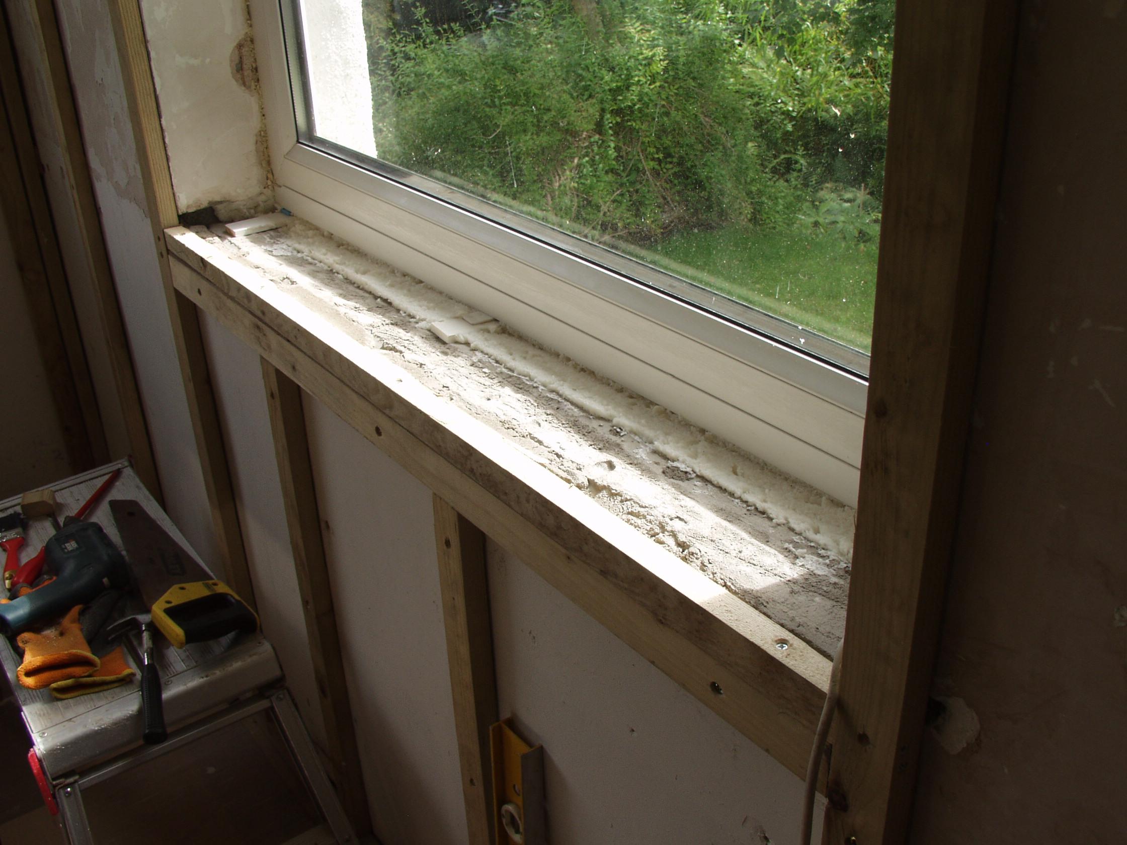

Cheers Ferdinand.. useful having some encouragement. I took the plunge today & ripped off bits Peter noted (BFO red marker) & altho I scratched the frame to chisel superglued bits off, & altho the window -does- seem to be fixed in by foam alone (alarming!).. job done. Frame seems solid & no gaps to fill in fact top or sides, just the sill. So I'm ready to tart the sill up. I'm ok foam-filling the gap, but how to make a new level area in front of it? is it a Q of mixing some mortar stuff up making a wood surround to put the mix in front of or s'thing? a 5min job for the experienced.. but a head-scratcher for me. thx zoot -

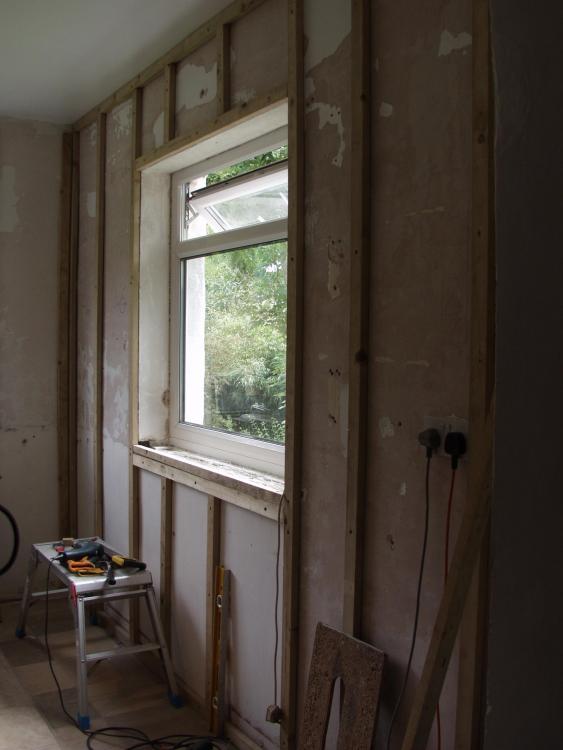

Damn got wrong foam then. Ok to planB: I'll have to try do the job with my foam & its sh*tty attatchment even if it can only be used for the sill job. So here's the wall done so far.. alas there'll be some in/ out PB variation over the battens.. but impossible for me to shim to level unless a days more spent on it (the wall badly fluctuated b4/ Ive done pretty well to level out some of it I think).. at least the units will hide alot. I'm going back over your 27mm insulated PB info/ pics.. maybe this is the way to go if £feasable for a small area. Onoff is it definite neccessary I use a dpc on the sill job?? I understand what they're for etc.. its just that this is a renovation rather than a build, ie, it had no dpc issue before, or any evidence of damp after recent rain. And yours is a continuation of the walls' dpc which looks like the latter stages of a complete build, unlike mine. thx zoothornrollo -

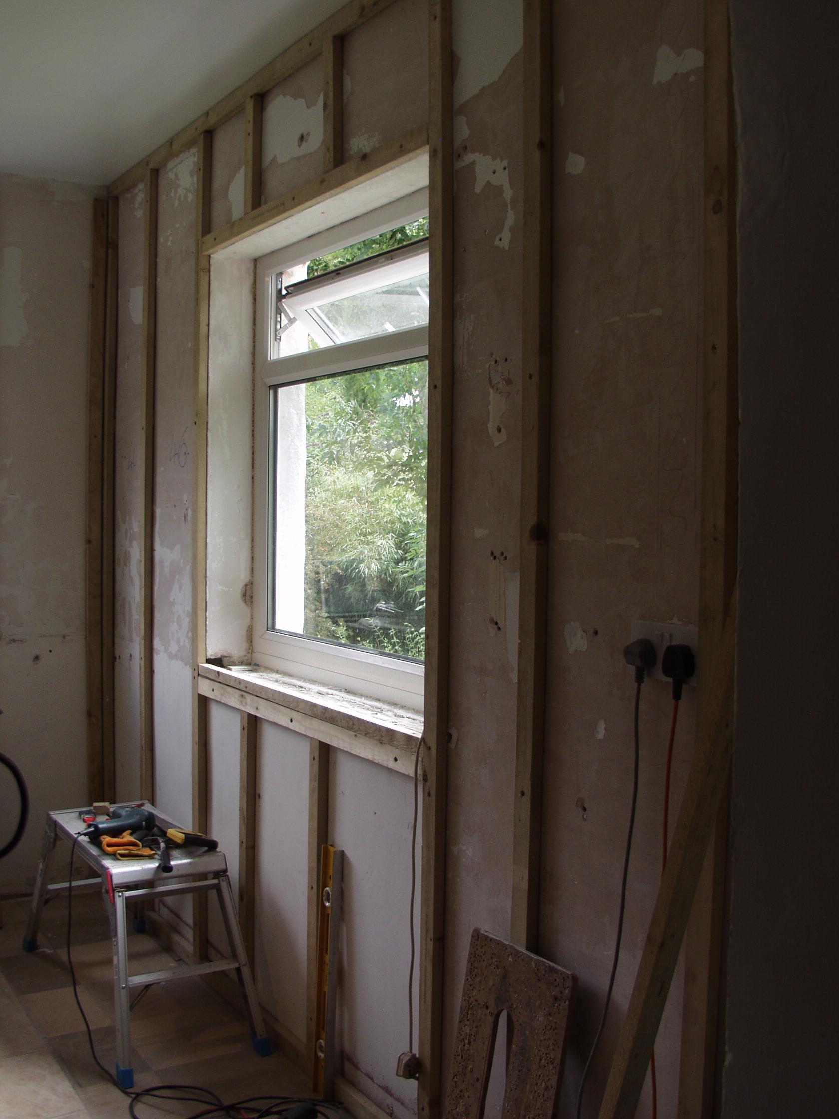

So far.. the veerticals done on 1 of the 2 walls. I need advice on getting a batten onto the top lip of the window.. Im sure its a lintel or s'thing I'm hitting but I can't drill enough depth. -

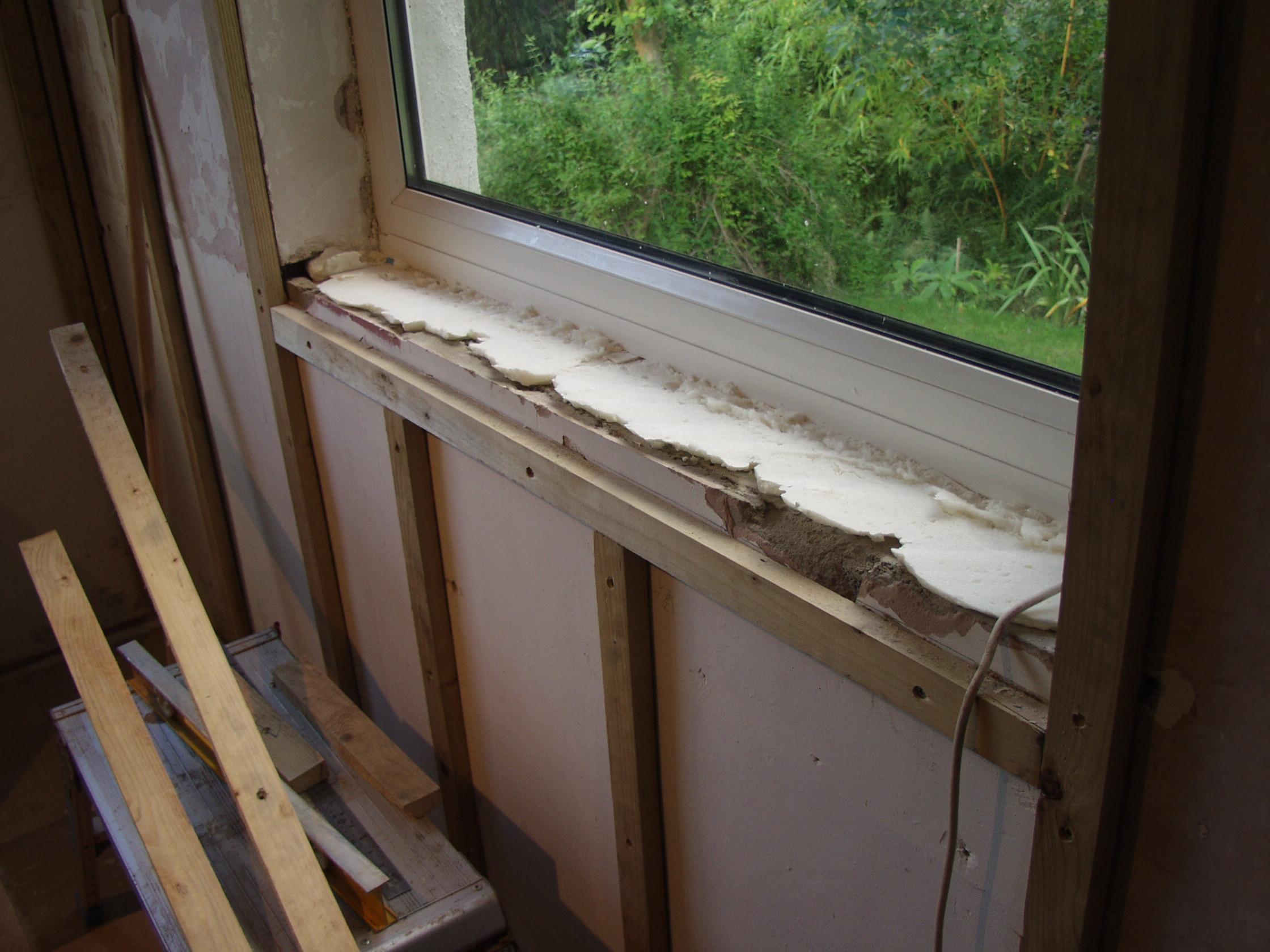

Yanked the sill out- took some block away tho @ top mind you. I get a big draught from the cavity: is that normal? I find a 2" cavity between 2 blocks, with some 1" C'tex on the inner course. I thought it was 1cm in fact/ so the Insulation Co told me when they came out & probed in (last year- having this C'tex meant I couldn't get a grant they said).
