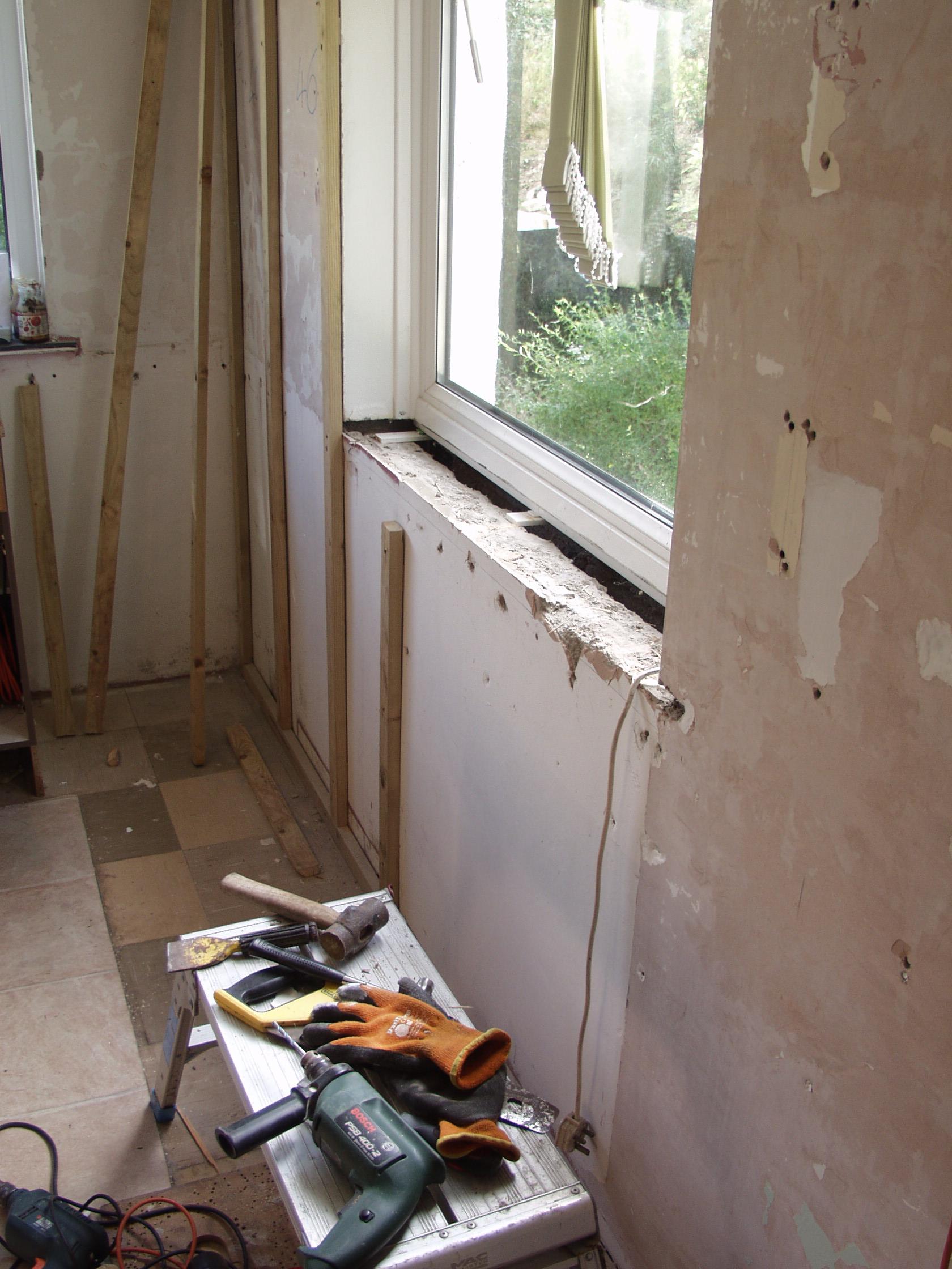

Yanked the sill out- took some block away tho @ top mind you. I get a big draught from the cavity: is that normal? I find a 2" cavity between 2 blocks, with some 1" C'tex on the inner course. I thought it was 1cm in fact/ so the Insulation Co told me when they came out & probed in (last year- having this C'tex meant I couldn't get a grant they said). -

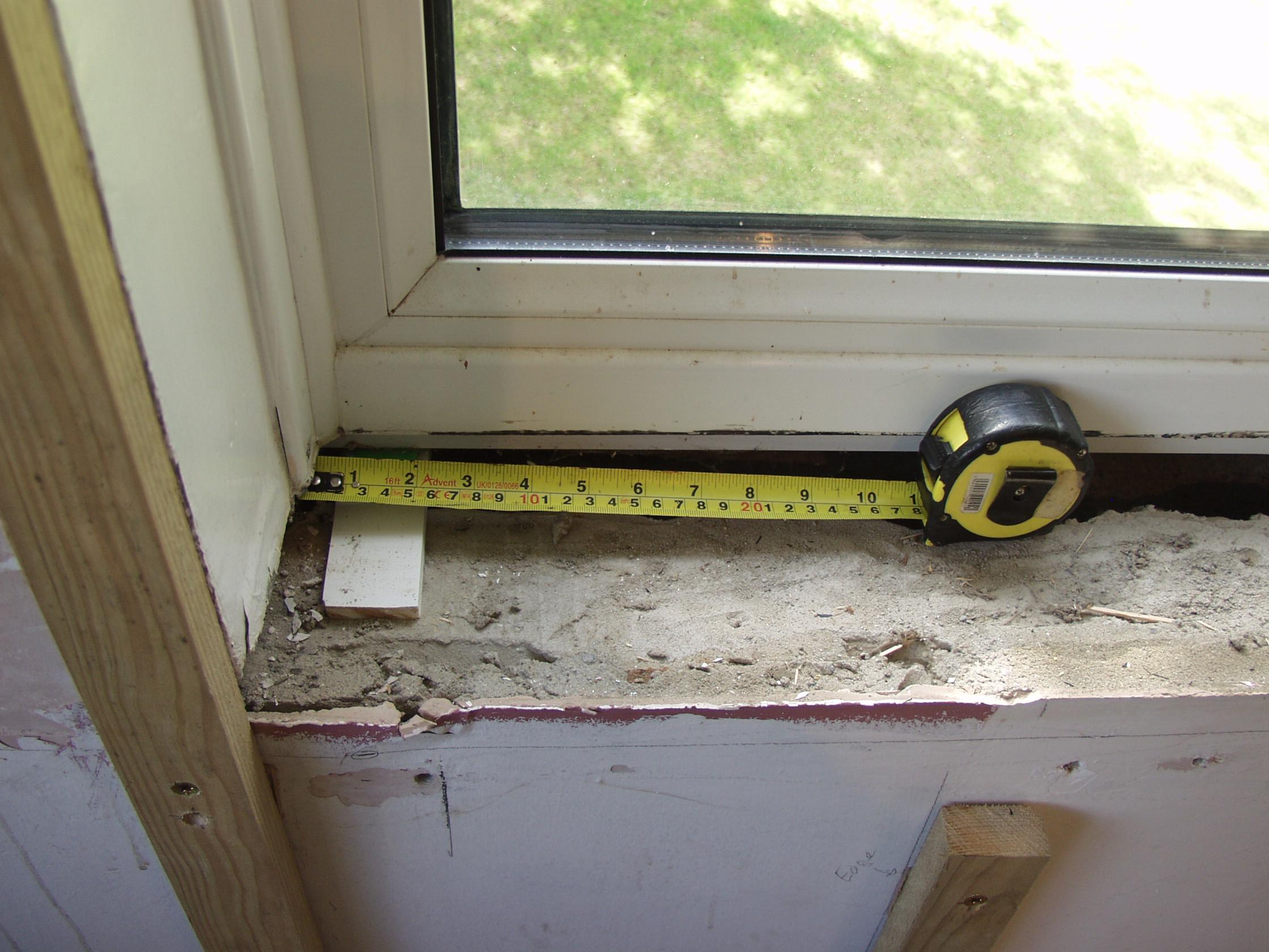

Great help onoff (& Peter esp with that pic- v.useful too).. I'm back on board with your info, near all: a "tapered edge" is what tho.. a me-cut edge sanded/ de-burred to neaten up the rough edge?? (or do you buy/ ask for 'tapered edge PB'). The worktop will actually meet the sill (bar 1/4" gap, as its 27mm acacia not 44mm top like old one).. so its just the wall above window to smooth out a tapered-square edge joint, at this PB meeting point. So ok I go from RH wall 'back' then? I'll try get the sill out then. Now, I notice the general way to PB the reveal is -not- including C'tex. Is that right, or, should I consider C'tex on reveals too? I'm thinking the cold will spew out around these 'weak' areas. Or is it just 'too big faff/ don't bother just PB is normal way here'. Thanks, zoot -

Ok thanks Peter.. I'm trying to figure out which is most economical re. PB taking into account the other wall to do you see. Without experience I'm bound to make a cockup on this or some other pg1 thing. And what would you do with my black pine window sill too? it won't quite reach out to the PB with an annoying gap of 1/2".. plus another annoying 1" gap below it (to the horizontal batten the units will fix to- guess I can fill this with a sliver of C'tex or is that too fiddly/ stupid?). -

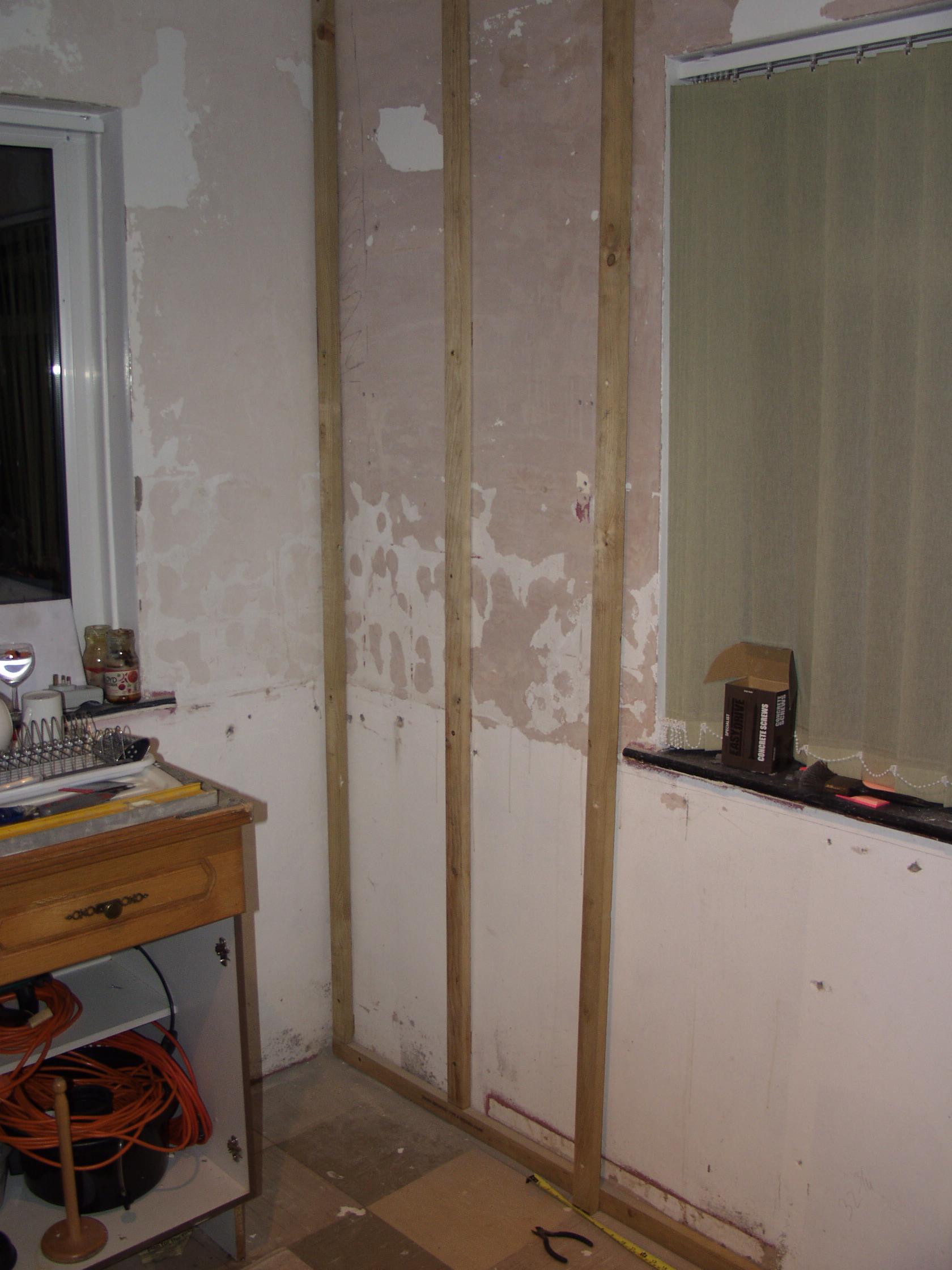

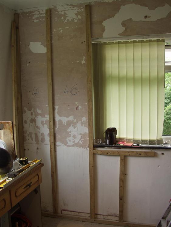

(not according to onoff's diagram below the kids bedroom diagram a few posts back newhome.. from midpoint of 1st batten to midpoint of 4th). I don't know how to proceed as I have more than 1200 each side. Assuming I have to put a vertical batten on RHS edge of window, as in my pic below, to facilitate the window reveal boarding.. & start the battens from the RH wall corner "back" twds the window @ 400.. do I cut it at this window batten midpoint (~1100), or add another one bang next to it to get me to 1200? Then fill the middle vacant area above & below the window with 1 more short batten/ cut a small bit of PB to fit?? -

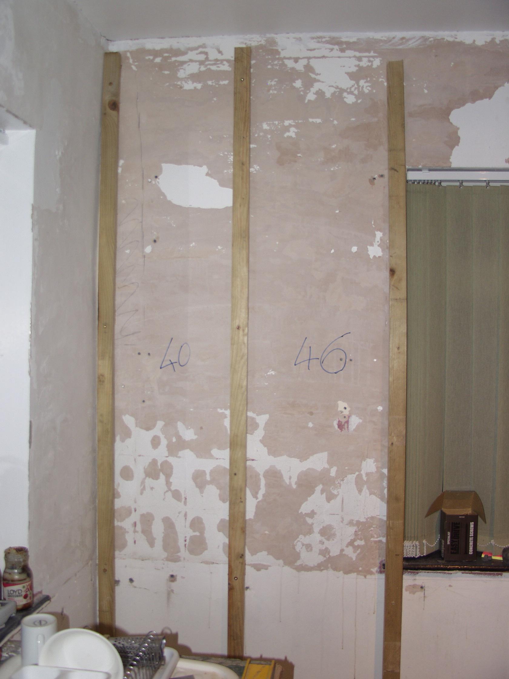

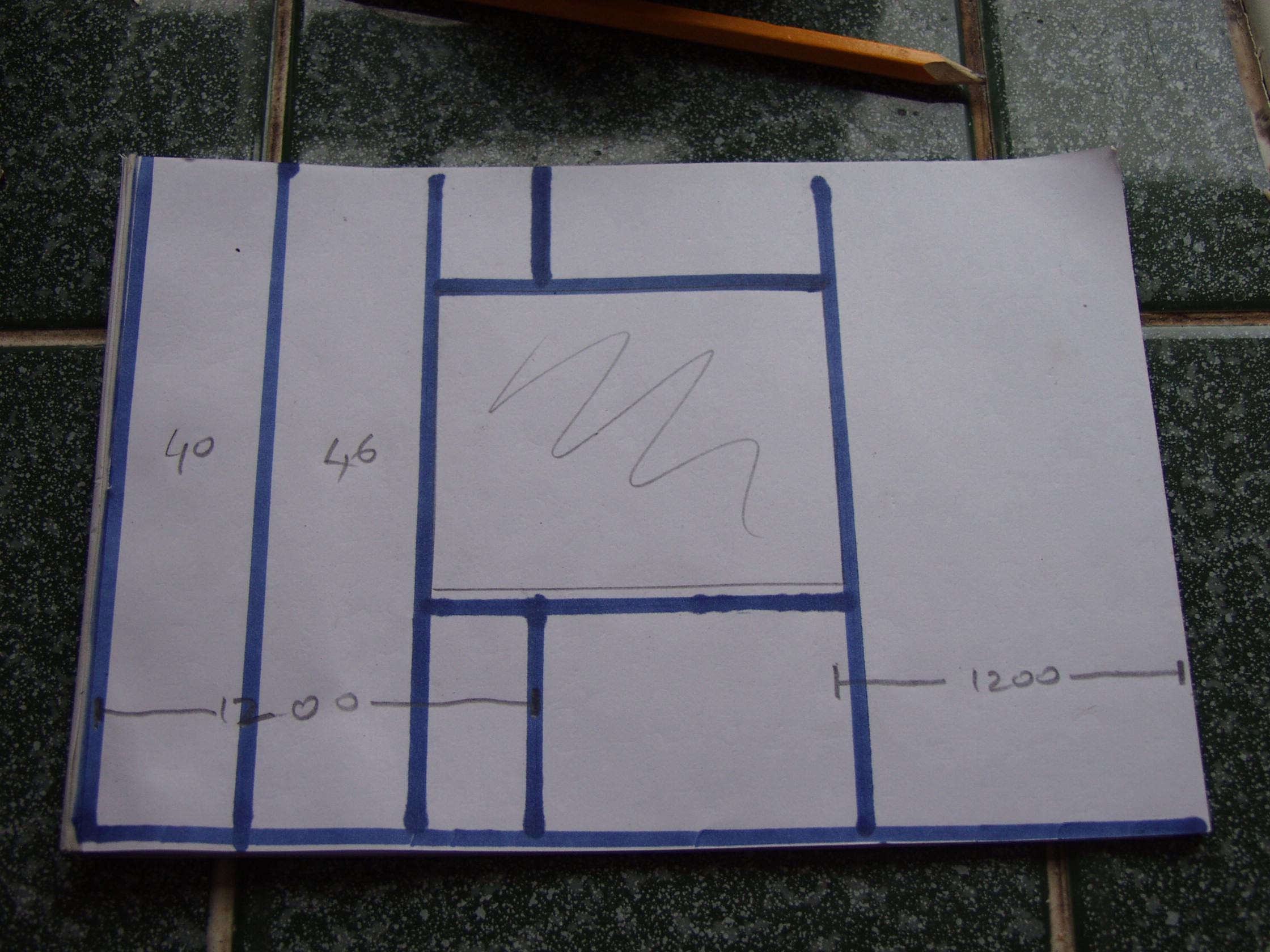

I hope its as per the "1200" diagram below the 'kids bedroom pic' in the post above this ^.. cos that's the way Ive done it.. ie, centre of batten to centre of batten. Can someone say if having got to the window.. I should be doing the same working back from the other corner of the wall, twds the window? -

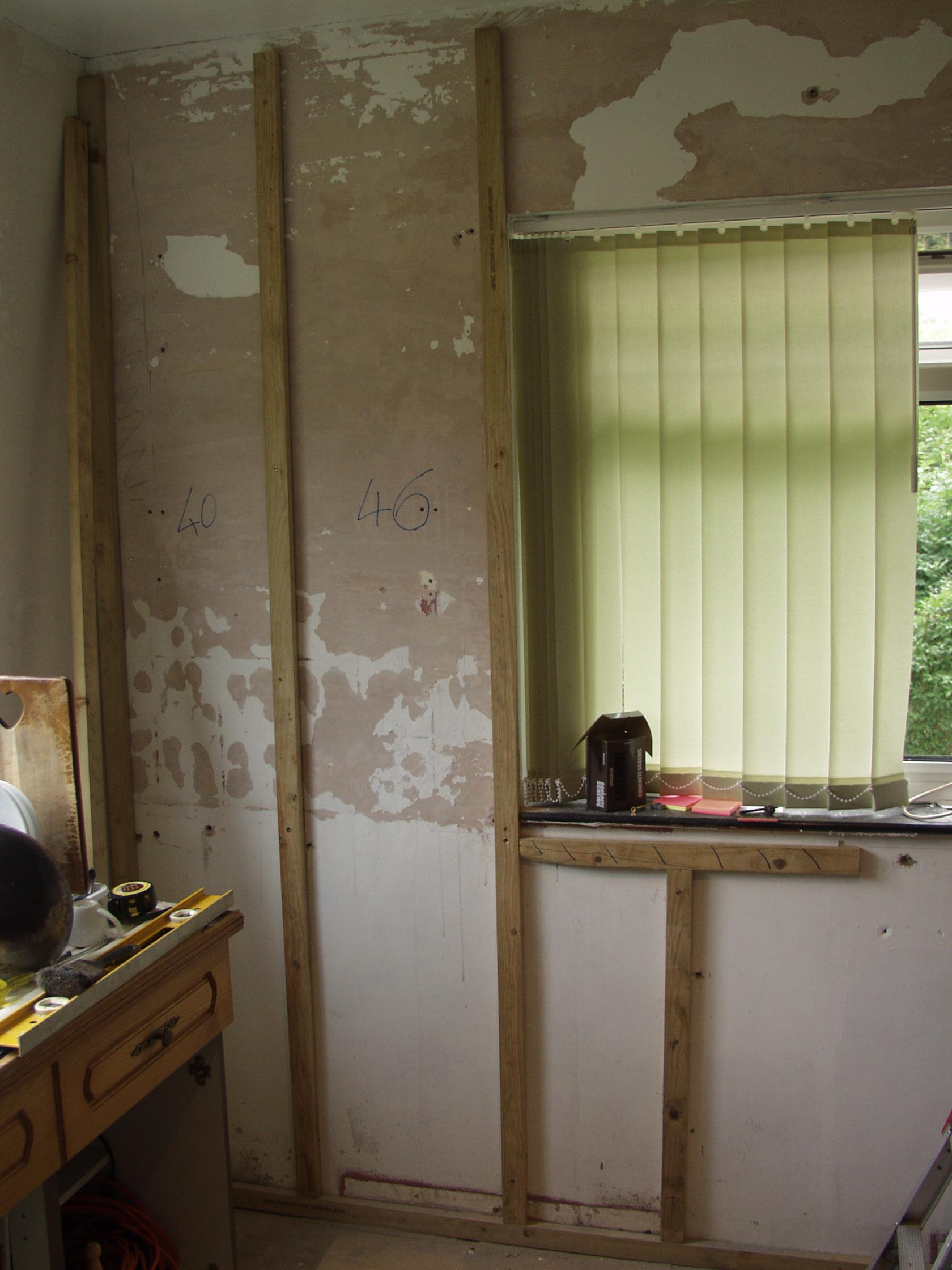

Hi onoff.. yup been looking back over your useful pics. Done no3 @ 46cm, & no4 @ 120cm from no1. I had thought to line the window reveal with PB onto inside & batten edge.. as I can't see how the PIR would fix the the inside back of the reveal side.. its too complicated to explain where I mean let alone do it! So having done as below, is the idea now to go from the other side (far RHS of wall) 'backwards' to the RHS of the window?? then fill the middle small uprights above & below? Im away all day but continuing 5PM & over w'end. [The "////" batten is just resting ie to show what I plan to do here (horizontal midpoint is the UNITS' fixing height you see)]. Much appreciated.. I'm slowly getting there, maybe? -

Onoff I'm not understanding anything now. I dont know what a CAD is. I need sleep. Was this diagram the one you did before, for your kids b'room.. or did you sketch this up of the plan of my room? I'm trying to look for your kids b'room.. but I can't find anything/ a link?? Im so confused. -

This is your kids room diagram?? -

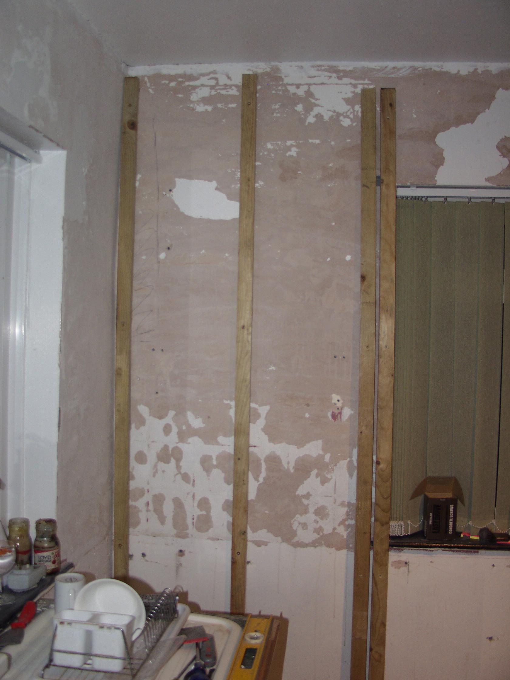

So do I put my next batten at 46cm?? this side of the window is 90cm wide, so effectively can be spanned by only 3 battens. You see I'm still not sure why the figure 40cm (apart from it being 120cm divided by 3). Is it for 'structural rigidity' of the PB attatchment & -has- to be therefore 40cm?? or can it be 46cm with no ill effects. Therefore, I'm not sure where to put this 3rd vertical batten. which you can see is only resting at 'noprmal' 40cm mark. If I put it here, then the next one is almost bang next to it with only a 1/4" gap between the two. Surely impossible to fill.. or is this the right way to go? (& fill with a sliver of C'tex.. or even foam?? seems a silly gap). Are you understanding what I'm saying I wonder? -

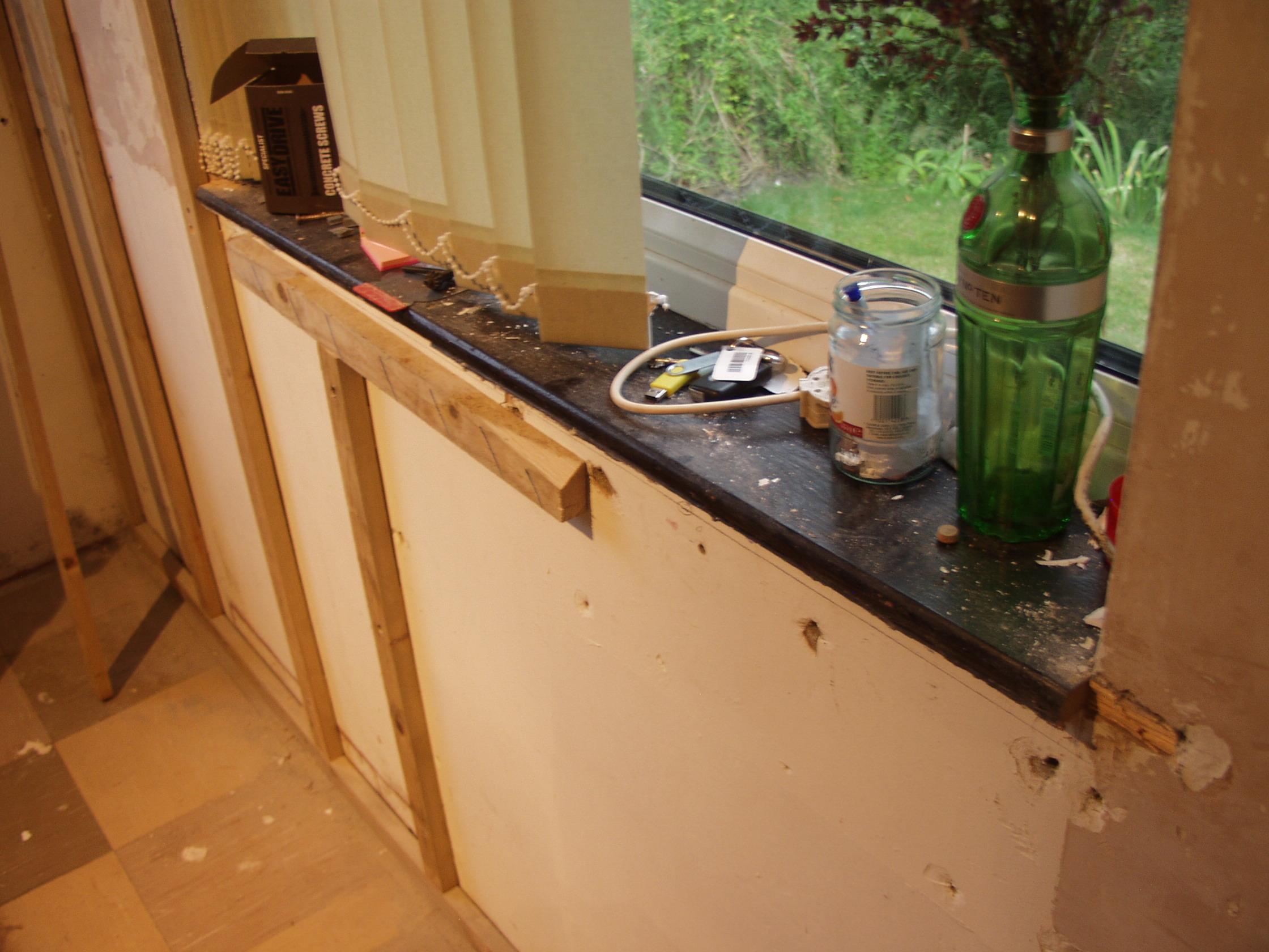

no3 vertical is resting: as you can see it'll be only 1/4" away from no4 though, if this goes flush with sill edge.. -

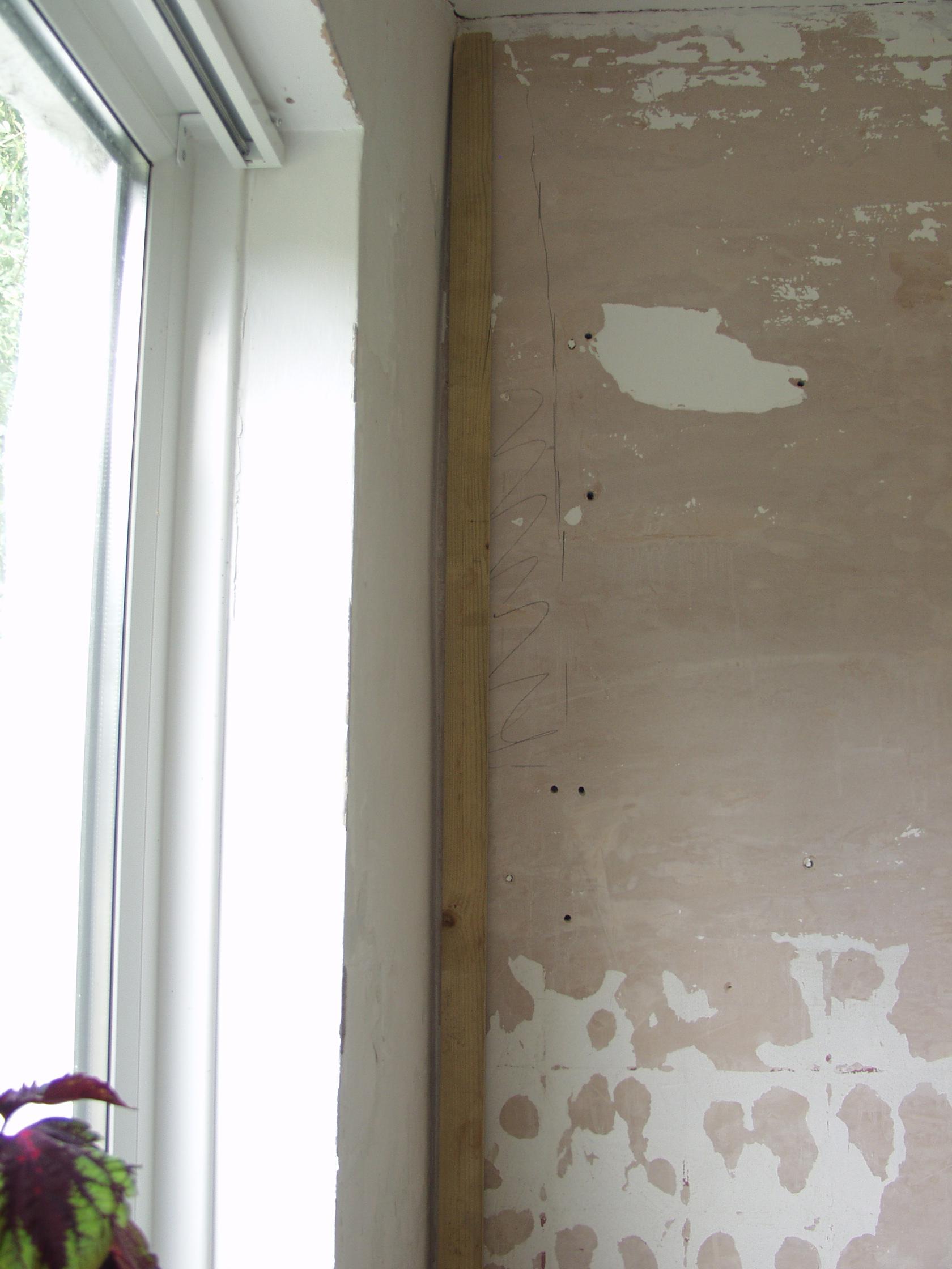

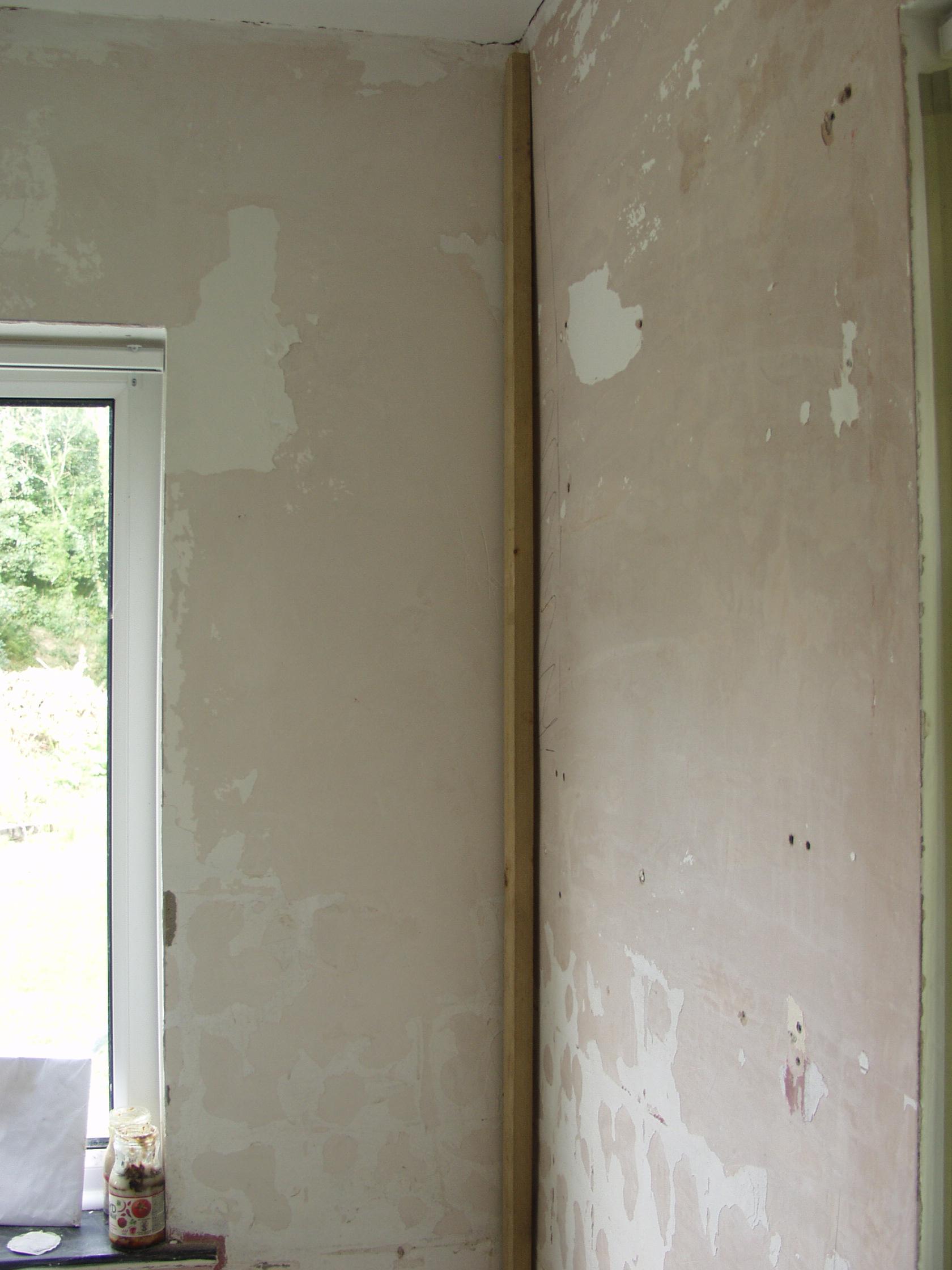

Well the extension which is bathroom/ kitchen, UT room is 1975-85 (main shell of the house is 1830, a top floor 75-85 of 2 beds above). But this extension is terribly badly built, as is the top floor. If I put batten up at the junction of the "L" level (sensible to start here-?) I have a 1cm gap behind to its wall in the middle (pic 1/ so the wall bows in).. & a 1.5cm gap, at middle, to adjacent wall (pic 2/ so that bows in too). -

Onoff.. I just offered the 1st batten up to see- & the walls are not exactly vertical: meaning, if I start at either end with an upright batten touching the side wall @ top, there's a big gap at btm if I set it to level. What do I do here/ how do I start? Ive bitten off way more than I can chew with this job I know it goddamit.. its going to take me a week to put the battens up as the walls go in & out/ really badly all way along. desperately need help chaps! -
