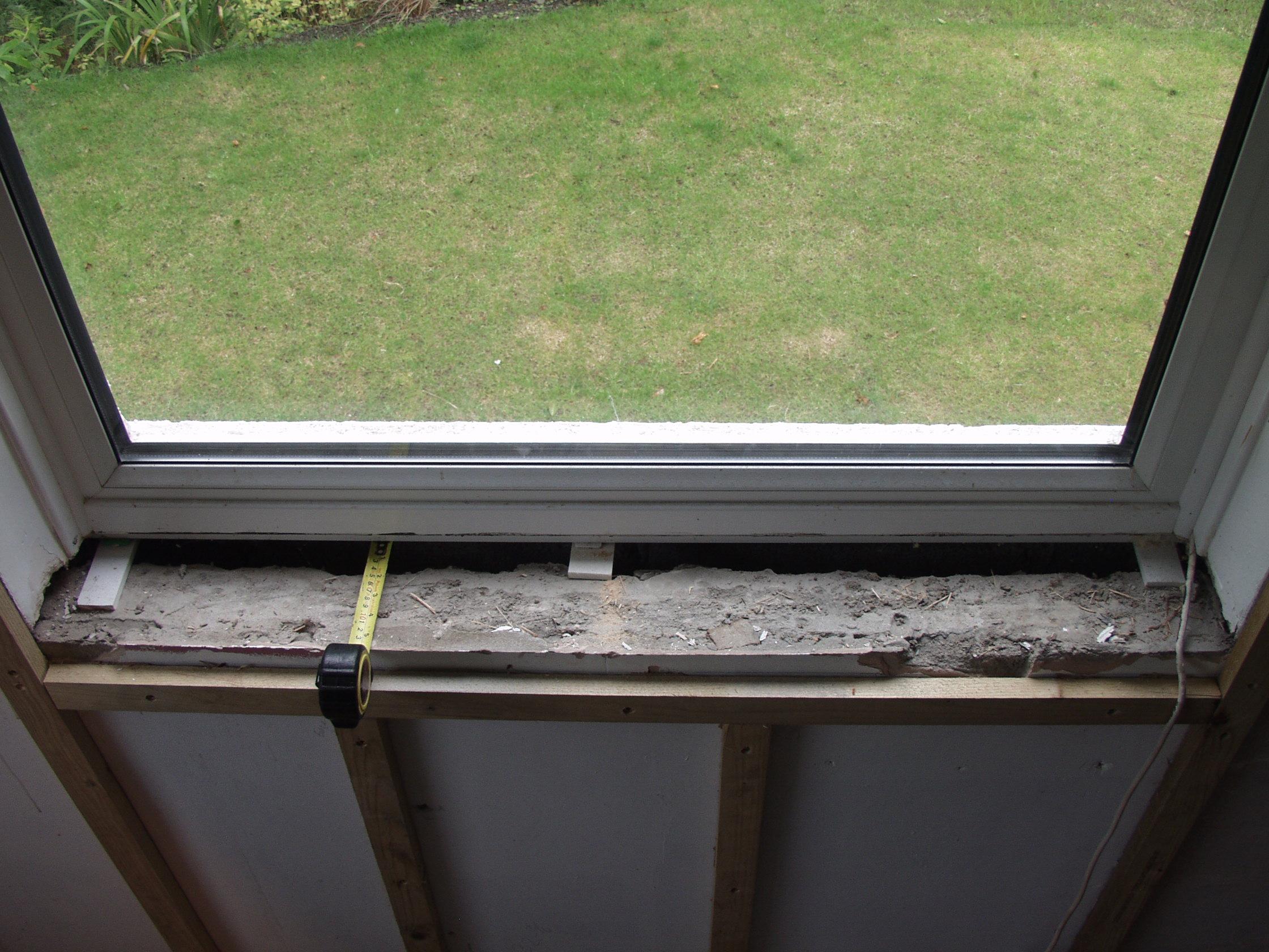

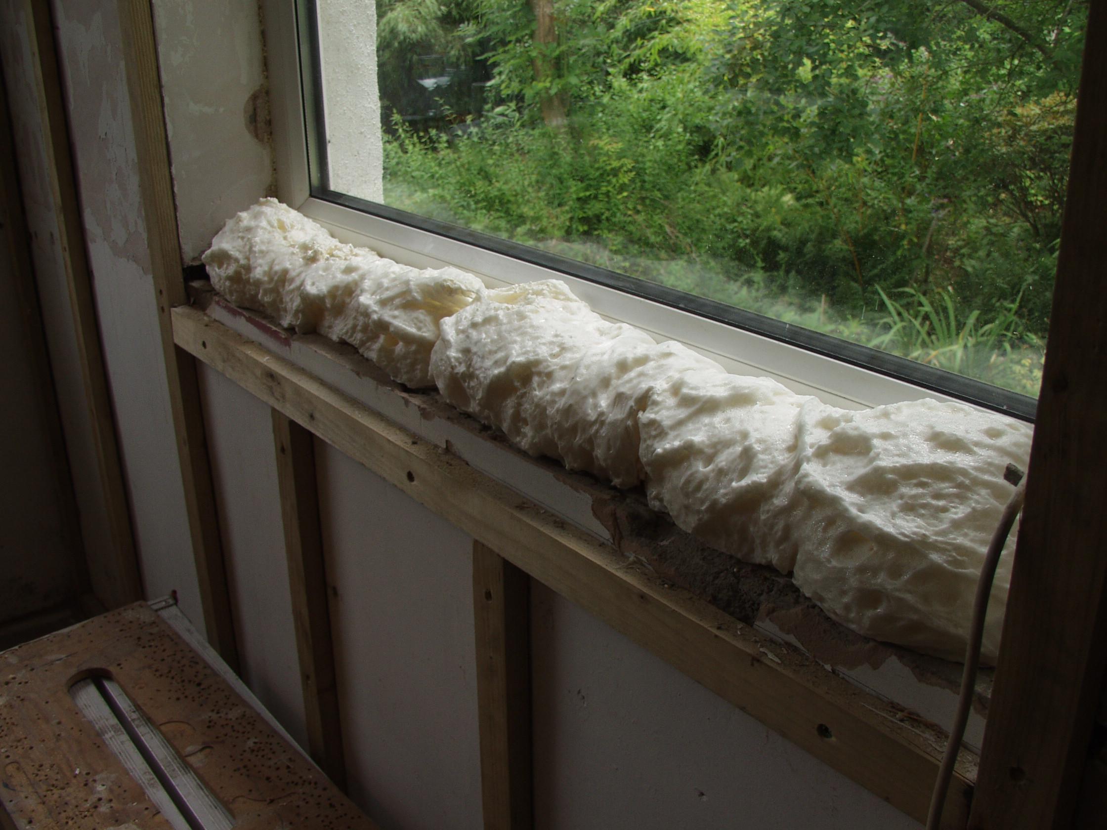

Ok thanks Peter.. I'm trying to figure out which is most economical re. PB taking into account the other wall to do you see. Without experience I'm bound to make a cockup on this or some other pg1 thing. And what would you do with my black pine window sill too? it won't quite reach out to the PB with an annoying gap of 1/2".. plus another annoying 1" gap below it (to the horizontal batten the units will fix to- guess I can fill this with a sliver of C'tex or is that too fiddly/ stupid?). -

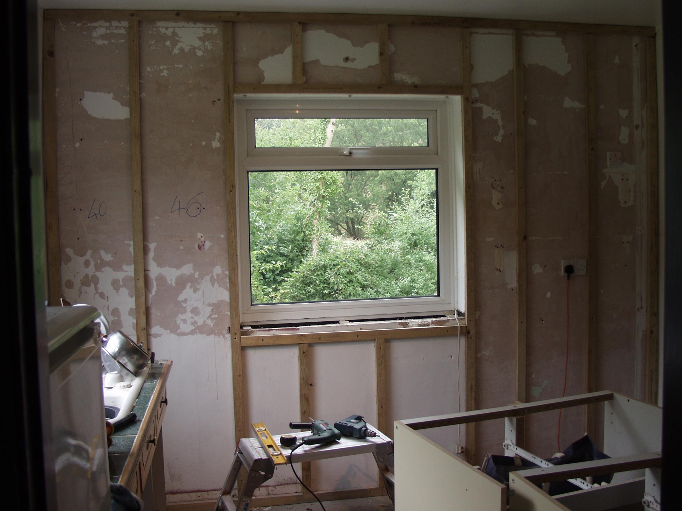

(not according to onoff's diagram below the kids bedroom diagram a few posts back newhome.. from midpoint of 1st batten to midpoint of 4th). I don't know how to proceed as I have more than 1200 each side. Assuming I have to put a vertical batten on RHS edge of window, as in my pic below, to facilitate the window reveal boarding.. & start the battens from the RH wall corner "back" twds the window @ 400.. do I cut it at this window batten midpoint (~1100), or add another one bang next to it to get me to 1200? Then fill the middle vacant area above & below the window with 1 more short batten/ cut a small bit of PB to fit?? -

Hi onoff.. yup been looking back over your useful pics. Done no3 @ 46cm, & no4 @ 120cm from no1. I had thought to line the window reveal with PB onto inside & batten edge.. as I can't see how the PIR would fix the the inside back of the reveal side.. its too complicated to explain where I mean let alone do it! So having done as below, is the idea now to go from the other side (far RHS of wall) 'backwards' to the RHS of the window?? then fill the middle small uprights above & below? Im away all day but continuing 5PM & over w'end. [The "////" batten is just resting ie to show what I plan to do here (horizontal midpoint is the UNITS' fixing height you see)]. Much appreciated.. I'm slowly getting there, maybe? -

So do I put my next batten at 46cm?? this side of the window is 90cm wide, so effectively can be spanned by only 3 battens. You see I'm still not sure why the figure 40cm (apart from it being 120cm divided by 3). Is it for 'structural rigidity' of the PB attatchment & -has- to be therefore 40cm?? or can it be 46cm with no ill effects. Therefore, I'm not sure where to put this 3rd vertical batten. which you can see is only resting at 'noprmal' 40cm mark. If I put it here, then the next one is almost bang next to it with only a 1/4" gap between the two. Surely impossible to fill.. or is this the right way to go? (& fill with a sliver of C'tex.. or even foam?? seems a silly gap). Are you understanding what I'm saying I wonder? -

no3 vertical is resting: as you can see it'll be only 1/4" away from no4 though, if this goes flush with sill edge.. -
