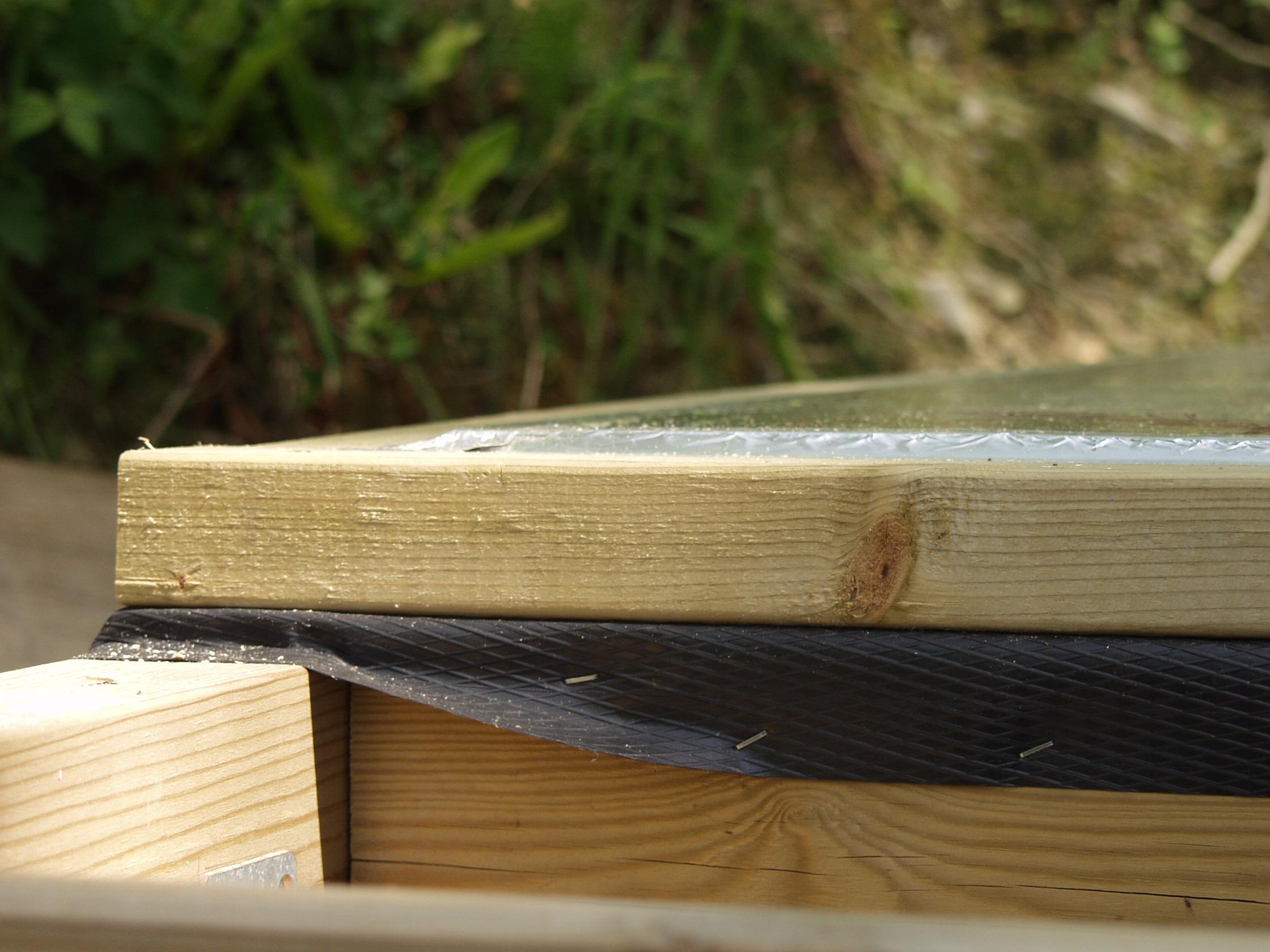

So are you suggesting this? https://www.toolstation.com/damp-proof-course/p54162 And suggesting bc you know its thinnner than the textured stuff at screwfix? Its JFDI yes its p'easy a 5m job.. once Ive got the right stuff. Until then its hours to trawl/ ask/ ask again etc to establish what it might be.
Ok thanks chaps- so not a sheet but a cheapo DPM/ in DPC width.. now this is all I see at screwfix: the very stuff I think is too thick to do a sharp 90* down, after I staple it to the horizontal outer 3" of the osb under the 3x2 'frame'. https://www.screwfix.com/p/capital-valley-plastics-ltd-damp-proof-course-black-30m-x-150mm/78665 I can understand if the suggestion is thin stuff (for eg, same guage as my placcy dpm under my concrete) but not thick DPC stuff that's lain under concrete block course. The screwfix stuff folks say is extra-thick too. I had a roll of this, & its like 1.5mm thick. Could you possibly provide an eg of what you suggest? or is it just this ^. I only have screwfix or toolstation to get this tmrw AM. I must fit this sub-floor tmrw. thx zoot
Ok understood. Thanks for confirming. So when the suggestion is a 'dpm' all I recall is that stiff black rigid textured stuff that comes on a 6" wide roll.. which I can't see how malleable enough to pull over a sharp edge. But is the suggestion a -sheet- over the whole expanse of the osb? does that mean then the same type of plastic DPM (thinner than this rigid textured roll stuff) laid under my extention floor concrete top (poking up I bent up & trimmed then laid PIR on > caber floor): is this what you have in mind? Or maybe the thinner 'vapour sheet' stuff suggested on topside of my ceiling pB (which I can't face doing!)? not sure if this was a 'DPM' per se. thanks, zH

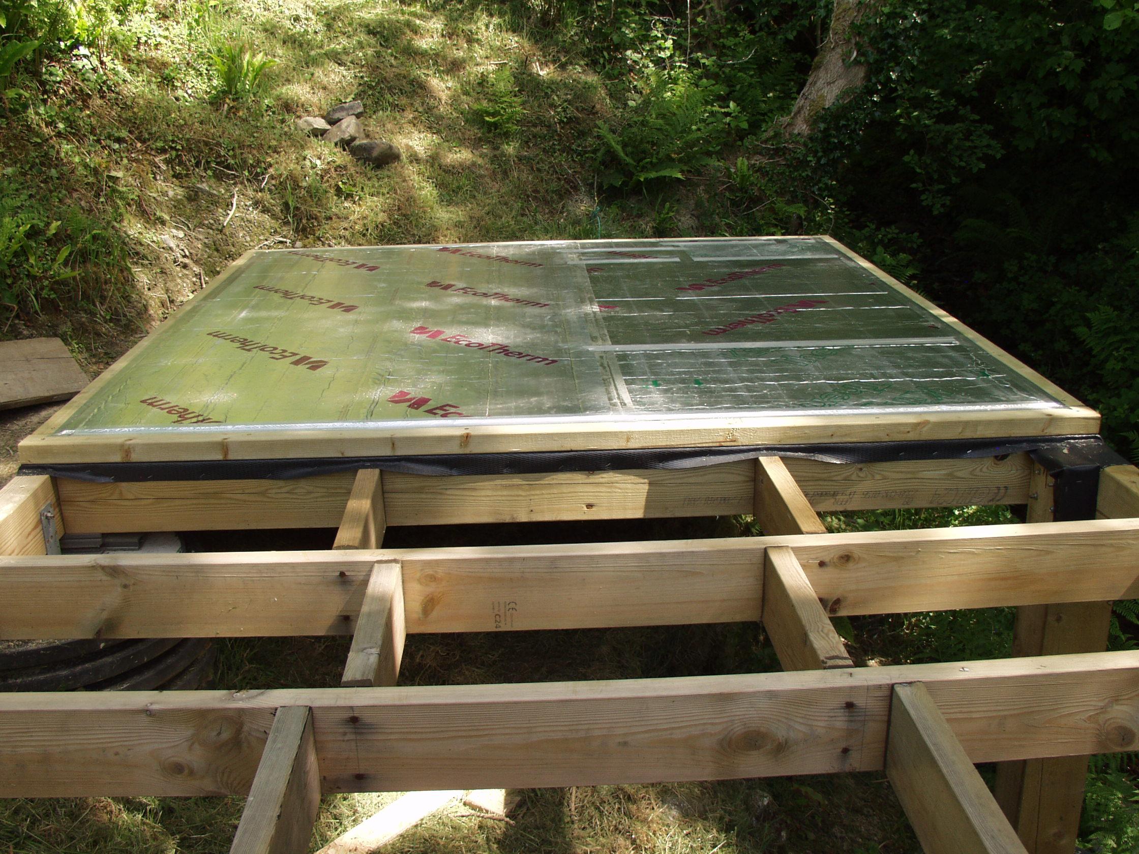

@PeterW hi Peter if you're out there.. was your suggestion like Onoff's 1st sketch.. to put the PIR directly onto my (^) base, within the 3x2 perimeter frame (so this 'frame' sits directly onto the base) >>> THEN the osb covers the lot? [Or Osb goes 1st onto base..). Thanks zoot.

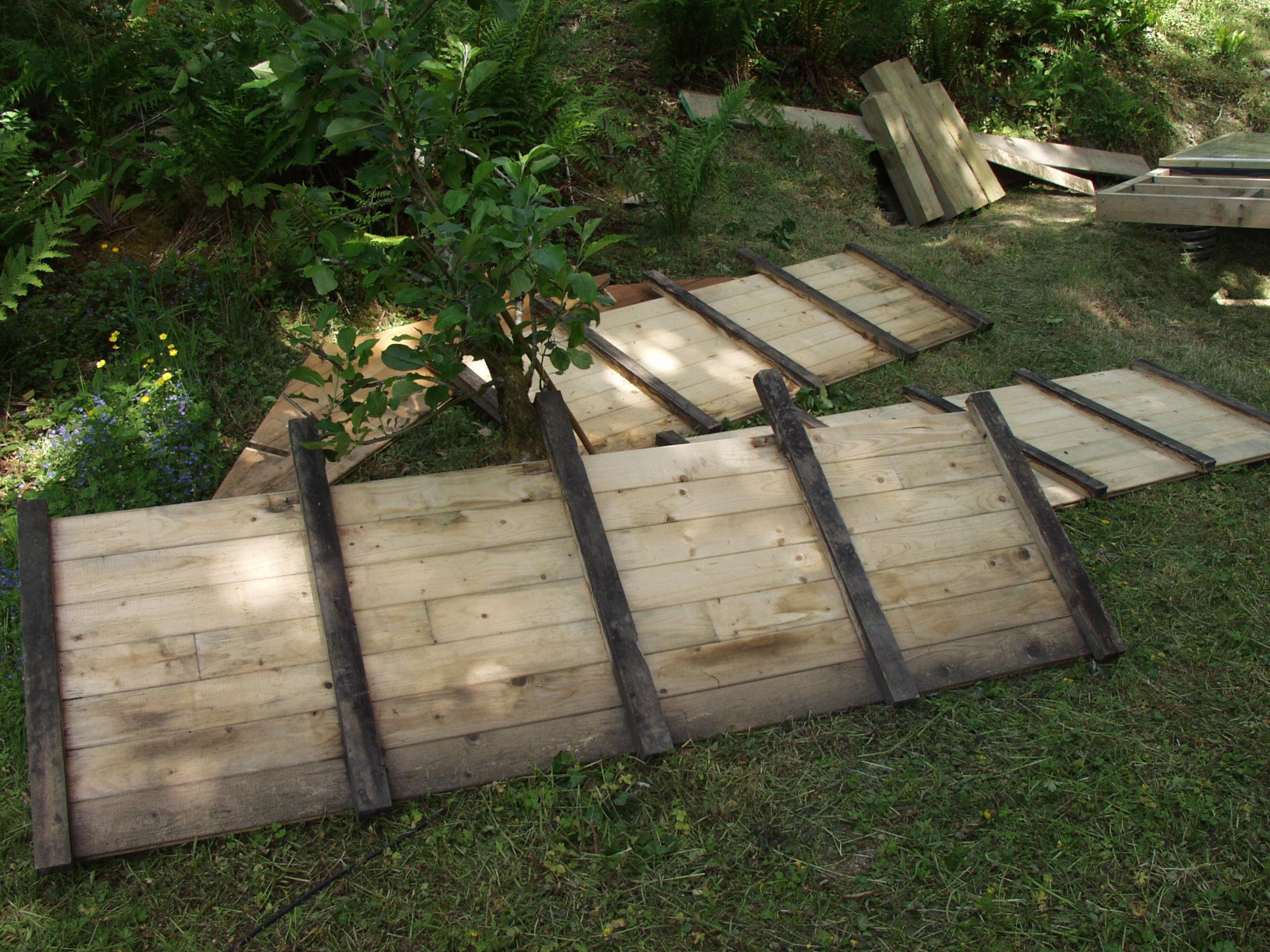

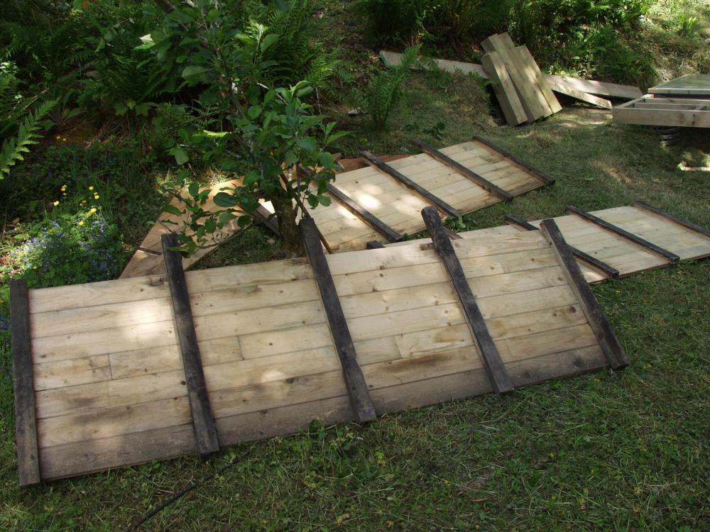

Hi @Onoff cheers for thesees sketch (calming!). Two discrepencies: the Osb goes below the 3x2 & PIR (I think this is how PeterW suggested/ this subfloor his idea). But your idea I think remains the same (& sprung to mind over w'knd) of adding a side to cover the osb edge. And the t&g in your 1st sketch is the wall, not cladding (I dont have an inner load-bearing wall) & so sits upon the 3x2. So any dpc will need to do another 90*. If its thin enough a dpc can maybe squeeze between the cabin floor & wall.. but any thickness & it'll then prevent a tight join between them & stick out sideways.. and/ or onto the 3x2 as well. But if thin & able to be bent 90* out > then 90* down over the osb edge = bingo. Not sure. Yes a floor is with cabin: not great but useable: 3 interlocking sections (2x1 battens with floor slats nailed across ontop) slide together making the floor. So it has double-use: a floor obviously & a 'start' section, to position walls tight around > & build up. Sorry even if I could sketch.. I don't have a cam now to photo it. Thanks alot- zoot

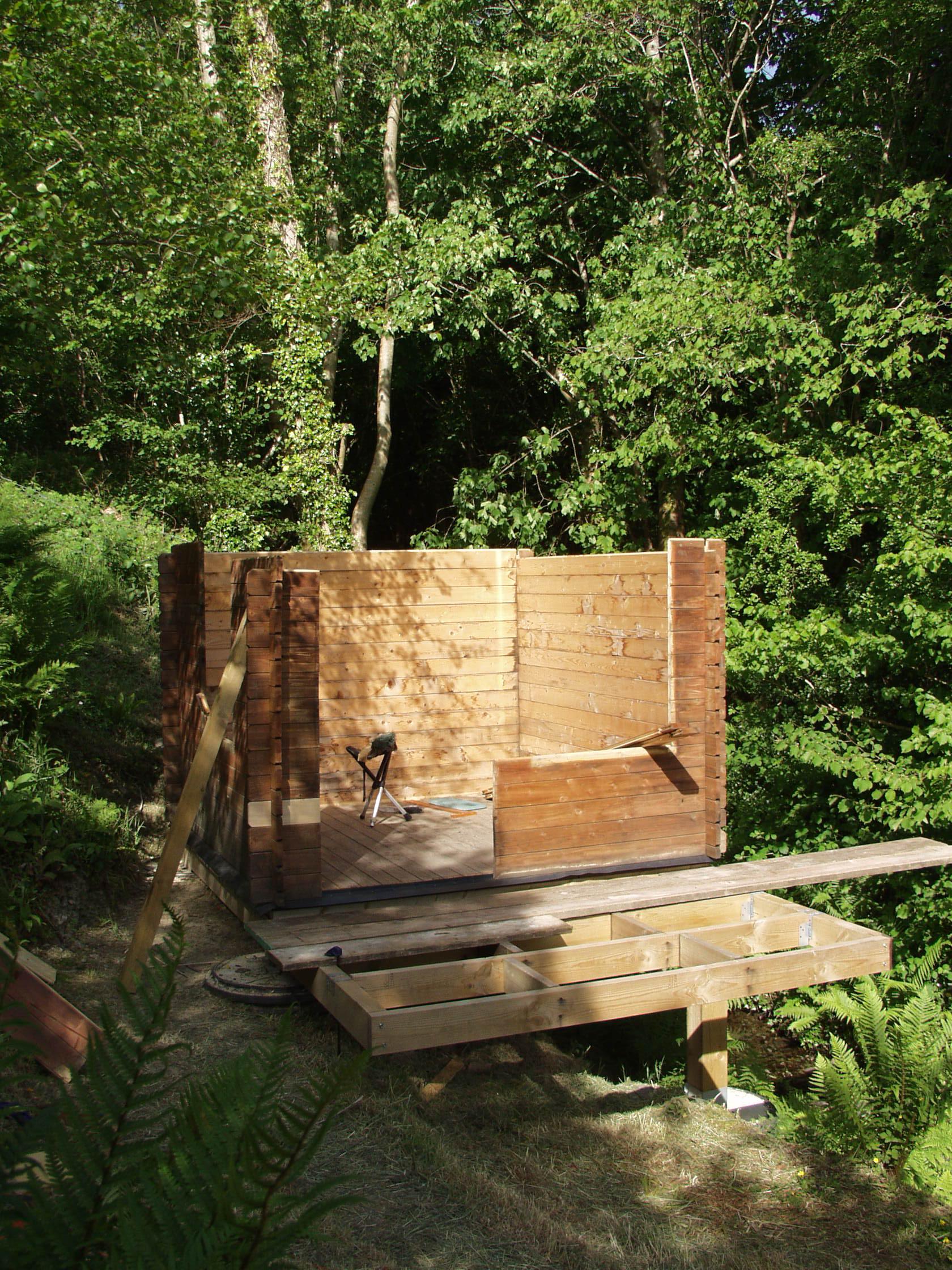

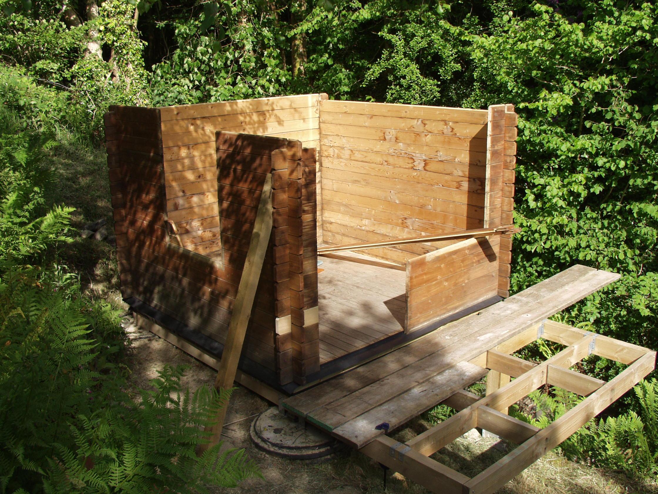

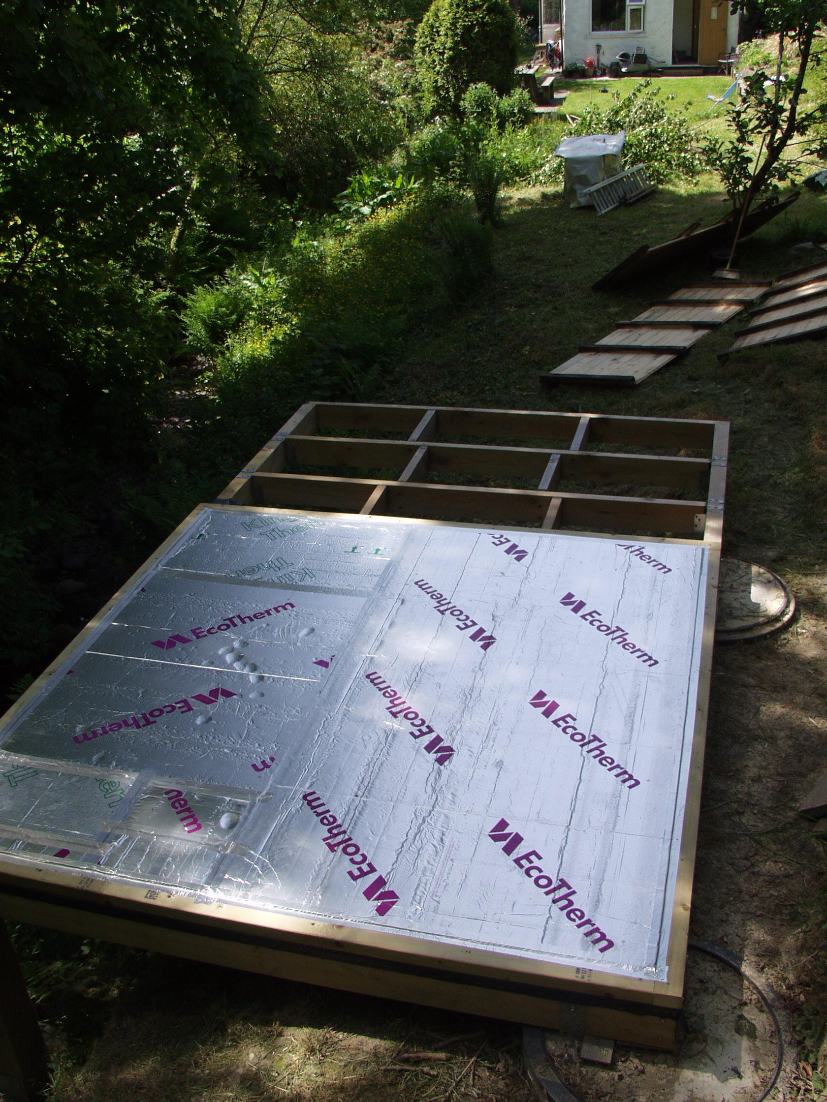

Hi- does anyone know if these osb edges can be covered/ or, what's the best thing to do here? The 11mm board edges will be exposed to weather you see I need to sort this before I can proceed. Osb3 will lie onto of this (^) base. A periphery square 'frame' of 3x2 will sit ontop of the osb. 50mm PIR will go inside the 3x2. Thanks, zH
@Onoff Ok so where there are single nogs/ the 2.4m square for the cabin: osb (11mm) will cover to the edge of this (^) base. Then an outer square of 3x2 (IE, the cabin's 4 walls go upon this). Within this square 3x2 'frame' : the 50mm PIR.
Sorry, a sketch of 3x2 ontop osb? not sure if it would help, even one of yours tbh. plus my camera's rip. Its simply the fallible edge of the osb.. what is usual to 'cover it' to the elements? Ive thought if I extend the 3x2 out so it hangs 1" over edge of the osb, that will hide it a bit- but it'll still get wet surely. (my other Q: shall I soudal-foam fix my PIR to the osb? I need to fix it down really).
Can someone help with what to do with my osb edges, & fixing my PIR: The 3x2 will have a sandwiched layer of osb3 between it & my base, so this edge will be prone to rain. What's best to do? And the PIR 50mm which will be within the outer 3x2. I may have to leave it/ tarp this sub-floor work (trying to get overhanging ash cut before I put cabin up.. not easy with lockdown/ maybe not possible) so should I fix it to the osb I wonder.. soudal LE foam 'dabs' maybe? thanks zoo-t
