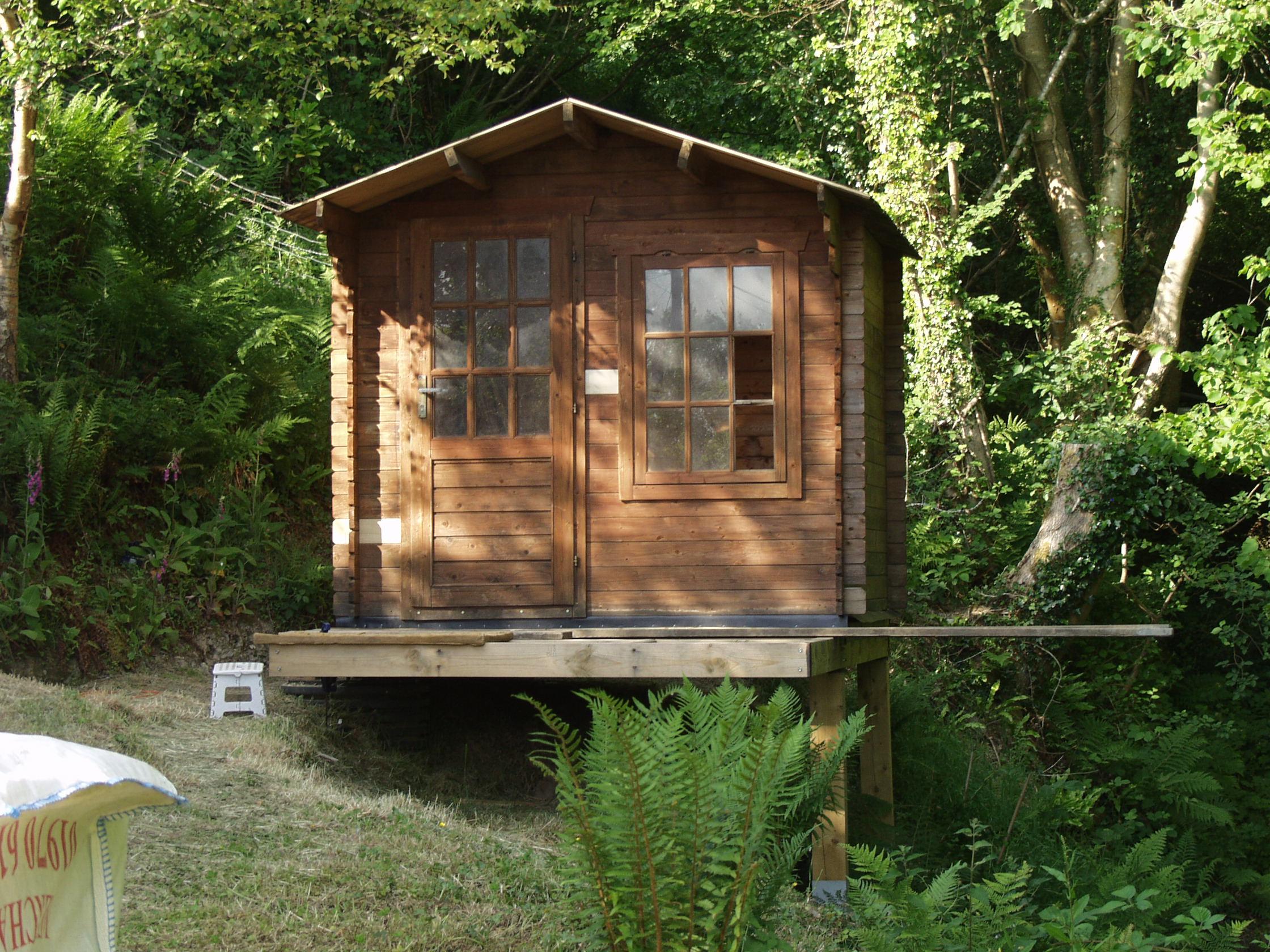

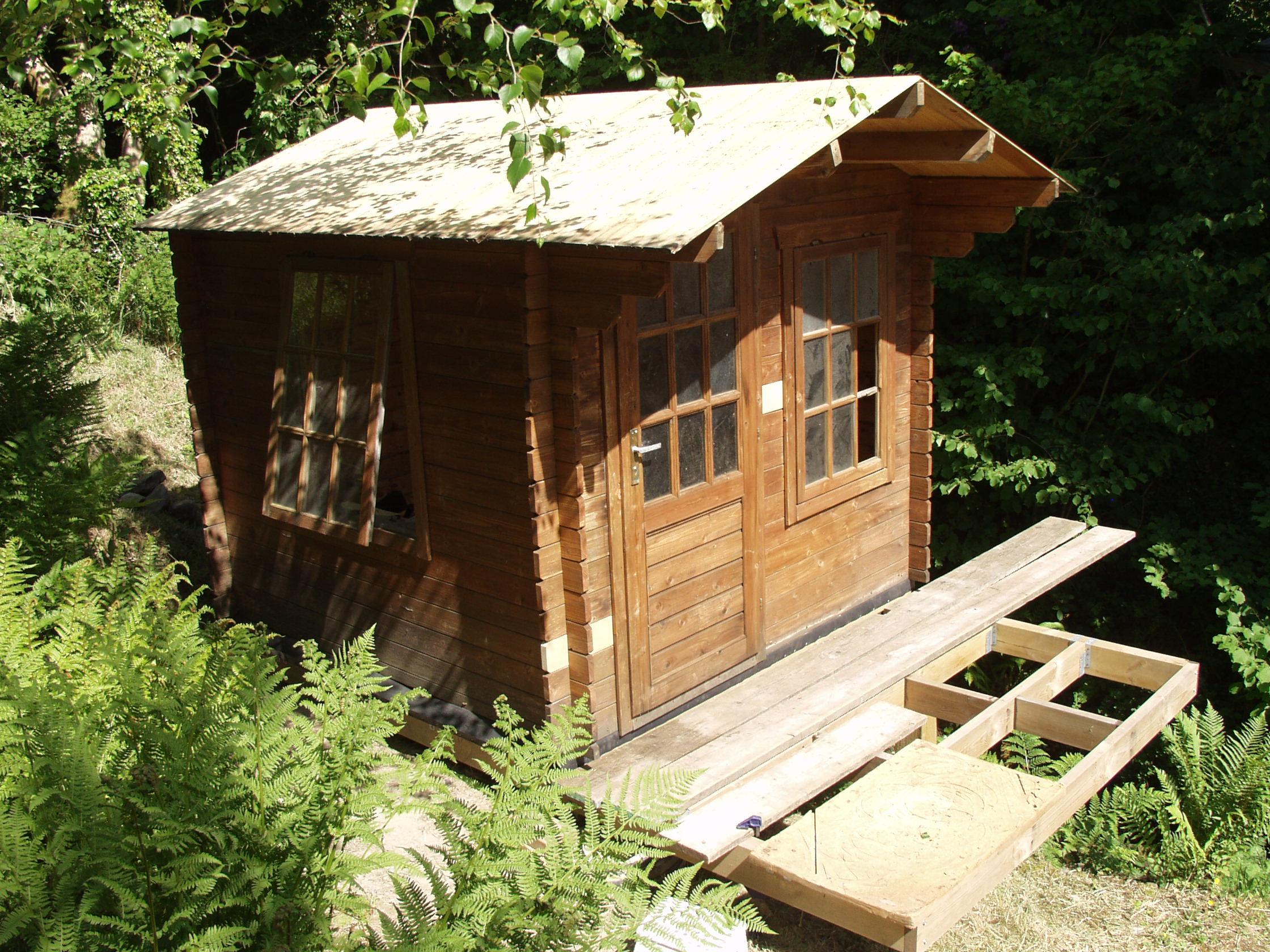

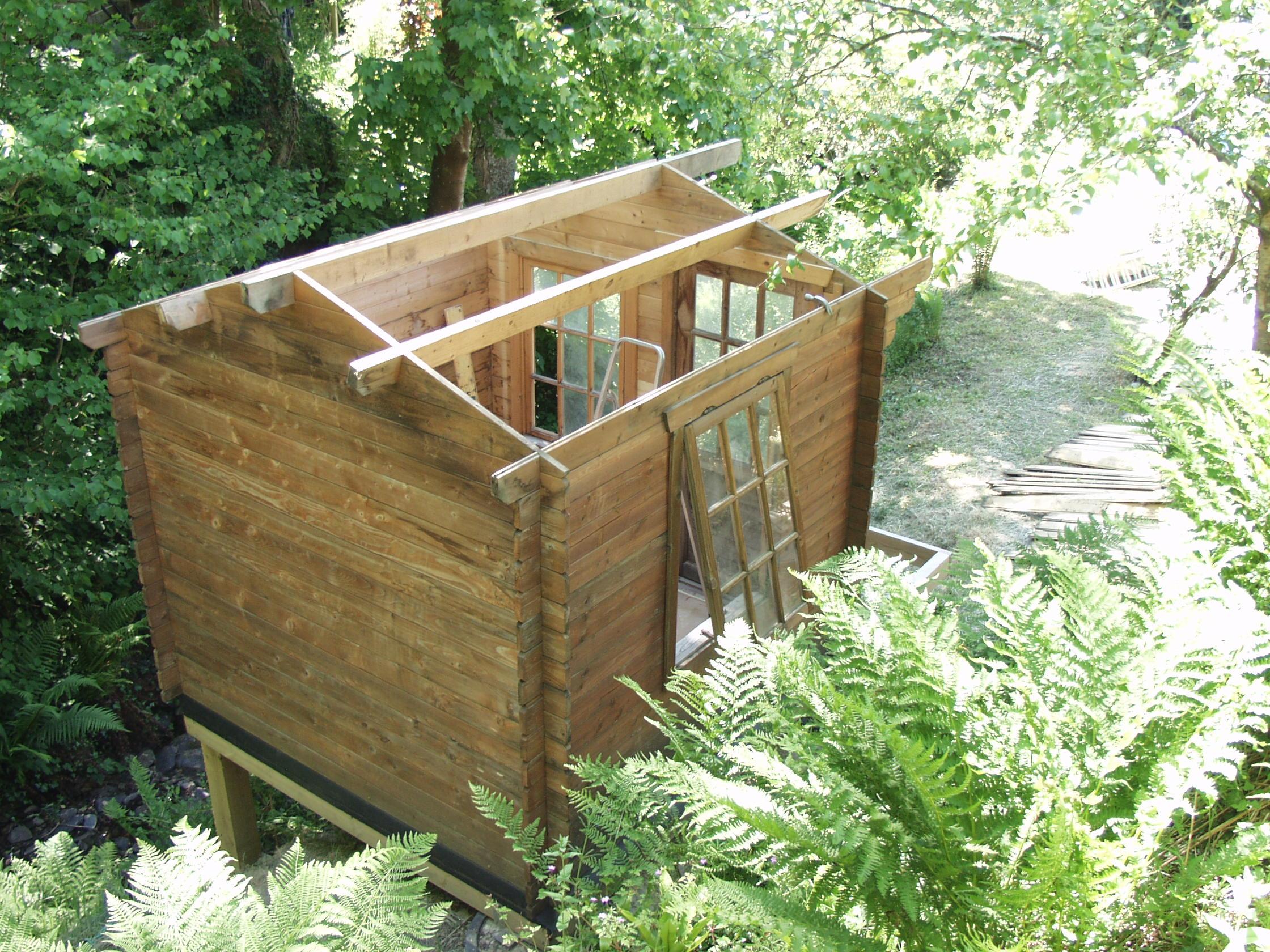

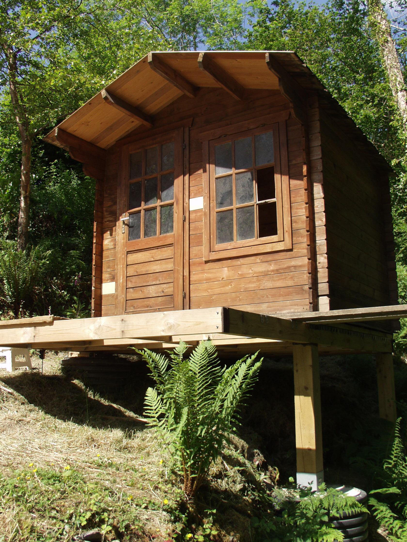

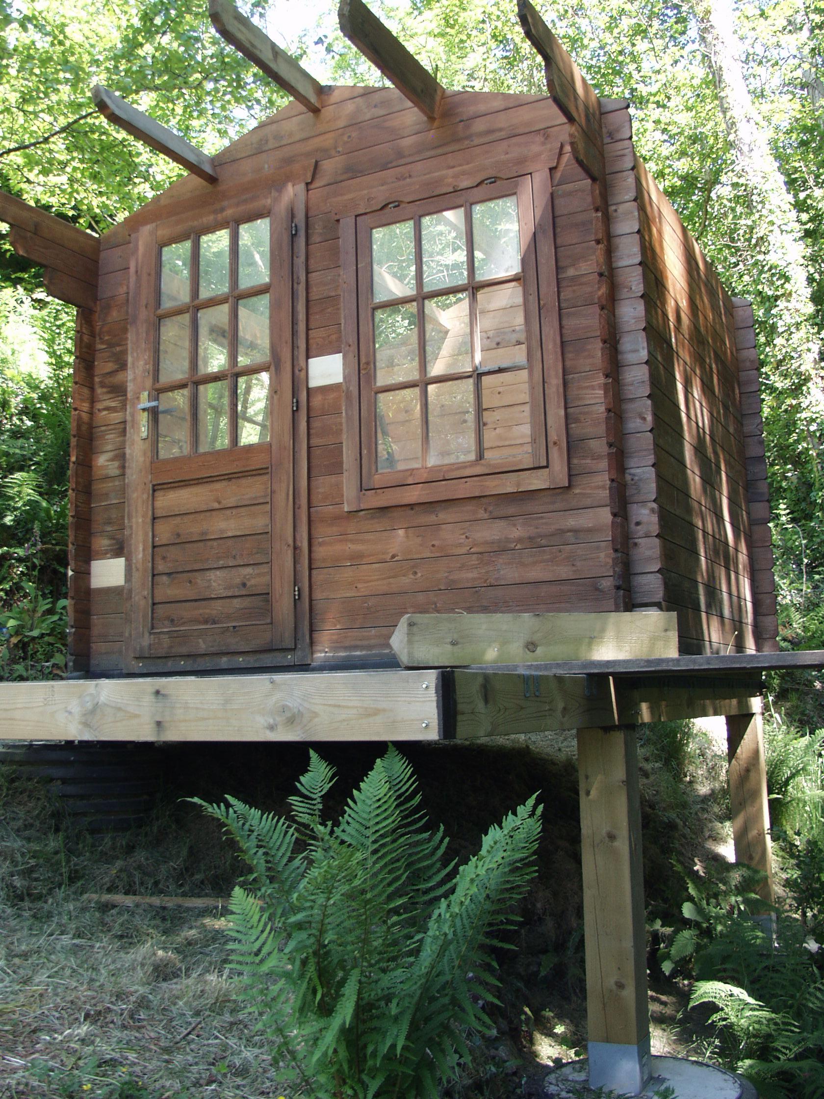

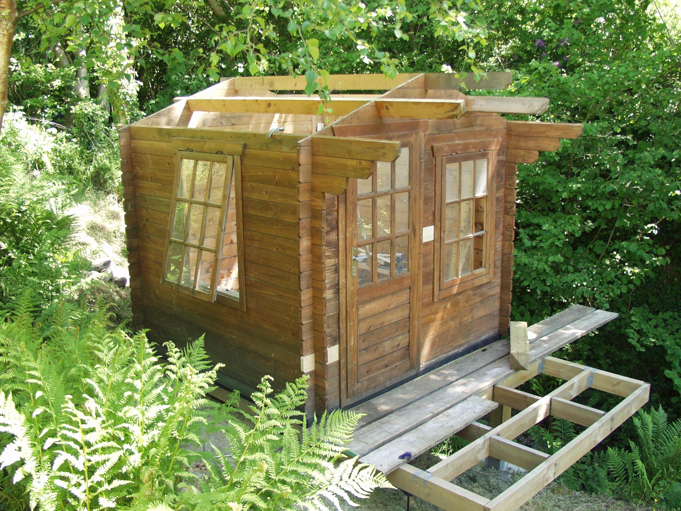

  13. Got my pinko rails on all around both roof sides (& my rotter sandwich went great/ pinkos under lip L & R/ solid).. & both PIR's on.. & 1 osb on too, on the easy side. Flat out all day to do this. Looking murky overhead tho so tarped it.. dammit. Not easy on the stream-side: its 2-stage ladder max extended, & sitting on osb roof is pretty slidy! jeepers almost slid off into the rocky piddle. One last step I'd like to do as a belt & braces peace-of-mind addition, is fix a metal (ideally) vertical rail on the outside L & R, twds front near the LIFT-OFF roof bit, to tie all the logs to down to the base (& up to the roof too if I could as its only nailed to the joists, & the joists are only gravity-set in too). Any ideas?

  16. Trouble is with this idea I haven't got any edge structure to screw into (rotten).. so needs to be a screw thru rot > into other pinko I think Peter. What length felt screws? might seem a trivial Q, but Ive bought 20mm but maybe 13mm diddy ones better? worried about any more splitting of the 18mm t&g's.. they're peppered with splits from pervious (sharp) nails, but not enough to be n/g: its a solid roof as it having repositioned nail fixings via pilot holes.
  17. Only 2 goddamit. I thought that would be more than enough until starting the t&g roof/ all been on a pallet under a tarp, roof at btm you see. I can think the osb is best attatched ontop, to -two- rails of pink batten for each roof side: one ontop @ rotter edges as said & another twds if not at the ridge. Or would it be sufficient do you think to just do one ontop @ the rotter edge.. & everywhere else just whack in 50mm screws from osb thru PIR into the t&g. Idf so, I might be able to patchwork-up the remaining vacant osb area with offcuts.. like I did on the ground PIR.
  18. Yup I'm with you.. was thinking the same an hour ago too. The PIR only needs to fill the actual area above the inside, doesn't it? I mean extending it over the forward porch roof area is effectively wasted, & both ~15cm side overhangs-? Reason I ask is I'm not gonna fill entire roof with my 2x PIR, & my 2x osb's. Osb the bigger problem obviously.
  19. Hi Peter- 25mm.. so same idea but a pink roof batten then? So I'm not quite on board with the purpose: is your idea a ledge to sit the PIR onto, just to make the job easier/ to get it up & stay up there? or a structural addition? ------ To answer your Q before.. the ends are bad: many rotten some very rotten, only few have solidity you see. N/g to fix to tho. So my idea was get PIR on & osb on (screwed from osb down thru PIR into t&g roof).. then on the problem ends: instead of fixing down to them, sandwich them between a pink batten rail underneath, 2 of both sides, then long screws down from surface, From osb > via PIR > via rotters > into batten. So rotters squished between, not fixed-to. Ive spaced enough good ends t&g's -just enough- equally along to provide some solid wood so the sandwich won't squish the rotter ends flat. But this idea might be utter balls.
  20. Old roof on.. now the tricky bit/ PIR & osb (felt last). I mean I don't know how I can even haul up 1 osb, so I might tarp it until I've a clear method sorted out.. but would be nice to get it completed before weather breaks. I do have a load of gap front-side to sort out too.

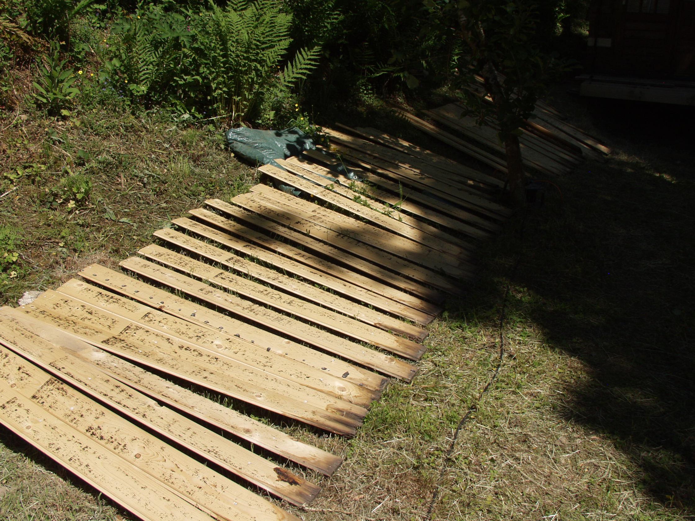

  21. The roof is gonna be a sod.. 60 t&g's to de-nail, pilot holes redone (so 120 holes) most ends rotten too, so thinking squeeze a pink roof batten on, all along under roof lip L & R > screw down from osb edge into it. There's -just- enough structure in some t&g section ends to be solid enough. I had thought of swixzzking round so rotters at the ridge.. but my joist fix point is very edge, so idea no can do. Any other ideas here chaps/ this is my most fallible bit. Ideally bin the lot/ redo.. but it'll add £80 min. Pic 4 shows the grey rotten ends..
