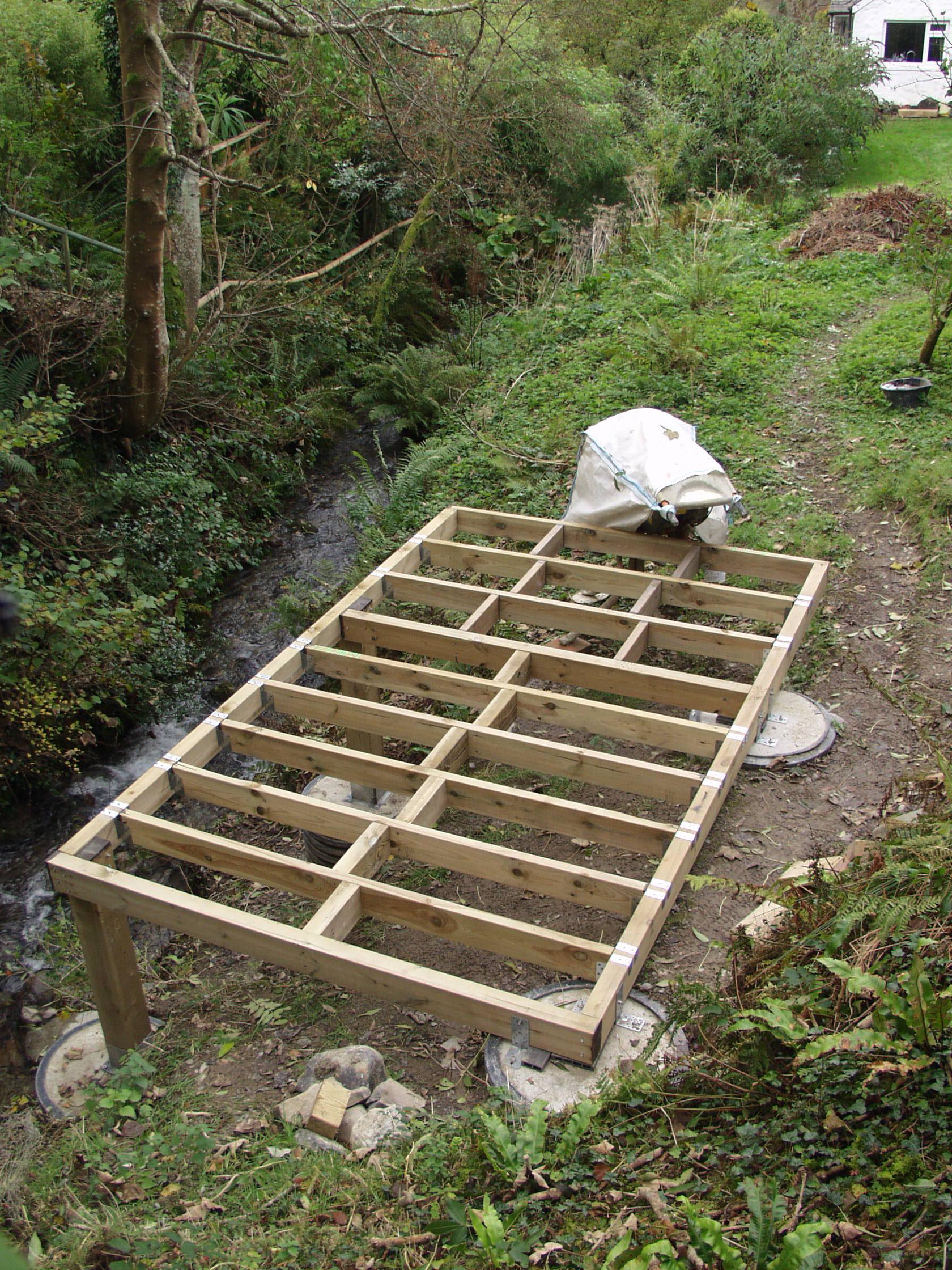

@PeterW where the single nogs end here (along middle, parallel to stream).. is my front cabin joist, & it sits flush on the far edge of it.
Ah didnt see this reply- ok alas no, I don't have a joist near my door, the door literally sits bang on edge of my outer 6x3 'frame' joist.
@PeterW or @Onoff or anybody.. Needing help on orientation of deck boards (32 x 125). Ideally loadwise & looking at my joists (pic^) I'd think the suggestion might be to place them from door side >> to front, the shorter 140mm dim. As my width across is 2320mm, using 4.8m boards (divided in two) would be cheaper. and I think would look better. Can I deck it this way? I guess its a Q of whether I have enough noggins in. thx zoot.
Hi Peter- ok I agree/ going for this. So, 1stly I need to put ridged decking boards down. Would the best orientation be across-ways, like my scaffold pirate planks are? Or is this dependent on how Ive done my joists & nogs? Can I just double-check my deck base is ok (the gaps between ok, & no more nog supports needed).. I know you said fine but just want to be sure with dims: gaps between nogs (measured across, like pirate planks are) are mostly 640mm W & 720mm W (Im sure ok) but two central bigger gaps one immediately outside door (under pirate planks), & other at mid front.. are @ 780mm W. Thanks, zoot.

Hi Peter- ok good I think I'll go with some decking boards. unless they cost even more! ah ok understand your point about the base rails. So you suggest -only- using the upright pillar bits ? I guess that means then the many 'spindles' (I think is the name) design is not feasable without base rails then-?

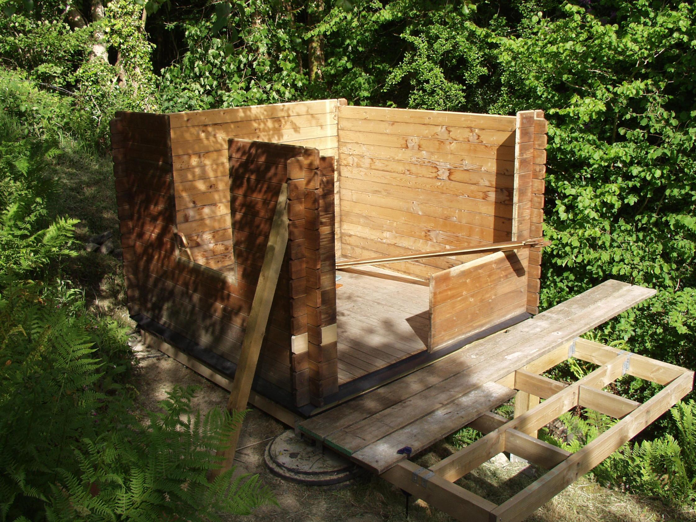

@Onoff great link that/ good pics of the treehouse-cabin. Yup an Onoff cuckoo gargolyle-on-bigFO spring needed. I've always wanted a spiral staircase.. might think on this as an addition to my extention balcony. A few moons away, but spurs me on! It's the softwood style handrail I want I'm certain, in the pic here https://www.edecks.co.uk/m/products/119/29/79/0/1800mm-Hand/Baserail . Only needed on 2 sides front & stream side (LHS left open, a sleeper for a step up to deck). That's a good start. I'm still considering the deck floor: 5x scaffold boards is £110.. pretty dear. Do I have enough support I wonder, IE my added nogs etc, to instead use standard decking ~5" wide boards? (usual types, seen in the edecks pic ^). gotta be cheaper surely. cheers zH
