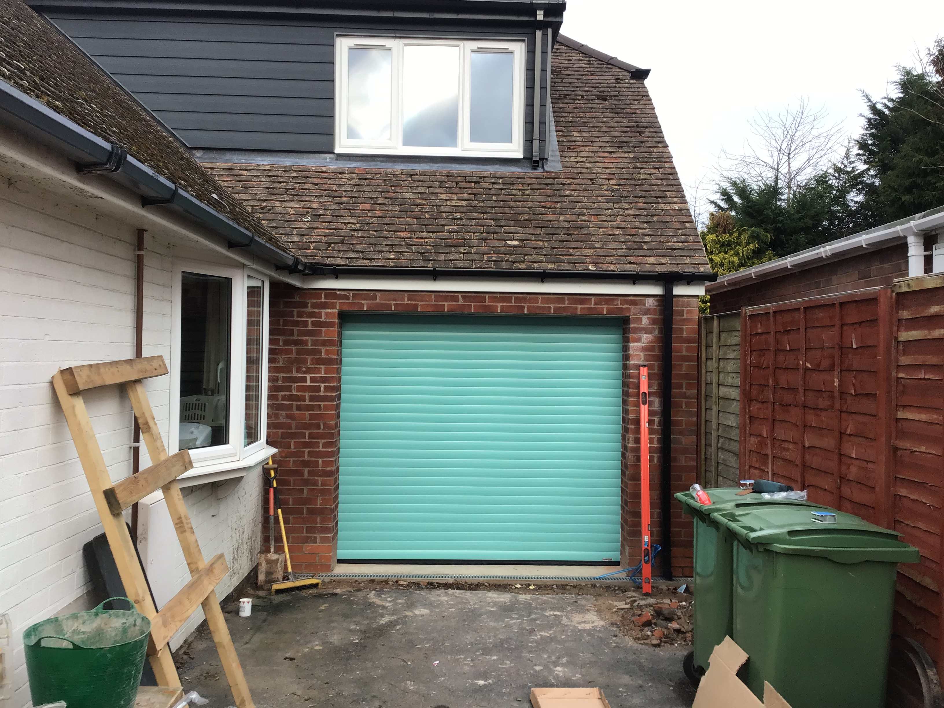

  2. Forgot to put an update on this!!! It FAILED spectacularly. Building control refused to sign it off on many counts which was the only sensible outcome. P.S. for those who thought it was acceptable and those that are watching and still build like this, don’t come to Shropshire , substandard workmanship isn’t acceptable here 😎. For those that were helpful and constructive I thank you 🤠

  4. Neighbour is 86 and doesn’t appear to be concerned about what is occurring, presume he’s here for a good time now not a long time! Referring back to the original question which nobody seems to answer, will it pass building regulations with the damp proof course bridged or not there and large gaps in the mortar beds and sometimes no mortar in the perps and without any pointing?

  7. It is part of a 13 meter wall that is going to be a two storey side/ rear building extension with a gable end and a pitched roof . It is being built by an individual small builder and monitored by Stroma building control . Hope this helps?
  8. I am being told that this wall being built next to our extension is of sufficient standard to pass building control and the test of time. I have challenged the builder who assured me it will pass building regulations !
