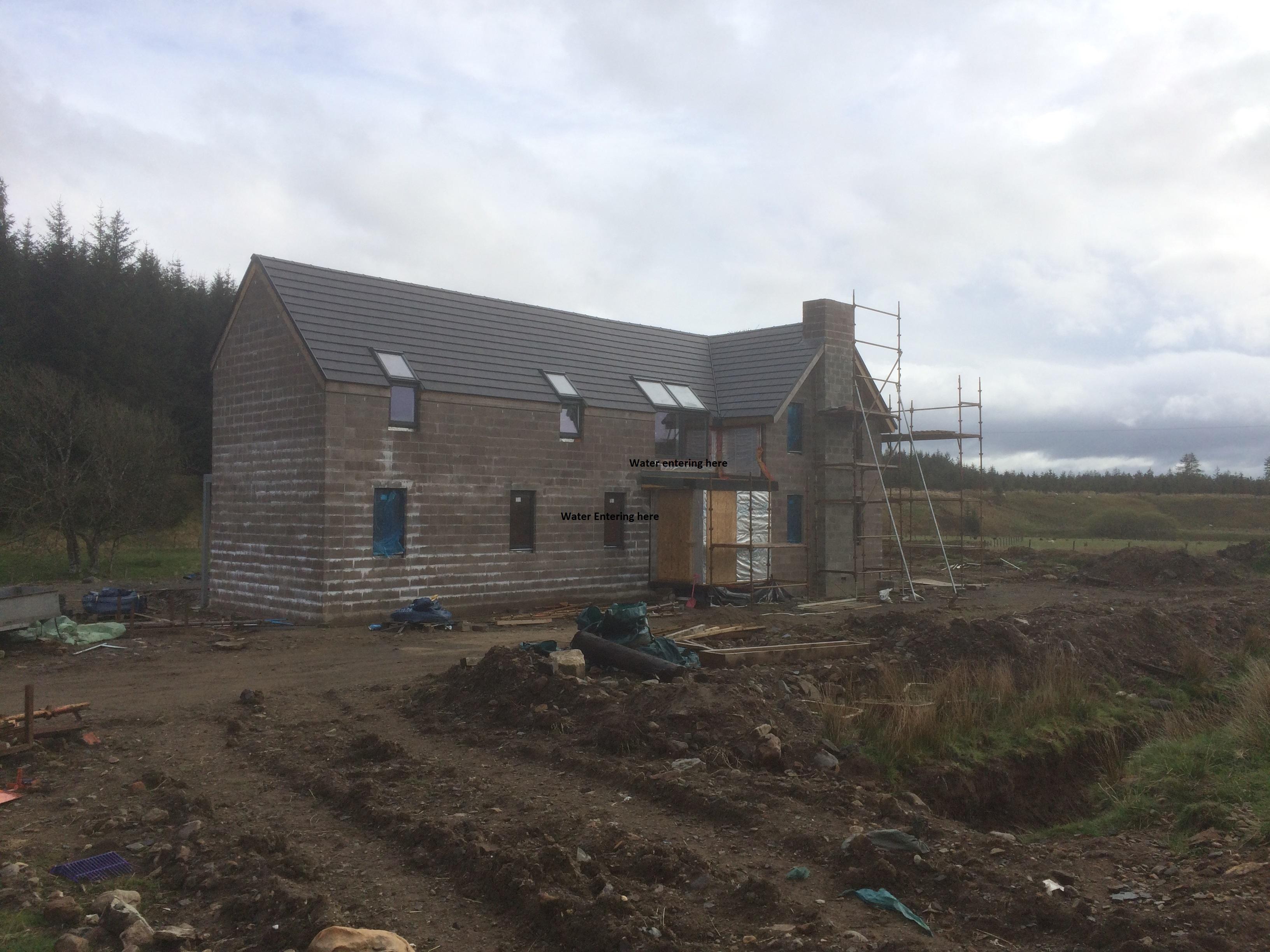

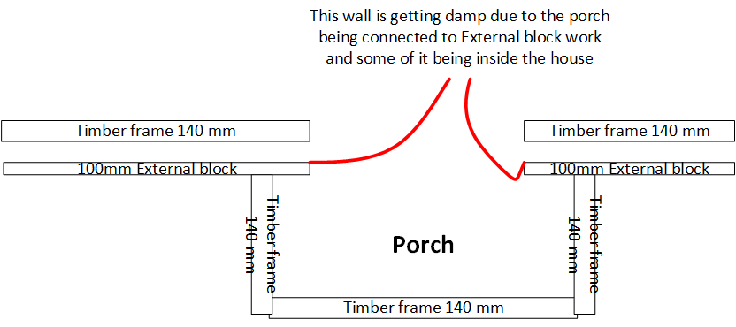

Need some advice on the porch and a damp issue I have. As the external block work is saturated with water and the joiners have joined the porch to it some damp is coming in horizontally and a small piece vertically. What would you recommend I do to resolve the issue?

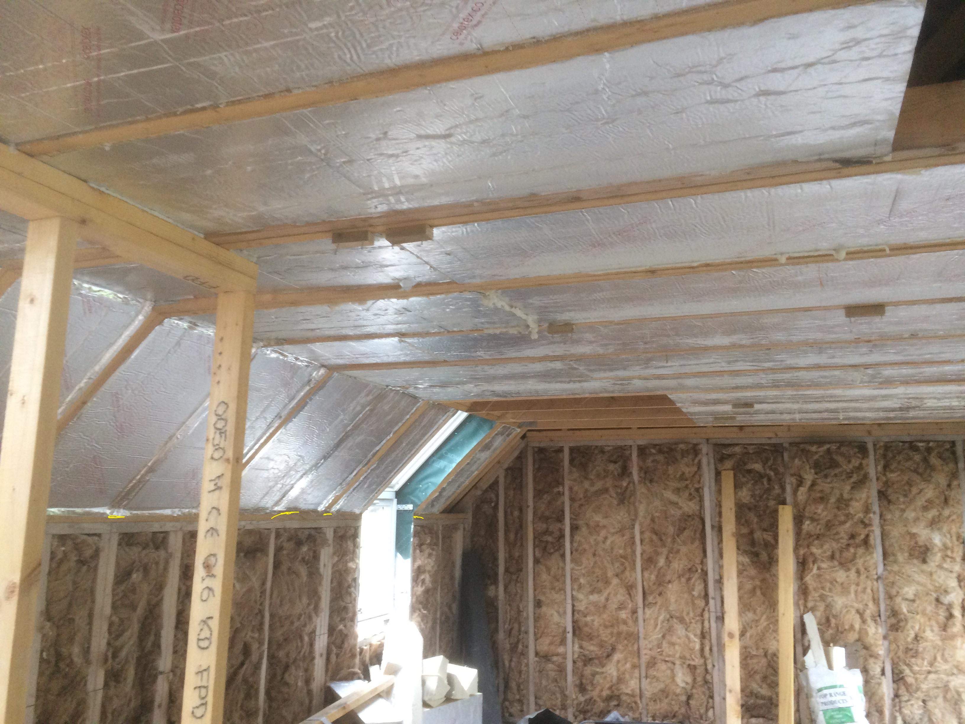

Just read NHBC guide and as the roof has no to little uplift as there is no soffits outside. From NHBC Site Where trussed rafter roofs are not subject to uplift, a minimum of two 4.5mm x 100mm galvanized round wire nails, skew nailed, one on each side of the trussed rafter, or truss clips (fixed in accordance with the manufacturer’s instructions) are acceptable.

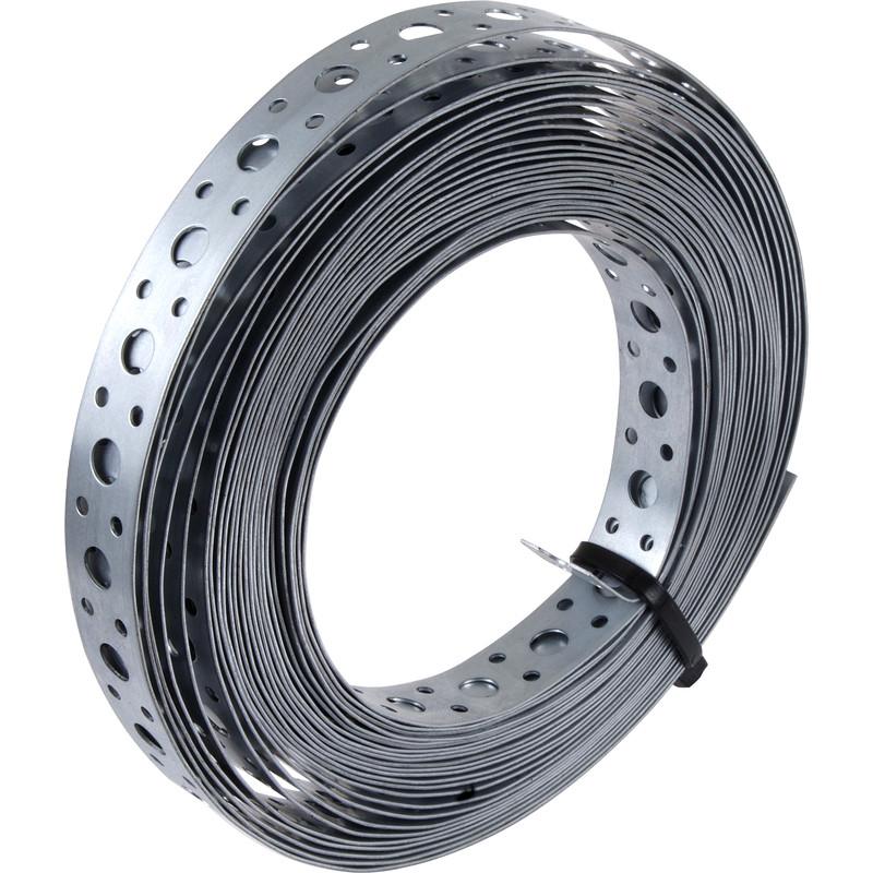

The photo is just a small part of it is massive but at least some of the roof is in a portal frame so no need to do it there. I think but would need to look to see if they have nailed them to the header. Have mailed my Architect he does not seem concerned in using the band on every truss
They have not used them we made the frame ourselves and there is a long story about it for another time. Was going to use the attached and using twisty nails to nail it to the wall and the truss where it goes up at an angle
Hi Just noticed that there are no rafter ties holding the roof to the wall header. I now can not install then due to insulation being fitted. Can I use Builders Band to do it at intervals where marked in yellow or something else or do i need to do anything thanks
