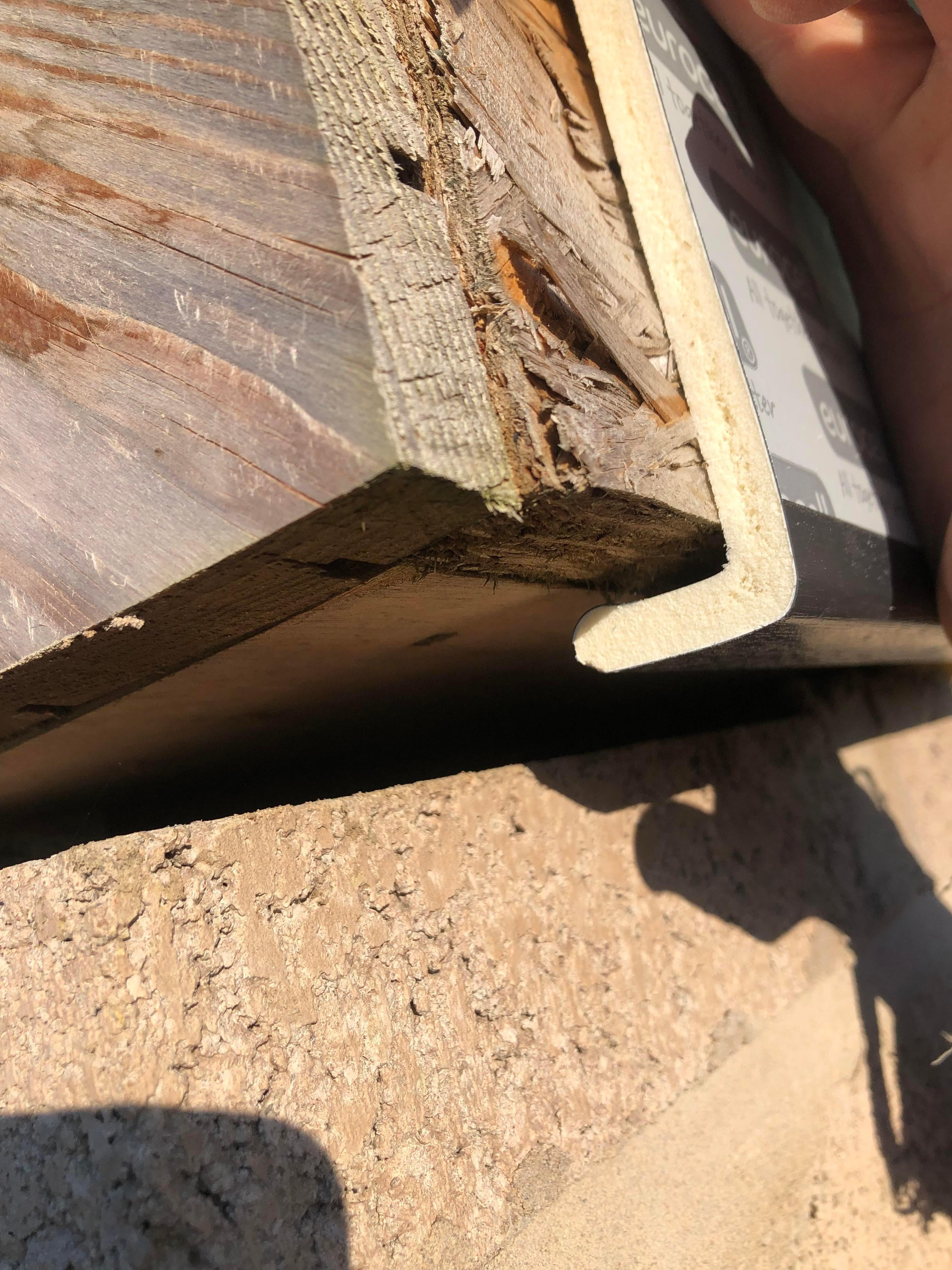

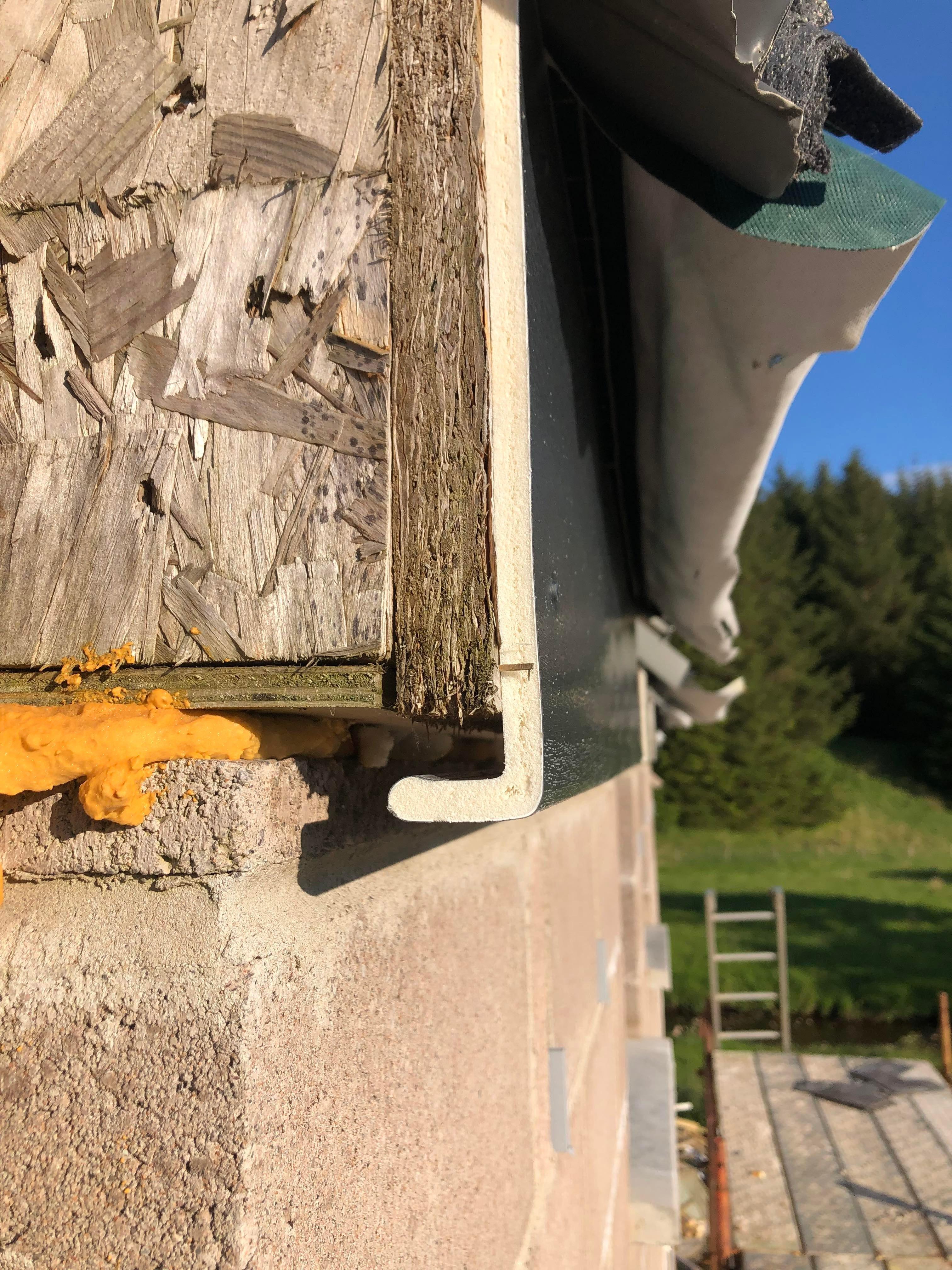

Hi I stripped it off and for some reason it was packed out at one end causing the issue. Trimmed it back with the multi tool and it is sorte. Glad I did strip it off as there was wool insulation behind socking wet. Panic over nothing as so much has went wrong with my build.

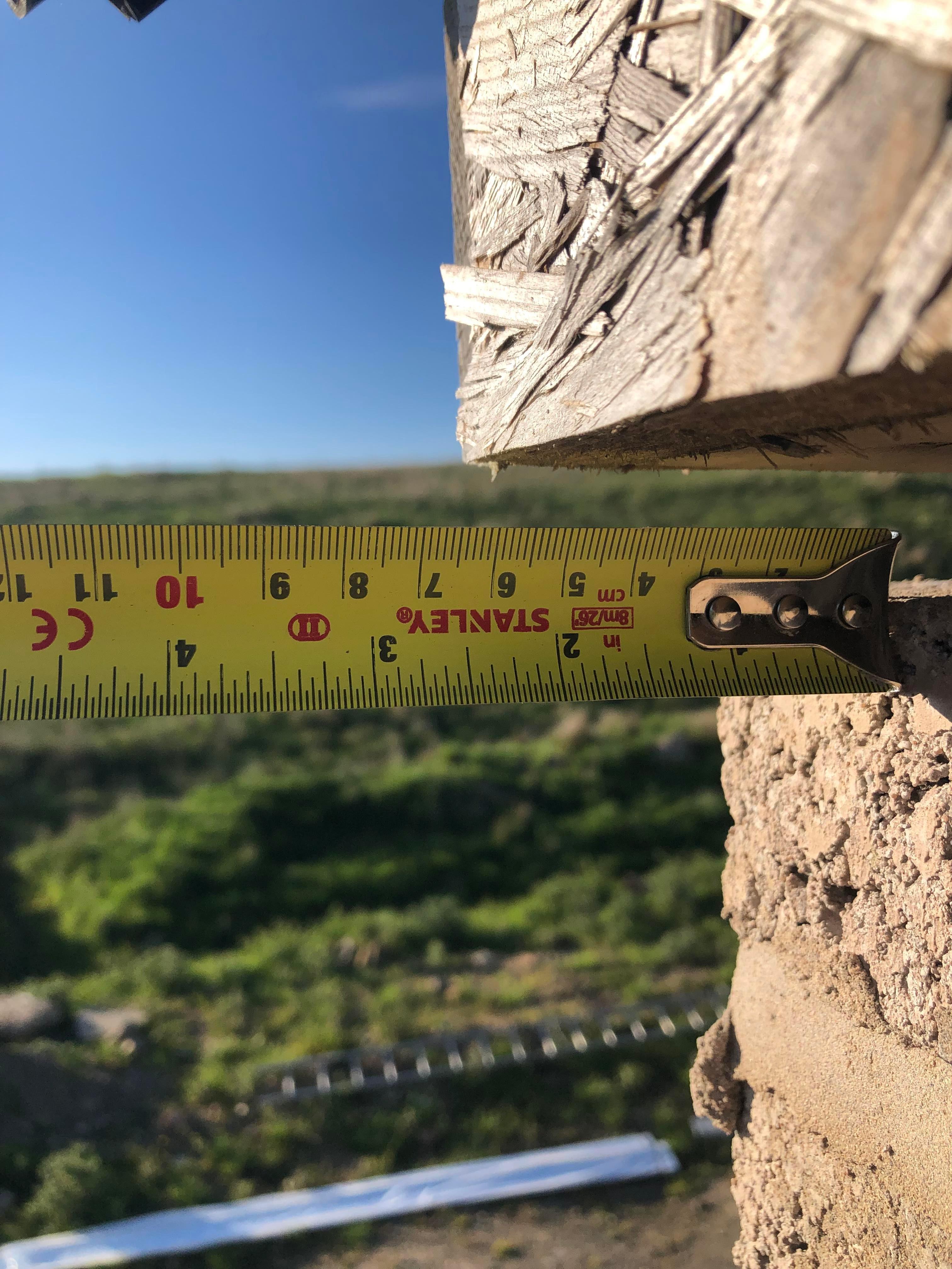

I was thinking about trimming back the rafter tail 30mm or so to correct it but do not know what impact that will have on the tiled roof.
It is render on the block
Hi Started putting on my capping board today and have noticed and issue which I think ios due to the roof not being put on straight. This part of the house does not have any soffits, As you can see from the photos it starts off with no soffits but at one point the gap goes up to 60mm. Any suggestions on how to fix this or if it can be fixed. I can not pack them out and put a soffit on as that would make the windows look funny.

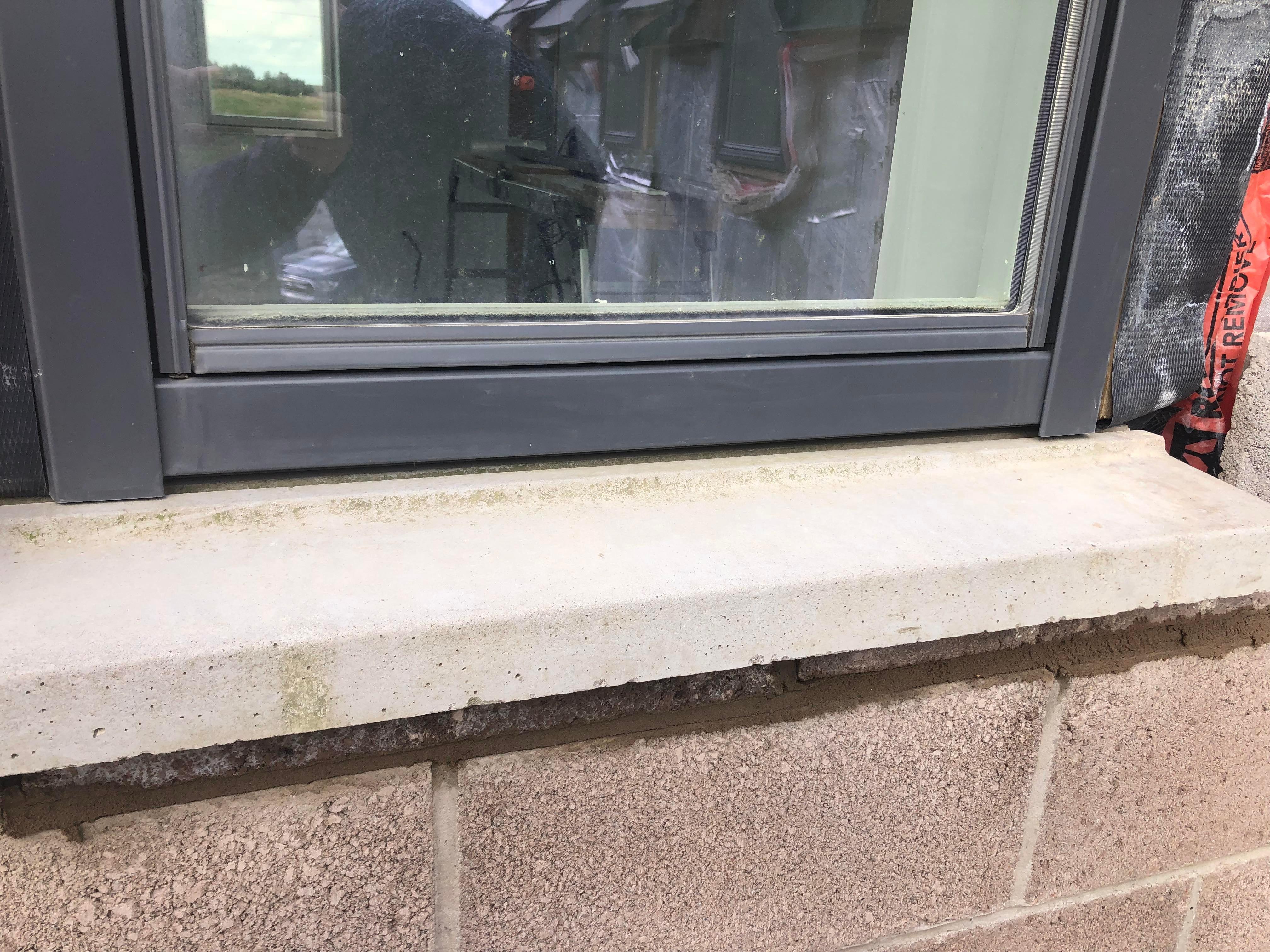

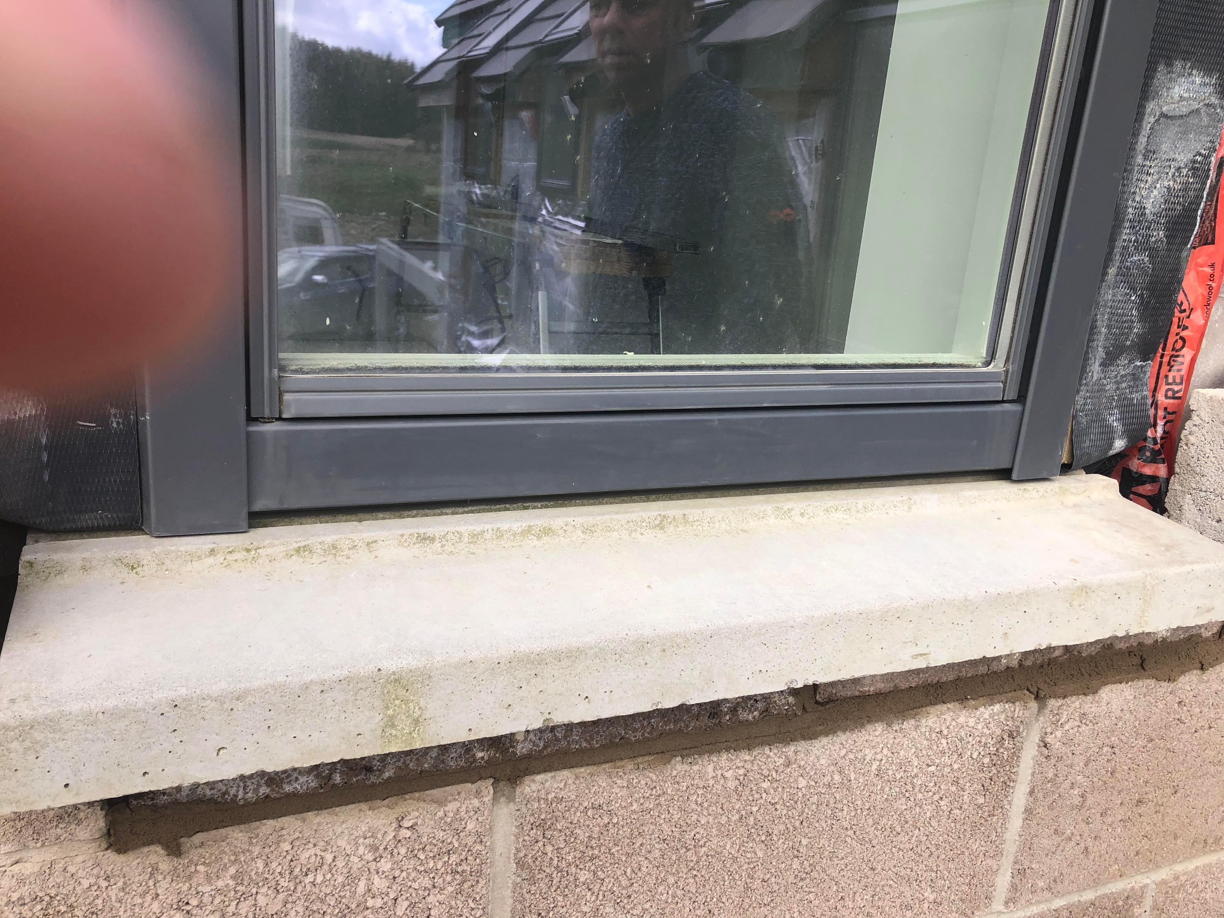

Hi I am looking for precast window cills. I currently have a precast concrete window cill but the finish on it is not that good (air bubbles ect) I was then looking at precast slip cills but can not find anywhere I can buy them off the shelf 14 weeks manufacture lead time. Can anyone advise where they got their cills from
