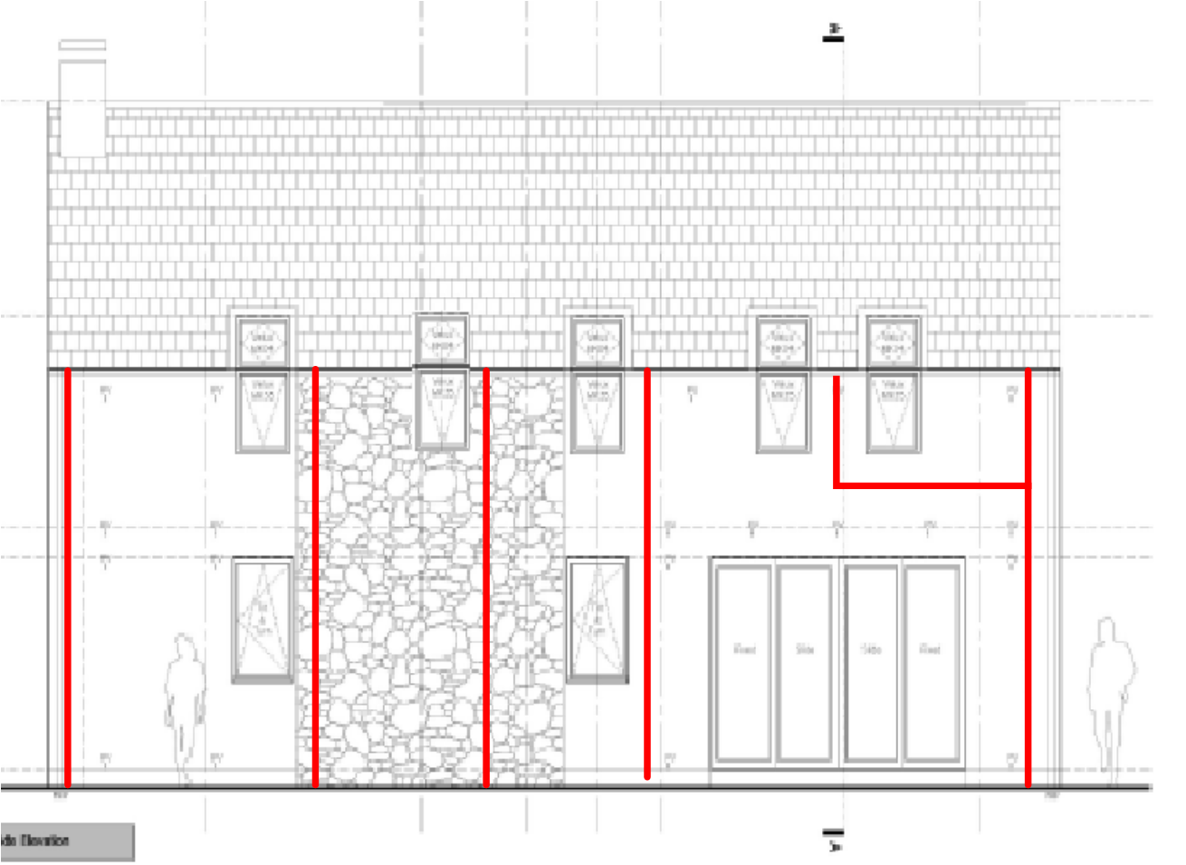

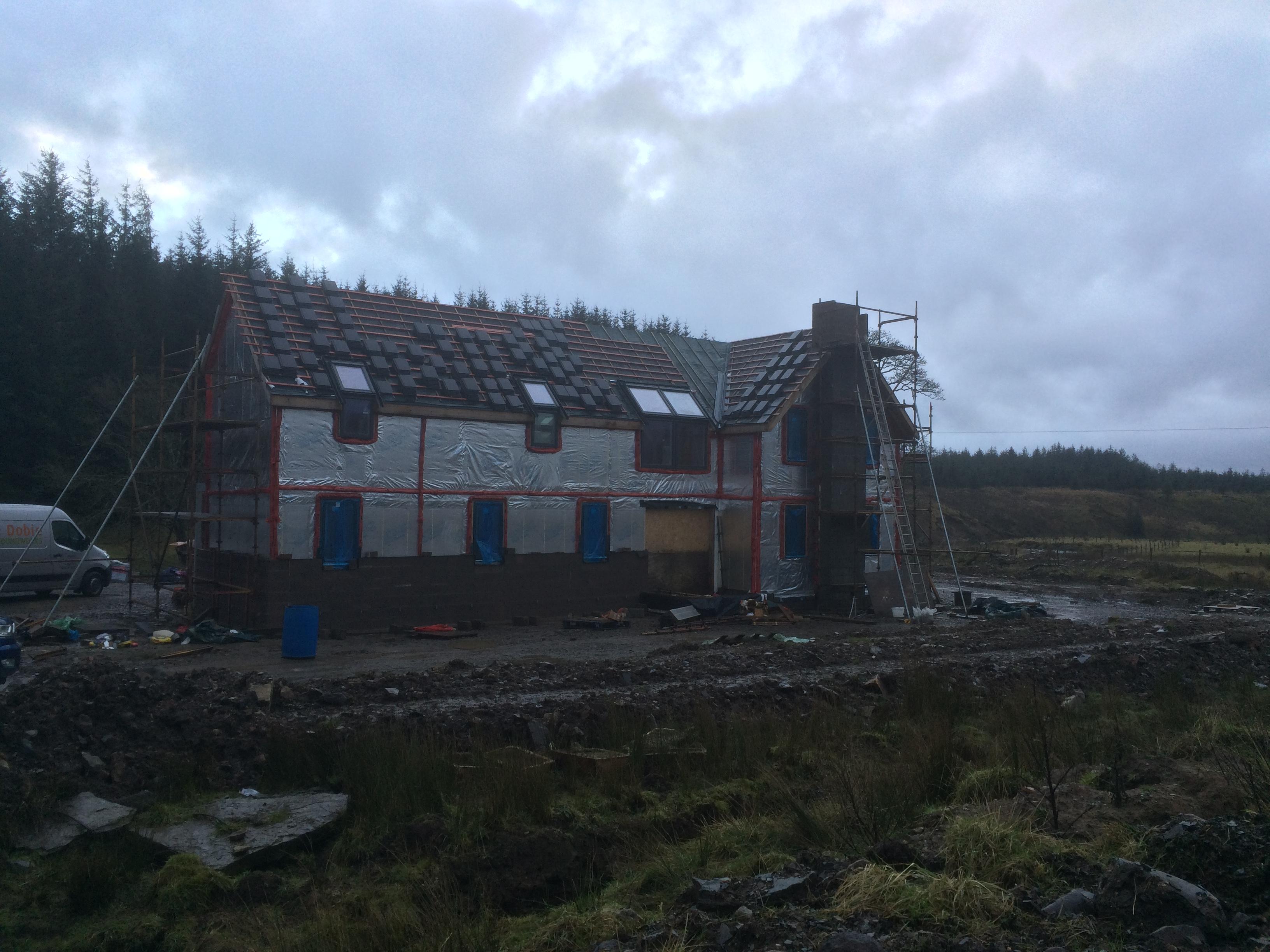

Hi Here is a phot of one of the elevations. It is a new build and the black line will be roughly where the gutter will be but not running past the windows. The whole roof will need to be drained by the gutter and the windows have a hidden gutter in them that drains into the main gutter. The walls will be a mix of render in bit and sections of stone. -

That is the issue there is no design for it it is a miss and know the roof is on it is like a bit of Sh*t what do I do moment. I was thinking that due to the lengths of guttering being in small sections then the area of roof is very small the water is collected from. Due to this the flow rate will be greatly reduced thus I can get away with a smaller drainage pipe. I could connect a 32mm MDPE pipe to the back of the gutter and run it down the cavity or inside the house and out the bottom. This would have no joins in it and if in the house can insulate it so no noise. I could put a mesh at the top to stop it getting blocked. -

I am ok with them being all in one length with no joins as I do not want something that looks like this -

No it is a pitched roof. Was thinking about brining the down pipe inside and putting it in the service cavity. -
Hi Is there any way you can hide down pipes? Due to the windows on my house being in the roof and the wall (see pic)it is causing the need to have lots of downpipes for the guttering. If the guttering goes past the window it will be in line with your eye. On the elevation there is actually another set of the windows so 5 in total Is there any clever solutions to solve this.

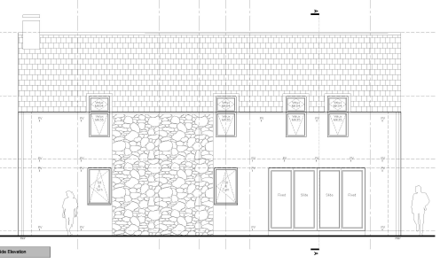

Hi was just wondering what other people think. Just took a photo of my house to show someone and noticed that the windows are not symmetrical. do you think it matters I a, not sure if it looks odd or not. The top half of the building will be white render and the bottom will be stone.

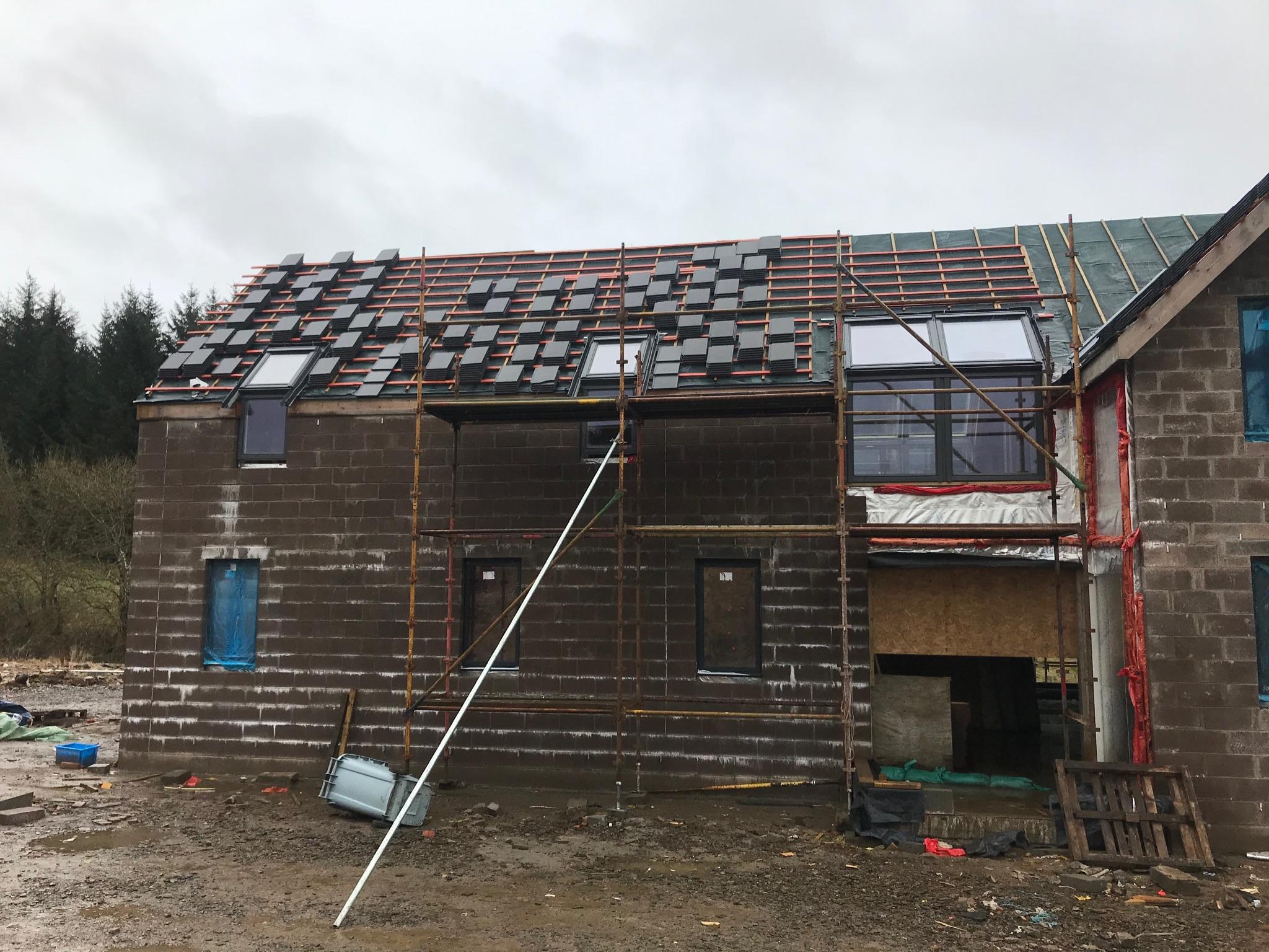

Due to scheduling and some of the roof not being able to go on as it rests on block work. All the outer walls are being built out of block except one which is timber clad. The frame has sat built for about a year and I am leaving 30 mm at the top instead of 20mm to allow for the additional weight from the tiles and more settlement. will this be OK as normally you would tile the roof before building outer walls. thanks

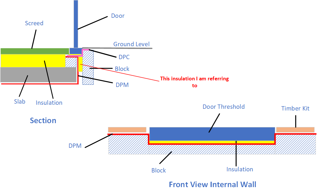

Due to the way the person erected the timber frame the cavity below DPM will be a bit wider that the standard 50mm (may be up to 10 to 30mm in places) that will be above DPM Does it matter if the insulation below the bi-fold doors and standard doors does not fill the cavity or do I even need the insulation in the cavity below DPM if there is 20 mm of insulation below the door.

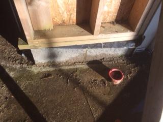

Hi My timber frame is raised of the slab by one course of block. I have just noticed on on wall of the house about 13 metre run that the cement has not went off it is like sand. As the timber kit has the blocks in compression and attached to steel work in places and there will be a 60mm screed going on and covering the block by 60 mm will this be OK. the block was laid nearly a year ago if not what can I do to fix the issue as I would need to take the kit down to relay the block. thanks

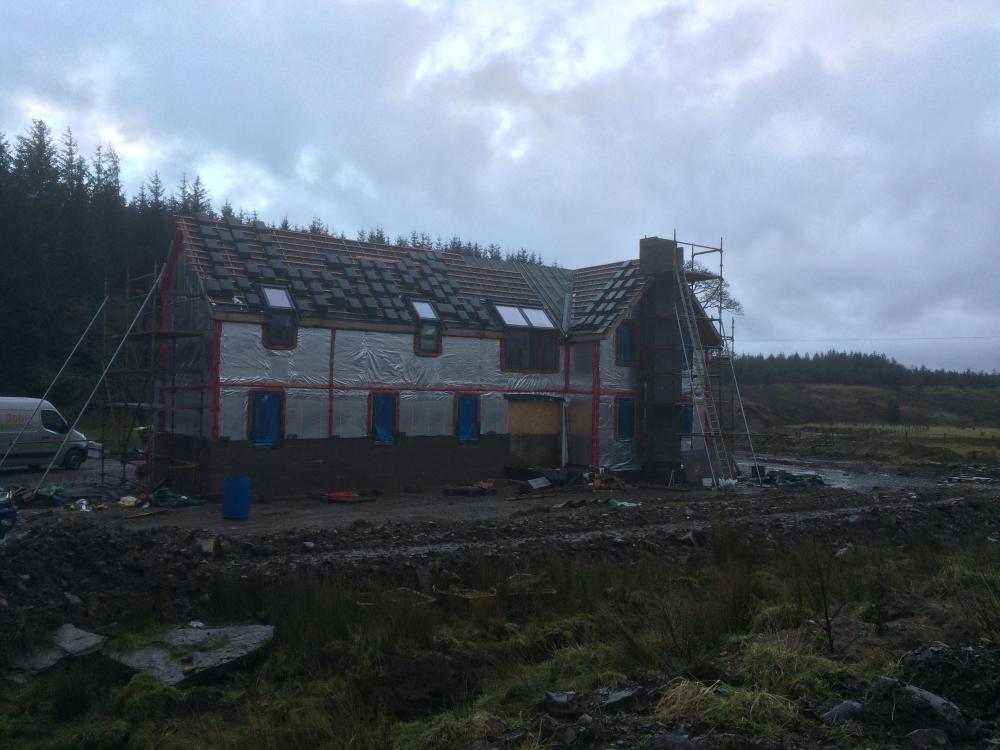

Breathable Membrane running down hill
GrantMcscott replied to GrantMcscott's topic in Roofing, Tiling & Slating
Supperjohmg I know exactly what you mean tearing my hair out -
I will tell him to make sure it laps correctly and the OSB is cover but if it is wonky will it mater if it is lapped correctly -
When on the scaffolding I am to close to capture the issue and you can not see it from the ground. try to explain better so if you were doing it properly you would lay it parallel with the roof eaves. Mine is not parallel it runs down hill by 30 degrees. At the eaves on the left hand side you see about 200 mm of the OSB and if you look on the right hand side the membrane is down to the eaves does that help
