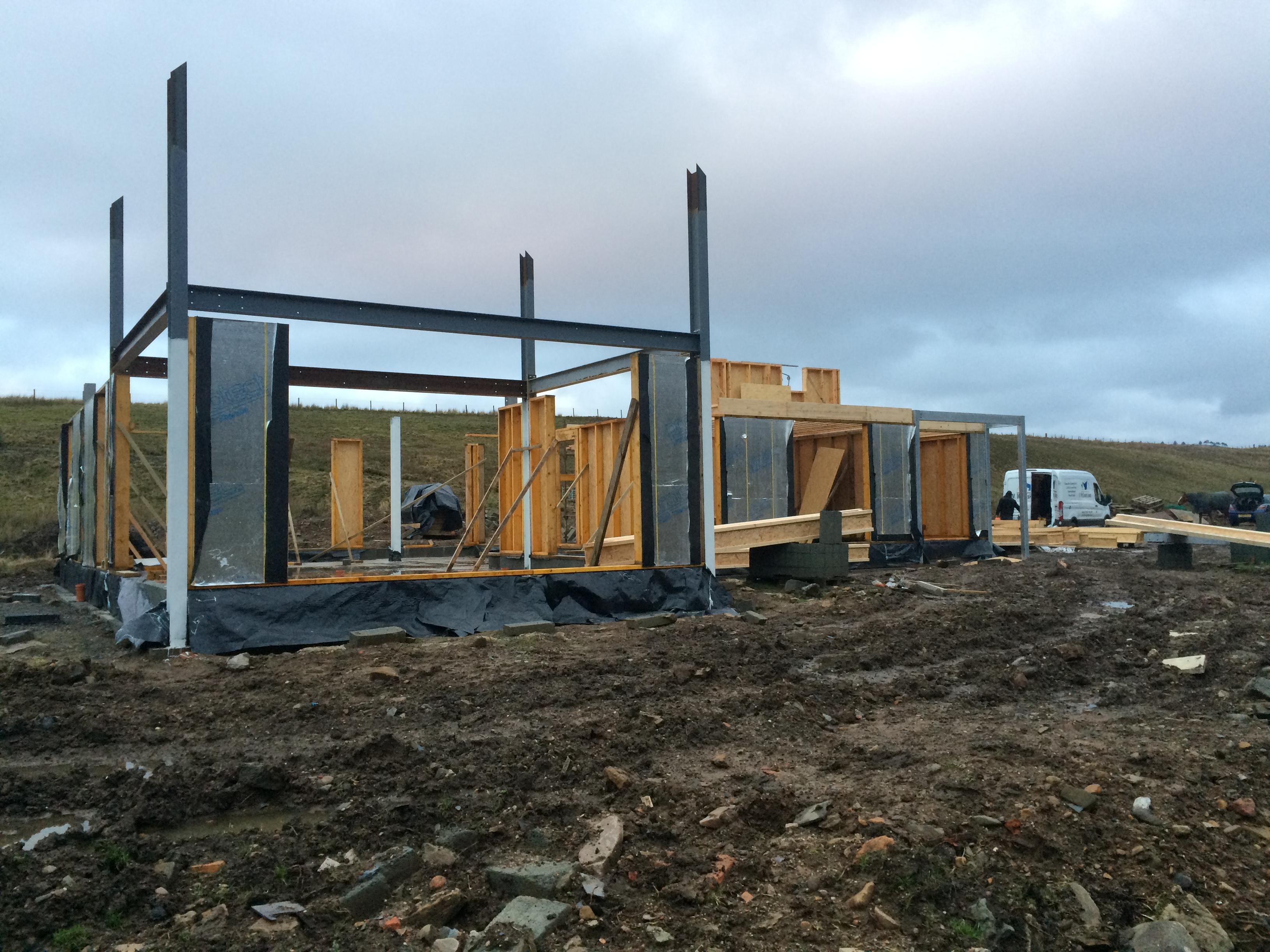

  5. Hi I have just had the steel dropped off for some supporting parts of my house. There is 10 steel posts going in and will be attached to the foundation and also some beams between them. The person doing the steel has not painted it and there is some surface rust on it. Does this matter as most of it will be internal. thanks

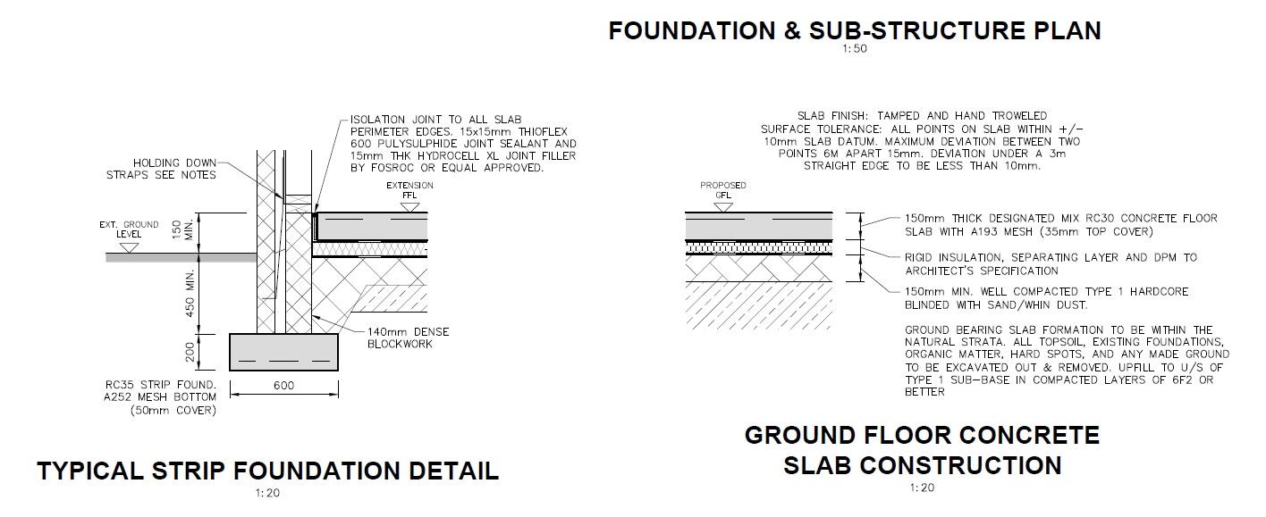

  8. Hi I have my slab make up back and from reading the forums it does not match what other people are doing. I plan to use 100mm Celotex ga4000 underneath the sub-floor for the insulation as per the drawing. On top of the slab I plan to put more insulation on top of the sub floor about 50 mm, then lay the underfloor heating with a screed of about 60 mm Does this sound correct as a lot of the reading I have done on the forum suggest the slab then the insulation. thanks
