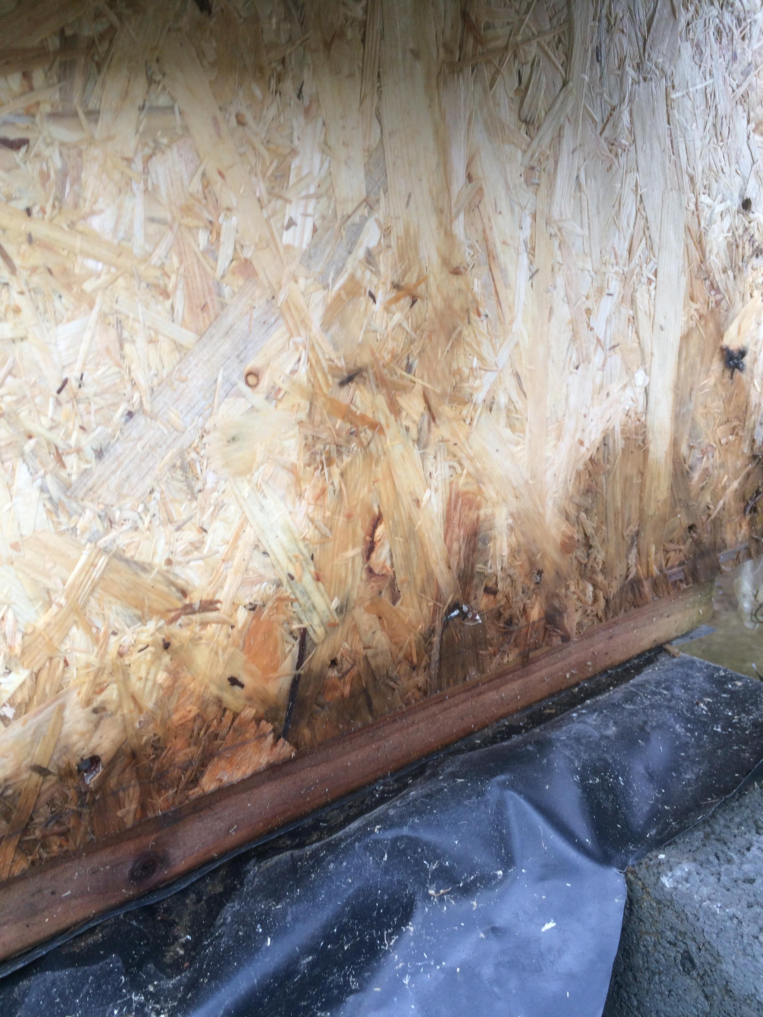

  3. it is under the solplate but also stappled on top of the osb the same way the wrap is thus you can see the black at both places where the wrap is not covering it
  4. Hi My Joiner is putting on DPC stuff at the bottom of the timber frame and where the top of the first floor meets the floor joists . Is this necessary as I have never seen it done before? See pic

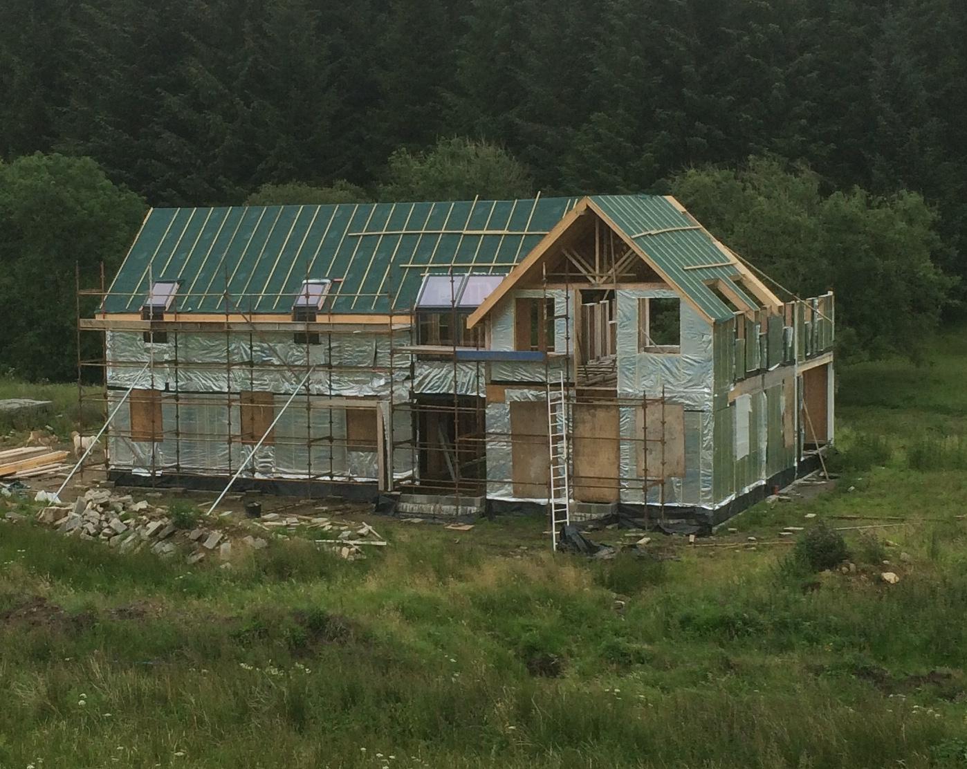

  7. Well frame is coming on and roof half done but starting to really worry about the rain effected OSB and frame. The frame has cracked in a few places and the OSB eages are very wet. This is due to water penetrating it from inside to out. It has been non stop rain here for weeks with minimal dry days since January when we started

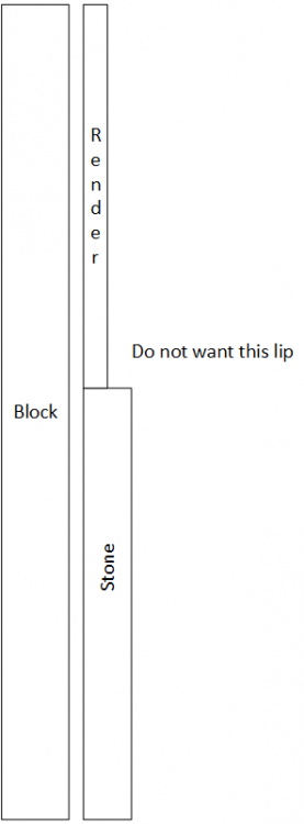

  11. So full wall 100 mm block then bottom half 100 mm stone so the bottom half will be 200 mm thick then stop half will be 100 mm block + render so there will be a lip
  12. Not sure I understand as if I set the block in 25mm it would be in half of the cavety
  13. Hi My outside wall are going to be 100 mm block then 100 mm stonework tied into the block approximately half way up the building then it will change to white render. Is there any way to stop a lip where the block meets the render as the render will be thinner than the stone thanks

  25. We have started constructing our house and the down floor is nearly complete. The build is getting hampered by the bad weather rain and wind. Will the OSB board be ok as we will not be wind and water tight for a couple of months. How much water can it take. The wrap at the minute does not cover the wastes of the external OSB as it is folded back. Thanks
