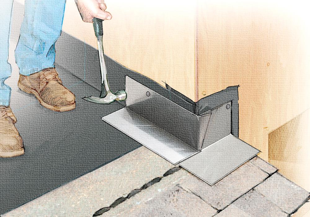

  6. Hi Is there any material I can use for flashing that can be rendered over. I have 2 saddel flashings which will be dressed round a conrner where render will be. or is it possible to use lead and then put wire over them to alow the lead to expand and contract without breaking the render. thanks

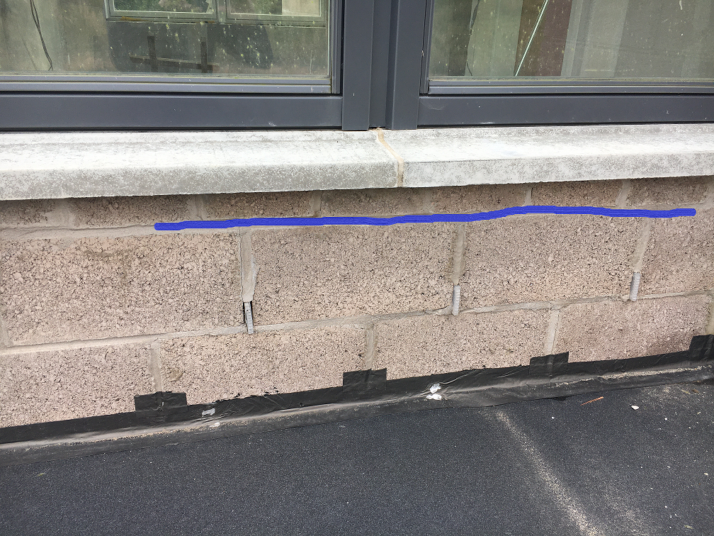

  11. Hi I am doing a GRP roof and was wondering if you can chase the flashining into the block or does it need to be chased into the mortar joint? Also not sure about the grey flashing being so visable on the roof due to insulation ect we will have gey flashing visable or should I use white to match the render

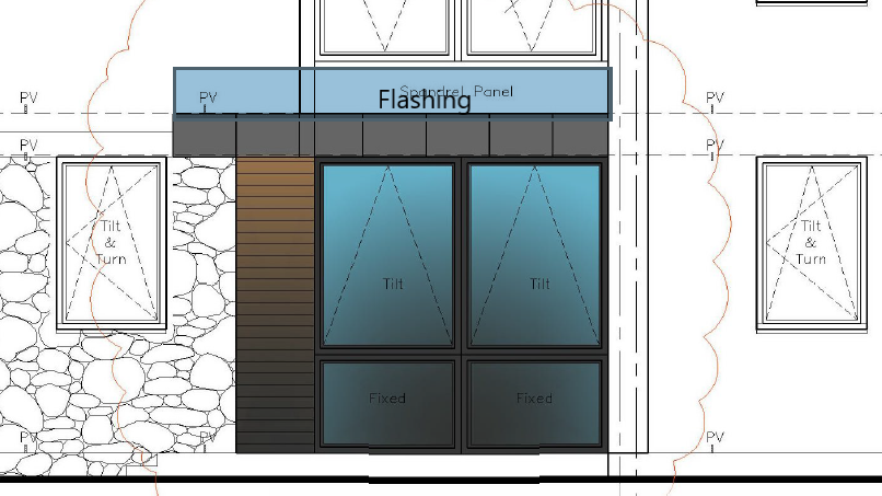

  21. Hi The rafters are already in and they run front to back 😞 The ceiling is already as low as it goes. I have 225mm from the OSB so the time I put slope on the roof and insulation ect then it is above the block mortar line so I need to go upto the next block for the flashing and will look daft
  22. Hi I need to do a warm roof for my porch either EPDM of GRP the issue I have is the spec is for 170mm thick insulation on top of the OSB. If I do this the flashing will be above the weep holes for the lintel and very close to the windows and look silly. Is it possible to put 40mm of insulation on top and 15mm in the joist zone will this be OK or will I still get condensation? does the flashing need to be chased into the mortar or can I chase out the block thanks in advanced.

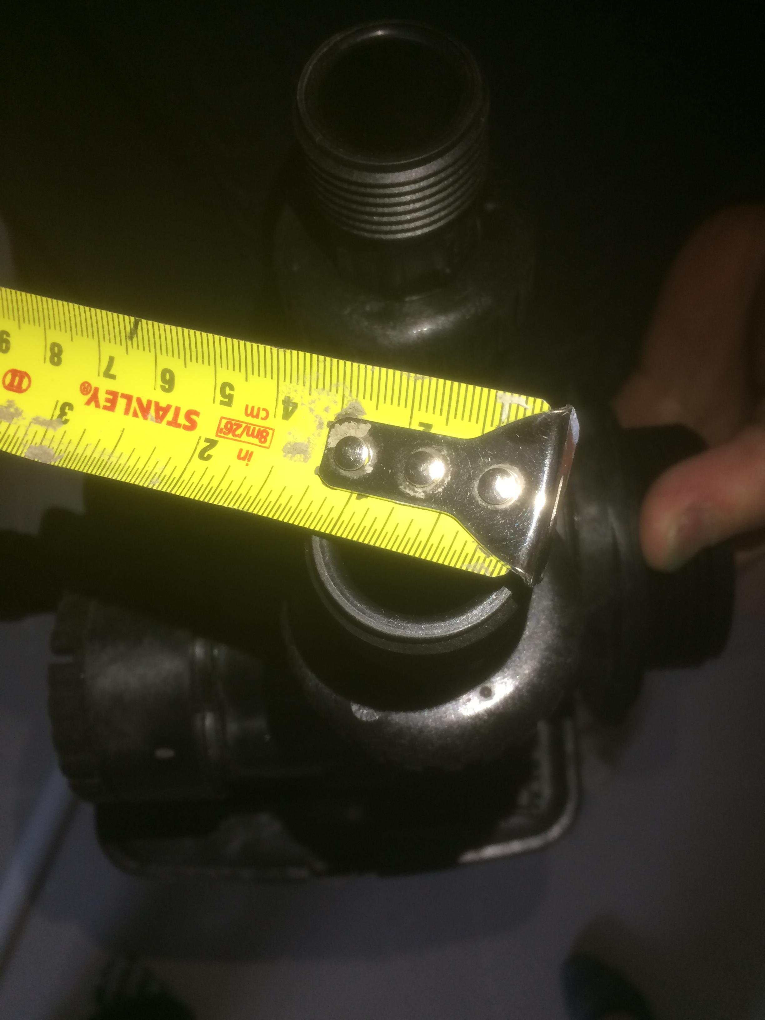

  23. No Will it not be a 1" BSP thread as outside diameter according to the BSP chart is 33mm
  24. Yes you are right it is an 1.25" been googling and can not find a fitting for it. I am assuming it is a BSP thread as it feels rounded at the top.
