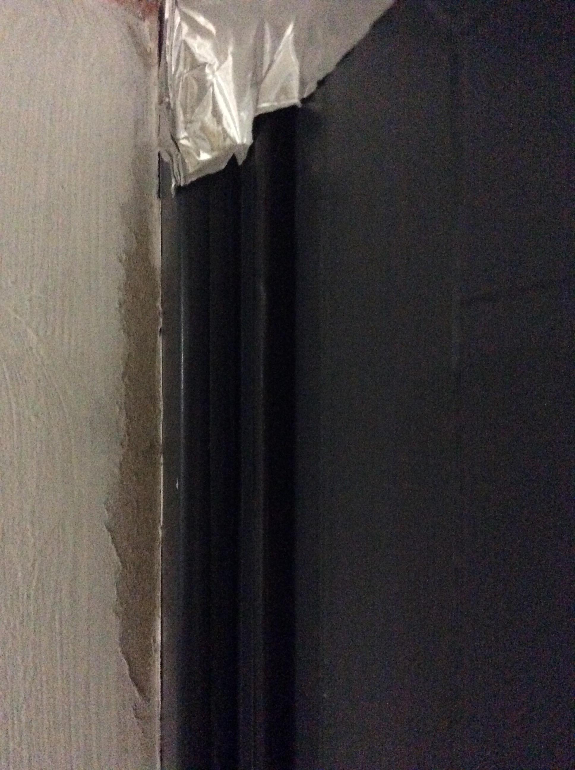

Everything posted by GrantMcscott

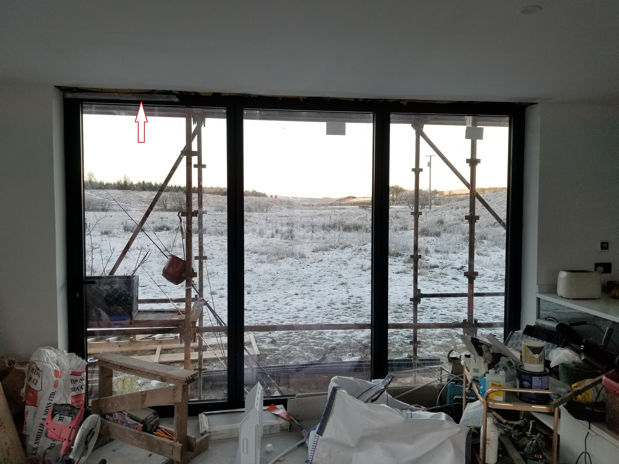

  2. Idid adjust the locking to pull the door in but it does not pull it in enough. My doors are SCHUCO and struggling to find any good documentation on it for adjustment
  3. Hi had another look at the door tonight and it does not look like an issue with the gasket. It looks like the door is not shutting tight enough at the top. You can push the top of the door in an out. Is there any adjustment to bring the top of he door in to close the gap between the frame and top of door? Not sure if you can see it from this pic

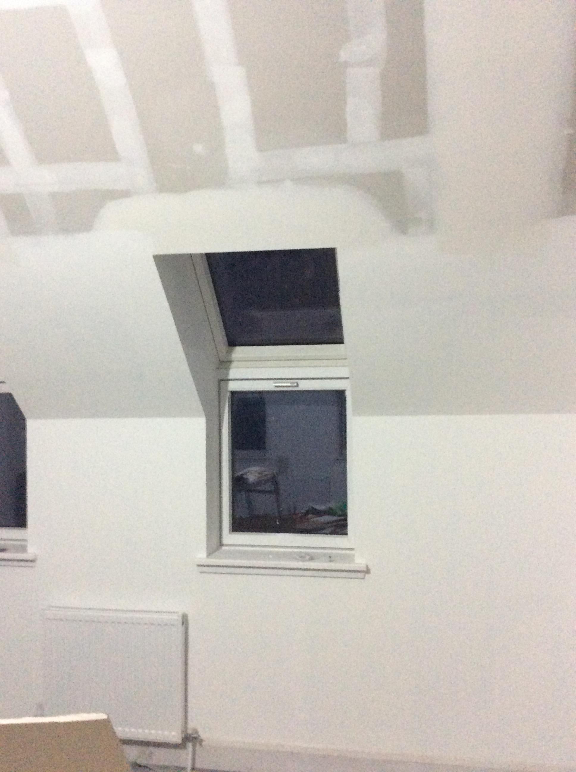

  7. Hi We have Velux VFE Windows see pick. On the Windiest part of the house the gasket that seals the Windows let’s quit a big draft in at the corners. Wondering if if anyone else has had this issue with Velux and what they did about it. Going to to contact them on Monday as had to put scarfs on the window sills to stop drafts

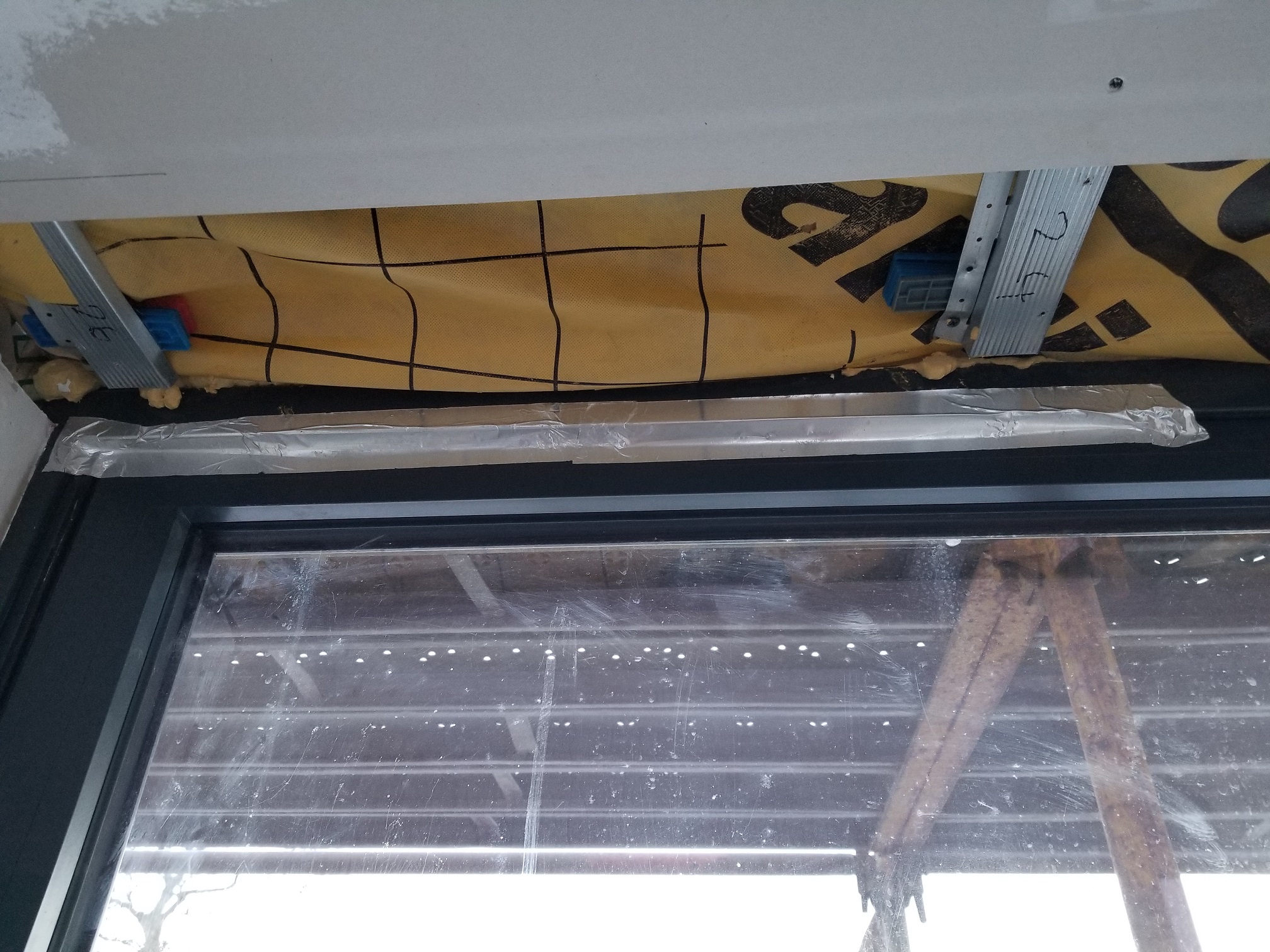

  8. The windows are sitting mostly in the 50mm cavity so there is hardly anything for the compriband to stick to. I was looking for a tape to tape the window to the timber frame
  9. I still have some windows on one side of the house that needs timber clad that has not been done yet. The windows have been sealed with expanding foam but what tape would you use to seal them to the building before clading? Also no rendering has been done yet so is there anything I can do to make them more air tight before the building is finished?

  11. The windows were sealead with expandable foam all around where possible as for eample the one in the utility is siting on the frame so hard to get a seal to the bottom. so it has a draught that needs to be fixed

  13. Yes it where you say it is to late now as it is all plasterboarded and upstairs floor is down. It is not poor design it is a design that has not been followed and implimented. I think the best I can get is sealing the skirtingboards and windows at best
